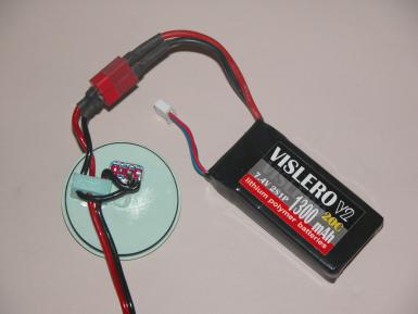

      What are these parts for. Having a brain dump

                  Zip-cord (two conductor) power cable between battery and BEC, ESC, Lipo-Guard, and MPC. Spare pushrod seals, and the power cable strain-relief block that keeps you from tugging on the wires as you make/brake the plugs between battery and system.
