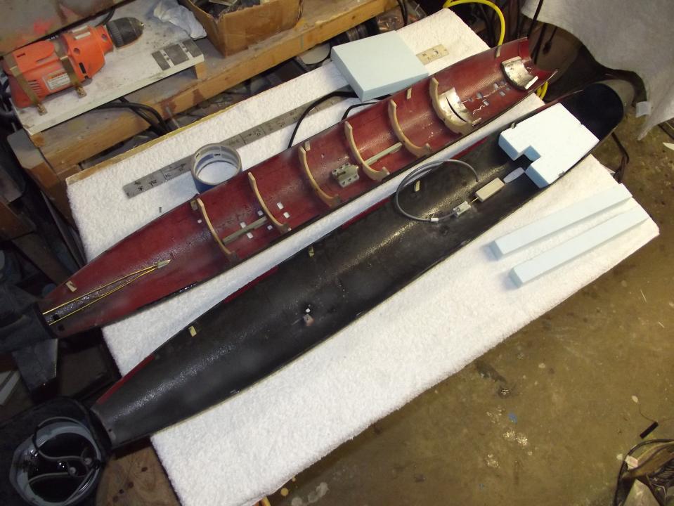

    Nice Job there Peter. A question you asked earlier about a way to reinforce the hulls shape. I like your long bolt Idea. What I did was go by a Plastic supply shop and buy a piece of scrap. I bought 1/8". I cut them up and shaped and fitted them to the Oscar, and then epoxyed them in. Worked great.

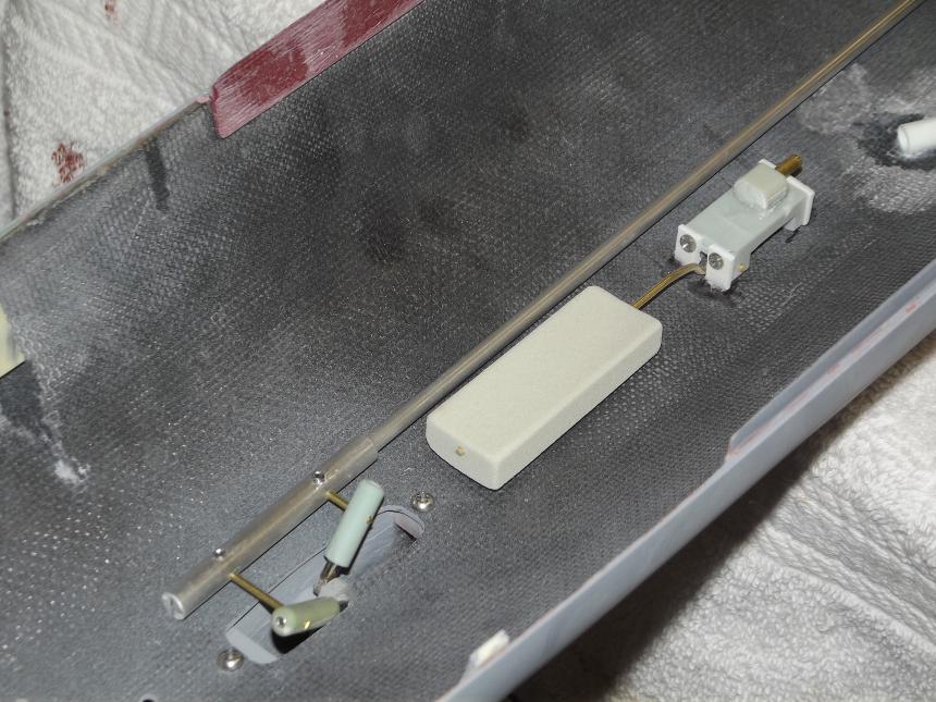

ID:	91611Click image for larger version
ID:	91612Click image for larger version

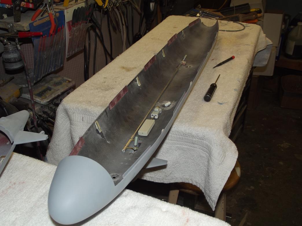

ID:	91613You mean the SAS? And you can mount the snorkel induction head-valve just about anywhere, such as how I did it on this 1/72 THRESHER model -- there was no room in the sail so I mounted the horizontal type unit into the upper hull. Works fine.

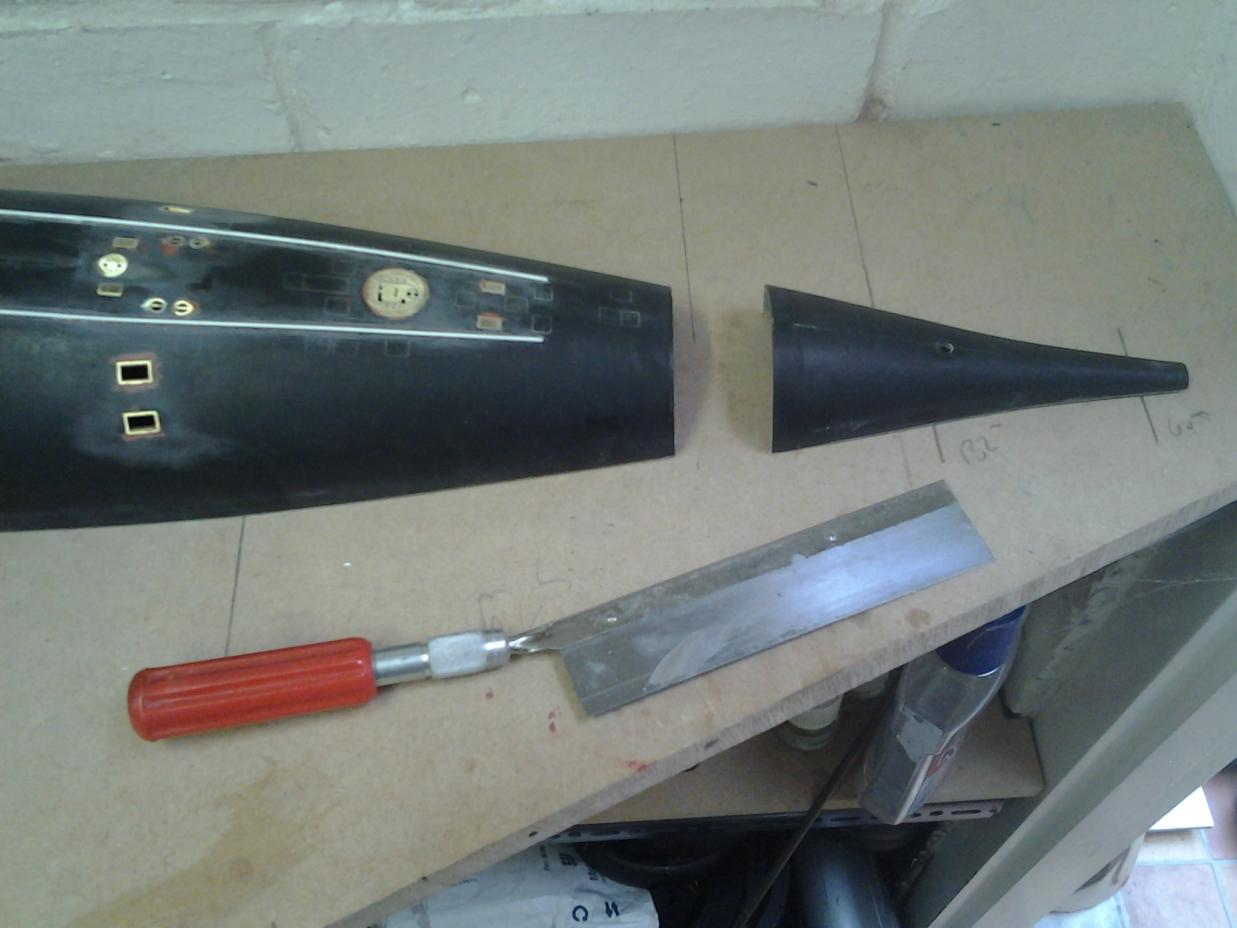

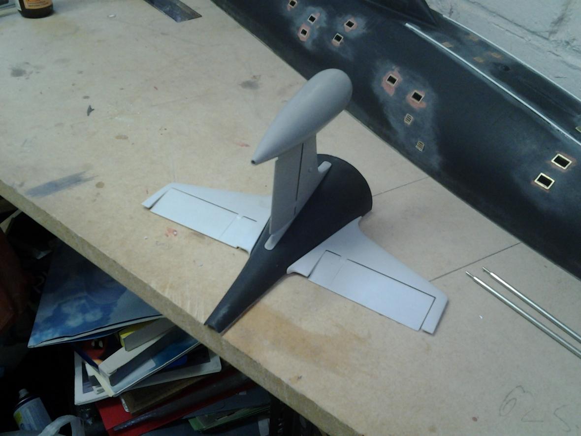

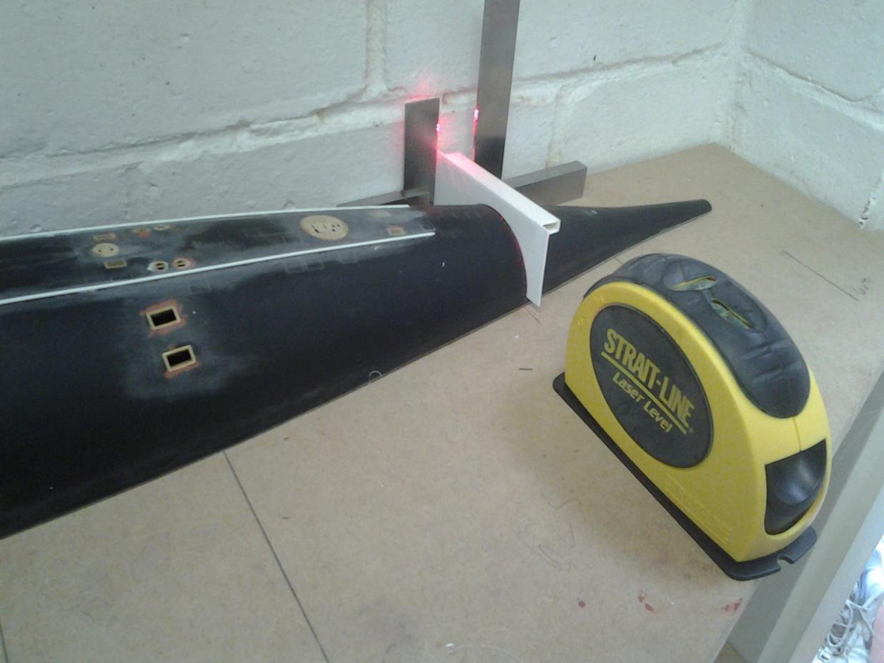

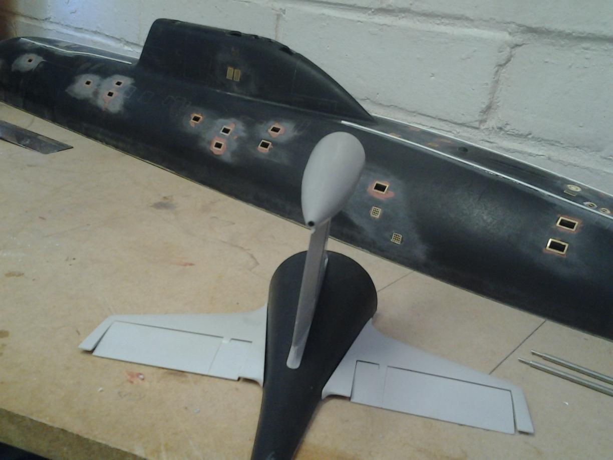

                          Recent events have slowed me down....again but I have made some more progress I am pretty sure that all the brass is now finished, by that I mean filled and everything. I may do little bit more gluing from the inside of hull but they are finished apart from that.
                          Today I decided to grow a pair and tackle the upper hull cut. This, due to never having had to do this before had worried me a little to the point of prevarication. However in the event it was a bit of an anti-climax. I made a pencil guide to make the marking out a simple matter then with my narrowest kerfed razor saw hack, hack and it came out well. I then allowed myself a picture of how the stern would sort of look with upper rudder and stern planes before typing this missive.

                          Note the addition the hole at the back of the rudder pod, I think it looks better than not being there.

                            You are doing a great kit a very good service. An enjoyable WIP, Pete. Keep it up.
                            And a reminder (likely I should not have to say this, as I think you already appreciate the reason why): after you have made the hull surfaces ready for that first coat of primer, insure that you pickle all exposed metal surfaces first. This to insure a good grab between metal and primer. Failure to get tooth on those areas will result in primer-paint shrugging off those areas the first hot July day you encounter.
