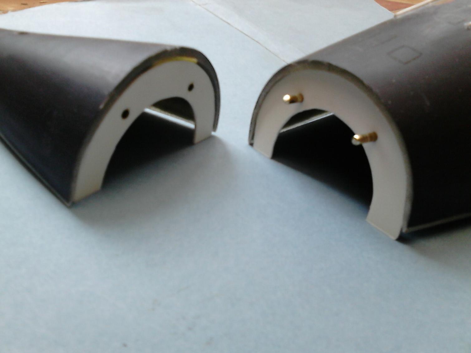

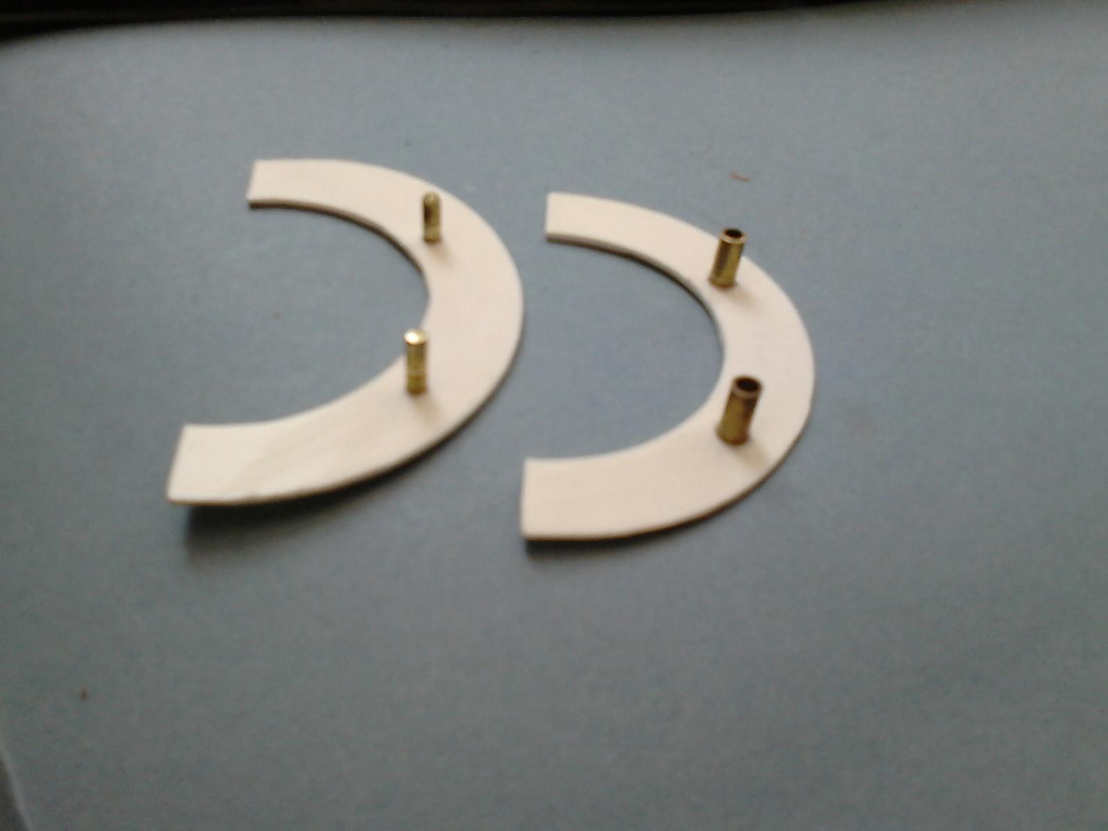

        Well to answer a question posed by Redboat ( I think it was) about the lack of posts. I for 1 have been away and ill, a bit. Also the state of my Fiscal being is currently not good so products I am starting to need are being saved up for in earnest. I have however not been too idle but have decided to play around with/ mock up the stern joint between the 2 upper hull parts, as below.
Name:	Akula b 999999999994.jpg
Name:	Akula b 999999999995.jpg
        The pegs are 3/32" brass rod and the tube being 1/8". The styrene will be replaced for 3mm G10 epoxy sheet...........when I get it. The top of the sheet will be reverse scalloped( hole type thing put in it) to allow air to travel freely and not get trapped and the half circle affair will not travel the full half circumference of the 2 hull pieces.....just enough, in other words. The mock up is purely so I can be doing something ! although I have been trawling through my Akula pics looking for more ways to detail the hull, so I have enough to be getting on with.

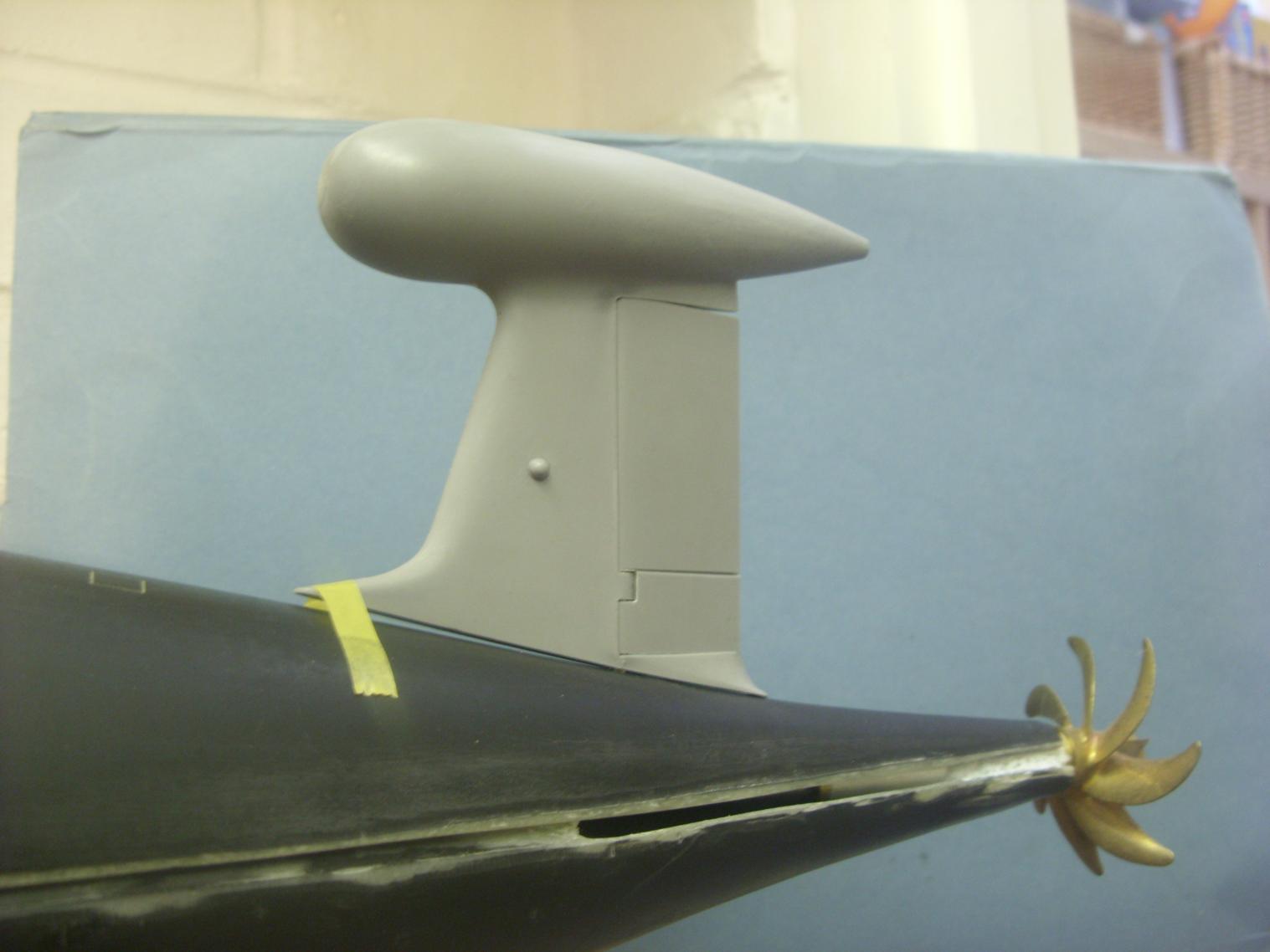

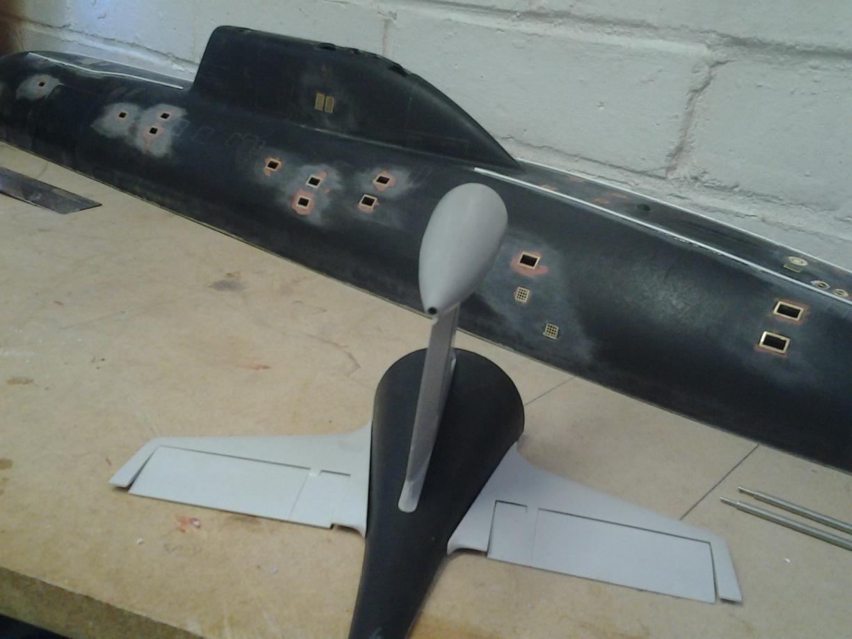

                          Thanks Mate. Will do. The model is an early version of the II with the large towed array container above the rudder but the thing is solid resin. I've drilled a small hole in the rear of it for realism's sake. Do you have a spare snort valve with float kicking around?
                            • 14010
                            #118
                            E-mail me with your address. I've been out of the shop for over a month, so I've been late getting stuff out. But I'll fix you up eventually.
                            Chop that egg off the rudder, and vacuform a thin-shelled version off it. Trust me on this.
                              #119
                              Can't you cut it in two radially and hollow out each end with a Dremel? Won't be as thin and light as a vac form, but an improvement on something solid.

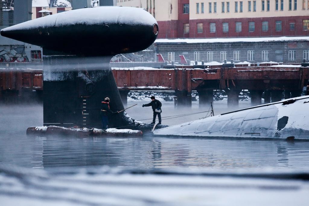

                                OK given your comments a bit of thought, As I Don't have a Vacforming machine or I may confess the skill to cut the pod in half, scoop out like a melon then rejoin could I core it instead, let me try to explain. The hole at the rear end of the pod which I have put in for decorative reasons is 2.5mm ( a little over 3/32" if my maths is correct)
Name:	Akula b 999999999993.jpg
ID:	92936 Click image for larger version
Name:	Akula b 9999993.jpg
                                The Pod at it's thickest is about an inch, but based on the picture below I have the option to put in a vent/access panel at the front of it. Now it isn't a detail of the K157 but I am not a rivet-counter and quite like the idea of putting it in as a detail, but if I were to put a 9mm (3/8") hole in from the front towards the rear for say about 75mm (3") I could lose a reasonable amount of weight, I could then use a diamond burr to hollow out the pod more losing even more weight. A 3mm (1/8") hole down from the top, a vent covering on top of that and Hey presto........and er ...so forth.
