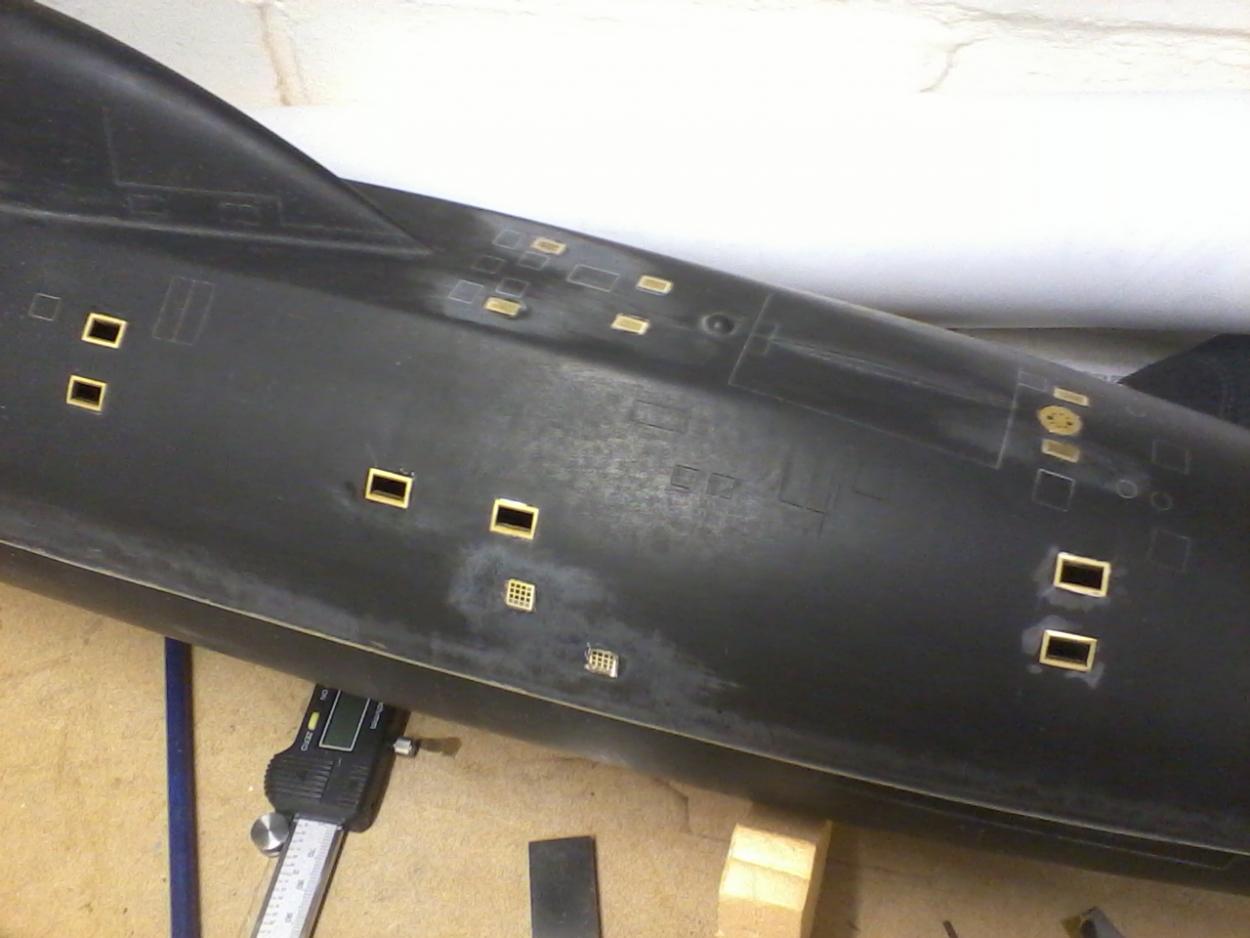

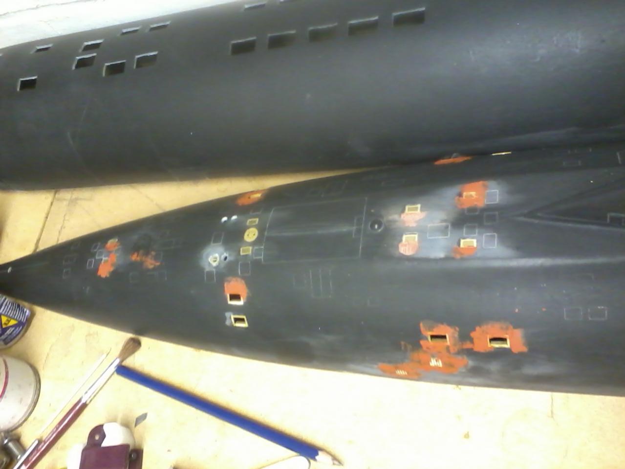

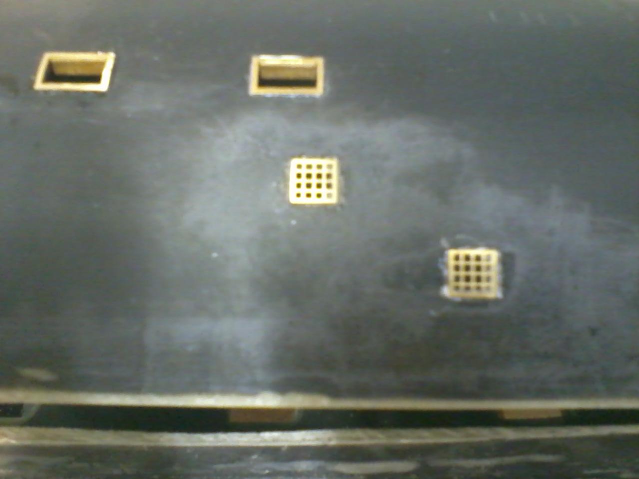

          Right not much to show because I am off to Italy for 2 days with work but finished up the 2 grates on the upper port side.

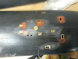

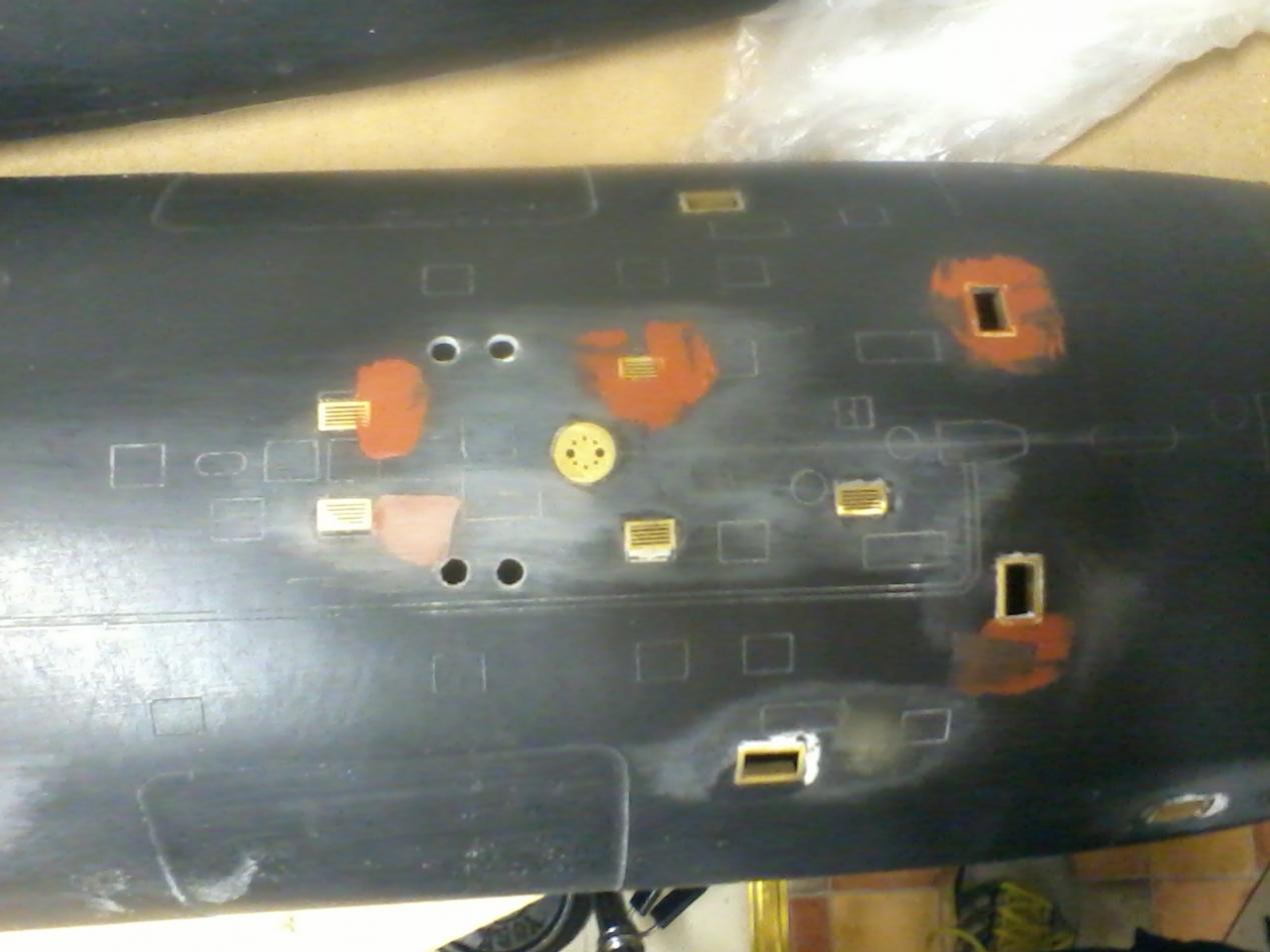

            Have now fitted the 2 vents on the other side of the hull to the ones pictured in the post above.
            Now apart from the 8 bollards and the rear access hatch the brass on the upper hull is nearly there.........apart from the scopes and bridge area. the scope section is reasonably straight forward but the forward section including the bridge itself is not scribed as the plan.

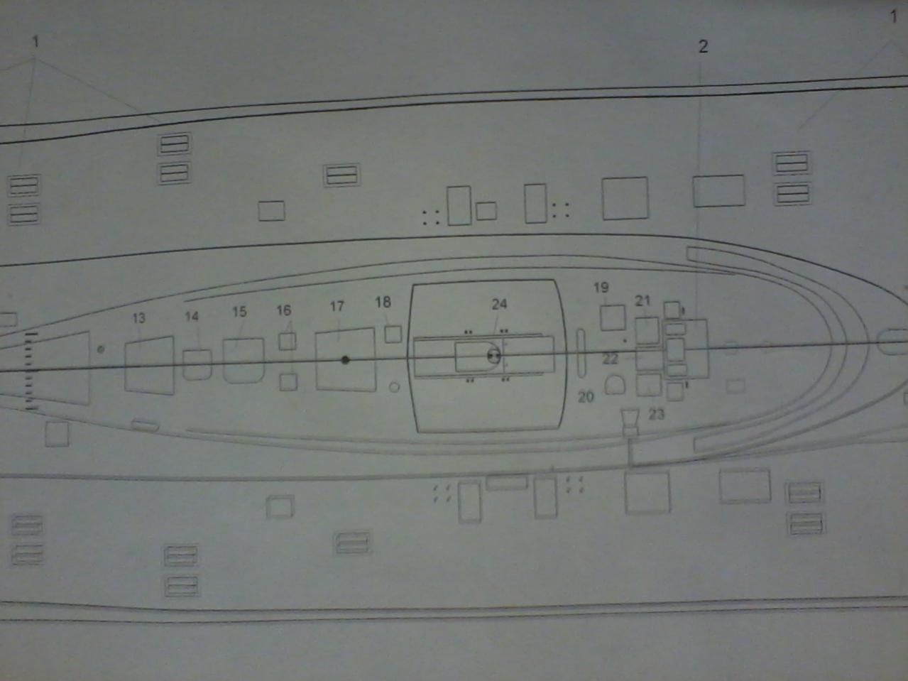

            The 24 marked on the plan is the brass piece in the picture, so as you can see the actual model is different to the plans. The bridge section needs to be modelled, positioned and built based on the spray shield provided as a brass piece. So I shall fill the scribed lines and re-mark starting with the bridge.

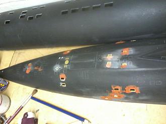

Name:	Akula b 9999999.jpg
ID:	83829Click image for larger version
Name:	Akula b 99999991.jpg
              Using a bit of styrene sheet to apply works pretty well but it does melt the styrene a bit after a while.

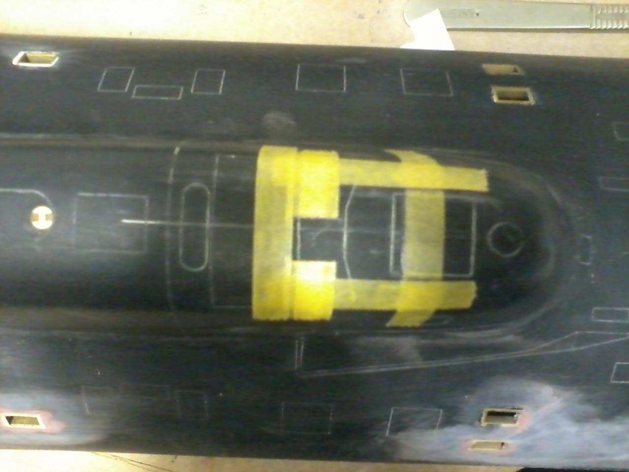

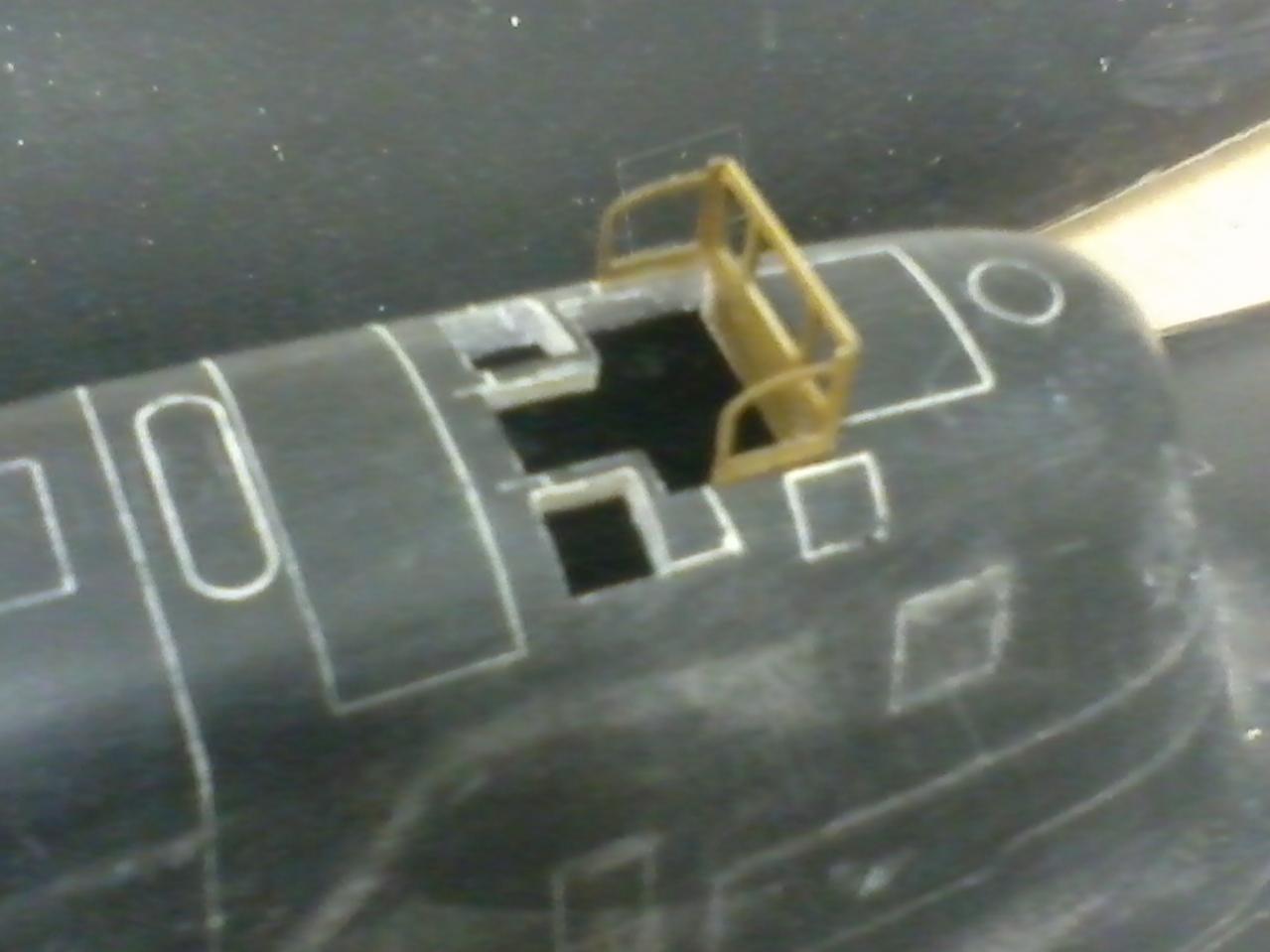

                        #71

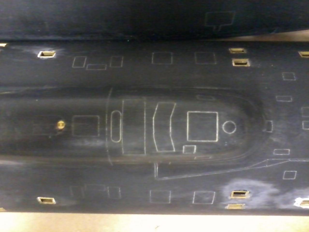

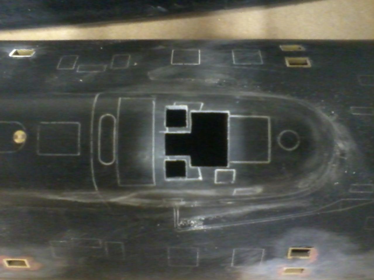

                        So I have sanded all the filler back and apart from 7 of the 8 bollards stern hatch I have done with the brass on the main hull.
                        The biggest detailing job on the sub is going to be the top of the sail.
                        Now as previously stated the sail is scribed correctly enough on the rear half but the front half is not right, so here we go...... ( must apologize again for the indifferent quality, having trouble with the array of cameras I have)
Name:	Akula b 99999992.jpg
ID:	83930Click image for larger version
Name:	Akula b 99999995.jpg
                        Before... After...
                        As you can see the bridge area is not marked at all and the position is a best guess based on the plans and pictures posted by Mark.

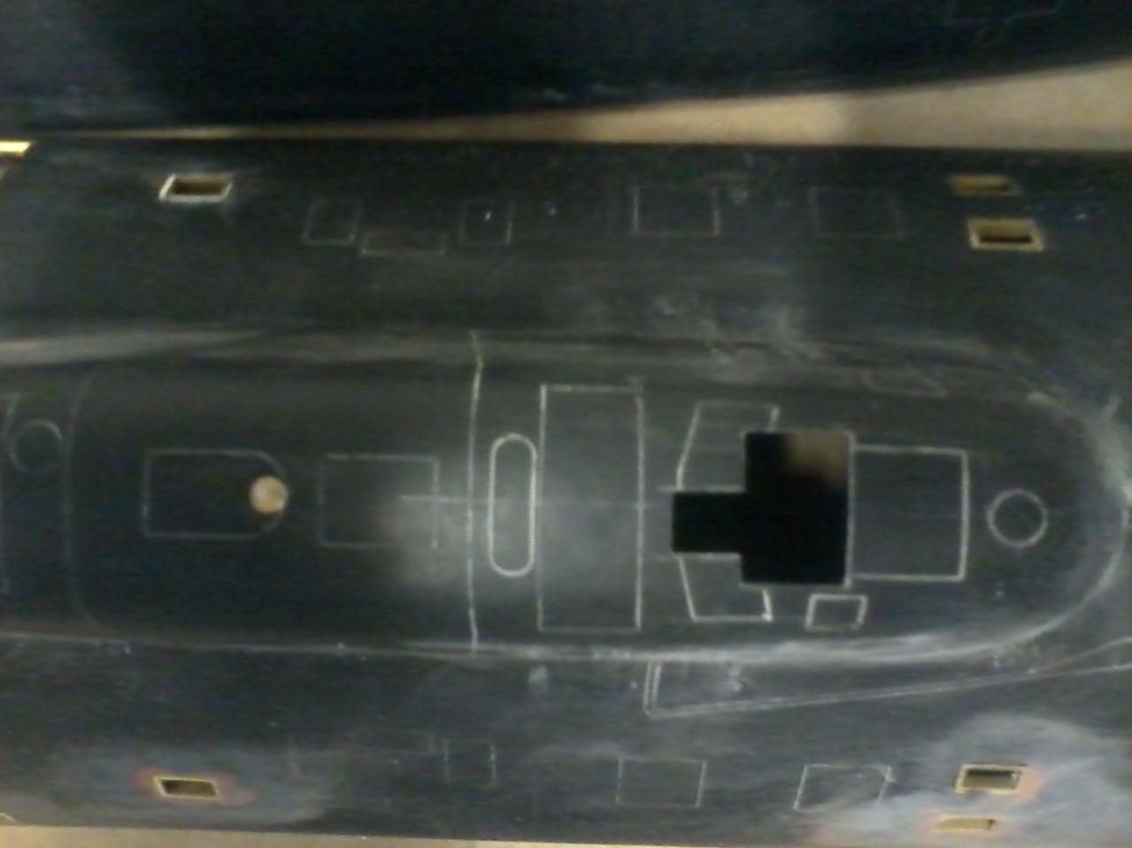

Name:	Akula b 99999996.jpg
ID:	83932Click image for larger version
Name:	Akula b 99999998.jpg
ID:	83934Click image for larger version
Name:	Akula b 99999997.jpg
                        Then I marked and filed the 2 other sections. This started getting hairy, at 1/96 scale the sides of the 2 smaller holes nearest the main hole are thin.

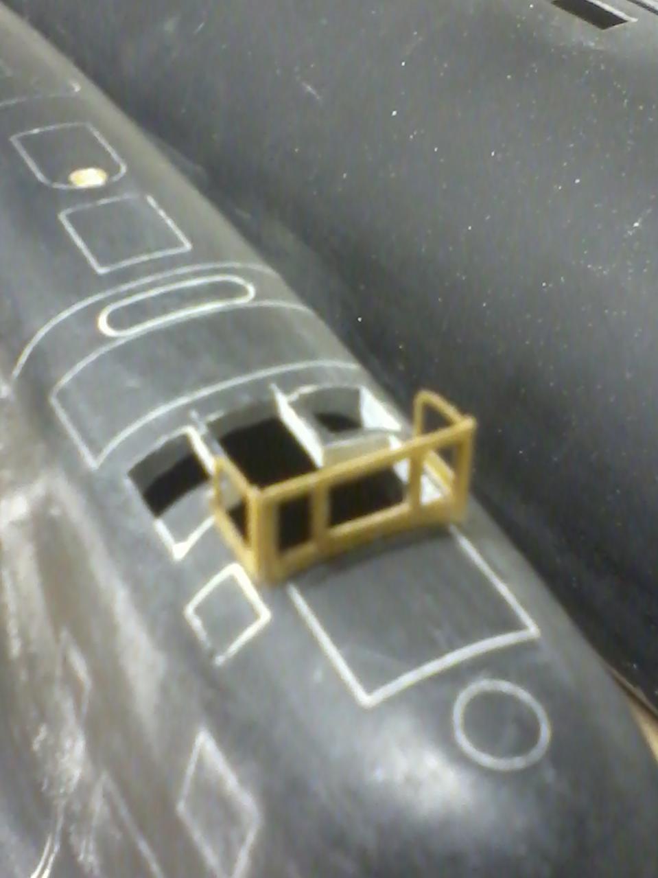

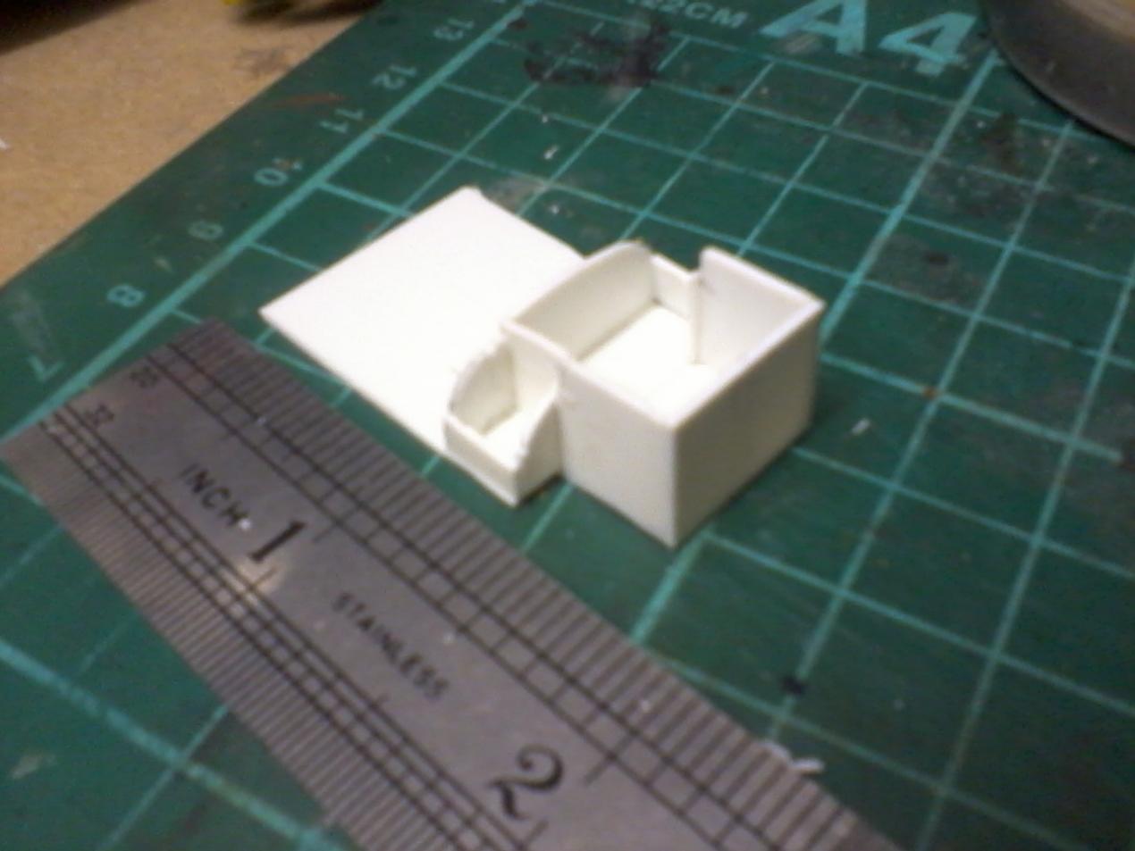

                                OK....all the best laid plans.....

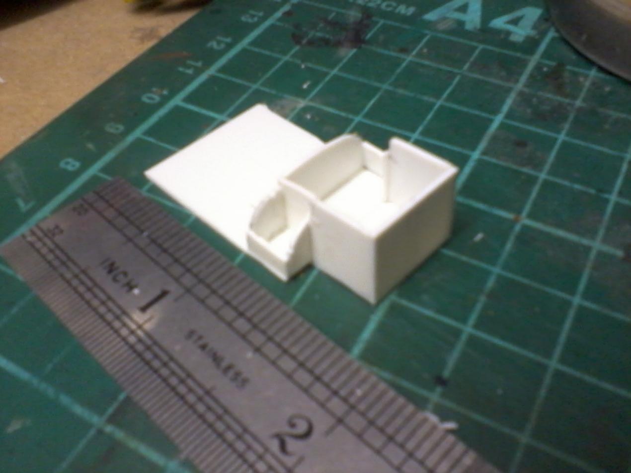

                                After not getting as much done over the weekend because my wife has been a little poorly, I have now finally managed to get a little bit further.
                                The bridge section as I have already said is going to be mostly guesswork thus the reason that the picture shows my 3rd attempt and itself required about 4 hours of work.
Name:	Akula b 999999991.jpg
                                Believe it or not that was a right **** to make as I have to deal with the GRP build up inside the sail so it isn't a uniform shape. The reason for the bigger than required base piece is so that I can run a few scopes through it for stability etc. The bigger job will be building one of these for the rear end of the sail.
