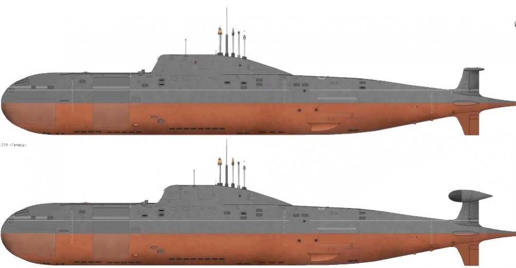

          Hello Mark found this picture shows the difference between the old and the new. The old one looks the same as the Sierra class scoop.

            Now that you mention it................................................ .........................................do you have a picture of a Sierra scoop? You posted one the other day but it doesnt stick out very far. Are we sure its the same one as on the Akula? Take a look if you get a chance.

              Mark, that isn't the reactor scoop, it seems to be a sensor of some sort but google translate doesn't help much on the Russian sites when they start getting technical. I have only seen the scoop for the Sierra in plans but whether those plans were trustworthy I don't know. I think they follow the design of the Typhoon but obviously smaller.

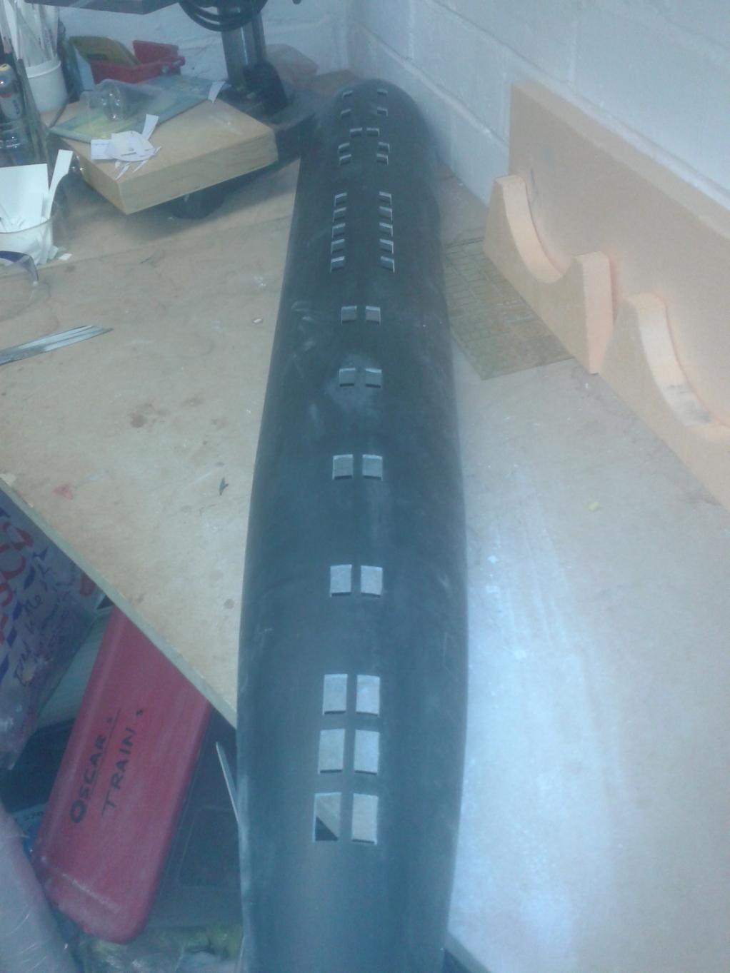

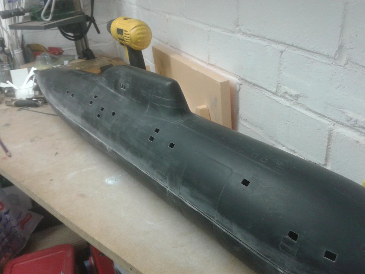

                Hello all me again not done as much as I would have liked this weekend. Hospital, kids and all that but I have managed to finish the holes in the lower hull. Unsure of what to do next. I think I may start opening up the holes in the upper hull next then I can start looking at bracing the hull, a common theme with the Scaleships hulls seems to be slight twisting etc. If I do the holes first I will then know where not to put the bracing. besides I like filing holes, don't know why just do.
                All the holes filed.
Name:	Akula b 97.jpg
                Peter

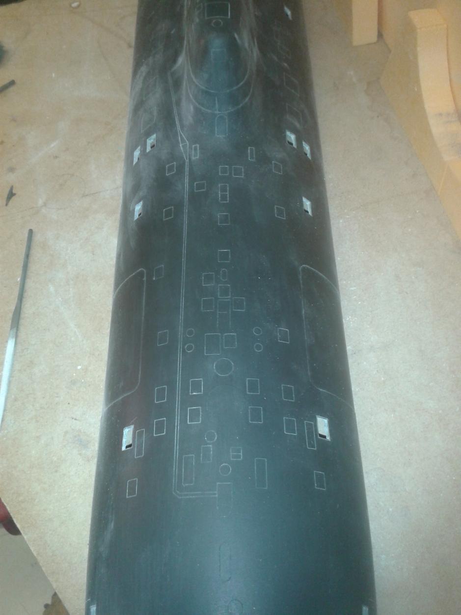

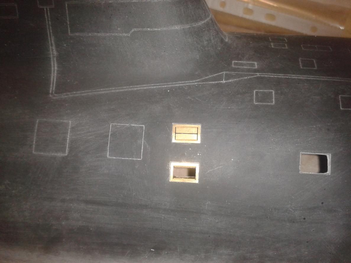

                  We continue,
                  I have now moved on to the upper hull, the holes I am filing out at the moment all have etch fit to them so I am not filing out to the marked line but am stopping just short so as to give the brass something to fix to. I have decided that all the flaps for these holes will be open, I prefer that look.
Name:	Akula b 993.jpg
Name:	Akula b 994.jpg
                  21 down 9 to go.
                  Peter.

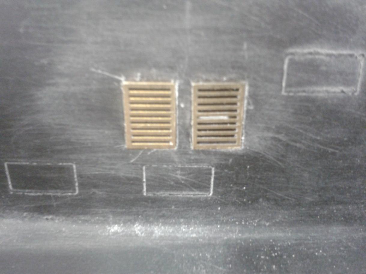

                          This weekend I got a fair bit done for me. 64 holes and counting.
Name:	Akula b 997.jpg
                          After the vent holes were all dealt with I had to have a play with the etch and indulged by having a look to see how pretty they looked.
Name:	Akula b 999.jpg
                          I have decided to have them all open but thought I would show them in both positions.

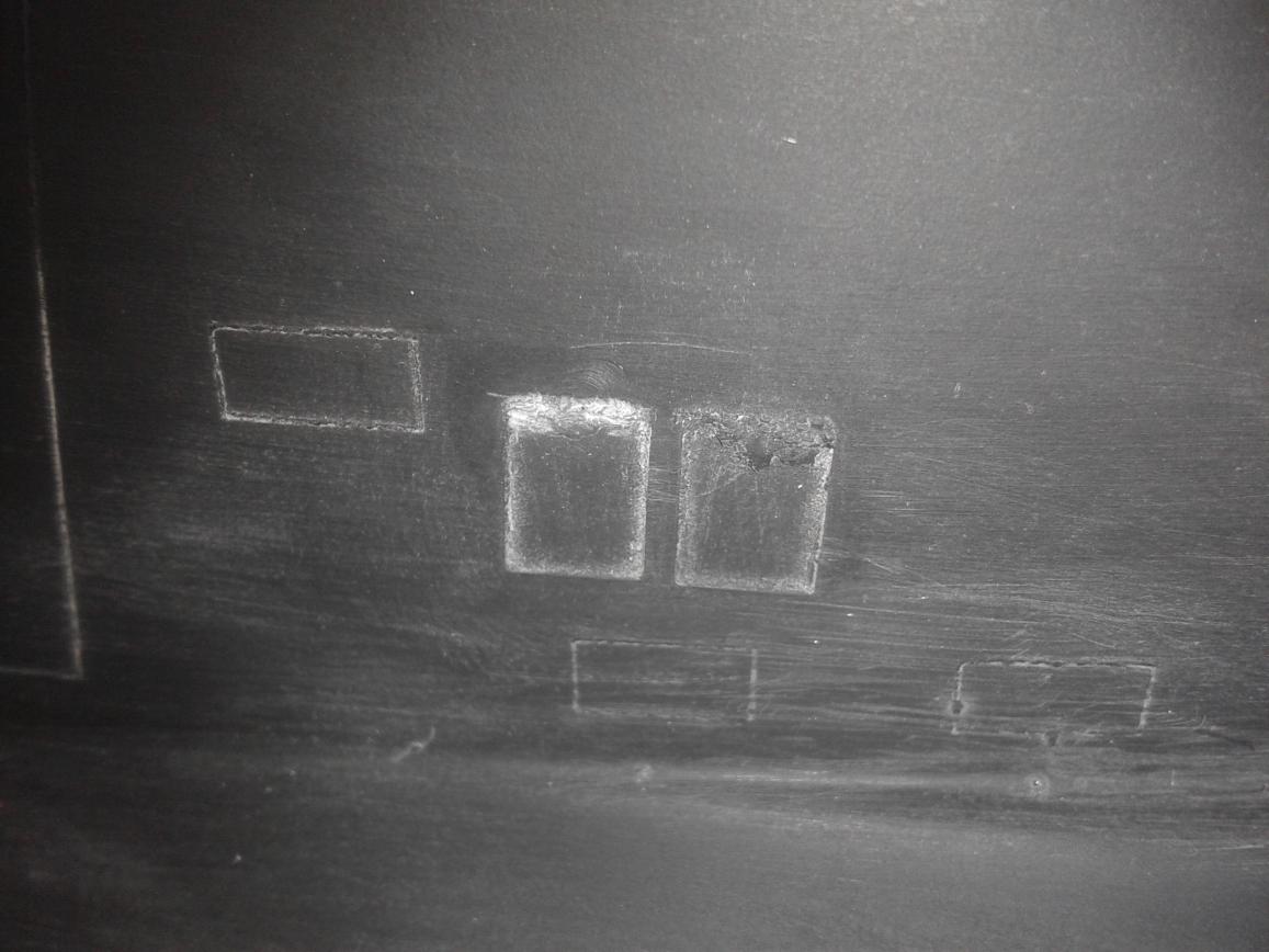

                          Next I moved onto the 4 vents on the sides of the sail. SIDENOTE, although this is a stunning model and I am really happy with it there are 1 or 2 little issues with it. Here is 1 of them.
Name:	Akula b 991.jpg
                          As you can see there is a slight resin deposit on the said indents. The indent on the right is as it came, the one on the left is after I grew a pair and went at it, freehand, with a diamond burr. This side wasn't too bad to deal with but the other side bore the full amount of my extensive foul language. Ultimately however, I eventually got the desired result.
Name:	Akula b 995.jpg
                          I am now faced with more vent holes with etched parts along the top of the hull but these ones have no indented marks to help so I expect more foul language, it is good that I have an extensive vocabulary in swearing or it could get boring. I do have a reasonably good idea of how I am going to do it though.

                            Are the parts you need to indent the same size? If so couldn't you make a fence out of some scrap metal, that should speed thinks up a bit. The boats I've seen converted have used 100mm diameter acrylic pipe, in an effort to keep the cylinder below the waterline and minimise displacement.

                              Andy, the fence is a good idea the only problem I face is the vents I now need to do are nearly all marked but the marks aren't recessed so getting the brass flush is going to be harder. ( recessed is probably a better word than indented, sorry)
                              I was thinking 100mm pipe. I do have 3m of 80mm pipe aswell ( long, long story) but haven't really thought too hard about that bit yet.
