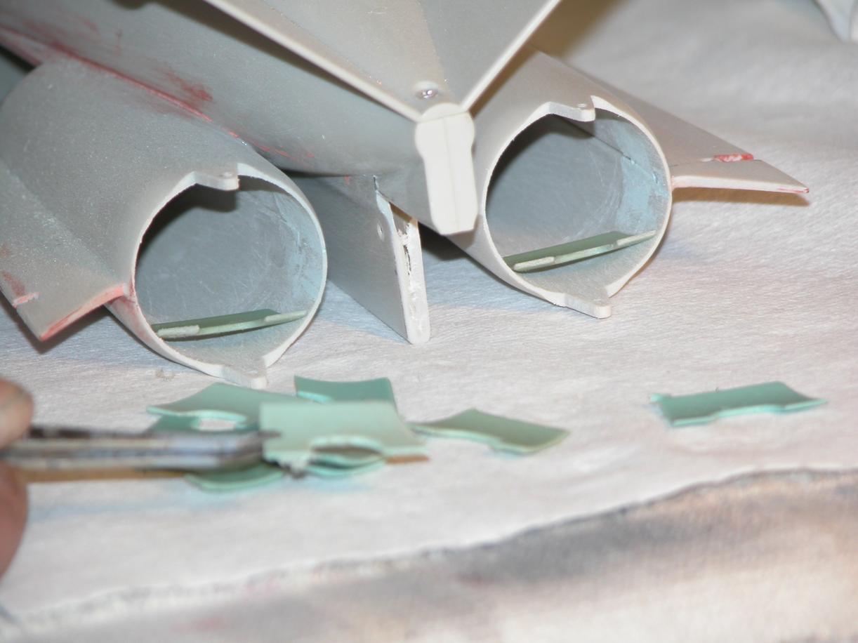

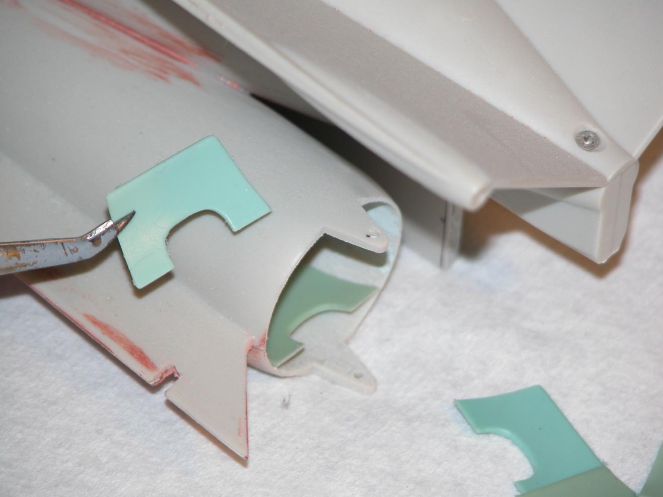

            Here it is....and it snaps together with a perfect fit. This is going to be one nice RC Sub.
