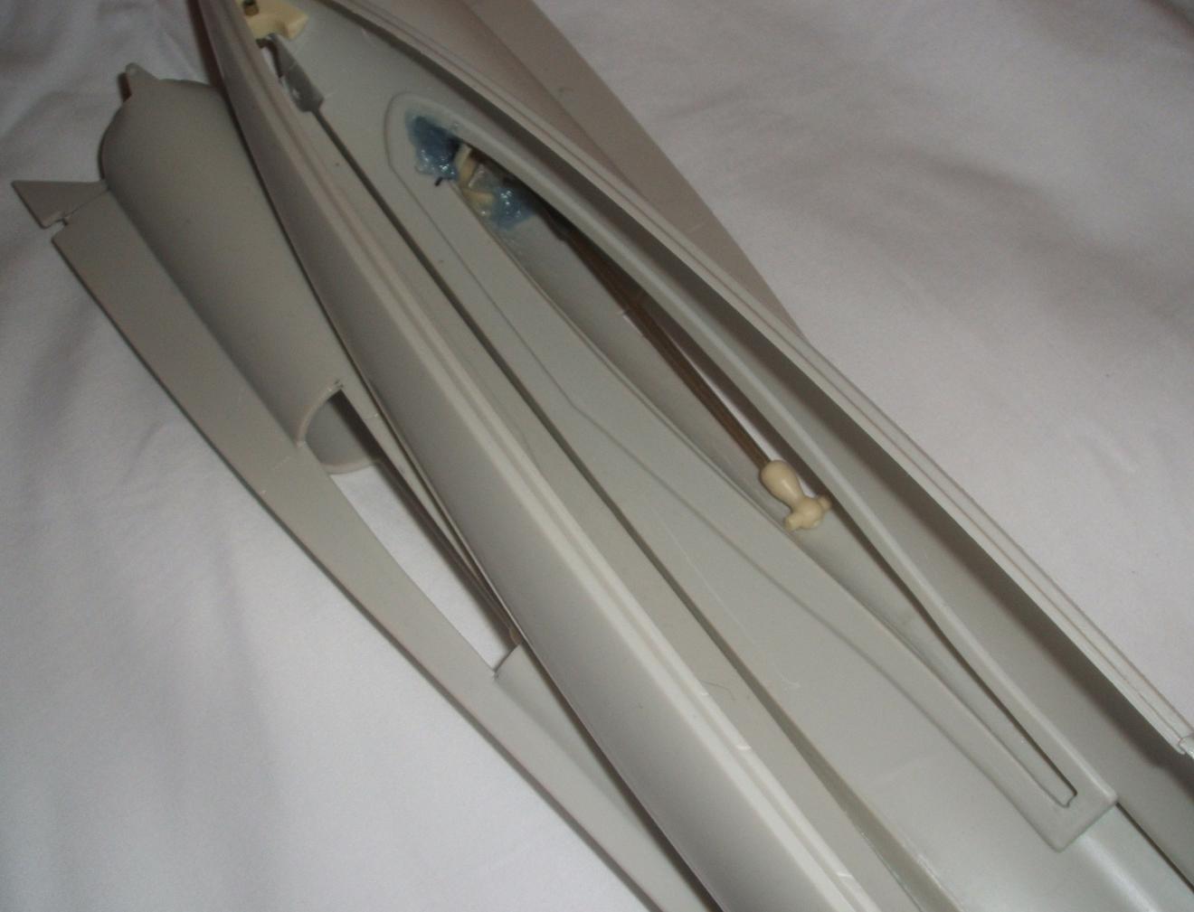

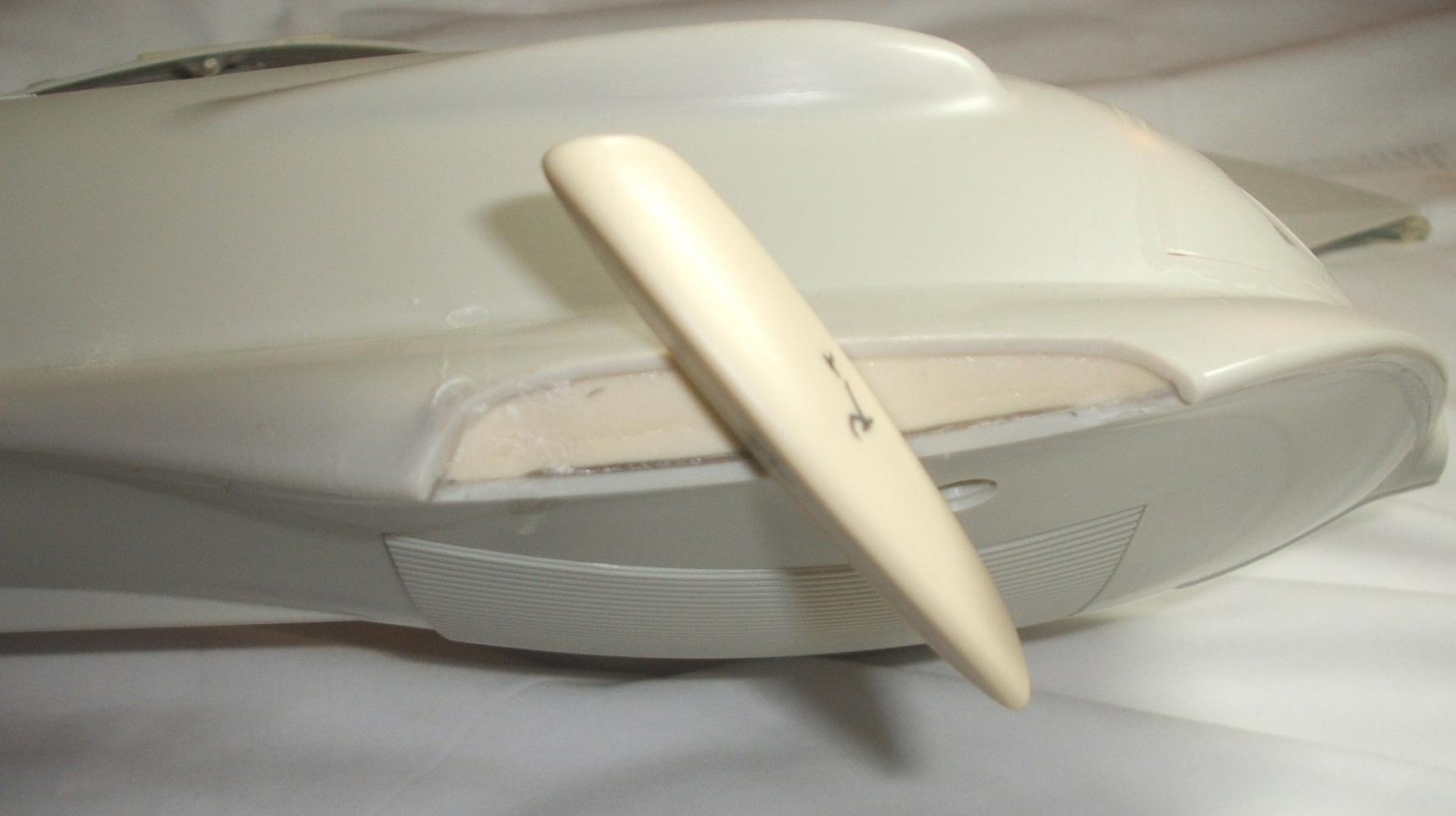

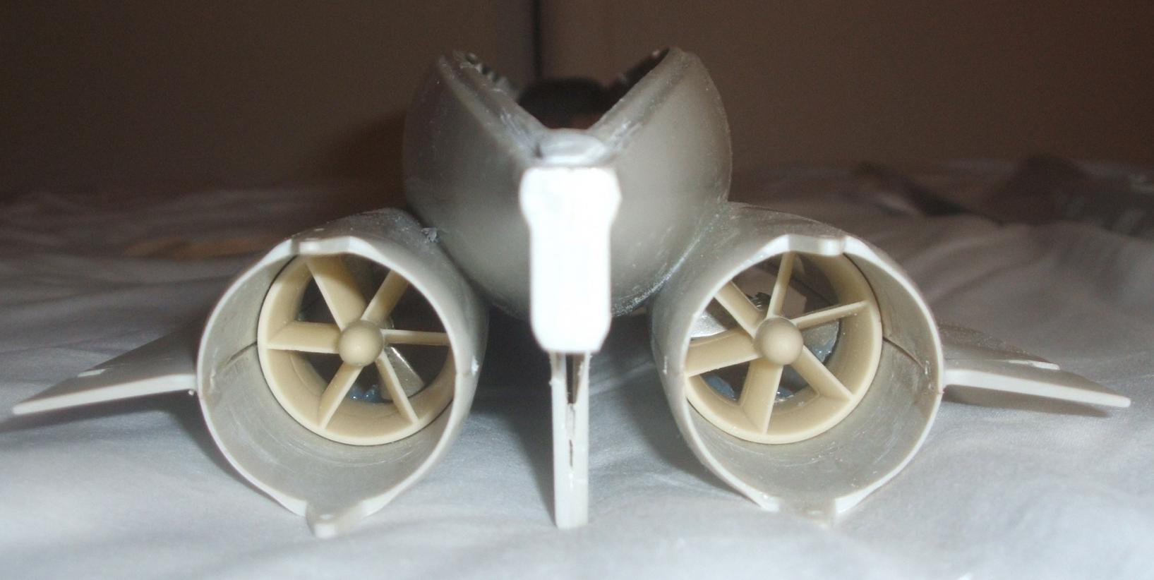

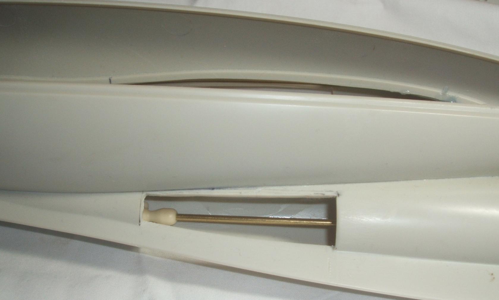

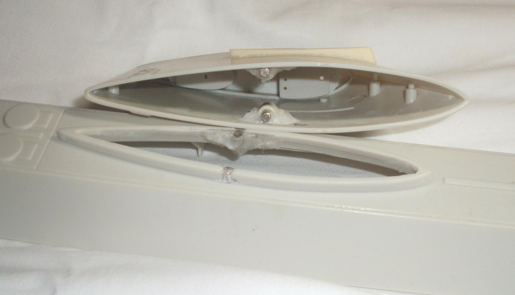

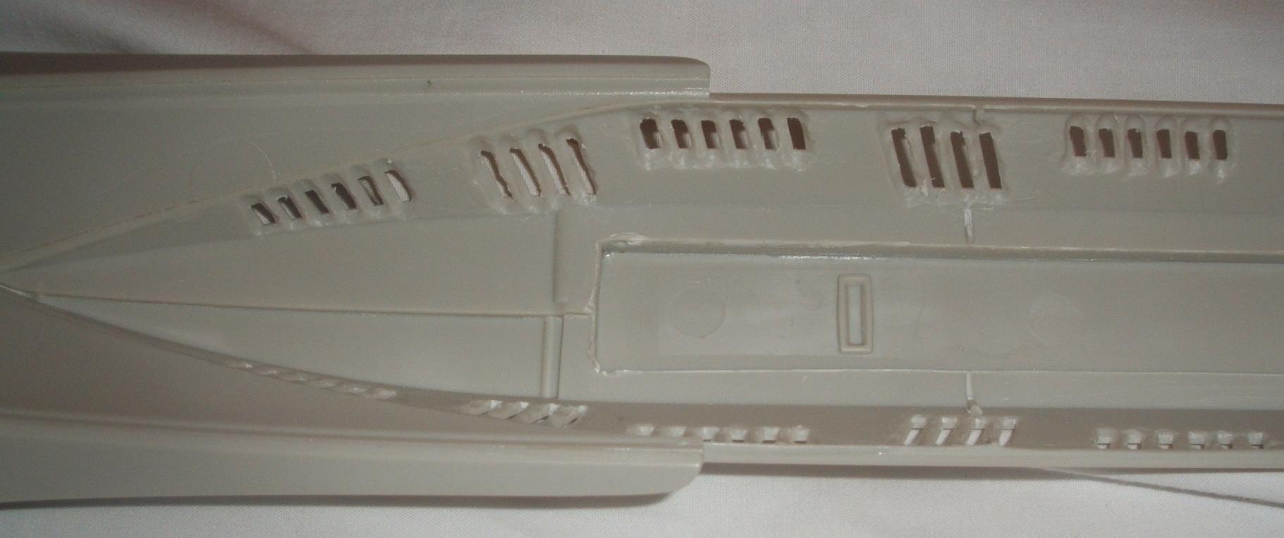

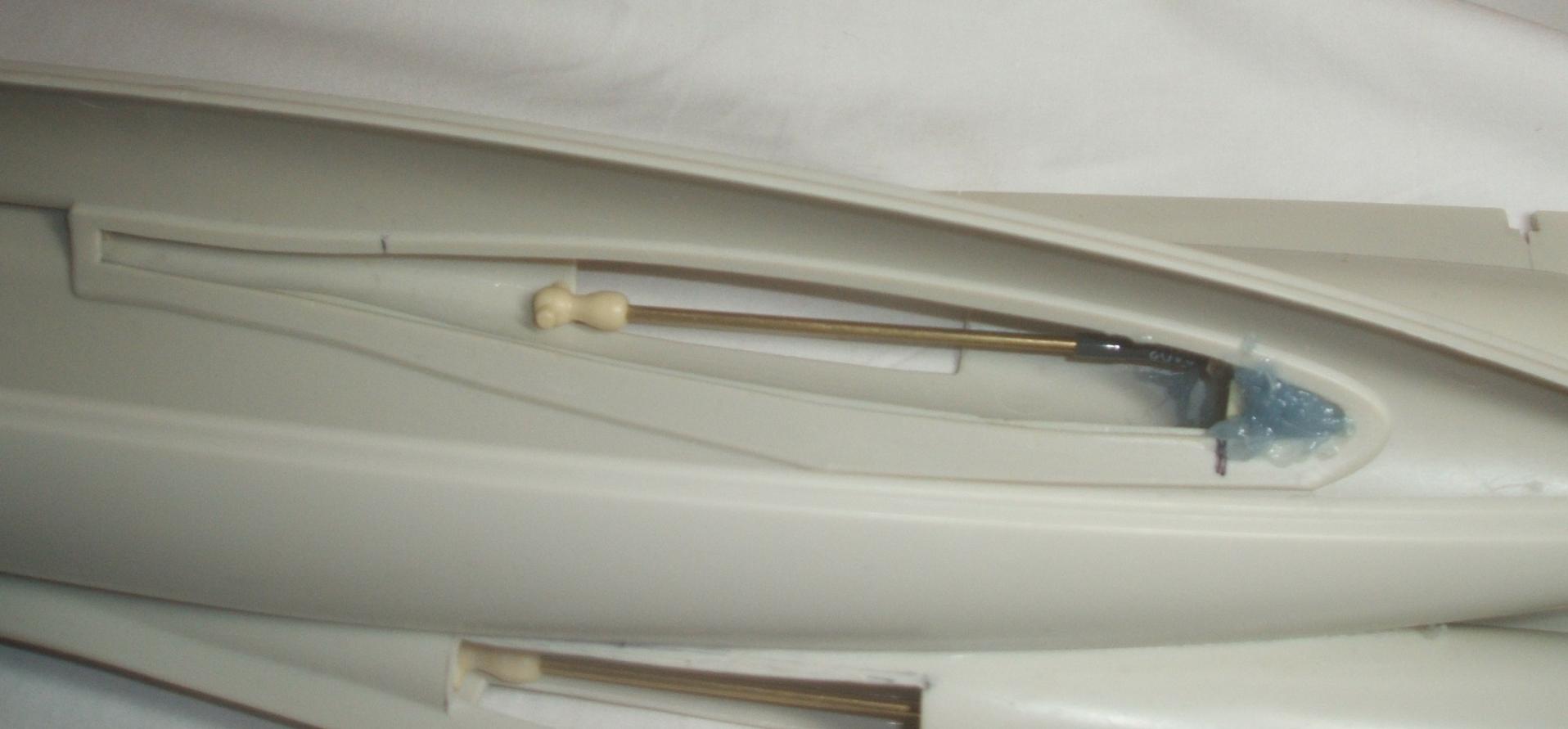

      Here's some pictures of my Seaview build. This is my first sub model..be kind;)

        I have read that the vents can be done with a dremel from the inside for a small portion, then to take a file to the rest.
        I have no idea if thats correct. My dremel is not variable speed...will I need or use this in this build?
        Also I believe I need a dremel drill press unit< correct?
        I am waiting for the DVD and Fittings kit to start.
        I can order that next week.
        But tell me, how do you scribe and cut the superstructure and manta bow fins?
        Real nice work by the way!
        I am more confident....great work for a first time.

          Looking good, Steve. Nothing to be ashamed of there. Tell the class how terrible/easy it was to separate the superstructure from the rest of the hull, please.

            You simply have to have a low-speed capable Moto-tool, Dean. No getting around it. You go into the work high speed and you'll instantly find a molten mass of plastic twisted around your wrist! And that tool, and the proper bit, is the only way to grind out the inside of the limber holes. The DVD will walk you through it.
            You don't need a drill press for this model assembly (but one is always nice to have).
            As you don't 'save' the bow planes (actually, just the tips of the manta-fins, identified with engraved lines), you simply grind them away with the Moto-Tool. The fittings kit contains a set of practical bow planes ... check out what Steve's done so far and you'll see what I mean.

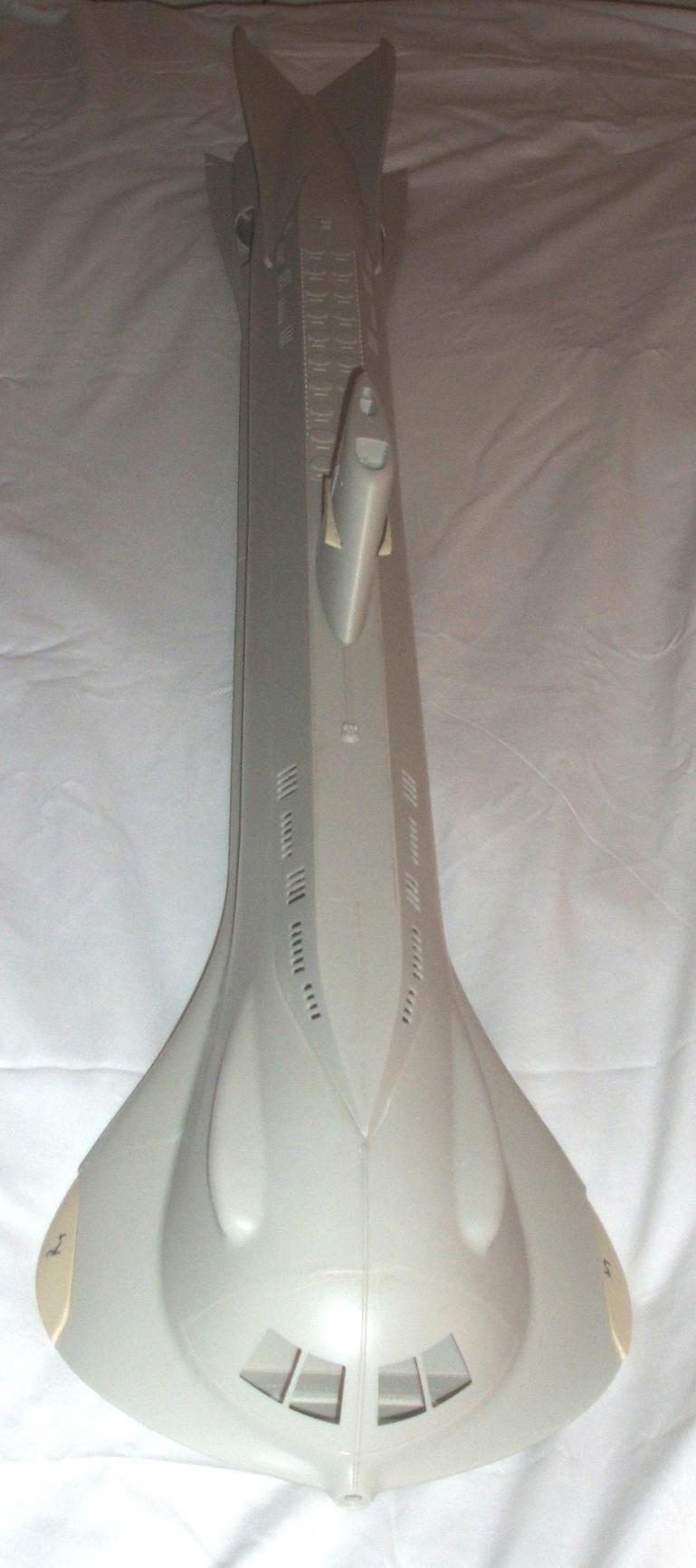

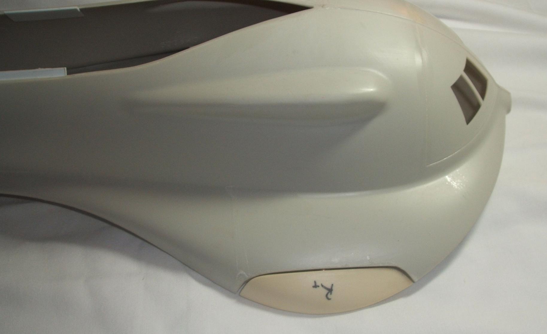

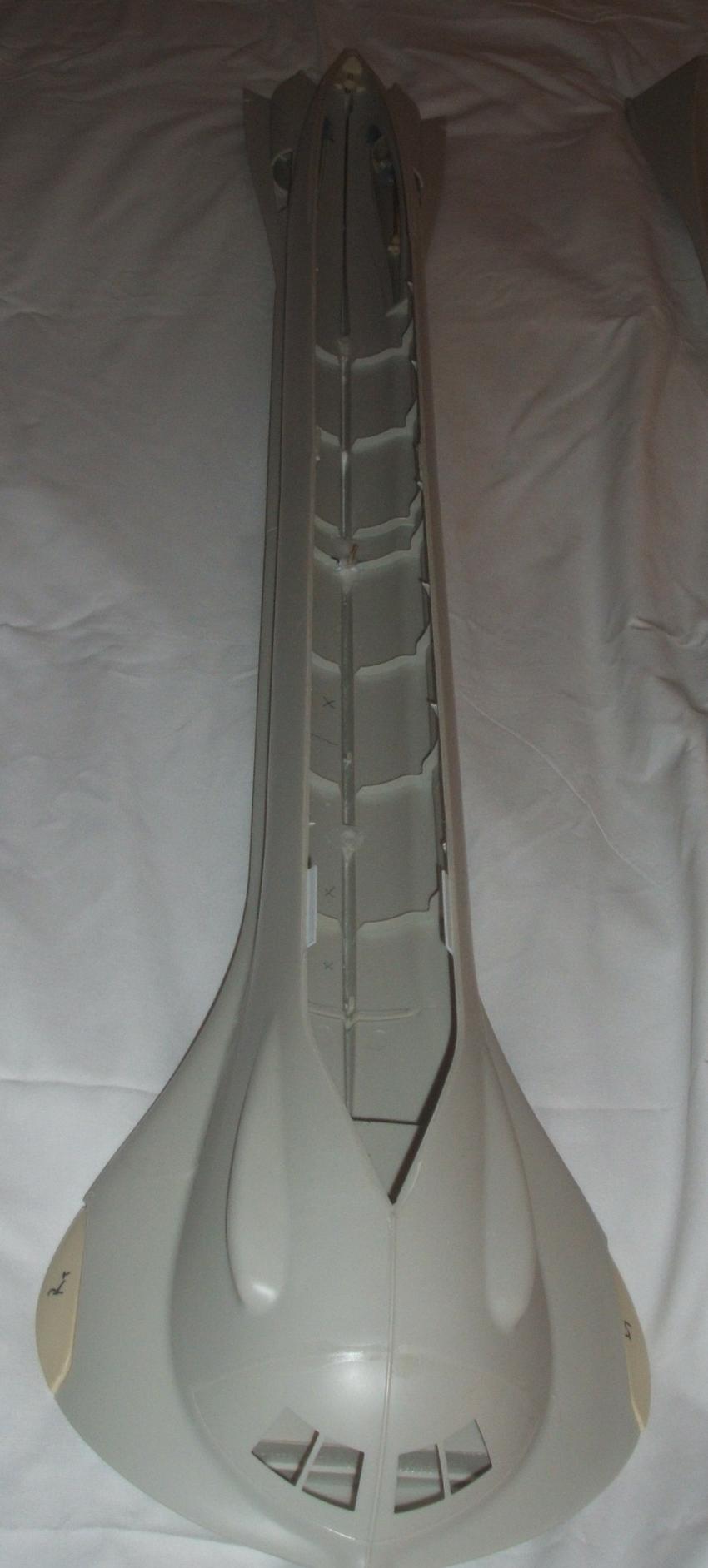

                Here are a few more pics
                Thanks for the compliment. Its been a slow build with work and kids..... The scribe lines for the bow planes are there already as are the lines for the vents. Daves DVD shows you step by step how to "open her up". I review it many times before I start a new section. If your still unsure of something ask, Dave and others are there to help. Just take your time and remeber.."measure twice cut once".
                Stephen

                  The superstructure was easier to do than I thought. DONT rush, it is a time consuming procedure. Im not saying mine came out perfect but I am happy with the results.
                  Stephen
