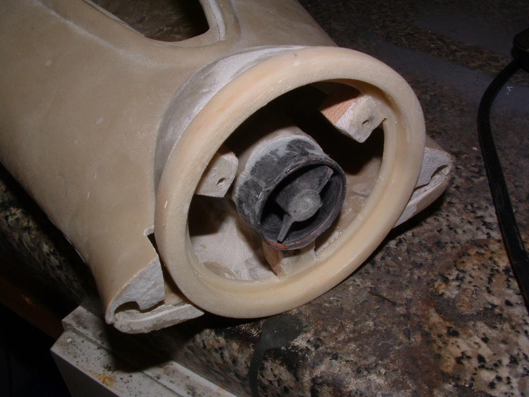

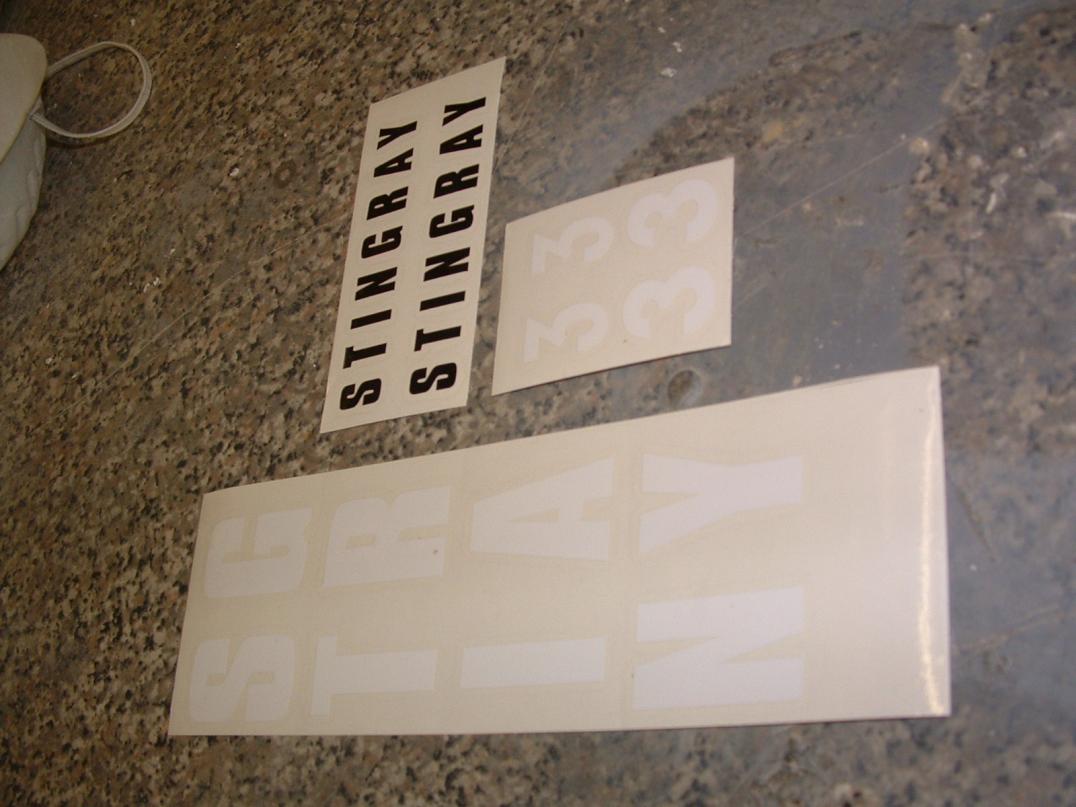

    Got the decals done and I added the tail fin to see if I could get the Ratemaster assembly in and out without it fouling the back of the tail. And its fine. All servicable.:biggrin:
    David, I'm waiting for some Lazer cut parts and then I will send out the pack for your perusal.
