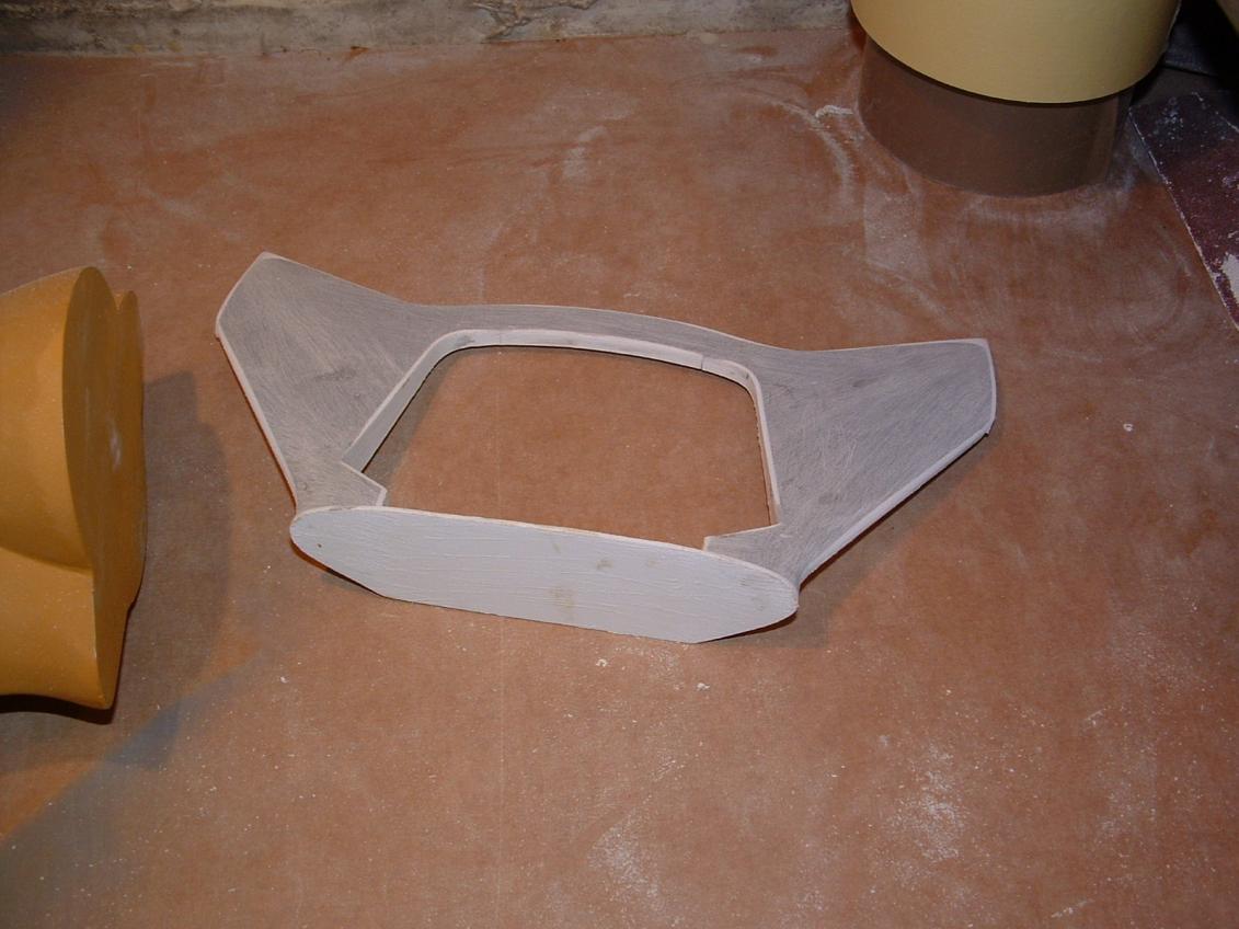

    Today I did the fins and the conning tower, all need finishing off. tommorow I will do the periscope head and might start on the dreaded ratemaster.

    Lol, again thanks David. I have been around for a few years but never really put myself in the forefront, Happy to keep a low profile lol. As for my method of building, My fave uncle (No longer with us) used to say. "You visualise something and then it springs from your hands". I guess thats got to be true. Oh plus the fact I'm not a patient guy so I try to work fast. I definitely like to throw it at the wall, lol.

    Your trick of establishing the inner and outer contour points on the stern is an example of simple, functional, lay-out work. You make use of rigid materials (the plastic card) for the basic structure, and leave it to the formable filler to fill in the blanks. The basic means of dictating final form of tapers and compound curves to a complicated sub-assembly. Even using the existing stern as a guide. No flubbing around; no mis-steps; and FAST.
    You strike me as being both an intuitive throw-it-at-the-wall-and-see-what-sticks sort of guy; but also one well versed in the disciplines of pattern making (plan interpretation, lay-out, materials selection and use).
    Who the hell are you, and where have you been hiding all these decades?!....

    Thanks David. Done a bit more, Cabin Primered but still needs fine work done and tail mated to the back end.

    Made a start on the cabin and tail section yesterday and will finish them up this afternoon. Same method on the cabin as the main hull but I'm using plastic bumper (fender) filler on the tail. It retains a greater degree of flexibility when set.
