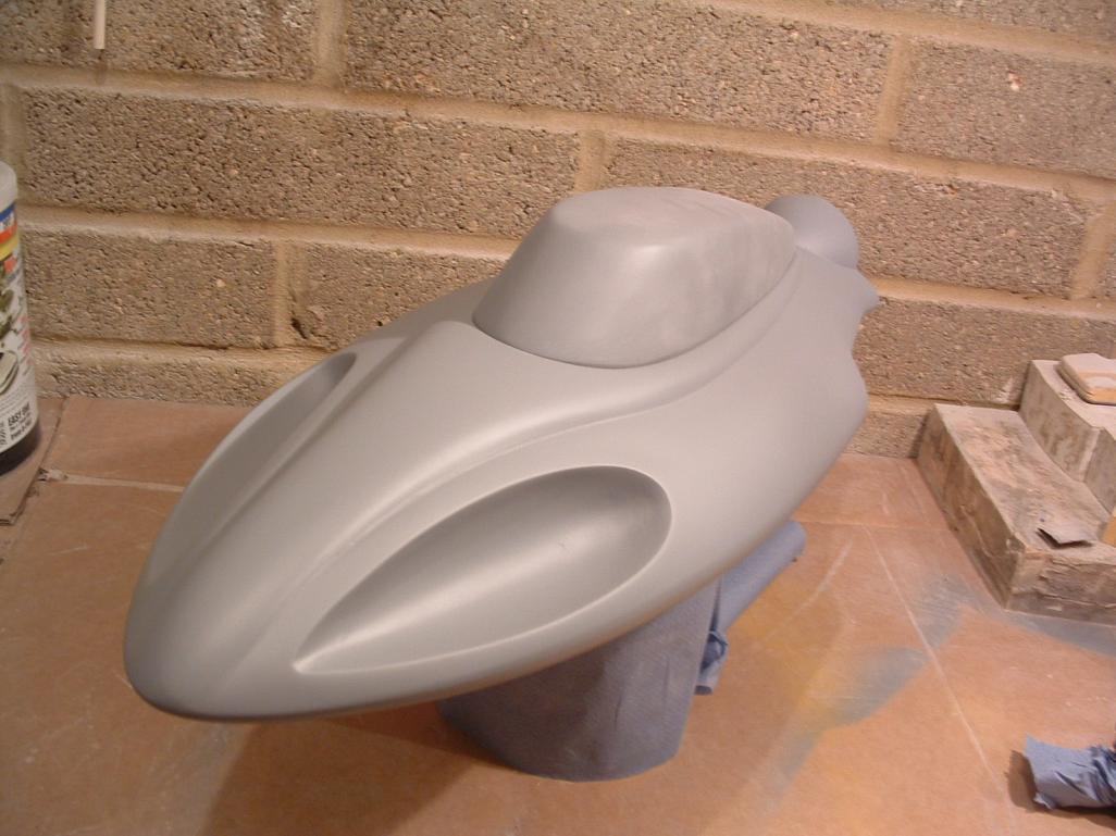

    Well I had a quiet day yesterday, It was my good ladys Birthday so I was busy doing other things. However I'm plesed to say that Its 99.9% done and within a 4 week period, a personal best for this size model. As you can see (just) the windows and ports are all "recessed" and the rear clear ratemaster star is done, needs a touch of cleaning up but there you are. Moulds to follow with an intended release (No pun intended) for the end of July.

    Very nice. I see you use all the same materials I do too- Upol filler, Halfrauds primers and 3M acryl red putty. Spooky!
    Are you going to mould the hull in three parts, top bottom and cabin. Or will the cabin be vac-formed in clear plastic?
    At the moment my plan is to mould the cabin in the same stuff as the main hull. It will have all the window detail on it so the builder will have to cut them out and add glass, or I may make up another bigger vac former and do it in plastic for the static modelers. Not sure yet.

    A work of art! Hey, is that blue toilet paper? Ive never seen blue toilet paper before.
    Loooool if only you knew.

    Well thats it now, Main hull done, I adjusted the side outlets and smoothed out the bottom of the hull. A few details to add and I think thats it.
