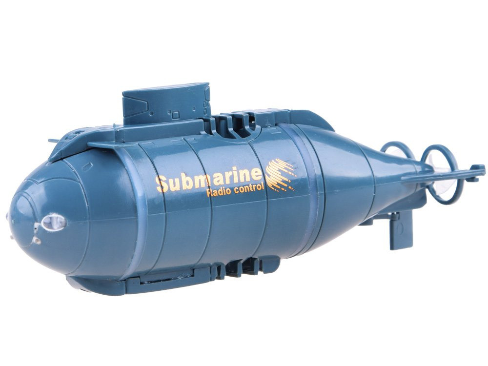

    I bought one of these toy R/C submarines and had some fun running it around the test tank. It has a piston system for ballast control and a stern thruster to turn. While it functions reasonably well, it was too short and tended to dart in random directions.

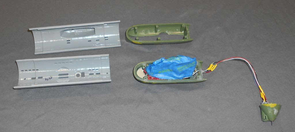

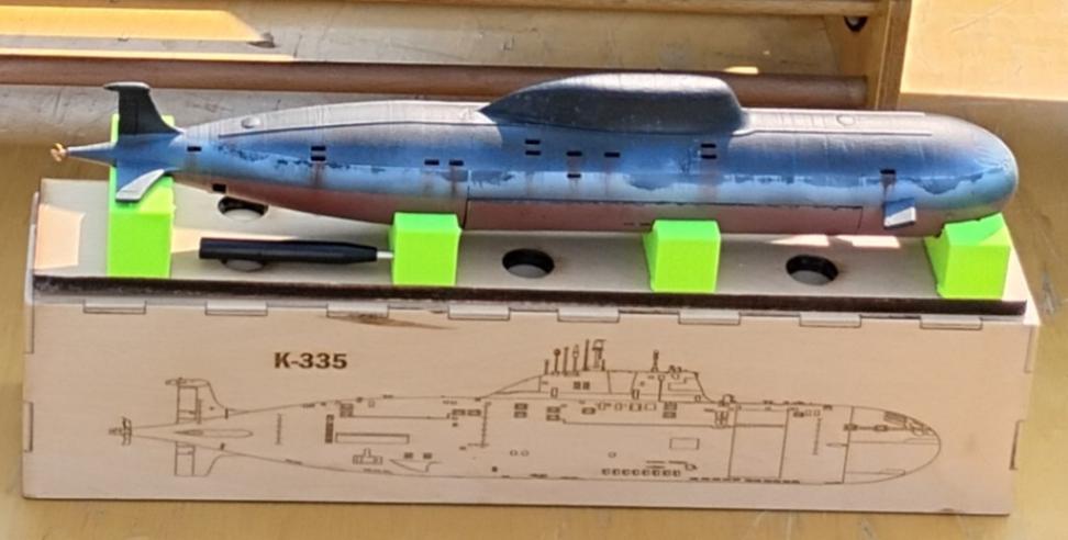

    I disassembled it to see if I could take the R/C components and put them in a larger submarine. Eventually I decided to try it with an Akula III. After a bit of CAD and print tests, I ended up with the following conversion:
Name:	Finished Akula.jpg
    The submarine runs nicely and looks great underwater.

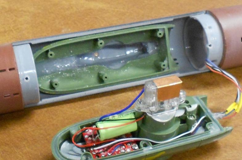

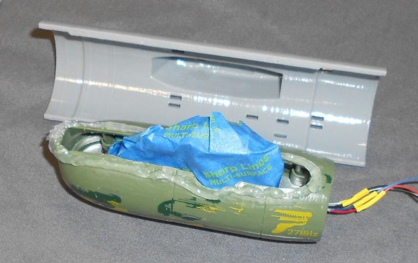

      You can see from the pictures above basically how I cut up the original toy and glued it into the new hull. The weights from the stern section were removed.

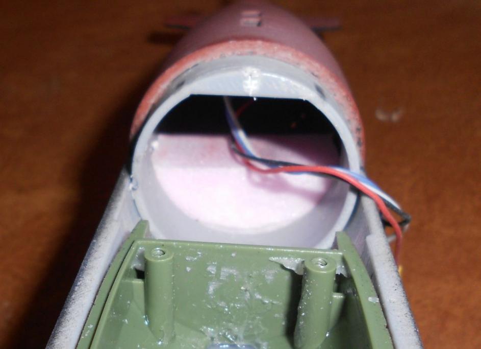

      The top was glued with silicone, first with a light bead around the top opening. Then once tacked in place I slathered more silicone on the inside to make it waterproof.

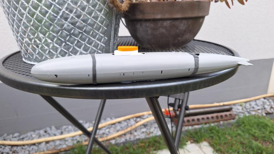

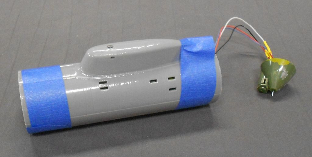

      The bottom keys into the toy, so to make sure everything stays aligned I taped them together.

      You can also see there are three holes in the sail so you can see the "on" LED in the toy. These need to be filled with clear resin. I ended up painting over the side holes and just use the top hole.

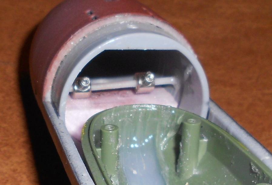

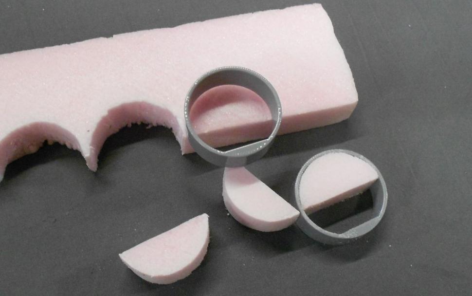

      Foam was cut to improve buoyancy. I found two of these 1/2 round foam pucks was enough - one forward and one in the stern.

      A piece of nylon tubing was glued into the hull to hold the forward planes. The wheel collars allow adjustment and removal of the planes. The tubing is the outer sleeve from some airplane push rods that I had. This is the closest thing I found on Amazon: https://www.amazon.com/Feelers-Teflo.../dp/B08S3MTRQG . The same tubing was also used to make a bearing for the prop shaft.
      The prop shaft was extended using some 1/32 music wire. It is connected to the motor with some 0.5mm x 2mm silicone tubing.

        A note on the center STL file.The longitudinal surface where the two pieces touch has a little extra material. This allows you to sand down the surface and get rid of the rounded corners that the 3D printer makes.

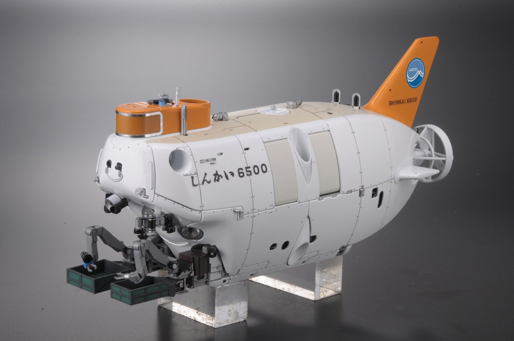

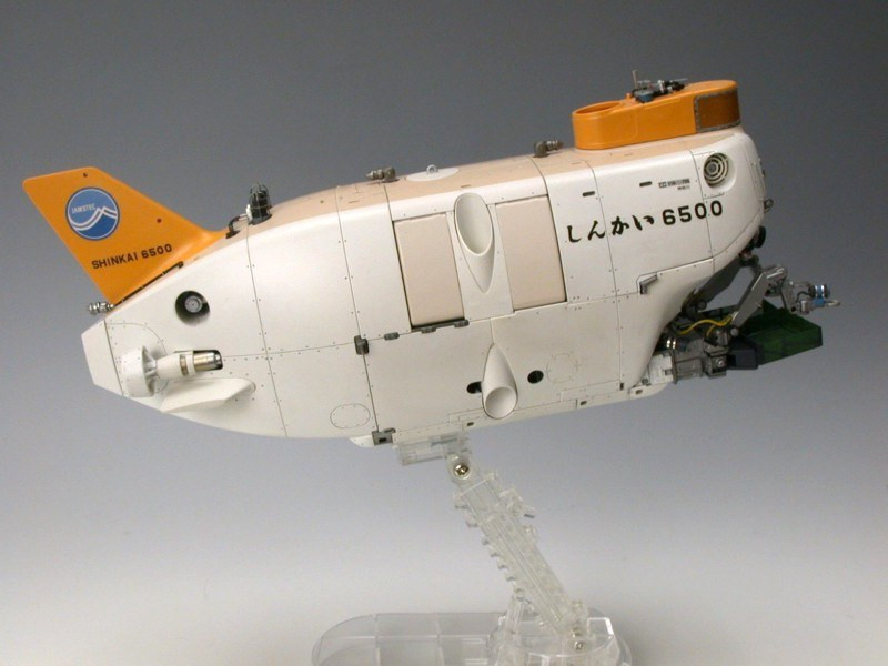

              May try it with my 1/48 Shinkai 6500 research sub

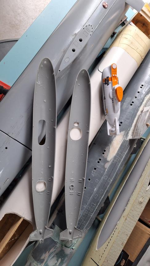

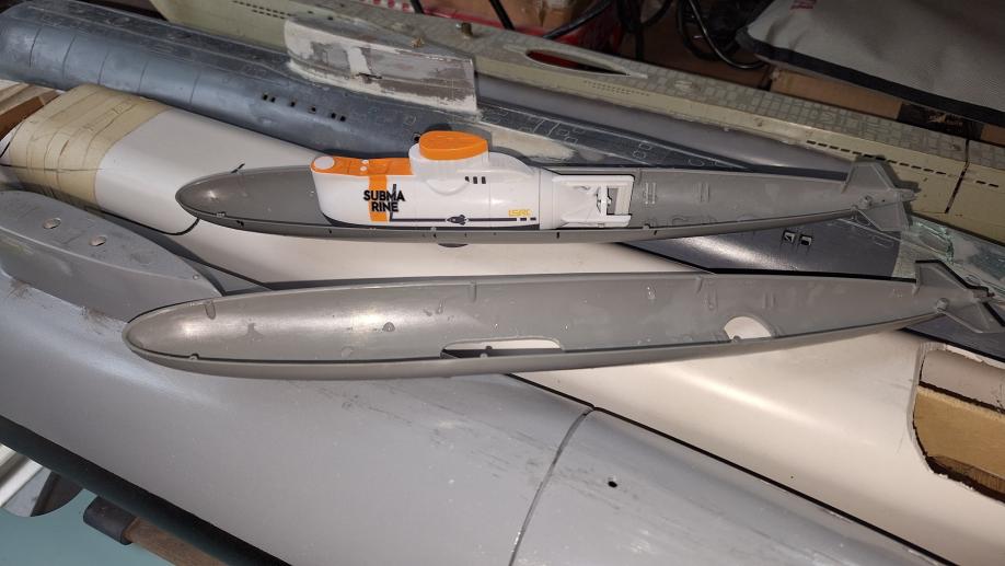

                Revell/Aurora 1/230 Skipjack. LET'S ALFA THAT THING!

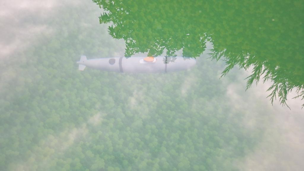

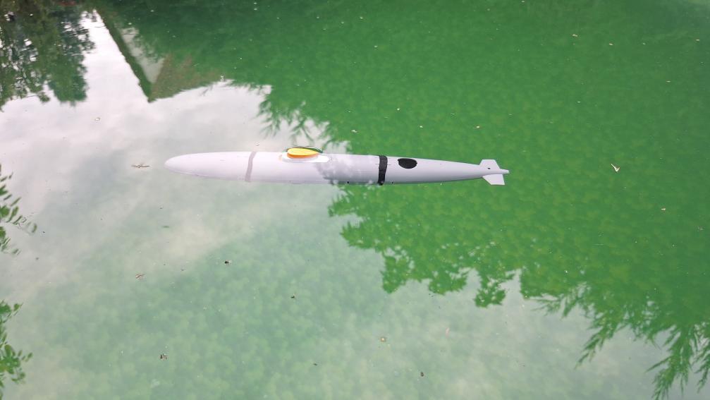

                  Testing!

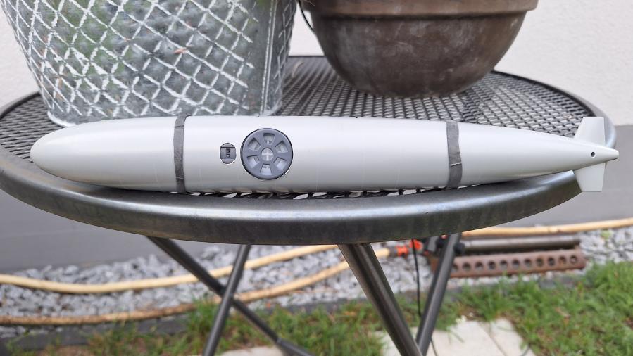

                  Hope you're fine with me posting this, but it's the same subject, different approach. If not, just tell me and i'll move it!
                  One question befor i cut open the stern:
                  Is the engine/thruster piece a single compartment seperate from the main watertight hull or is it a sealed part of the watertight hull?
                  New shaft, a sail and proper planes and rudders and K-123 is good to go!
                  What a fun that tiny sub is!!!
                  Jörg
                      Jörg
                      The stern is a separate compartment from the main watertight hull. It just unbolts from the front part. The holes from the 4 wires are the only penetrations and they are sealed with silicone.
                      That conversion is looking great! It's nice that with the larger scale you don't have to cut down the toy to fit it inside.

                        Sold! If you bring it to Subfest I'll buy it.
                        I would also just love to see it run.

                          Another thought on the Alpha conversion... It looks like it submerged nicely with the toy in one piece. So do you even need to separate the stern section? You could just run a longer prop shaft extension.
                          • JHapprich
                            • Oct 2017
                            • 1121
                            My thought, too BUT i need the thruster for steering at the stern. Thought about using pipes to control the flow, but i doubt it will be sufficient.
