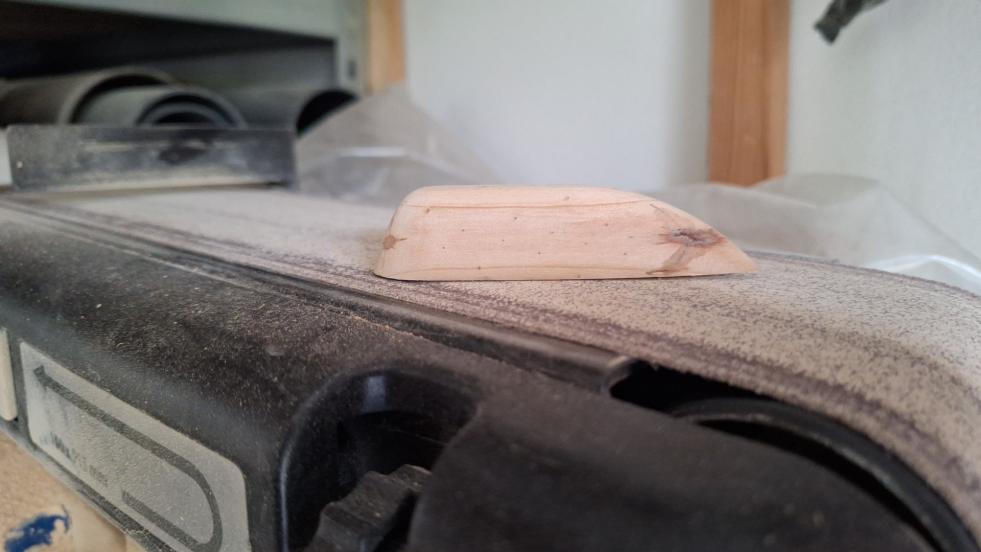

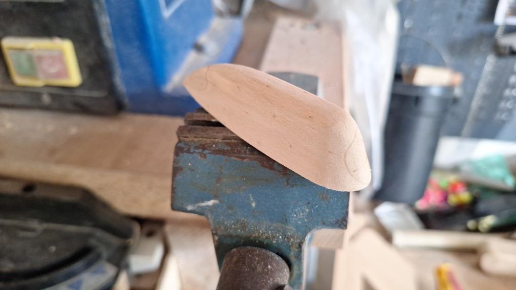

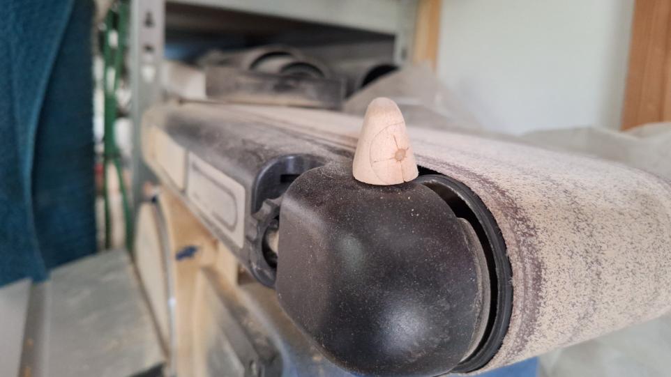

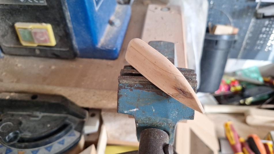

    Yesterday, i made a proper ALFA sail. I ground a wooden block to shape to act as a plug. I then softened 1mm ABS sheet with a heat gun and quickly pushed it down onto that plug. The opening of the upper hull was enlarged following the outline of the sail and the part was weld-glued. A bit of filling and sanding will complete the task!
    Plug:

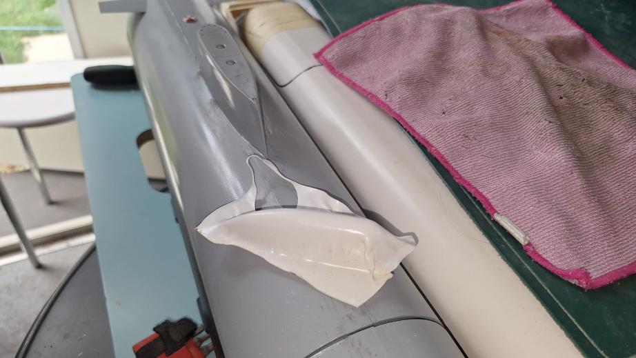

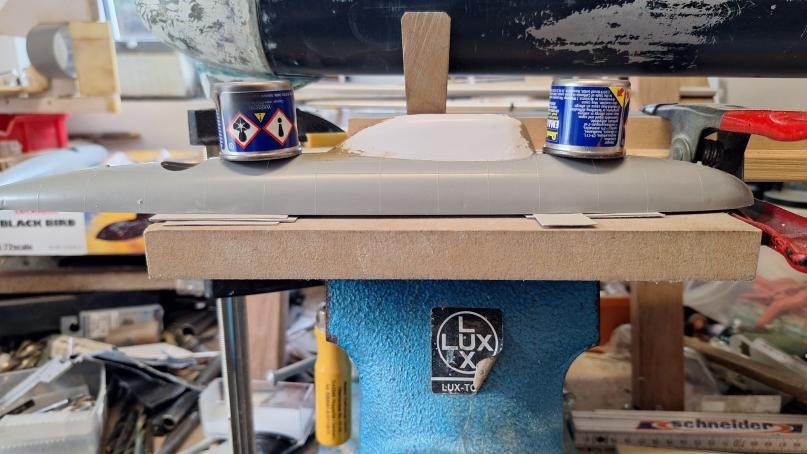

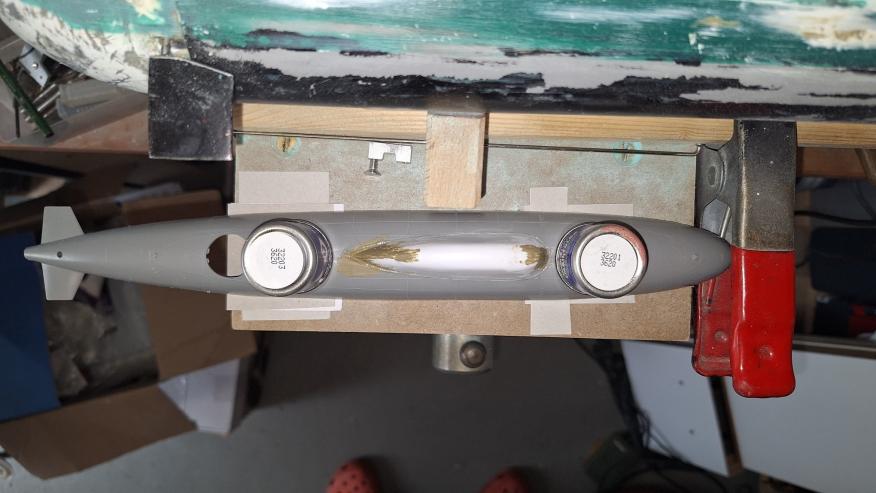

      The styrene sail:

      The first attemp was not succesful :-(

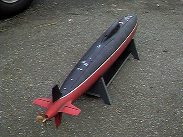

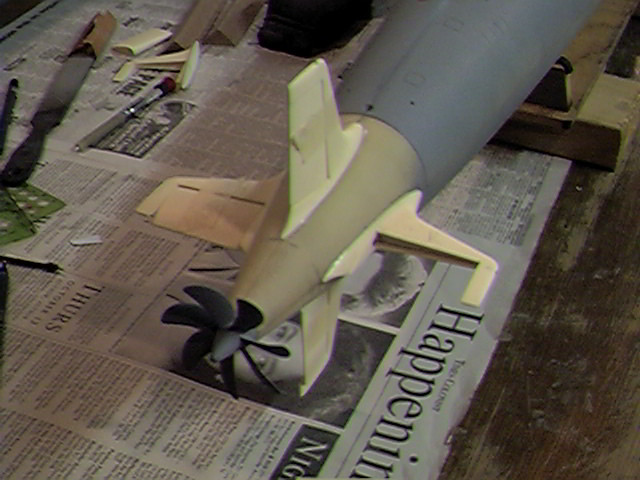

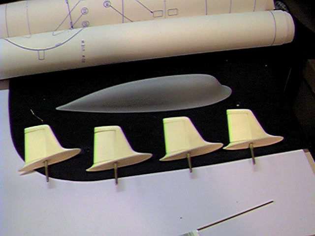

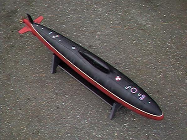

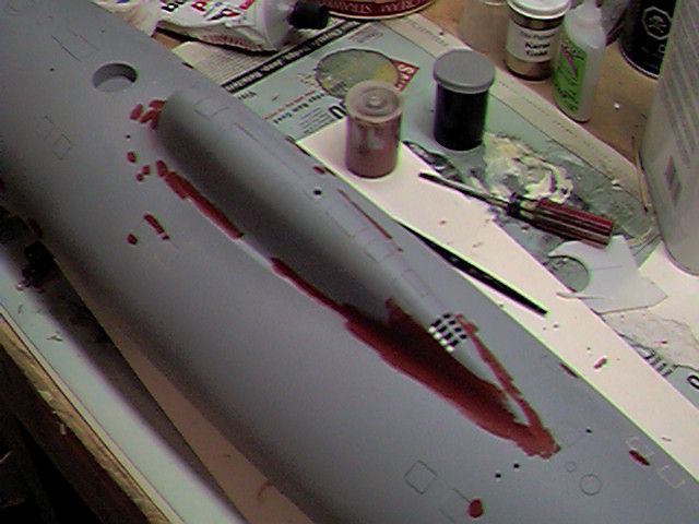

        The Alfa has a rounder bow than the Skipjack. Since you're using the Skipjack as your base this is more of a Project 1710 Makrel or Beluga class.
        Greg Sharpe once made a Beluga using a 1/96 D&E Skipjack hull with scratchbuilt sail and appendages.
