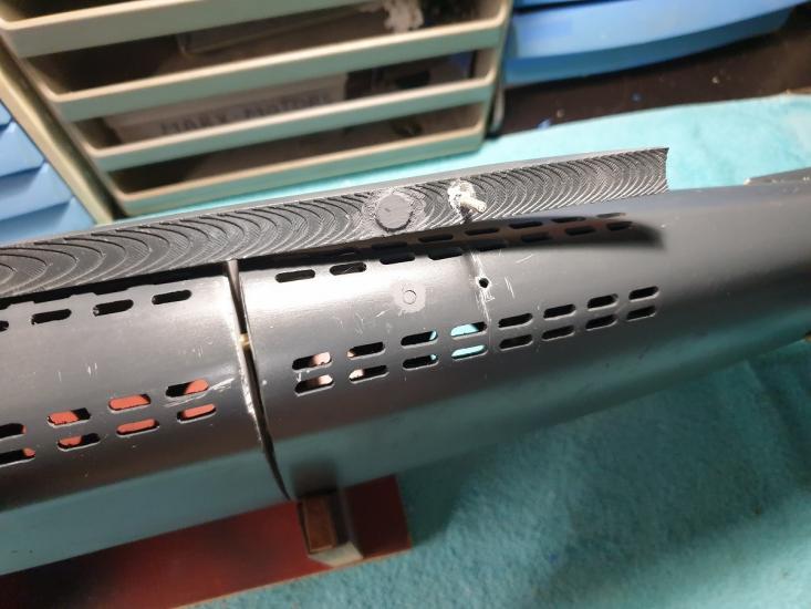

          First issue on the bench, that keel component was a bit loose, i discovered this in germany, probaly due to the warm weather during those days, added some magnets in the rear as wel at the front, this way it will be better connected, the pulling force will not be that great, so keeping it at it's place is good enough.
