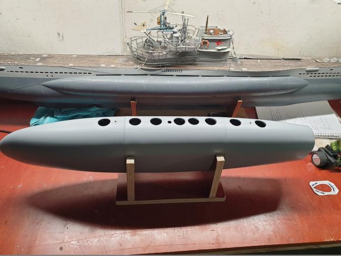

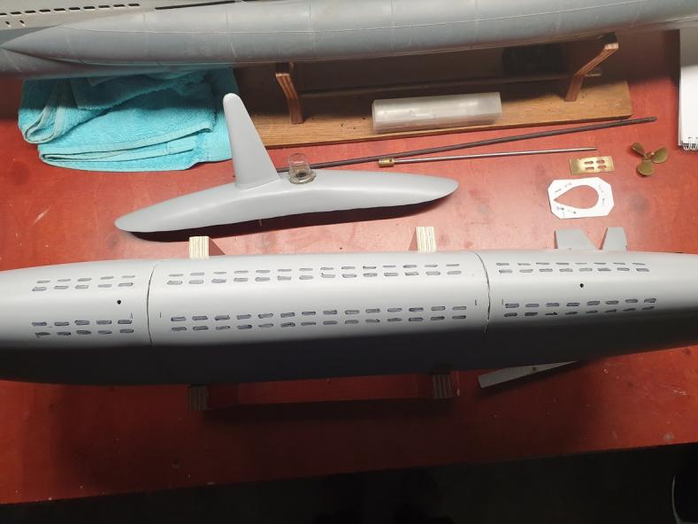

    This was a bit of a effort, two times sprayputty, two times primer, and a lot of sanding, only advantage was, i could spray the putty in one attempt, sanded everything off and another layer of putty in one attempt, getting the primer on was a piece of cake,
    Click image for larger version  Name:	20250727_154237.jpg Views:	0 Size:	42.2 KB ID:	189633
    Those are the parts sanded and primed, ready to be snapped together.
    Click image for larger version  Name:	20250727_154320.jpg Views:	0 Size:	44.6 KB ID:	189634

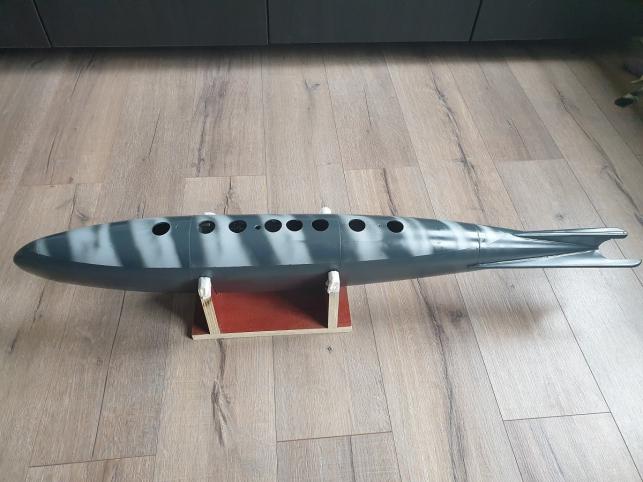

    Once together you get the idea, those holes on top are made to vent the boat.
    Click image for larger version  Name:	20250727_154342.jpg Views:	0 Size:	46.1 KB ID:	189635

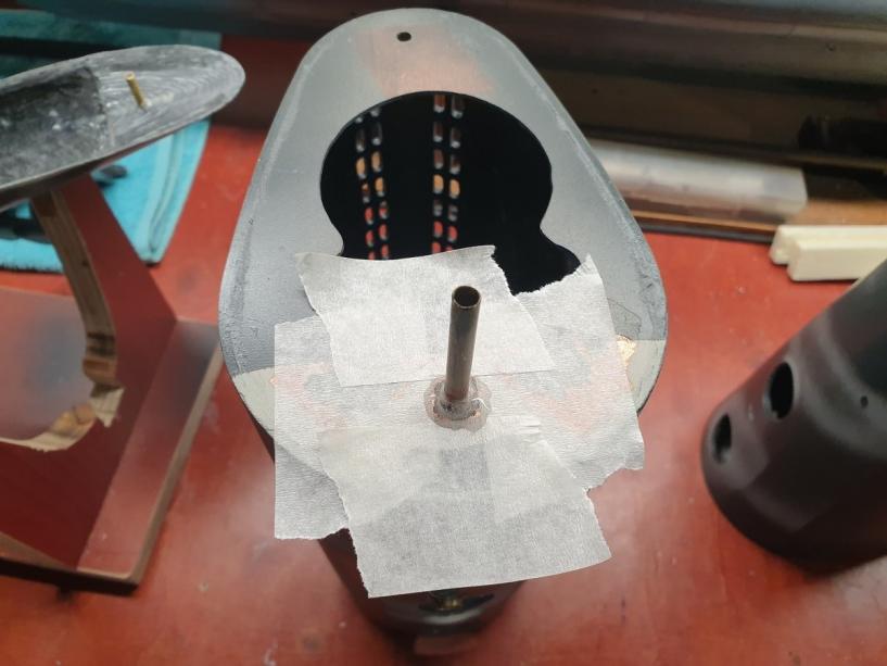

    The top part covers up the ventholes.
    Click image for larger version  Name:	20250727_154500.jpg Views:	0 Size:	50.1 KB ID:	189636

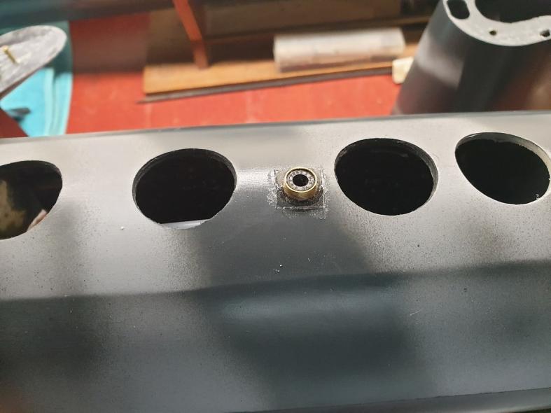

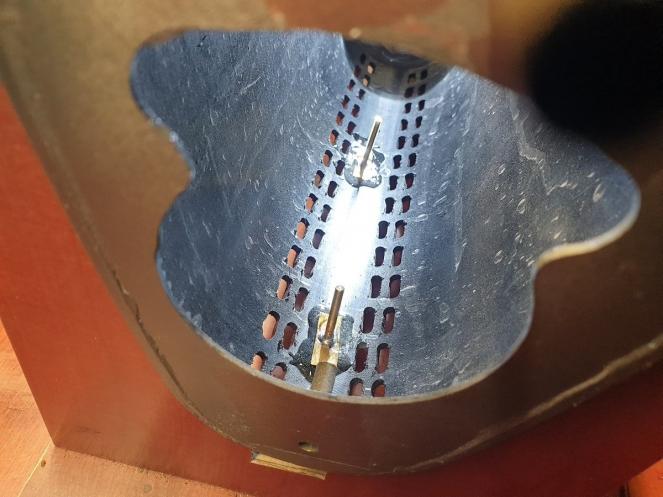

    Made a paper mold to get some more ventholes near the base of the strange extension, i presume it's a kind of peroscope protector.
    Click image for larger version  Name:	20250727_162037.jpg Views:	0 Size:	42.7 KB ID:	189637

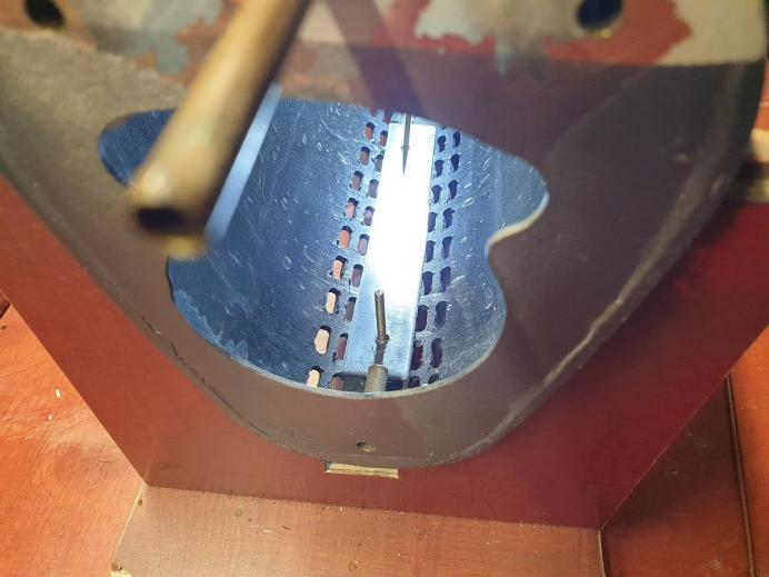

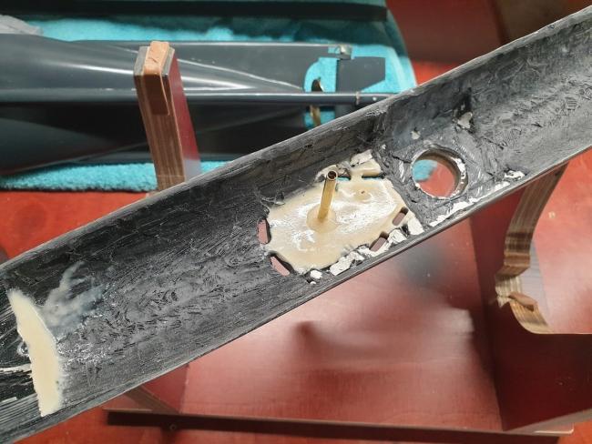

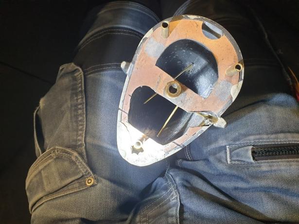

    Filled up the top part with some resin, just on the places where i don't want water or air.
    Click image for larger version  Name:	20250730_170039.jpg Views:	0 Size:	45.9 KB ID:	189638

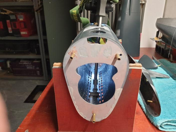

    Got the shaft in, adjusted the length and placed the connection to the drive shaft of the SD.

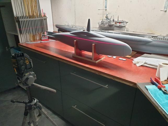

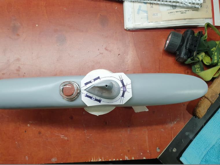

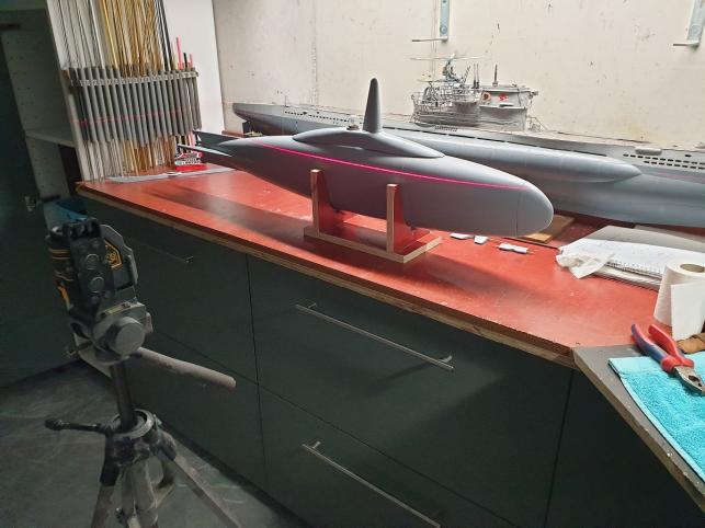

    Used the laser to get me a straight waterline, placed smal markers with pencil which i can follow up with the maskingtape
    Click image for larger version  Name:	20250730_170320.jpg Views:	0 Size:	44.9 KB ID:	189639

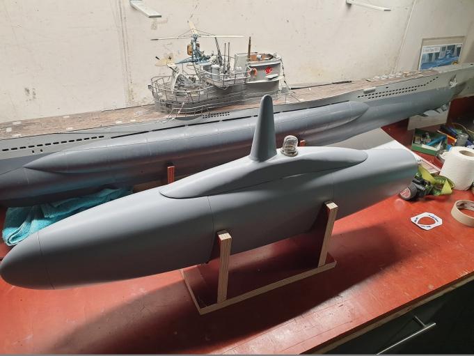

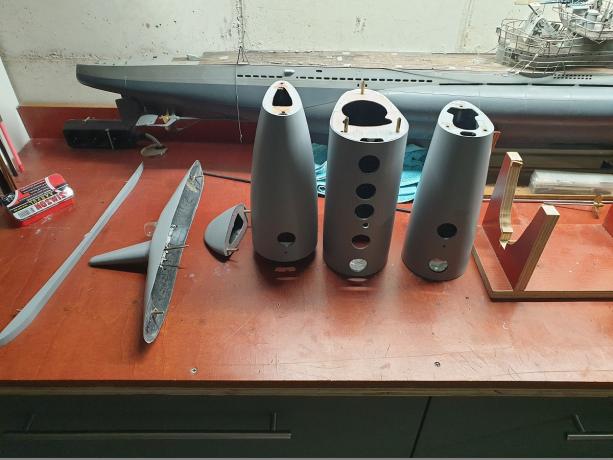

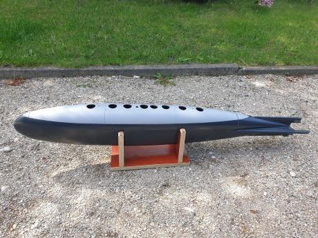

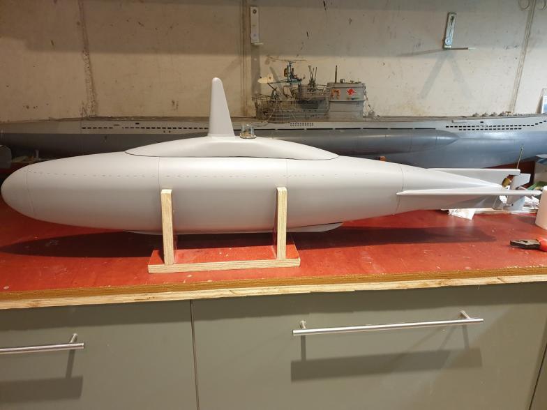

    Overall view of the complete hull complete with the rearpart with stabilising fins, attached the rudder and dive plane with some pins
    Click image for larger version  Name:	20250731_215905.jpg Views:	0 Size:	45.5 KB ID:	189640

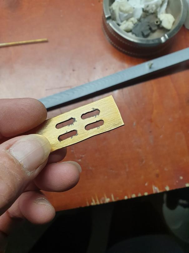

    Signed off the ventholes near the keel, just holes would be enough but took the extra effort to go a bit scale, no idea how this should work in real live.
    Click image for larger version  Name:	20250731_215918.jpg Views:	0 Size:	39.4 KB ID:	189641
    Made a simple copper jigg to ease the work on the ventholes, once this is done i can think about masking up and final paint.

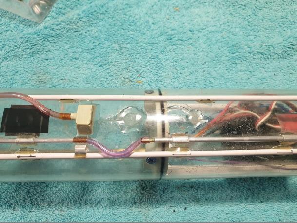

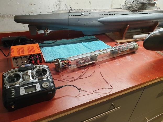

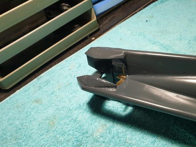

              Since i had filled up the wrong stabilisor for steering the diveplanes i had to make a solution to sort this, ended up with a small switch which gives you a choice wether you need to switch the functions of the rudder and diveplane servo by reversing them, that is rudder becomes diveplane servo and visa versa.
              Tested this solution and it works well without any problems using the ADF2, so now i have a choice between the V60 and Ko Hyoteki configuration by flipping the switch to the right position.

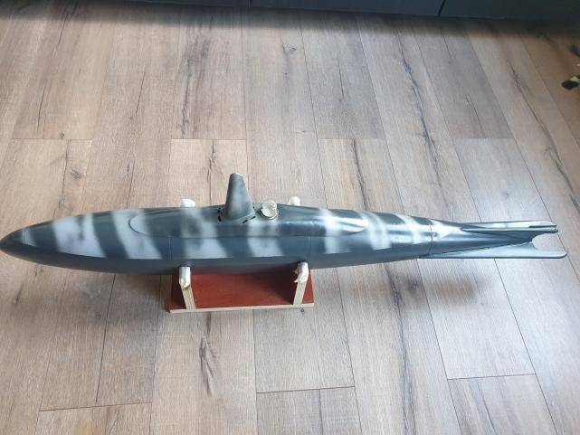

              Gave her the same camouflage scheme as the V80

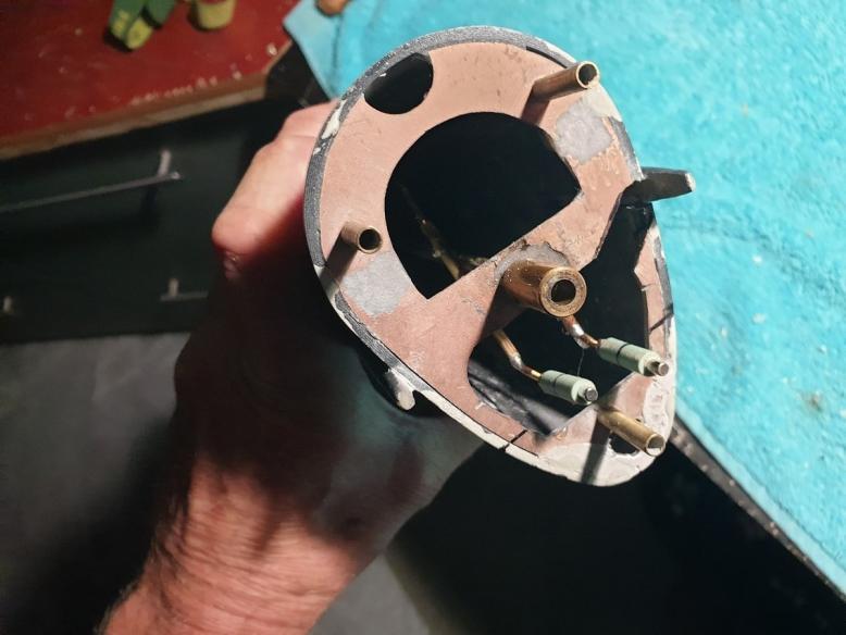

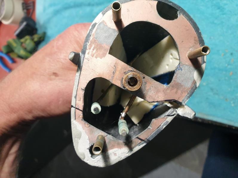

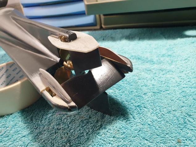

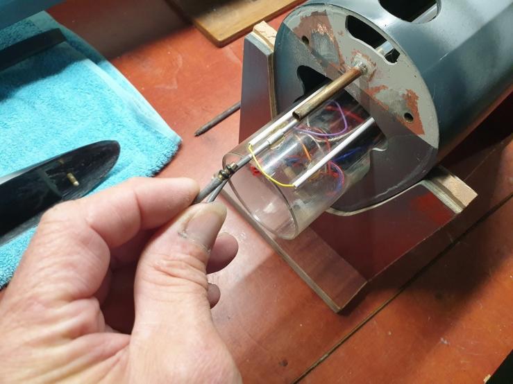

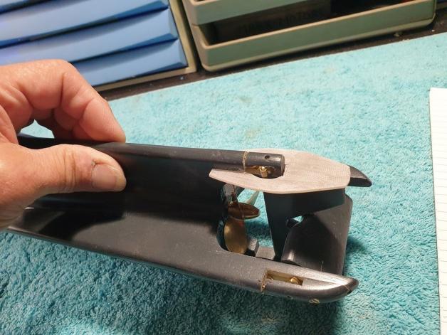

                    Made the connections to the rudder and dive-plane, did some work on a automatic connection to the snorkel mast.
                    Click image for larger version  Name:	20250812_175207.jpg Views:	4 Size:	55.5 KB ID:	189957

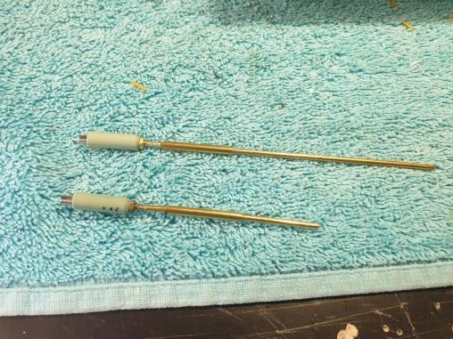

                    At first i made these, magnetic couplers with some thread for adjustment.
                    Click image for larger version  Name:	20250807_215525.jpg Views:	4 Size:	48.8 KB ID:	189959
                    Click image for larger version  Name:	20250807_215537.jpg Views:	4 Size:	46.6 KB ID:	189960

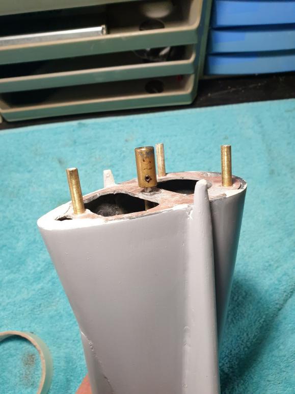

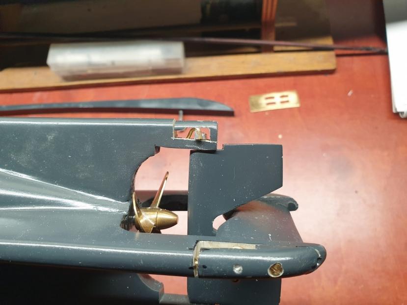

                    This was the tricky bit, getting the rods connected, there is not that much room, i tried to keep it simple.
                    Click image for larger version  Name:	20250812_175125.jpg Views:	0 Size:	44.6 KB ID:	189961
                    The situation inside the rearpart, made the first bent with the rods.
                    Click image for larger version  Name:	20250813_215947.jpg Views:	0 Size:	46.5 KB ID:	189962
                    Marked up the positions of the magnetic couplers and made the final bent to the connectors on the SD
                    Click image for larger version  Name:	20250814_192632.jpg Views:	0 Size:	51.4 KB ID:	189944

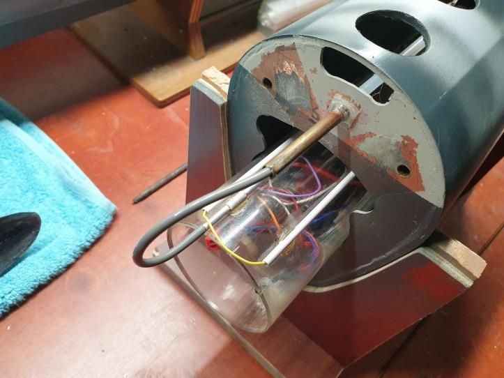

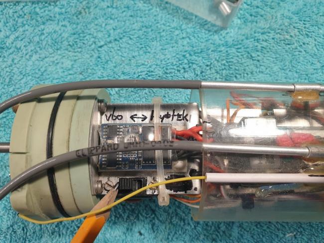

                    First i sleeved the tube from the snorkel, it was 3mm and i needed 4 mm.
                    Click image for larger version  Name:	20250814_192617.jpg Views:	0 Size:	48.6 KB ID:	189945
                    Made a connection tube at the front where the SD will end, it will clarify later on.
                    Click image for larger version  Name:	20250814_192625.jpg Views:	0 Size:	42.1 KB ID:	189946
                    Made a connector with a 4mm lipseal, this is done to make a direct connection to the snorkelmast, connected this with a small silicon hose to the forward tube.
                    Click image for larger version  Name:	20250816_110116.jpg Views:	0 Size:	52.7 KB ID:	189947
                    This is all made to do this, inserting the snorkel connection of the SD into the forward tube.
                    Click image for larger version  Name:	20250816_110128.jpg Views:	0 Size:	51.0 KB ID:	189948
                    It's the same connection as used with the Ko Hyoteki, now i have to attack the rearpods for covering the steering of the diveplanes and rudder, luckely i have my V80 as a example to copy.

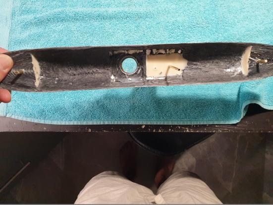

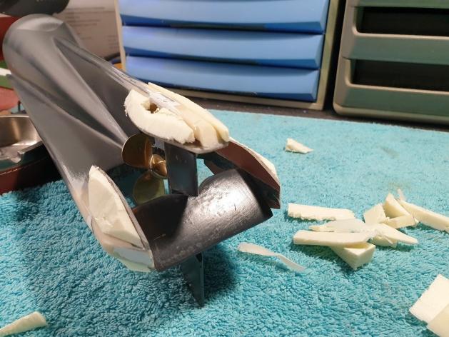

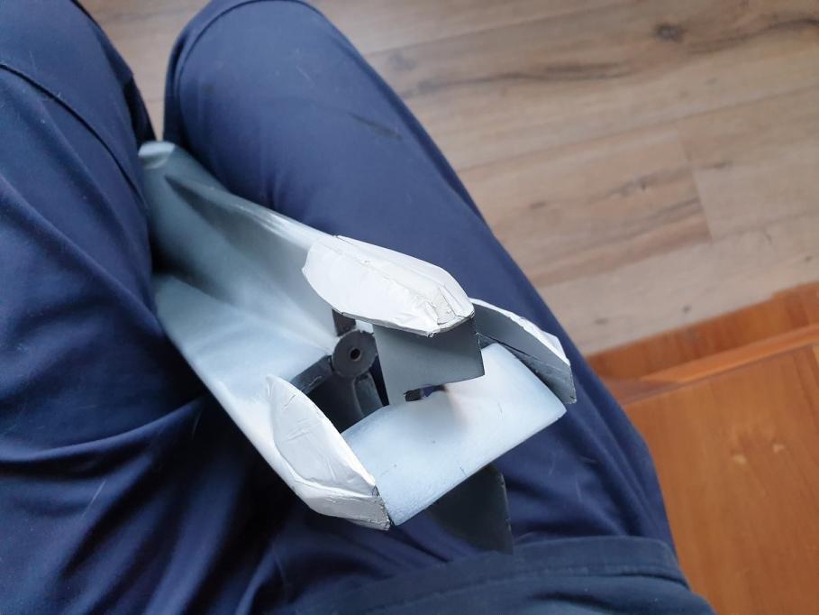

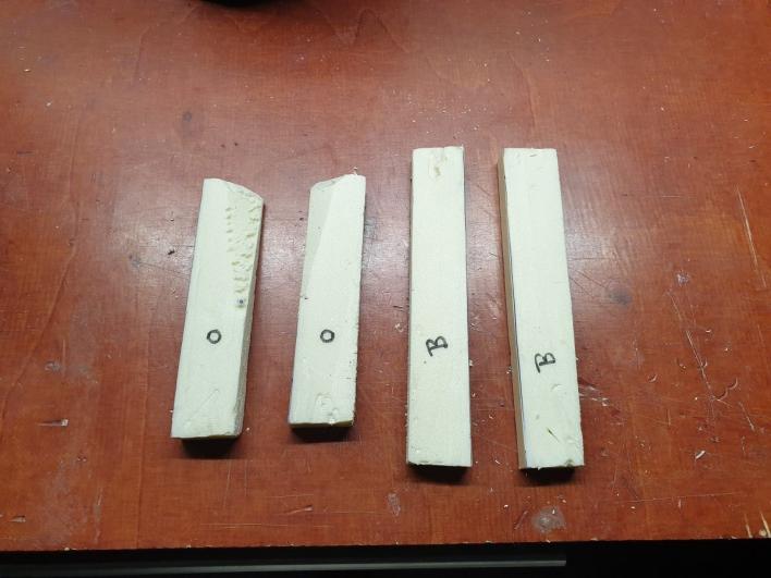

                      First i cutted some foam for inside the rear-end of the V60, i know from the V80 that has a weight issue, for now those four pieces.

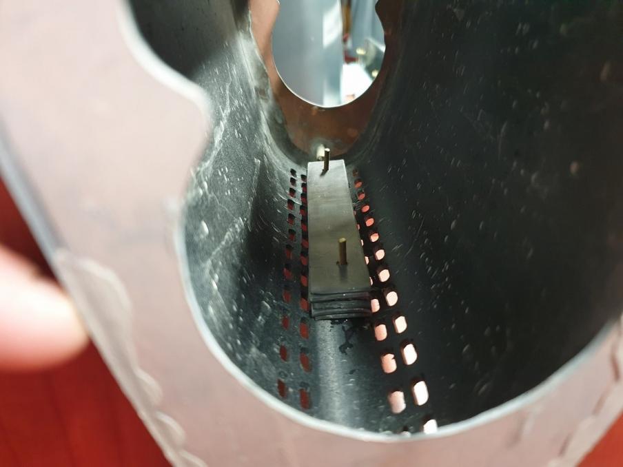

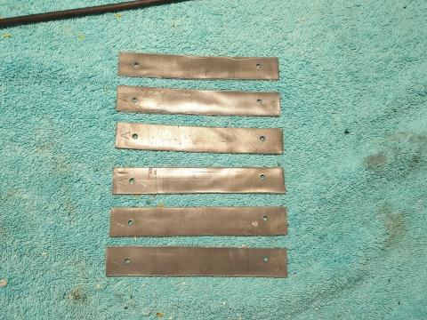

                      When you need foam you also need lead, those pieces will counteract the upperstructure and add some stability, used flat-lead to keep things simple.
                      Made two threaded studs on the lower part for rigging up the lead, pretty much the same way i did on the type XXIII.
                      Test fitting the flat-lead, on the end it will be secured by some M3 nuts.
                      Crammed in the four blocks of foam, i hope it will be enough, if not then i need to find some more space inside.

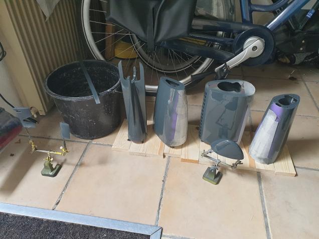

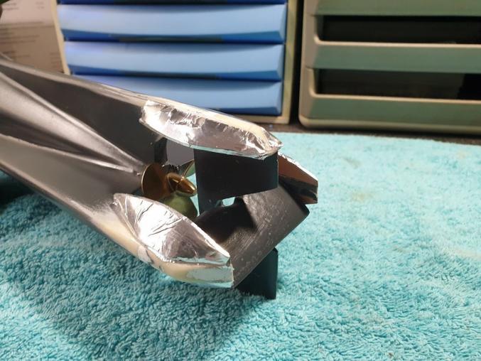

                      Started with the cover up of the steering, re-drawn from the V80 and altered the shape for the V60, those will be glued down at the stabilisor fins, from that i can place the foam which will give me the shape i'm after.
                        • 1647
                        It has been busy in the Cave, finished the fairings on the V60, for now she is ready to be trimmed.
                        Test fitting the base for the top fairing, had to make some room for the upper steeringrod, by taking out a notch it can move freely

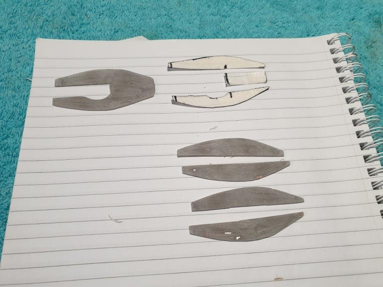

                        All three bases glued down, time to get some foam on them.

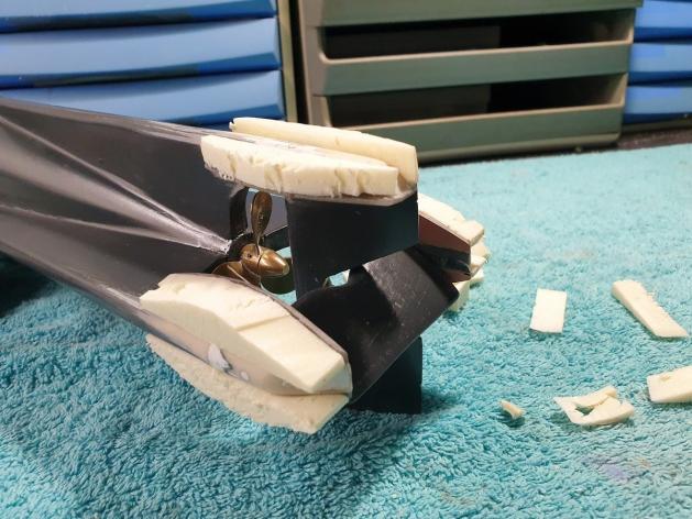

                        First stage with glueing the foam, after drying i cutted it roughly to shape.
                        Cutting them to the initial shape, the last pass will be done with a sandingblock to get the final curved shape.
                        Covered the foam with some aluminum sticky tape.

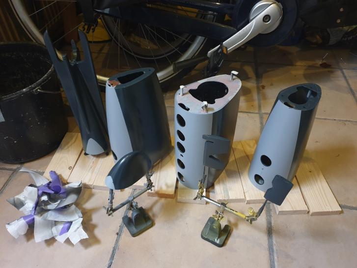

                        First i gave it a good spray of primer, so you can see if you need to correct things.
                        Final coat of paint, they turned out nice, shape is a bit different as on the V80.
                        Fastened the lead strips with some M3 nuts, if needed i can add some or remove them during the trimmingsession.
                        Since i know from the V80 the rear tends to be heavy i glued down some extra foam near the waterline on the second rearpart of the hull.
                        For now she stands like this, ready to be trimmed, when done i can think about the maiden.
                        SD is charging and ready to be used for the trimming session.

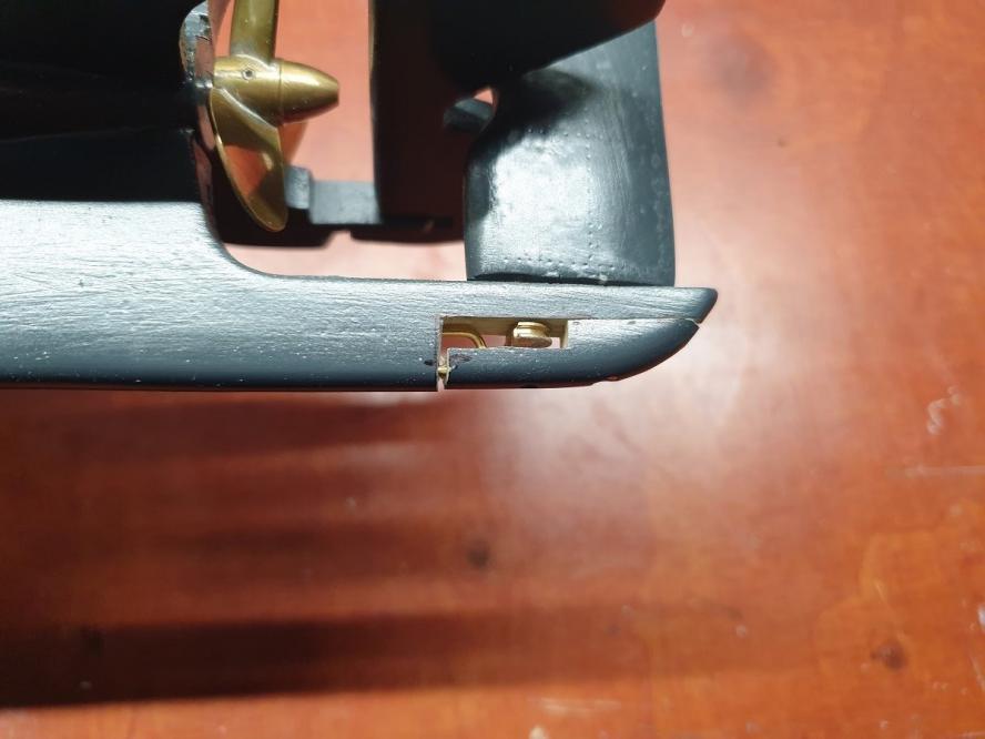

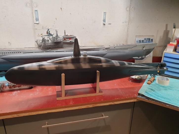

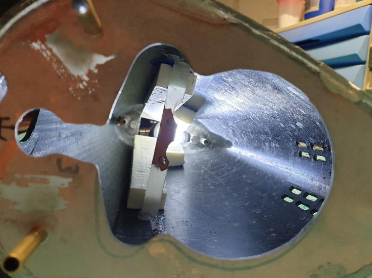

                          When working with the V60 i found out that putting the boat together and yet opening her up for switching her on, was getting a bit annoying, so i decided to make me a hatch on one side for easy access on the powerswitch
                          Place of the hatch determent and cutted into the hull, a bit rough at first, it will become better.
                          You can push the hatch open and by using your pinky finger you can reach for the powerswitch.
                          The first cut was a bit rough, so i cleaned it up with some aluminum tape and bakingsoda for adressing the size of the hatch
                          If you push at the bottom of the hatch it will open up, closing happens by pushing at the top of the hatch, it's a friction fit, if it get's floppy in the future i have to build something with a spring inside to keep it shut.
