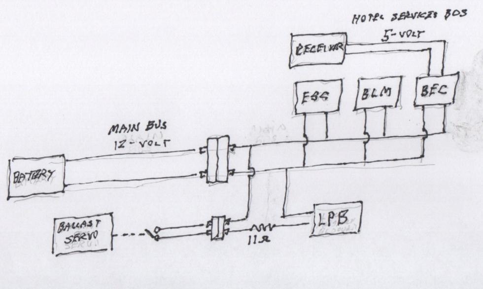

    Here you go, Ken:

    Thanks Manfred. The sample articles are in German, which I don't know. Not sure what I can get from there.
    Originally posted by Ken_NJ

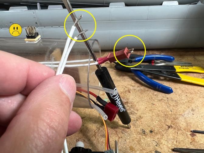

    Question for David
    There are two white wires coming from the micro switch mounted on the vent servo and two white wires coming from the ballast pump. The ballast pump is rated for 5 volts.
    Please tell me that I have this right. I suspect one of the ballast pump wires connects to BEC output ground. The other ballast wire connects to one of the wires on the micro switch. The other micro switch wire connects to BEC output 5v. Then when the command is issued to blow ballast, the servo activates the micro switch which in turn activates the ballast motor blowing the ballast tank.
    If this is the case, no need for a 2IS or the nifty splitter thing I made up.
    Click image for larger version Name:	IMG_9756.jpg Views:	0 Size:	57.2 KB ID:	189454

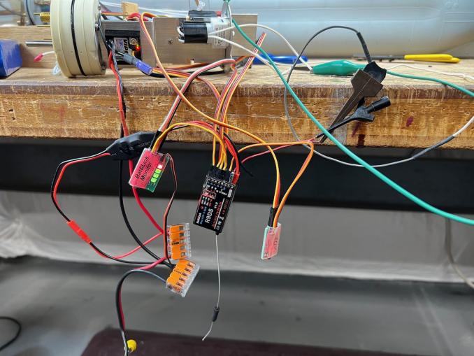

    Question answered. I wired up as I described and the micro switch activated the pump just fine. Only question is which direction will the pump run? Will figure that out once everything is in place and run a test in water. If I need to switch two wires to change the direction, easy peasy.

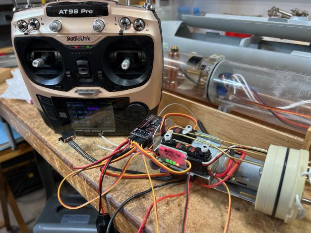

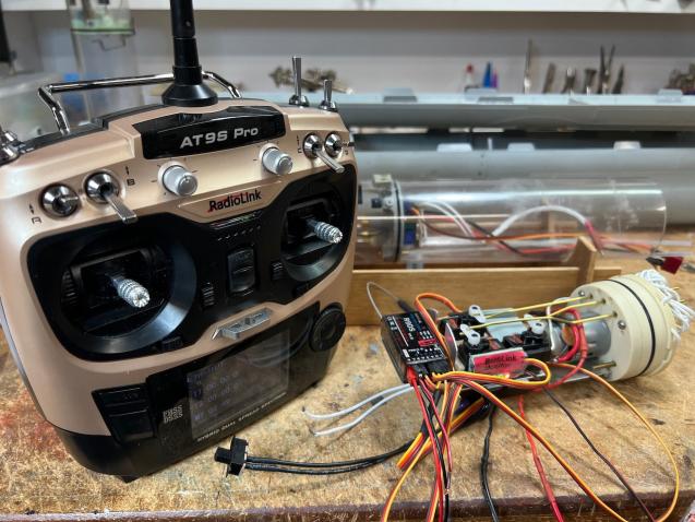

    Not that the following pictures are helpful. Wired up the 2.4 receiver, AD2, BLM, BEC. Going to try using these WAGO lever connectors from Amazon instead of soldering the ends. Everything works fine. Did some preliminary setup procedures on the BLM and AD2. Will redo and finalize it all once they are all in place.
    Even the 2.4 receiver might not fit well. Started figuring where to put each component. The Viper 10 mounts on the bottom under the servos. The AD2 and BLM are mounted on the servos with double face tape. I removed the connectors that came on the Viper 10 and used 2mm bullet connectors for the motor. The battery side goes into the WAGO connector. Still have to mount the BEC and WAGO's. Not putting the DC3 depth controller in until after Groton, unless I find time. Can due without it for now. Everything still works after mounting them.
    What to do with all the long wires, mostly servo wires? Fold them and bury them. Or cut them and splice them? Or cut and put new contact ends on? I don't have the crimper for these small wires. Might be a good investment.

    Question for David

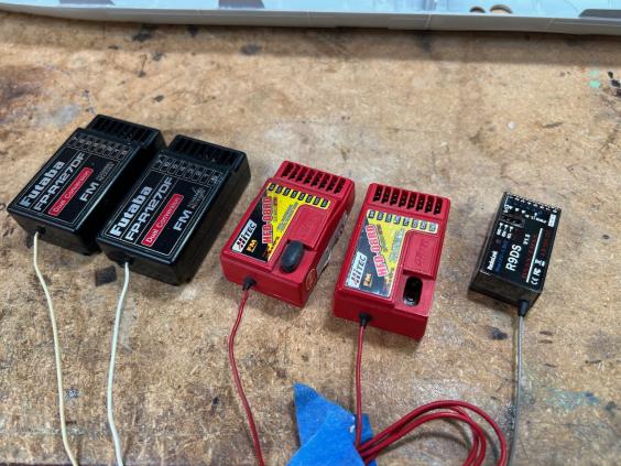

  • Ken_NJ
    replied
    I'm starting work on the guts of the sub driver. I have four receivers on 75Mhz. None of them will fit. I tried taking the Hitec ones out of the case, they still do not fit. I looked online if there were any smaller ones I can get hold of, nothing. I have dual and single conversion crystals. So I guess I'm going to 2.4 Ghz. I can order longer 2.4 antenna's from Amazon but don't know if they will be long enough. I have instructions that David had made up long ago on making a longer antennae but I have to find that.
    Click image for larger version  Name:	IMG_9753.jpg Views:	0 Size:	55.8 KB ID:	189447

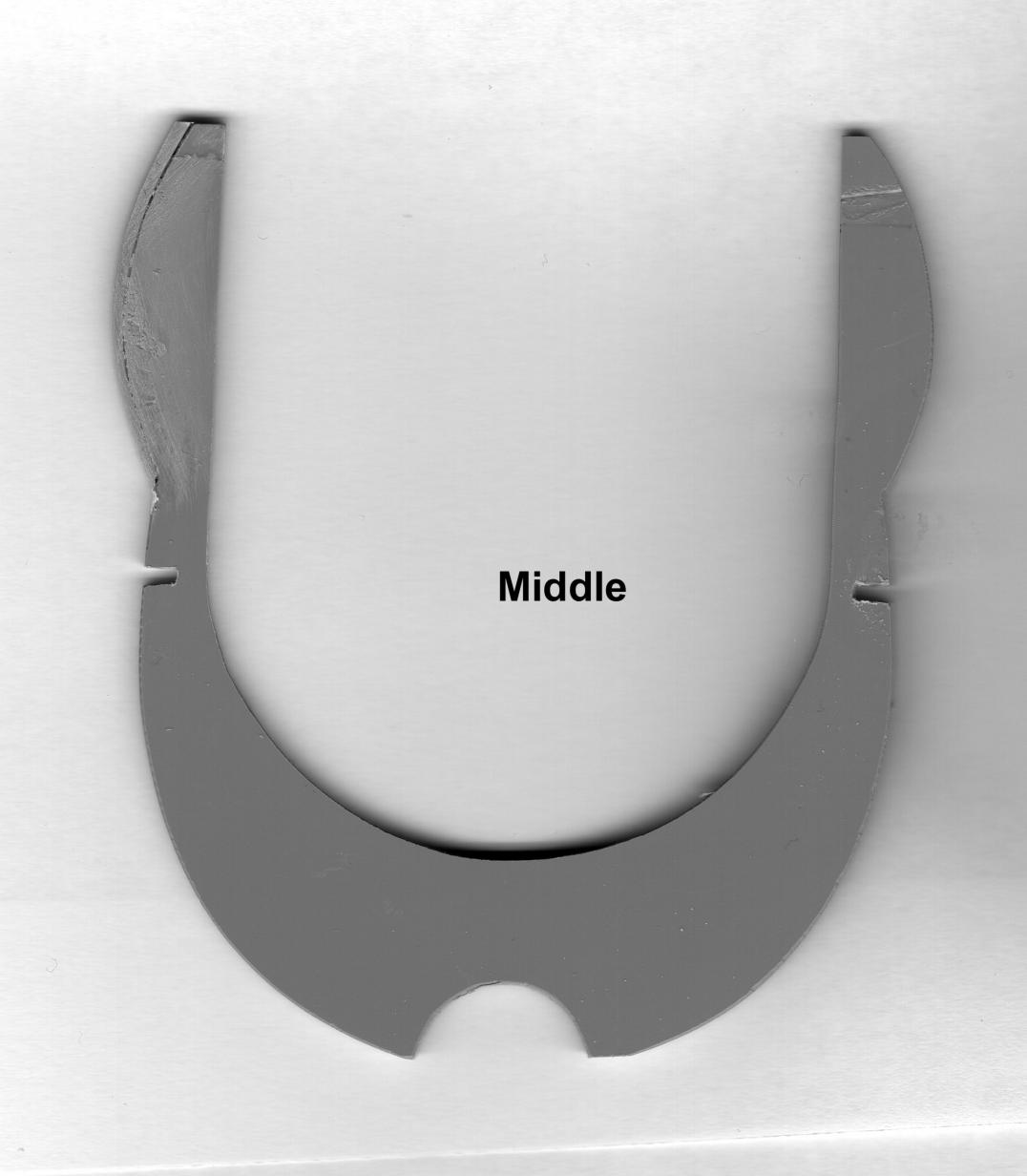

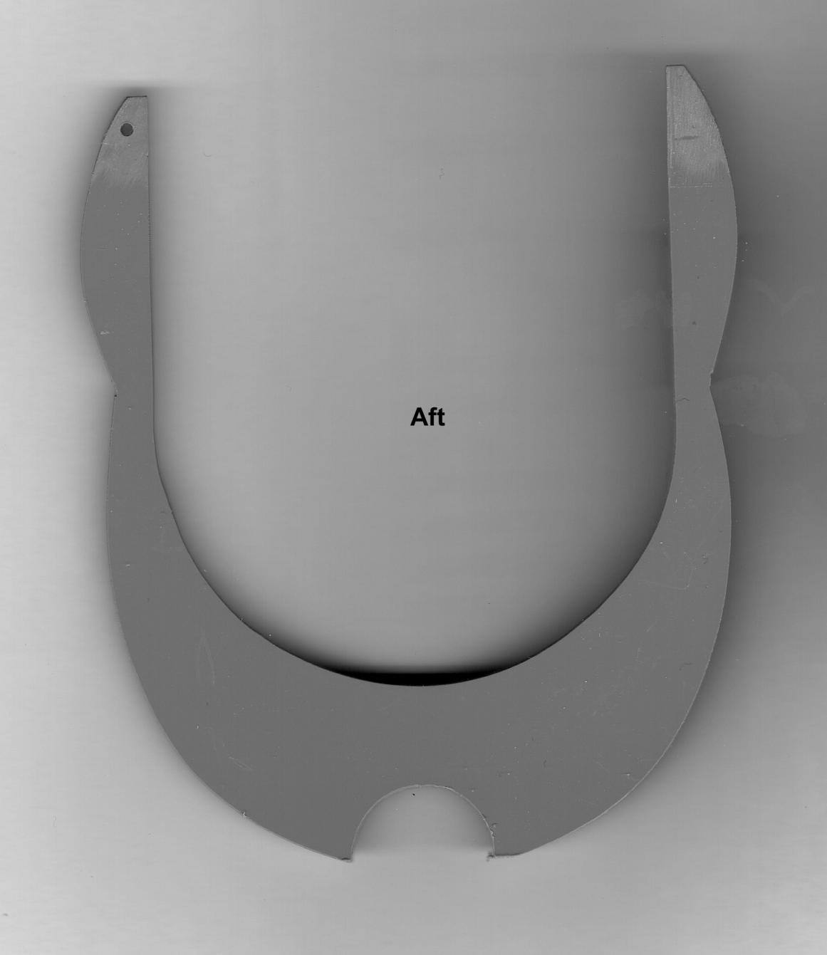

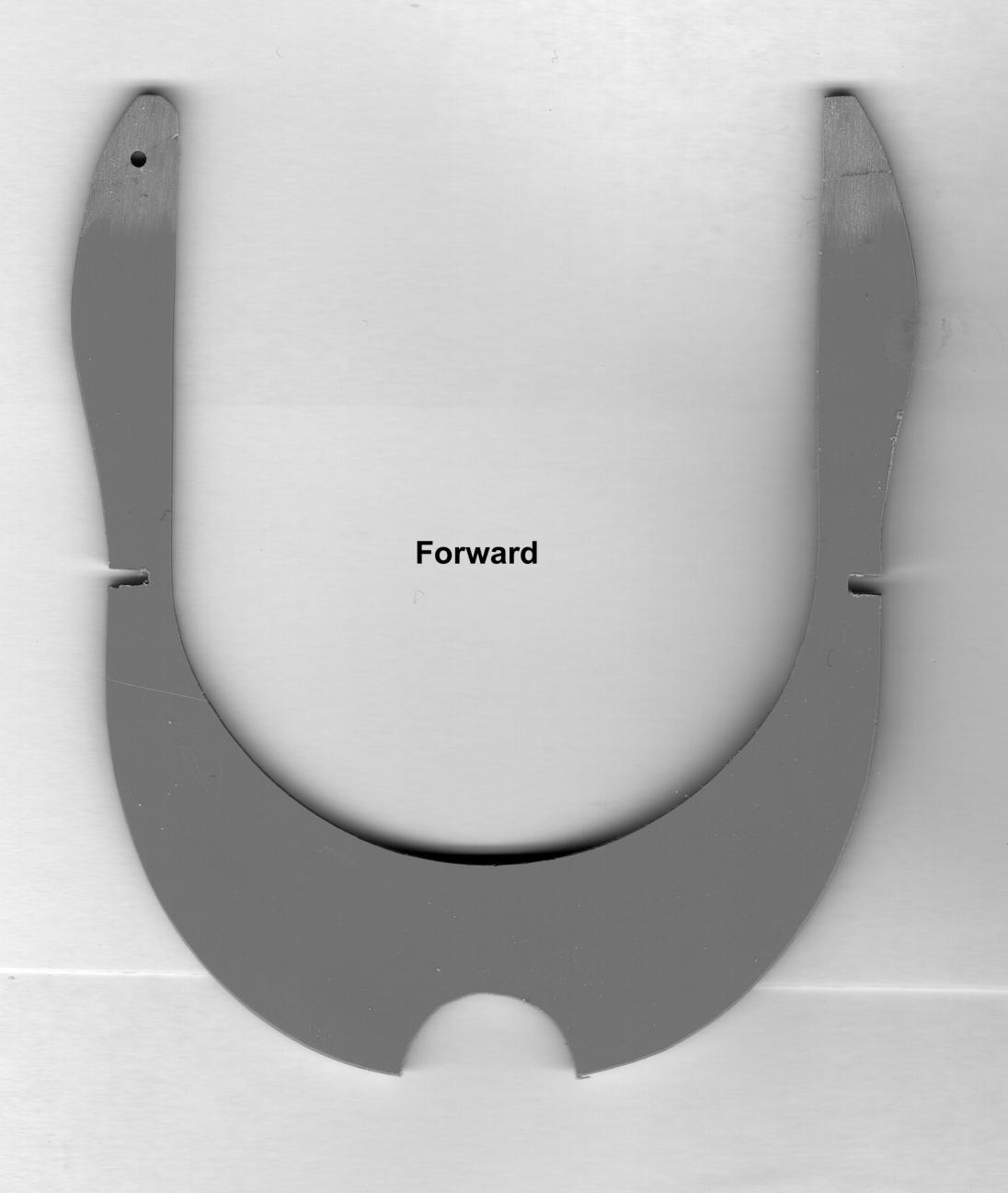

    This model has been around a while and there are probably few that would be building one today. Besides that, here are the profiles of the three sub driver foundations. If they are useful to someone, great, if not they will sit here.
    You will need to modify them to your liking. The small slots on the sides in the forward and middle one only are good if you do the same as what I did. You will also have to cut the height down shorter since you may not do the SD lever hold down as I did. AT least you have the interior profile.
    If you right click on each profile and select save as, it will save it to your computer as a jpg file.
    Click image for larger version  Name:	Forward_1.jpg Views:	0 Size:	59.2 KB ID:	189444
    Click image for larger version  Name:	Middle_1.jpg Views:	0 Size:	63.5 KB ID:	189445
    Click image for larger version  Name:	Aft_1.jpg Views:	0 Size:	52.1 KB ID:	189443

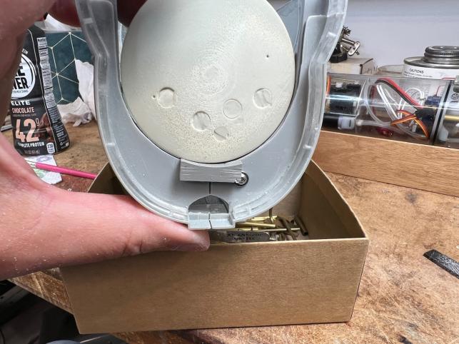

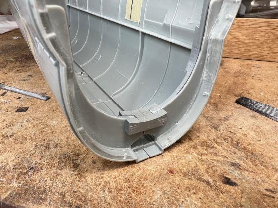

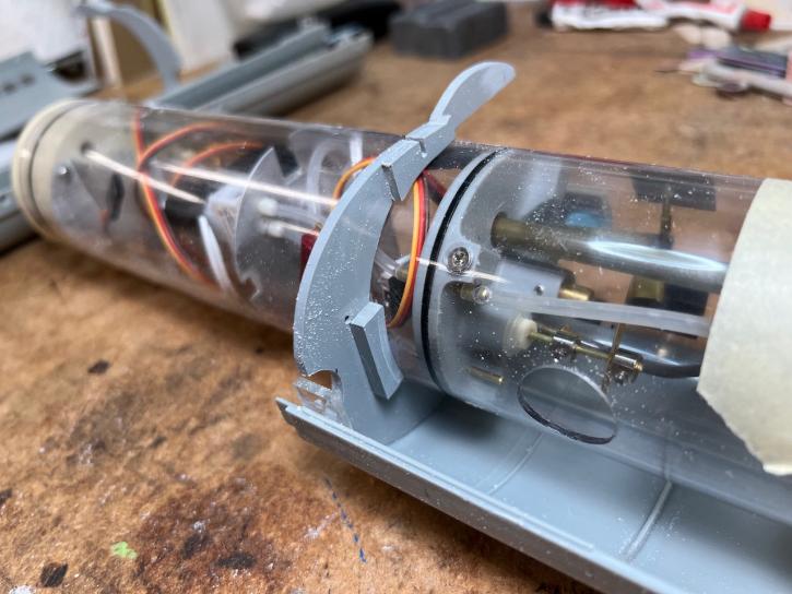

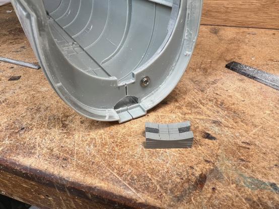

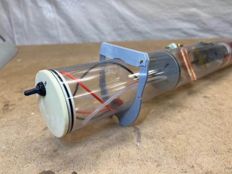

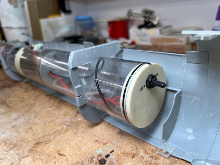

    Sub Driver Lock
    With the SD sitting in the foundations, the pivot levers hold the SD from floating away from the hull. There is nothing to prevent the SD from rotating or moving forward and aft. In some of David's SD's he has the shock absorber with a pin that sits in a hole in the bottom of the SD. My solution is the following, and I did this 14ish years ago on my Marlin. Actually, the chunk I am using here was left over from when I did this on the Marlin.
    A few layers of styrene were adhered together and one side was formed to fit the circumference of the cylinder. Slots were cut and filed on two sides. Then an area in the center foundation was cut and filed away.
    Click image for larger version  Name:	A_IMG_9690.jpg Views:	0 Size:	52.8 KB ID:	189434
    This chunk of styrene fits into the opening.
    Click image for larger version  Name:	B_IMG_9691.jpg Views:	0 Size:	53.7 KB ID:	189433
    To get the curve the same as the cylinder, it was rough filed to shaped then sandpaper was put on the 2-1/2 inch cylinder and the chunk was shaped on the sandpaper to the same curvature as the cylinder. No pic of this.
    Here I am using an end cap checking for fit.
    Click image for larger version  Name:	C_IMG_9693.jpg Views:	0 Size:	54.6 KB ID:	189432
    Click image for larger version  Name:	D_IMG_9696.jpg Views:	0 Size:	52.8 KB ID:	189429

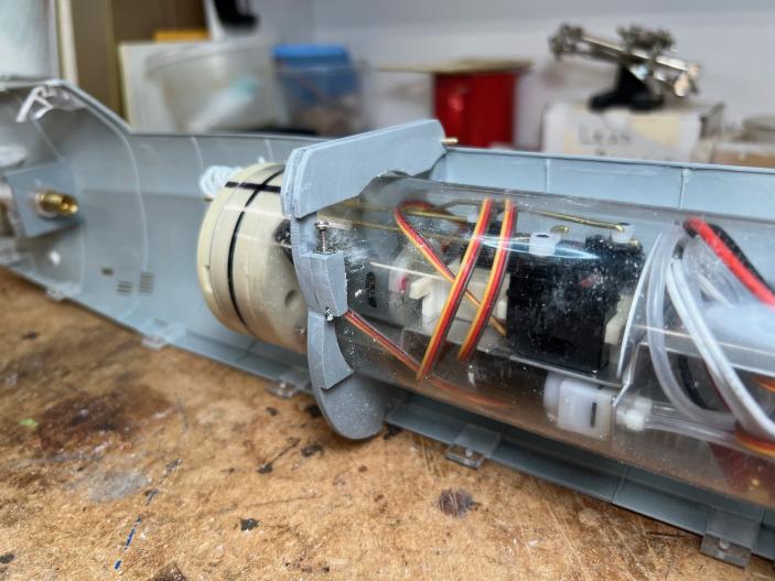

    Fits nicely in place. At this point CA was placed on the edge which contacts the cylinder and it was put in place, Then the cylinder was carefully positioned so the vent was at top dead center and pressure was applied. Once the CA set, the cylinder was removed.
    Click image for larger version  Name:	E_IMG_9695.jpg Views:	0 Size:	53.7 KB ID:	189431
    Now when the cylinder is put in the boat, this locator correctly positions and locks the SD fore and aft and with the vent at top dead center. It prevents the cylinder from moving fore and aft and rotating.
    Click image for larger version  Name:	F_IMG_9710.jpg Views:	0 Size:	56.6 KB ID:	189430

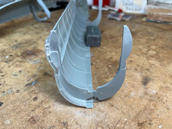

    replied

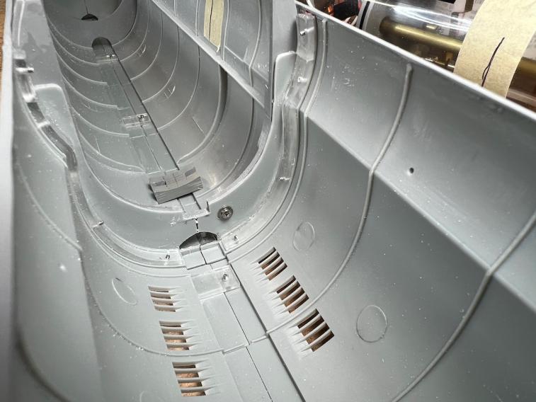

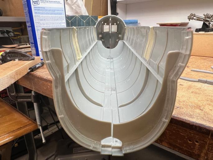

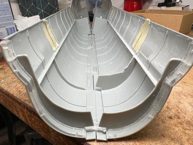

    Fixing Hull Warp
    Once the deck was cut away from the starboard aft section, it developed a warp or bulge, whatever you want to call it. Pretty obvious.
    With this warp, the deck would not properly match the hull. When I add the tabs to the deck and hull to align them, I didn't think they would be enough to help on this warp.
    Port side is straight.
    On the aft SD foundation starboard side, I added a chunk of styrene to the foundation and added a slotted chunk to the hull. A hole was drilled and tapped for a 2-56 machine screw.
    Now I can draw in the bulged hull and tighten up the machine screw to straighten the hull warp.
    Better.
    Leave a comment:

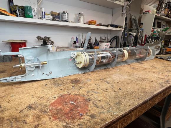

    Very soon I'll be able to make the drive shaft, rudder and dive plane connections. And I will have plenty of access to do this. No trying to squeeze things into tight spots.

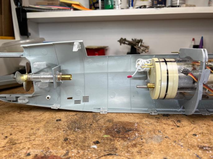

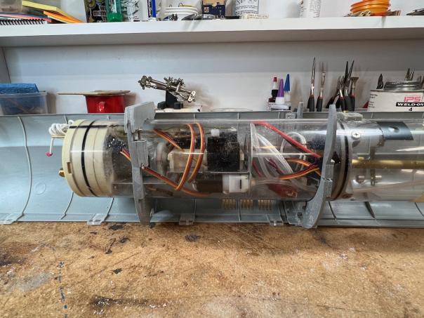

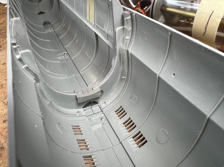

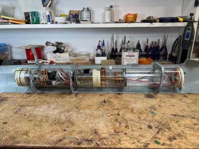

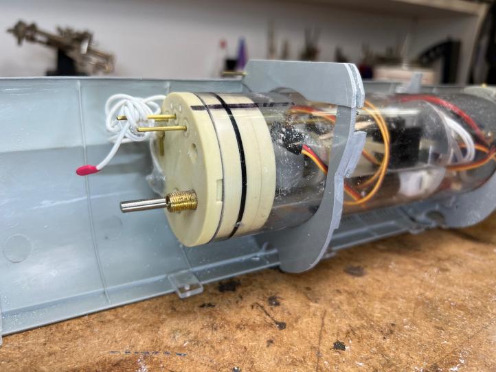

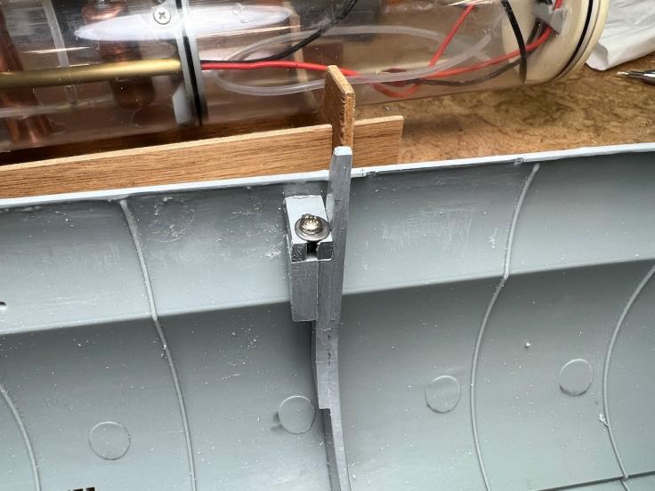

    Sub Driver Foundations Part 2

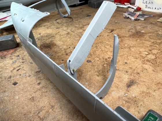

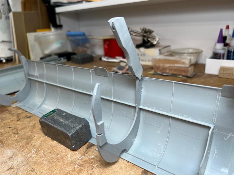

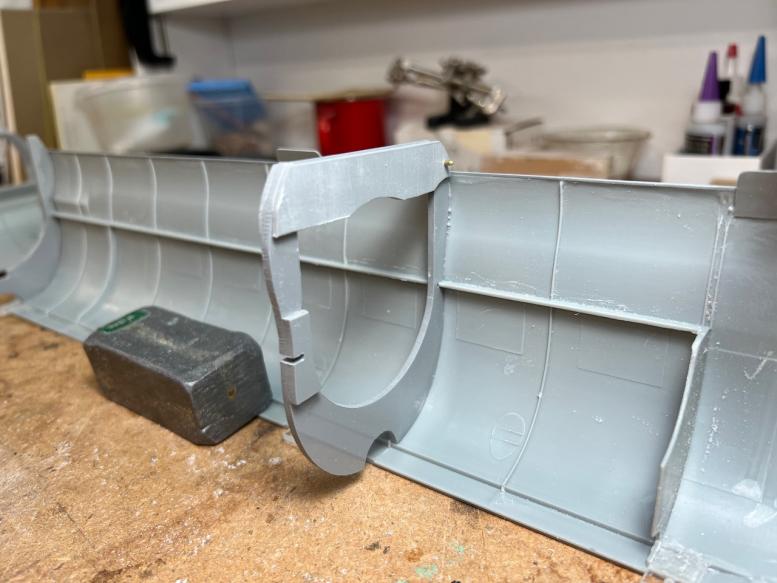

    Now that the SD foundations are cut to shape, they need to be fastened to the hull. Since the four hull sections are bolted together, each of the three foundations will need to be glued to certain parts of the hull sections. Two of them will be glued to the port forward section and one will be glued to the port aft section.
    With the hull sections bolted together they were all glued in place with the usual solvent. Here the forward foundation is attached to the port forward hull section. Note that the hull section on the port side had a cutout for the rib that I left in place. For the starboard hull section which will be bolted on, I added a reinforcement where the rib is since that portion of the foundation is thin and would be weak. The top piece is a pivotable section which will be a hold down for the sub driver.
    Click image for larger version  Name:	B_IMG_9703.jpg Views:	0 Size:	52.1 KB ID:	189402
    Here the hold down is pivoted upwards. The hold down is three layers of styrene. There is enough friction on the starboard side that no pin would be needed to lock it down. Besides, once the deck is in place, the deck will not let the hold down move.
    Ya think I over engineered this??? LOL
    Click image for larger version  Name:	C_IMG_9705.jpg Views:	0 Size:	54.3 KB ID:	189403
    From the backside.
    Click image for larger version  Name:	D_IMG_9707.jpg Views:	0 Size:	55.9 KB ID:	189405
    The pivot point.
    Click image for larger version  Name:	E_IMG_9729.jpg Views:	0 Size:	53.8 KB ID:	189408
    With the SD in place.
    Click image for larger version  Name:	F_IMG_9708.jpg Views:	0 Size:	54.1 KB ID:	189404
    And locked down. Again the deck will lock down.
    Click image for larger version  Name:	G_IMG_9709.jpg Views:	0 Size:	53.3 KB ID:	189406
    The aft foundation with lock down lever. One lock down lever forward and one aft since this is a 22 inch long SD.
    Click image for larger version  Name:	H_IMG_9726.jpg Views:	0 Size:	52.4 KB ID:	189407
    Click image for larger version  Name:	I_IMG_9727.jpg Views:	0 Size:	52.4 KB ID:	189411
    Click image for larger version  Name:	J_IMG_9711.jpg Views:	0 Size:	55.6 KB ID:	189410
    Click image for larger version  Name:	K_IMG_9713.jpg Views:	0 Size:	53.7 KB ID:	189409
    Nice to see an internal cross section view.
    Click image for larger version  Name:	L_IMG_9715.jpg Views:	0 Size:	59.4 KB ID:	189412
    Click image for larger version  Name:	M_IMG_9717.jpg Views:	0 Size:	56.0 KB ID:	189414
    Click image for larger version  Name:	N_IMG_9720.jpg Views:	0 Size:	54.1 KB ID:	189415
    Here is the mid section. No hold down lever needed here.
    Click image for larger version  Name:	O_IMG_9731.jpg Views:	0 Size:	53.8 KB ID:	189413
    Before I glued them in I scanned the foundations. In a few posts I'll posts those scans. If anyone wants to build the XXIII, they can used those scans to make the SD foundations for themselves.

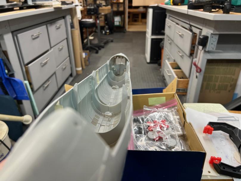

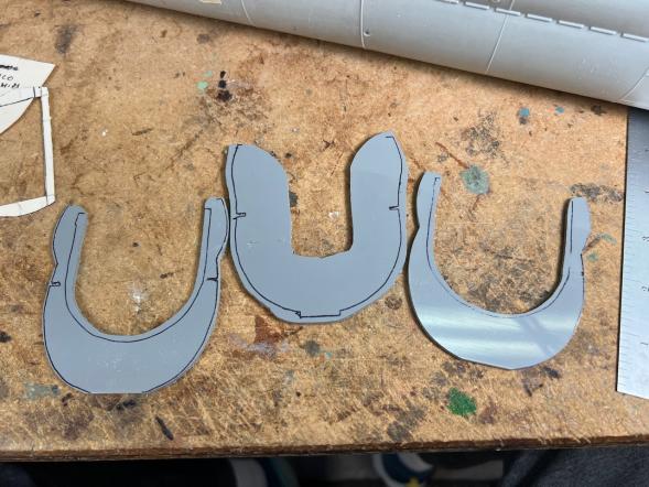

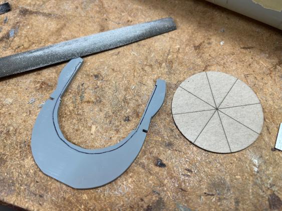

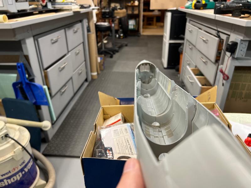

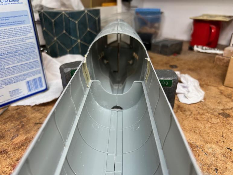

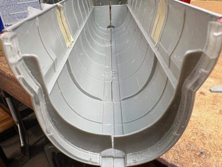

    Sub driver foundations Part 1

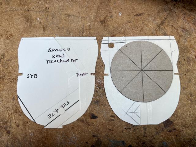

    I fashioned templates from scrap card stock of the interior. I used the aft section of the hull, placed it on the card stock and drew a general outline (no picture of this). This gave me an interior outline to work with. It was easier to draw half the hull, fine tune the shape and make a second half and tape them together. There will be three foundations, one forward, one glued to the center support and one aft. The forward and middle one are identical.
    Click image for larger version  Name:	A_IMG_9613.jpg Views:	24 Size:	51.3 KB ID:	189371
    Click image for larger version  Name:	B_IMG_9614.jpg Views:	24 Size:	52.2 KB ID:	189368
    Rough cut from 0.1" Plastruct styrene.
    Click image for larger version  Name:	C_IMG_9623.jpg Views:	24 Size:	52.1 KB ID:	189373
    Click image for larger version  Name:	D_IMG_9641.jpg Views:	24 Size:	51.9 KB ID:	189374
    Will explain the piece at the top later.
    Click image for larger version  Name:	E_IMG_9675.jpg Views:	25 Size:	51.4 KB ID:	189366
    I decided that second section before the mid section was not needed so I cut that down leaving a little there as hull rigidity, I probably does nothing.
    Click image for larger version  Name:	F_IMG_9676.jpg Views:	24 Size:	56.3 KB ID:	189369
    Click image for larger version  Name:	G_IMG_9677.jpg Views:	24 Size:	52.8 KB ID:	189370
    Since the SD does not reach the forward section, I cut some of that away as well.
    Click image for larger version  Name:	H_IMG_9678.jpg Views:	24 Size:	56.1 KB ID:	189367
    The final result.
    Click image for larger version  Name:	I_IMG_9679.jpg Views:	24 Size:	54.9 KB ID:	189372
