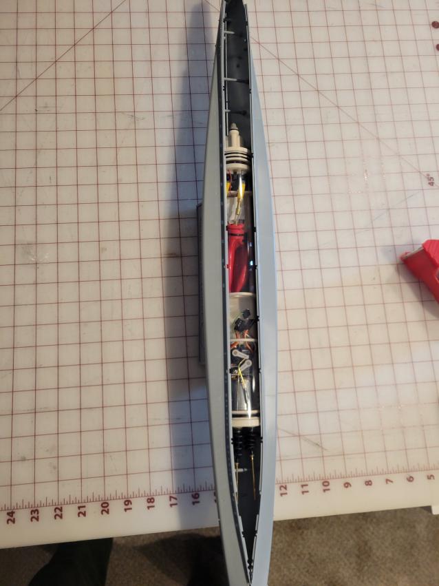

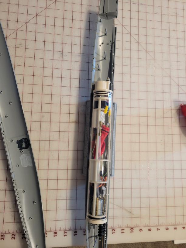

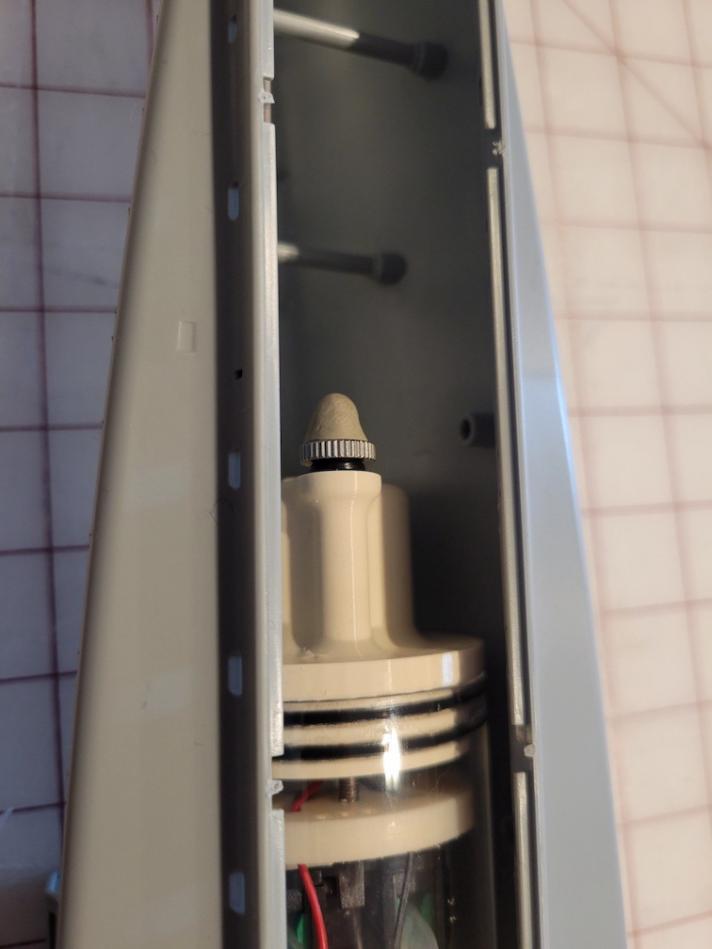

    I also spent some time with measurements and such on the Das Werk kit. Since there have been questions on the kit and an RC modified version I'll put these out. There is room to put in a WTC. A 50 mm x 300 mm WTC just fits. These are photos with my RC build hull.
    A question will be the forward planes. Two servo setup. Leave the forward planes fixed? Link to the stern planes? The stern planes are rather high on the hull, so I have concern on the stern plane only operation.
    Thoughts?

            The control planes on these old boats were far away from being placed in ideal positions. That's also the reason the bow plane configuration of U9 changed a few times. They rear planes are not in the propeller stream and therefore you only get effective force when the boat is moving. The rear planes are high and small, so not very effective. So yes, you'll need the bow planes and you need them to be independent from the rear ones.
