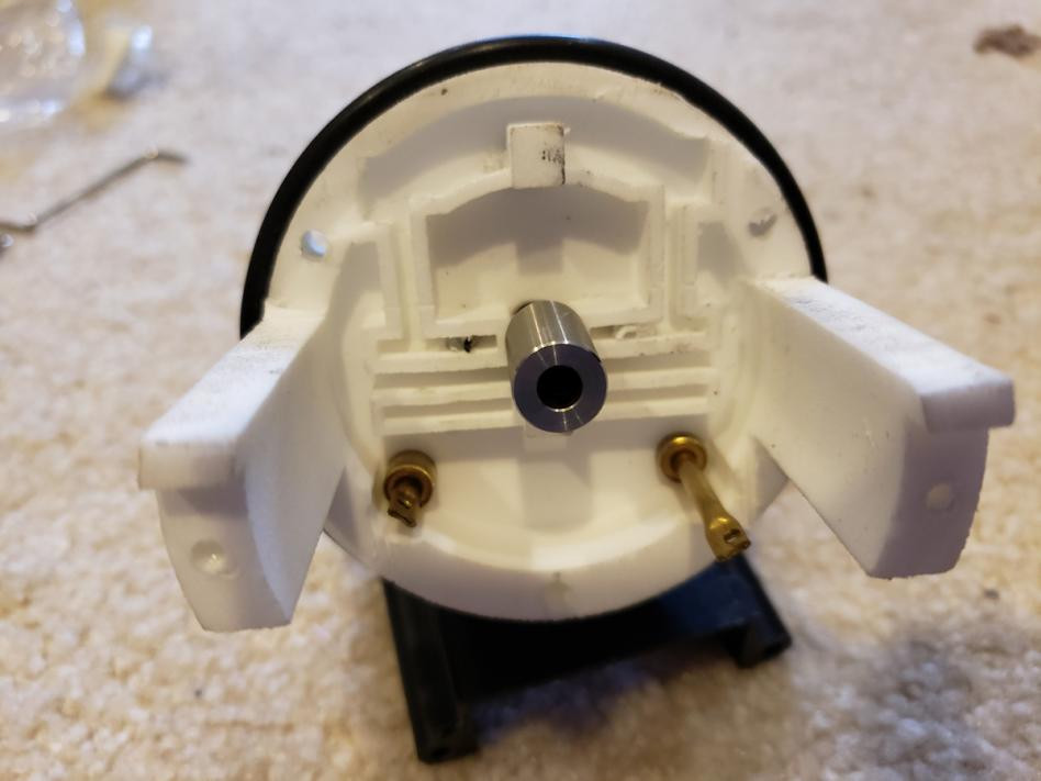

                          ​ Click image for larger version

                            Well, weather its air pressure or servo side load -I would remove the rods from the seal assemblies anyway and chuck them in an electric drill and spin polish them with a soft cloth and a little polishing compound so they wont tend to grab the bushing-also I am assuming that the seal that came loose was on the right side in this picture? I am seeing a figure 8 drill hole (double drilled or worn?) in that pivot hole for the servo link. That doesn't look like it would pivot too smoothly...Maybe replace or fix.
                            I like the CA idea on the/both seal housing/s and reinsert to the proper depth....while out for maintenance-maybe I would also cut the next concentric size of brass tubing to fit over the seal housing and with a dab of epoxy smeared around the inside, slide it on to form a shelf/stop so the seal housing can only move in if needed to remove it and any wayward air from those pumps will blow the end cap off before blowing the seals out LOL...
                            With that done-lube with some grease upon reassembly ... You got this Gwen!
                            ​ Click image for larger version  Name:	20230102_150659.jpg Views:	0 Size:	85.8 KB ID:	168284

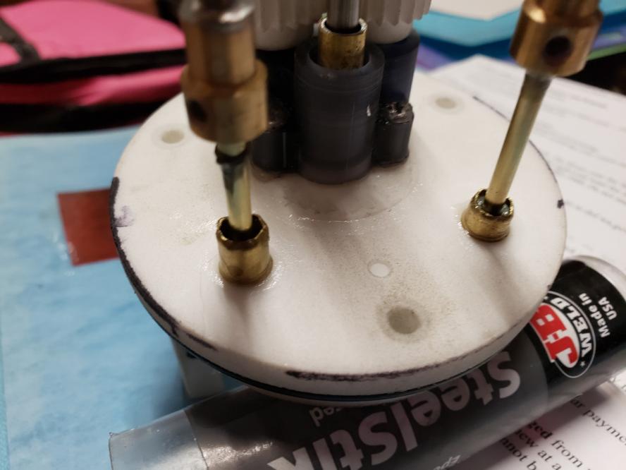

                            Thanks Bob,
                            I think I have made a pretty good start at fixing the problem. I removed the bushing/cup seal assemblies and pushrods from the bulkheads. Polished up the pushrods and greased them with lithium grease, carefully crimped the ends of the outer bushings inward to prevent any problems with cupseals popping out, CA'd the outer bushings back in place in the bulkhead, and reinstalled the cup seals, inner bushings, and pushrods. I have some silicone glue arriving today which I will add an exterior seal with around the outer bushings. The pushrods are definitely moving smoother through the bushings/seal than before and I think the grease will also help keep a good seal. Now I just need to do the same thing with the forward bulkhead.
                            Here's how they look now:
                            Click image for larger version  Name:	20230103_141540.jpg Views:	0 Size:	50.7 KB ID:	168290​
                            Click image for larger version  Name:	20230103_141556.jpg Views:	0 Size:	50.0 KB ID:	168289
