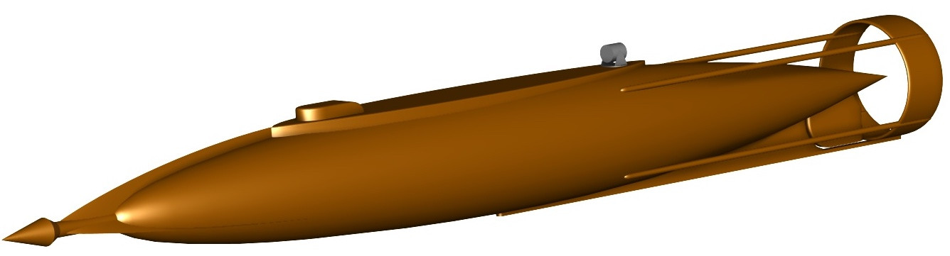

    DrSchmidt -
    I agree mine looks completely like a brick, but...It looks like that for a good reason =P the roof of the wheelhouse retracts into the hull and has to seal all the way around when it does so. Also it needs to be 2 meters wide from front to back to allow room for all the controls and Nemo. If it is rounded at the front (which I totally prefer looks-wise) the controls would have to be moved back far enough that there would not be room inside for the captain and or crew. Also the portholes on the top and bottom of the wheelhouse need to align in order to see out the front when it is retracted. The model you built looks great though=) It might be possible for me to round the front of the deck to match the rounded leading edge of the roof as you drew it if I can cram everything in there as Verne described it though. I'll see what I can do. This stuff is why I included an interior layout as well. I'm trying to make it all work as Verne described if I can.
    The ram point should be triangular in shape though when looking at it from the front. If you notice in my drawing the front of the deck (where the lower porthole goes) is cut out from the front to the leading edge of the wheelhouse top so the porthole can be inset behind the strake.​

  • DrSchmidt
    replied
    That's it....I did a bit more streamlined bridge, as the one in your PDF looks like a brick ;-)

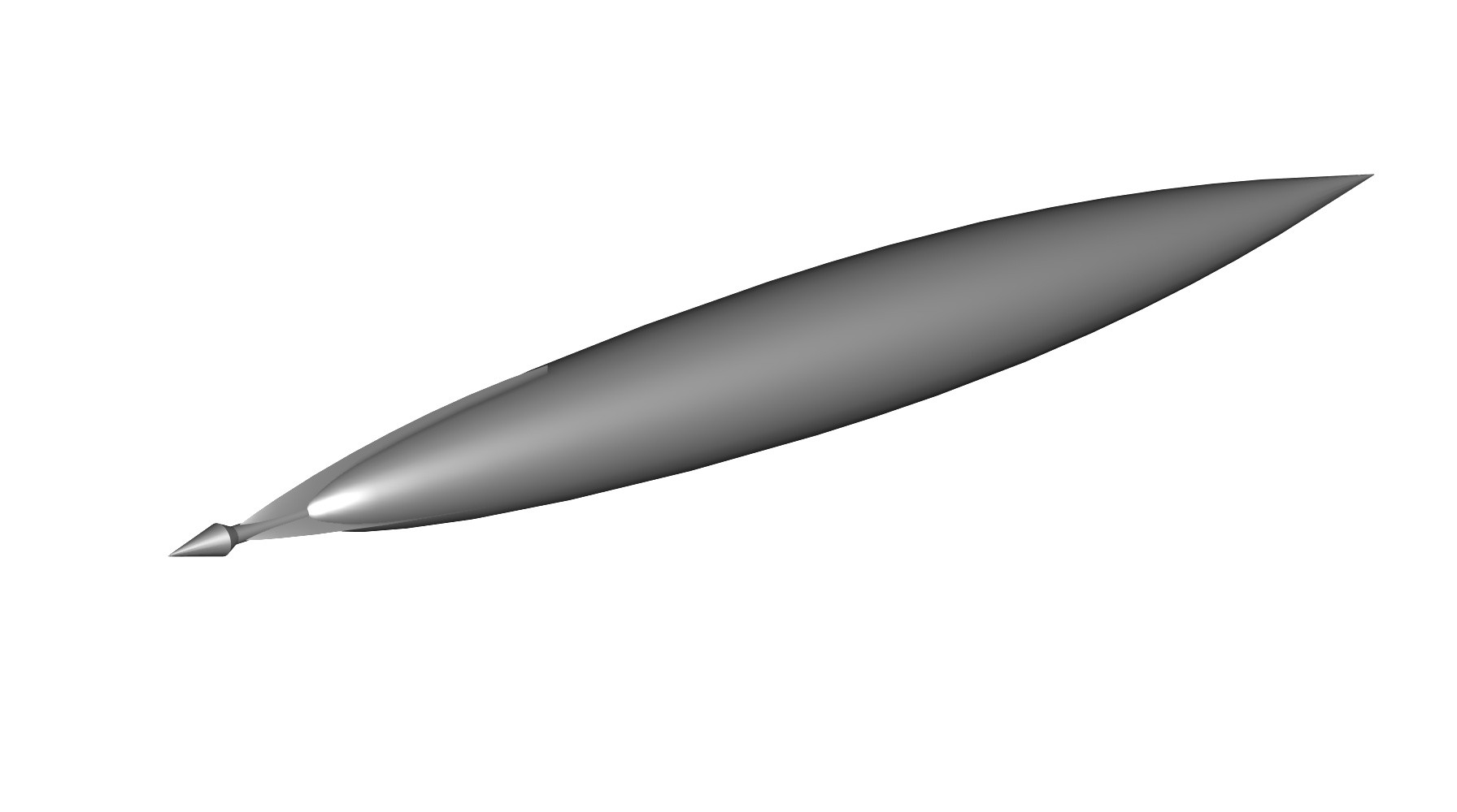

    Is your PDF based on a CAD-model?
    Click image for larger version  Name:	Nautilus.jpg Views:	0 Size:	73.3 KB ID:	168068

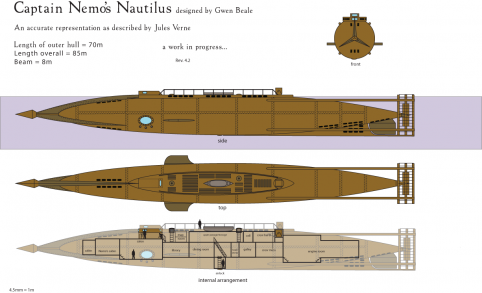

    Originally posted by GwenB
    Updated Nautilus drawing. I added hull drain vents and an aft keel to better protect the rudder.
    [ATTACH]n168058[/ATTACH]
    Tidy up that birdcage back aft and I think you've got it.
    Leave a comment:
  • GwenB
    replied
    Nautilus-Gwen42.pdf
