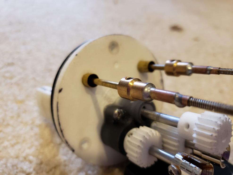

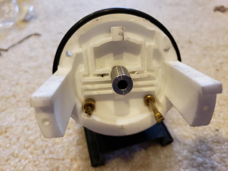

    The entire outer bushing (the brass tube you can see on the outside) pushed out of the bulkhead so the water went right around the whole thing and through the hole in the bulkhead. The cup seal assembly seems ok but the outer tube is not sealed well enough in the bulkhead. And I plan to refit all my servo openings on the WTC to make sure this doesn't happen again. I'm thinking that I should use CA on the outer surface of the tube where it passes through the bulkhead so it's held in place. And then use silicone glue around the tube on the outside of the bulkhead to help seal any possible leaks around the tube. What do you think?
    I see what you are saying about the cup seal housing not secured to the bulkhead. I have always used thin CA to secure the housing to the inside of my PLA 3D printed bulkheads, I then applied silicone around the EXSTERIOR portion of the brass housing coming out of the bulkhead. Not sure what material your bulkhead is made of, so you would need to see if CA would apply here or not!? It works great on PLA. If it will work just make sure you scuff up the outside of the bushing before installing.

    Originally posted by Bob Gato
    Those look like cup seals in a brass housing with a bushing behind...Remove the cup seal and clean-Clean- CLEAN the seating area (q-tip and Iso)...polish the brass rod shiny ..Clean the new cupseals of parting agent with alcohol and glue in new seals using good grade 100% silicone RTV. lube the brass rod and seals with any of the magic greases that everyone swears by on this forum...Did they come apart? I like to leave the curl from the tube cutter to prevent the seal from coming out with out anything but a strong pull and a twist-if its not there think about gluing (CA or epoxy) in the next size down of brass tube to act as a retainer for the seal.
    Update: I can see the curl on the bushing side but don't see any thing to retain the cupseal on the other side-that is a lot to ask of the RTV. I would def think about gluing in a 3/32-1/8" sliver of brass tube over the seal-

    OK Rob, here are a couple photos of the bulkhead and servo pushrod bushings.

    Now - Who can tell me what is the best way to keep the servo bushings nice and tight in the bulkheads without risk of what just happened to me happening again? I'm thinking either silicone glue or CA glue.

    I carefully disassembled, cleaned, and dried all the components with a blow-dryer last night. I left everything to air out over night and this morning I reconnected everything and am pleased to report that every single component is working properly. No problems at all. Thanks guys!

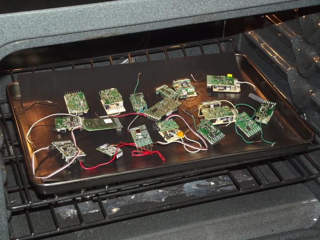

    Preheat your oven to the minimum 175-degrees, place a thermometer inside and wait for the temperature to drop to the safe range, then quickly place the cookie-sheet supported PCB's in there and let everything sit till the oven returns to ambient temperature. Or make a plenum out of a small cardboard box and discharge your hairdryer into it for a day -- place a thermometer in the plenum to insure you don't exceed the safe minimum temperature.

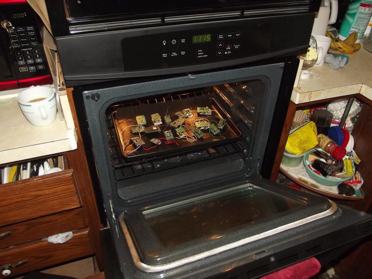

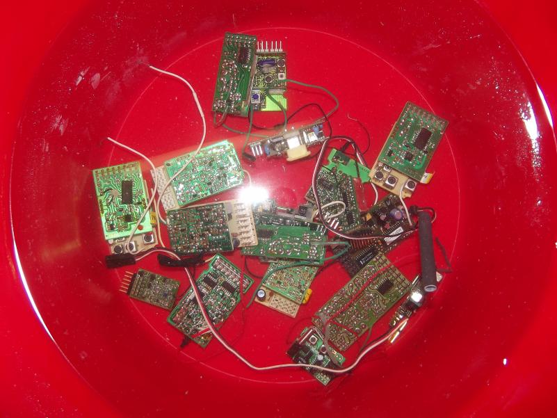

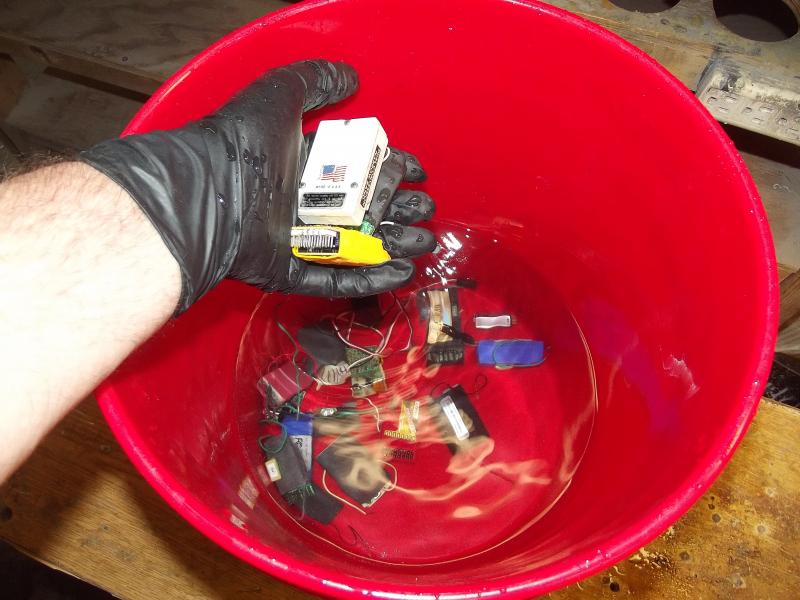

    Remove the heat-shrink from all devices that use it to cover the PCB; pull the wet servos, open them up to expose the PCB, motor, and potentiometer; If the ESC is potted, your good; yank the motor. Dump everything into a bucket of fresh water and vigorously scrub the conductor side of all PCB's with a non-metallic, stiff brush (a glass fiber brush is ideal).
    Click image for larger version Name:	DSCF1227.jpg Views:	0 Size:	63.8 KB ID:	168232
    Click image for larger version Name:	DSCF1229.jpg Views:	0 Size:	73.1 KB ID:	168233
    Dunk again into the fresh water then blow down with medium-pressure air.

    Place everything on a cookie sheet and bake at 150-degrees for 24 hours. It's vital that you place a non-conductive barrier between the PCB's and cookie sheet or you'll slick all the IC's. Do not bake the servo cases, gears, and the like or they'll melt!
