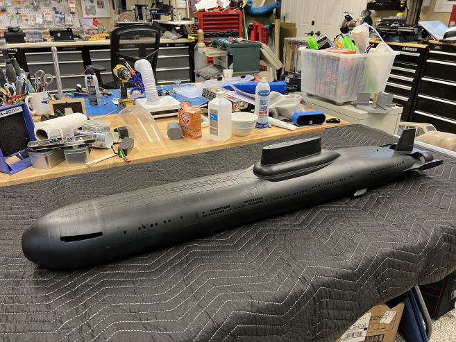

          Here's a little motivation for you! Prints pretty well, I had a little sagging that I never could figure out, but thats what bondo is for....Click image for larger version

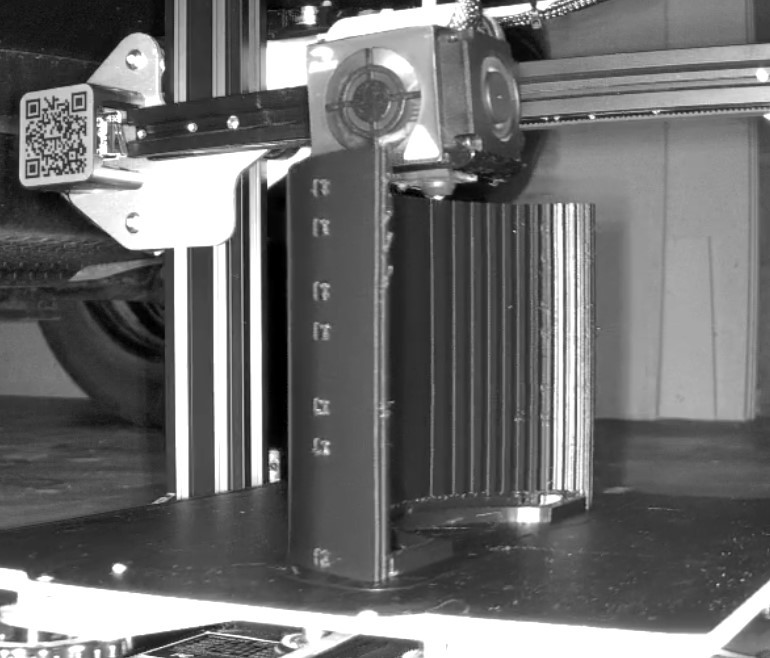

                  Hull 7A part
Name:	Capture d’écran 2022-10-02 214343.jpg
                  it will remain hull 7B and hull 8
                  It takes a long time to print.
                  I am on my third spool of 1kg of PLA​
                  Frank
                  (a belgian submariner)

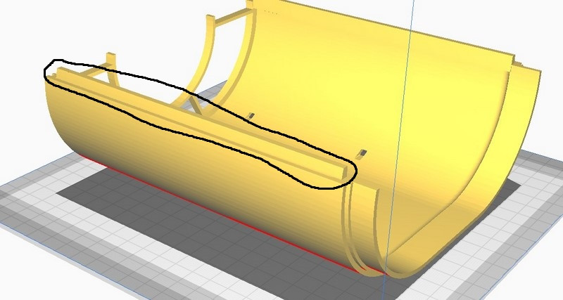

                    small printing problem. On the parts hull 5b, hull 6b and hull 7b, I have the circled part that detaches from the hull. I will have to glue them.​
Name:	Capture d’écran 2022-10-04 182138 (Copier).jpg
                    Frank

                      Hi Frank,
                      As I recall on my first build of the Typhoon using Nautilus Drydocks files, I had a similar situation! I just cleaned up that area and reattached with a quality medium CA. Worked out well for me!
                      I wish I could have finished my Typhoon! I got about half way through the build and somehow (old age) lost my files. I really want to build the Typhoon, so I got a hold of Bob, and he sent me another set of files at no charge! Nautilus Drydocks (Bob & Jason) are really great when it comes to quality parts and go out of their way to help you with your submarine builds!
                      Keep printing away with your Typhoon, and do not get discouraged with the process!

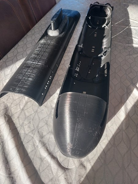

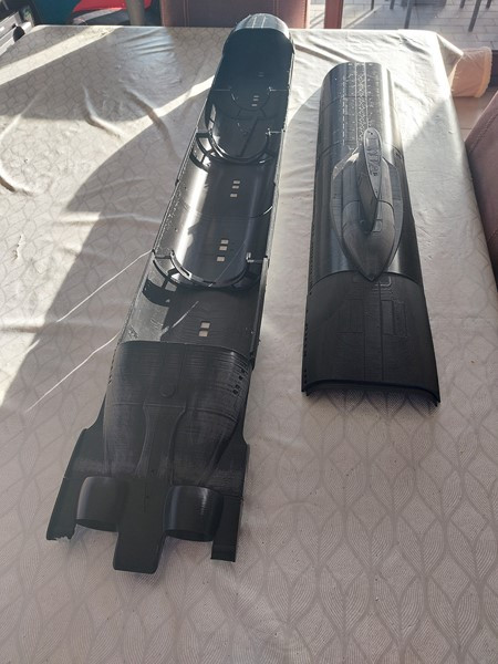

                        Printing finished !!!!
Name:	20221006_175240 (Copier).jpg
Name:	20221006_175311 (Copier).jpg

                          I had the exact same issue with hull sections 5, 6 and 7 - in fact on two of them it didnt print anything at all for those parts. I just printed a bunch of replacement "bars" and glued them on. Don't know what slicer you're using but I used Chitubox initially. I never reprinted these sections sliced with Lychee so dont know if it was a slicer issue or not.
                            Hi Frank,
                            Your Typhoon is looking great! Enjoyed seeing your photos! Well done!

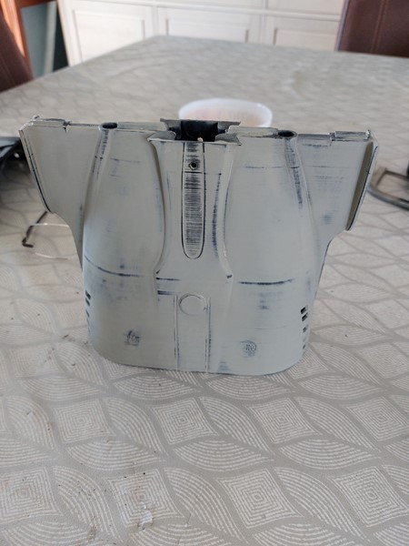

                              Parts 1 and 2: sandpaper 240, spray putty and finish with wet sanding (600 sandpaper)
Name:	20221010_111835 (Copier).jpg

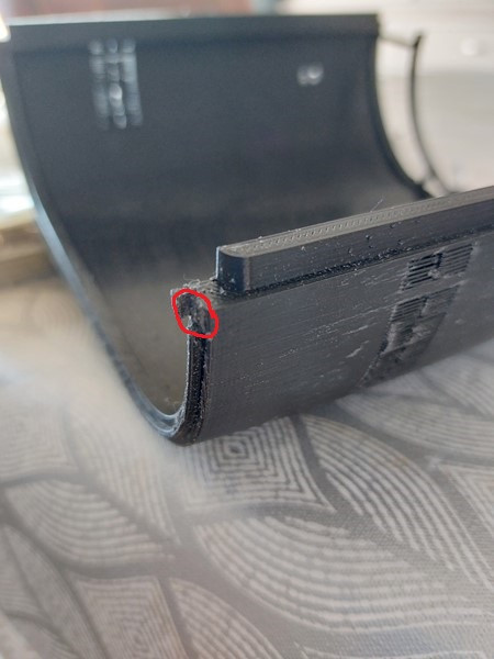

                              Then, I had to make changes to parts 2 and 3 so that they fit together.​
                              in the red circle, 5mm cut​

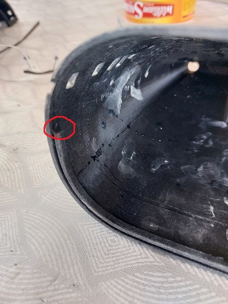

                              piece cut here too​
