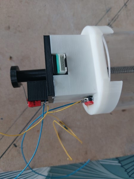

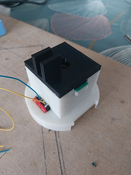

        It will be a 1 liter piston tank. I will be using a NEMA17 stepper motor.
        It will be controlled by an ARDUINO UNO

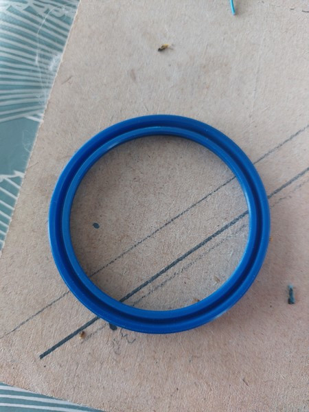

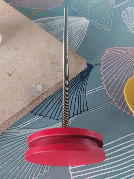

        I started making the piston with 2 o-rings. Problem, either the water passed or it was impossible to slide the piston.
        So I printed a new piston for hydraulic seal.​
        the piston

        The seal

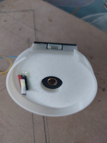

        I printed a piece of motor support and limit switch support​

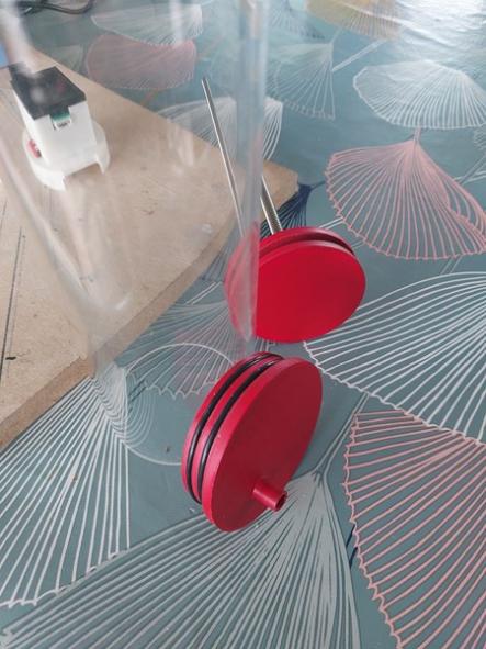

        and the closing plug with the water intake​
