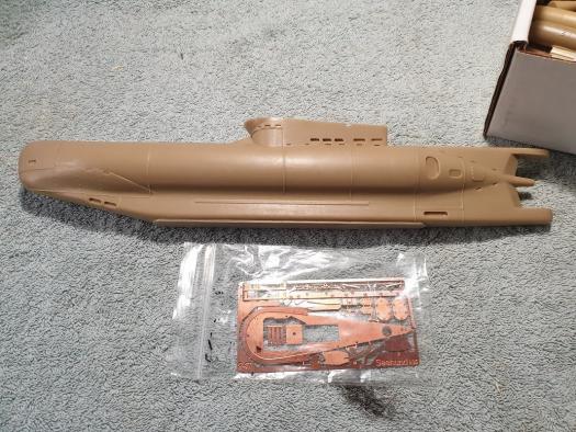

                Nick,
                Plastick models are only suited as wet models, running them dry is asking for troubles, it's better to make a hull from epoxy.

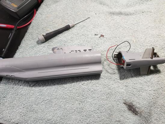

                Your question about the Verlinden Seehund,
                This is the resin hull i own, PE parts and other resin parts to make a complete Seehund.

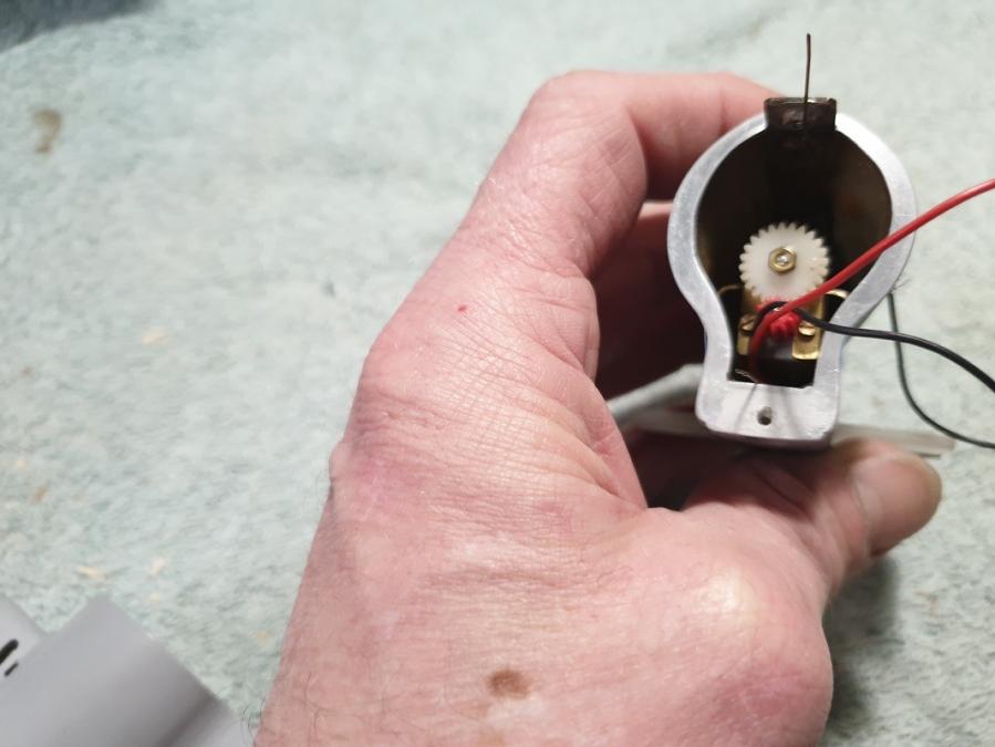

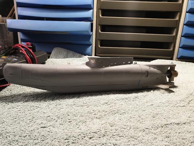

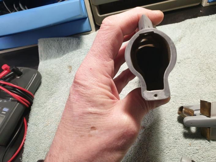

                This is the one my mentor made, i suspect he made a mold from the Verlinden Seehund, followed pretty much the same way as with the Bibers.
                Same layout as with the Bibers, same method of sealing it up.
                You split the Seehund this way, screw are hidden when put together.

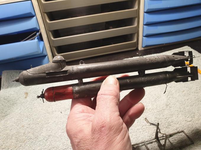

                If you like really small, builded this Marder scale 1:35 a few years ago, controlling it with a toy-transmittor, it's a suface runner, don't want it to push too far.
                Romel,
                That ain't gonna happen, my plate is full, got other projects to do, it seems that people forget that building micro is as hard as building big, and the result is a bathtub submarine, i'm more a open water guy.

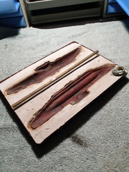

                    Traditional build as two halves from the mold, glued/epoxied to make one hull.
                    This is the mold i still have from the Bibers, he used gipsen to stabilise the mold, probably started it with pusing down the resin model halfway untill the gipsen turned hard, used the same method in the past, disadvantage is, only usable a few times, i used mine one time to get me the hull i wanted, smashed it to retrieve the epoxy hull.
                    Now i build my molds to last, those days, we wanted models which were not availibe didn't matter how.

                        Thank you for taking the time to show the mold and explain the process. Looks like he first made the soft rubber mold like rtv to capture the fine details and the gypsum as a hard support for the rubber. Very similar to using rtv rubber with a hard fiberglass backing. Very clever.

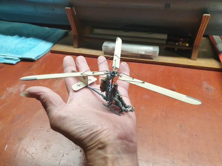

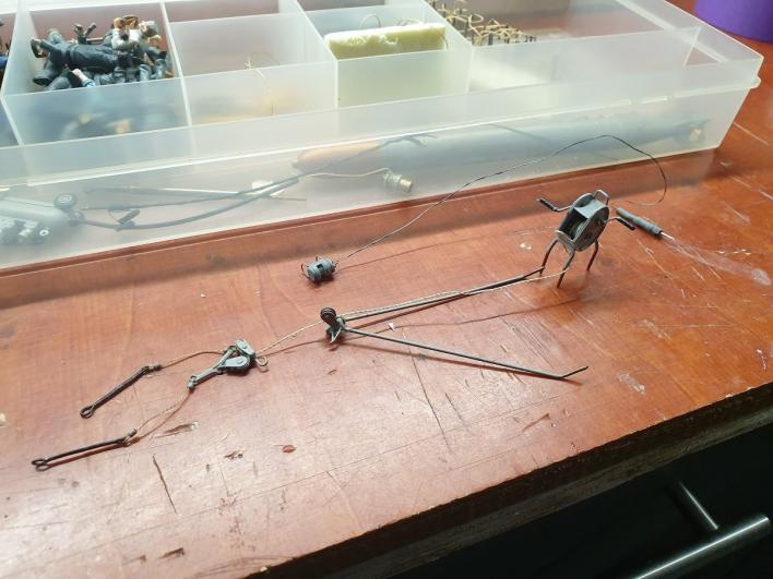

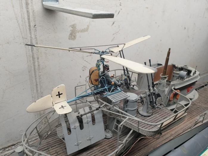

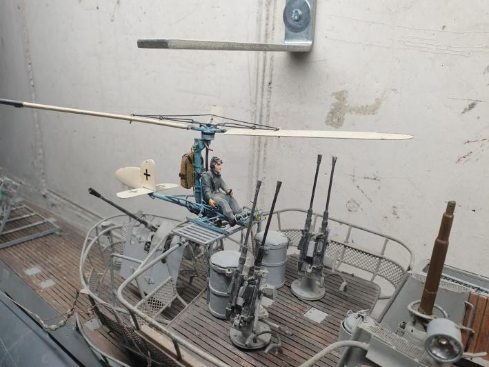

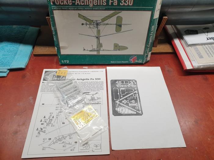

                            To keep things together i decided to give the update about my mentors work on this thread, so people can find all the info in one place.
                            All things has to do with the display he builded for the type VII, if i remind right he could build up three differend variations, one was torpedo loading, the other with the Bibers and the Bachelstelze and a third one with a rocket launcher on the rear deck.
                            Click image for larger version  Name:	20260721_205645.jpg Views:	0 Size:	52.5 KB ID:	196632
                            This was the kit i profided to my mentor, he enlarged the PE parts to scale 1/35.
                            Click image for larger version  Name:	20260721_205651.jpg Views:	0 Size:	56.9 KB ID:	196633

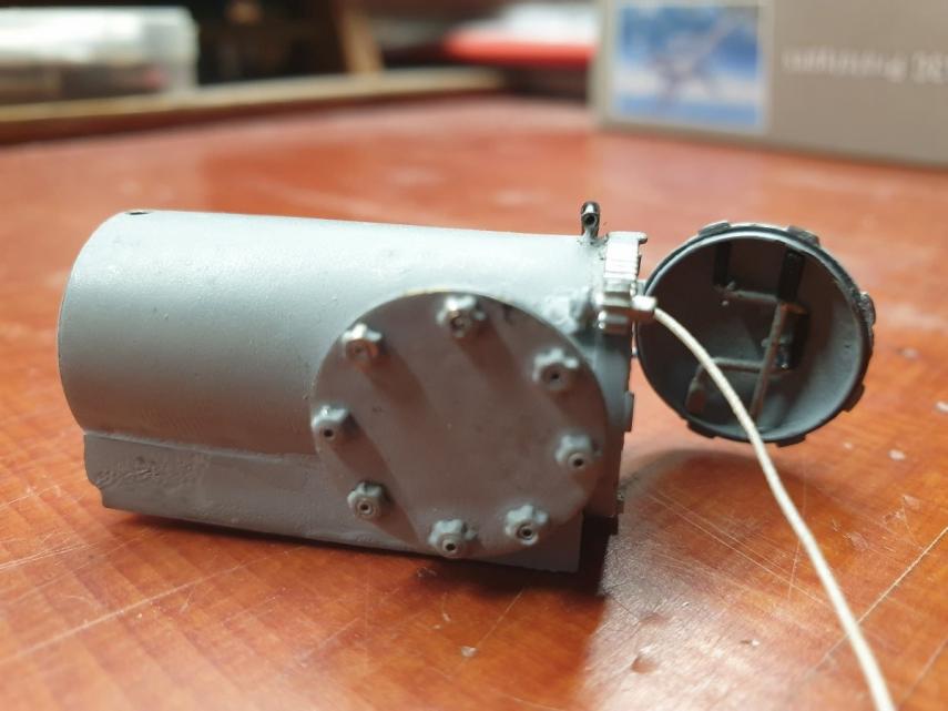

                            The final result on the conningtower, only thing is, this was only done on the type IX submarines, due to the room left on the upperdeck, on a type VII there isn't much room, so taking off the 20 mm flak will create some room.

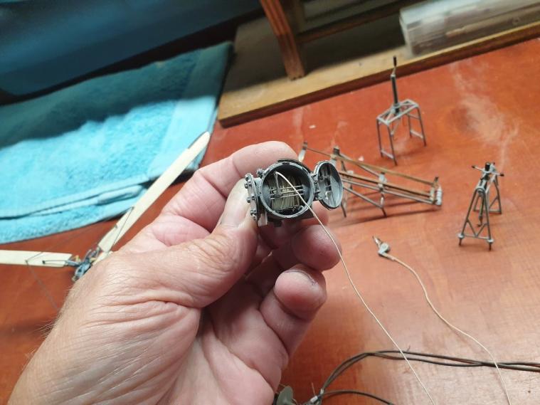

                            Click image for larger version  Name:	20260721_205814.jpg Views:	3 Size:	51.1 KB ID:	196635
                            The size compared to my hand, extra gizmo is a E motor hidden in the Bachelstelze, there is a electric connections present which powers the Bachelstelze.

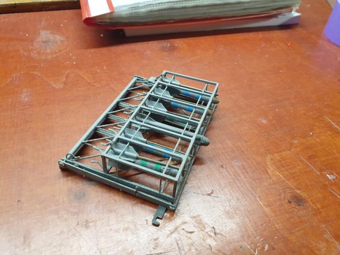

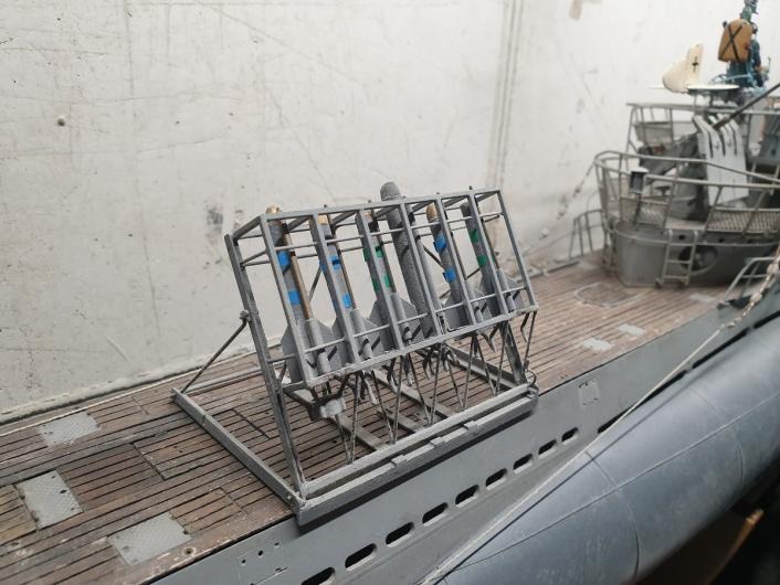

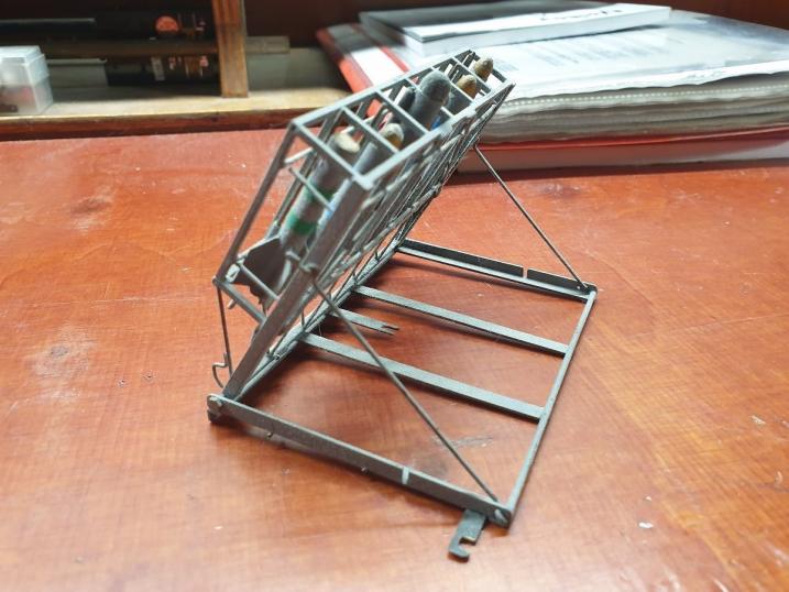

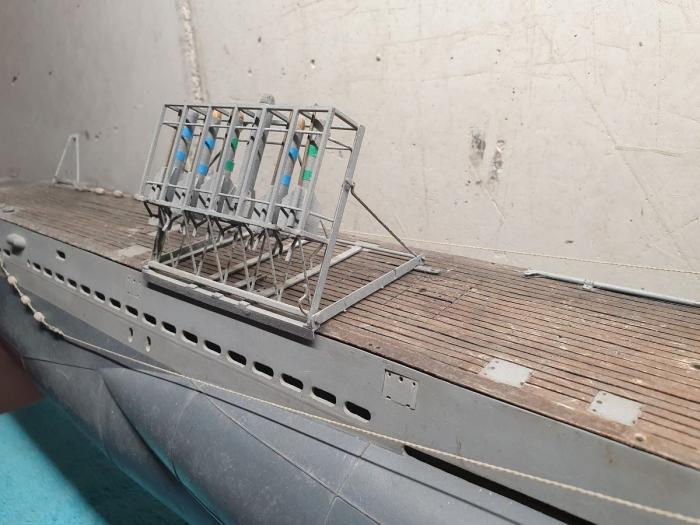

                              A rocketlauncher for rockets type 40, the germans did some experiments launching them from submerged as surfaced boats, a captain of a U Boat had a brother working at the rocketcenter at Peenemunde, they wondered if launching rockets from U Boats could be done, beside some experimental launches it never materialised.
                              Just like the real thing it can fold down, my mentors idea was to launch baby rockets, by using glowplugs he could light the fuses, to my knowlegde he never did, due to my experience with the OSA II i know you have to guide them in a proper way, in this configuration you can wait on the mayhem after launch.

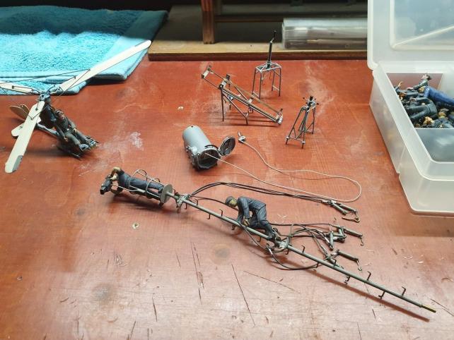

                                This is about the extra things he made to support the display.

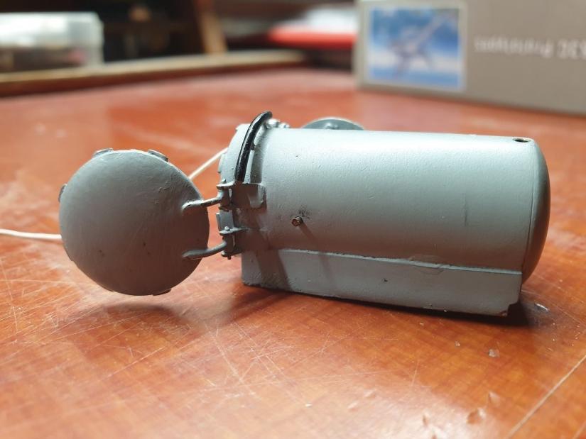

                                Talking about details, he made the complete winch for the Bachelstelze complete with the internals
                                Both sides of the winch, tools for building up the Bachelstelze are on the inside of the hatch.
                                Some more items made for the torpedo display, in the background a cradle for the front torpedo and the hoist devices for lifting the spare tubes under the deck, the pole with the camera guy i made in the past, had to adjust some things to place it on this boat.

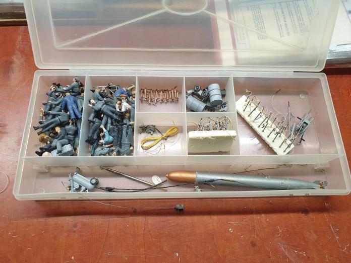

                                The box with the crew and some other stuff for the different displays.
