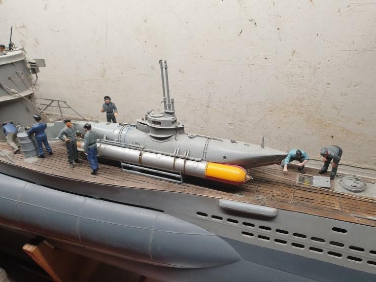

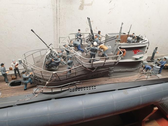

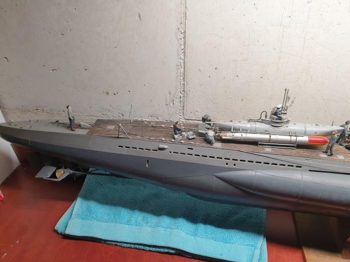

    Last Batch, last winter i tried to build up a display, made those pictures to remind me which item has to stand where.

      The depth and exactness of detail; all human made; figures that stink of life; and all arrayed as though a snap-shot out of past realities. Magnificent work!

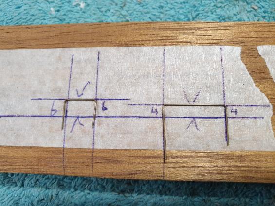

          Those rockets are kept inside the launcher with some additionel framing, this is the first stage, by using a bendingmould they are each time the same.

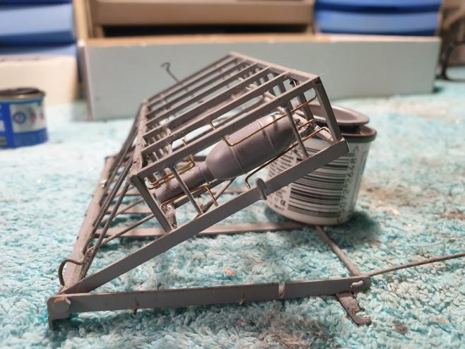

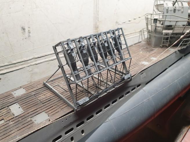

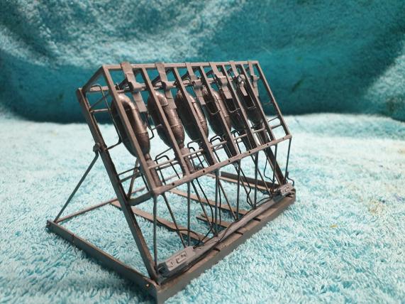

          First contraption soldered inside the launcher, i'm really NOT looking forward to repeat this process 6 times, i hate repeating the same things over and over, i noticed one thing on this arragement, need to place a small ring to keep the rocket at it's desired position, that will be noted down for the future, now i know this will work a can start making all the frames and a mold to get me some rockets.

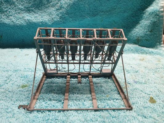

            First started with bending all frame parts i need for inside the launcher, it will take some time to get all those frames at their place inside the launcher, have to do this step by step and take my time for this.

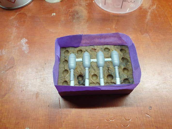

            First stage in building a mold for the rockets, pretty much the same as David does with his molds.

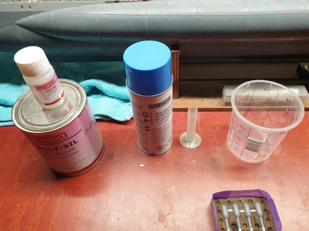

            All the stuff at hand to start with pouring the silicone, ordered some new because the old silicone was over due, that blue capped bottle is mold release, very important when molding stuff.

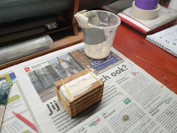

            No pics of the first silicone pour, this is the second pour, normally i let it cure for 24 hrs before releasing it.
