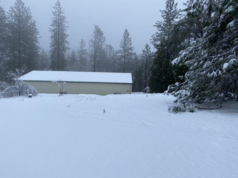

          We expected this storm so I prepared and brought up the fire wood supply to the house and fuel for the equipment.
          The shop, field and road covered in snow.

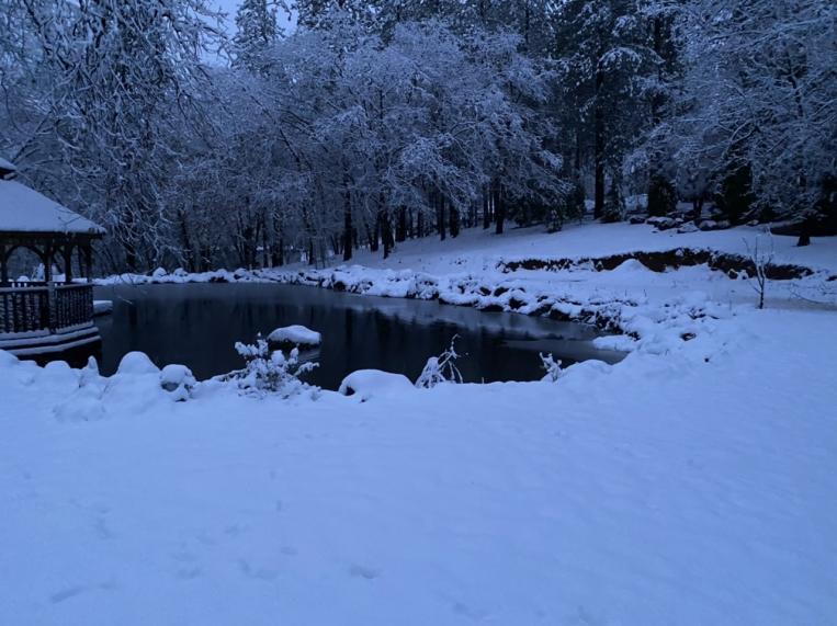

          The back pond about 6:30am. Still lots of sounds of trees and limbs falling from the heavy wet snow in the background going on.

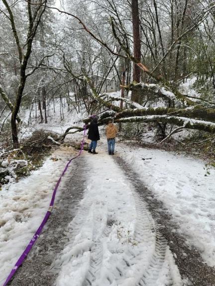

ID:	157405 Cutting one of the many downed trees out of the road and off of the lines later Monday morning.
          One of the downed big oaks we cut through. Monday morning was a mess.

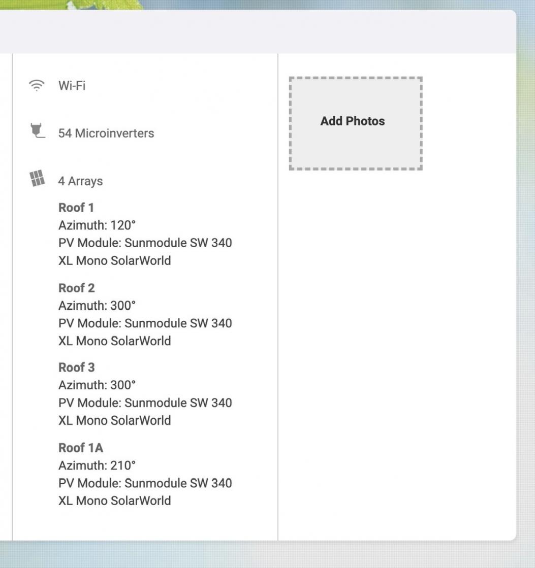

                            Before the start of the most current phase of the solar/back up system we had already installed 54 340W solar panels. 38 of those panels are for the 240V 3 phase electrical service which provides power to the shop and some large water pumps.
                            The other 16 panels supply power to the 240V single phase house electrical service panel. We just added 5 more 360W solar panels to this system so we now have a total of 59 panels.
                            Here are some screen shots of the energy production from about 6 months ago when we began the planning for the current stage of this project of adding 5 more panels, the Tesla PowerWall back up batteries and the 25kW back up generator.
                            Here is a screen shot of all the solar arrays as they are layer out. Roof 1A is the 16 panel system dedicated to the house. This is the solar array we just added 5 more 360W panels to.

                            Screen shot of the specs on the original 54 panels.

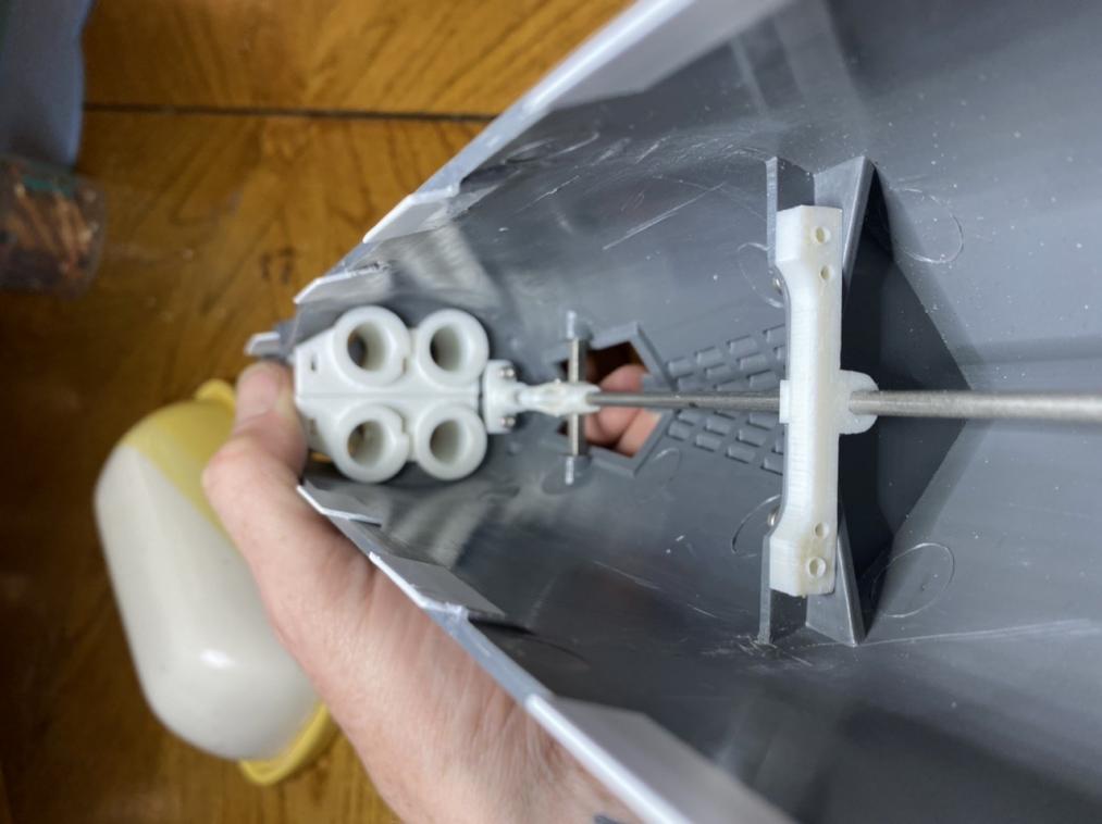

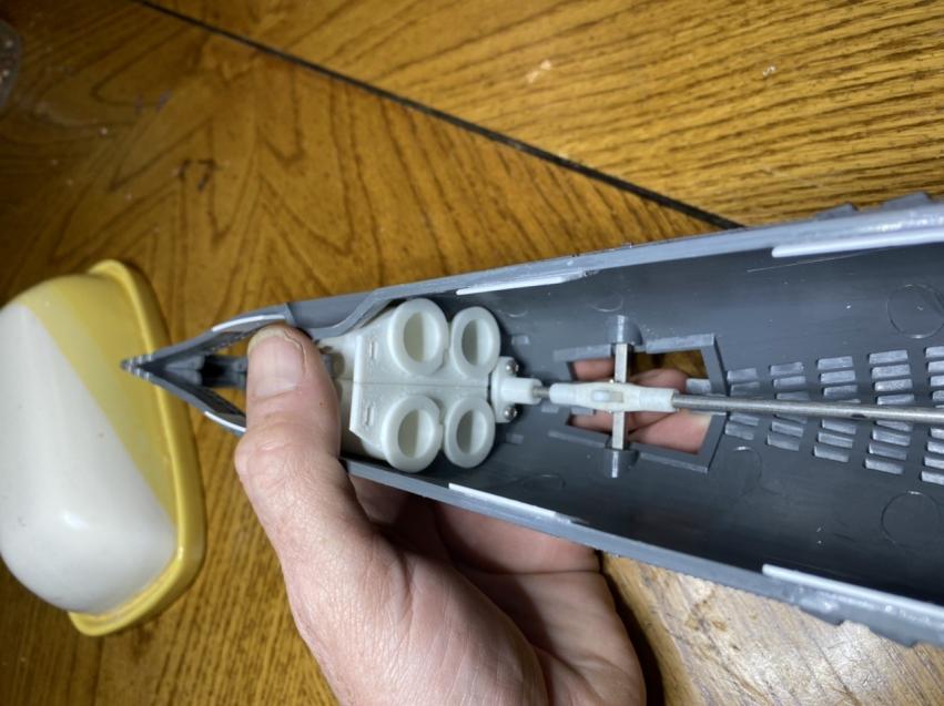

                                First time since I started this project last year that I’ve seen the four forward torpedo launch tubes together finally in the hull. The port side is fresh off the printer and still needs to be cleaned up and fit but I couldn’t wait to see how it dropped in as is.
