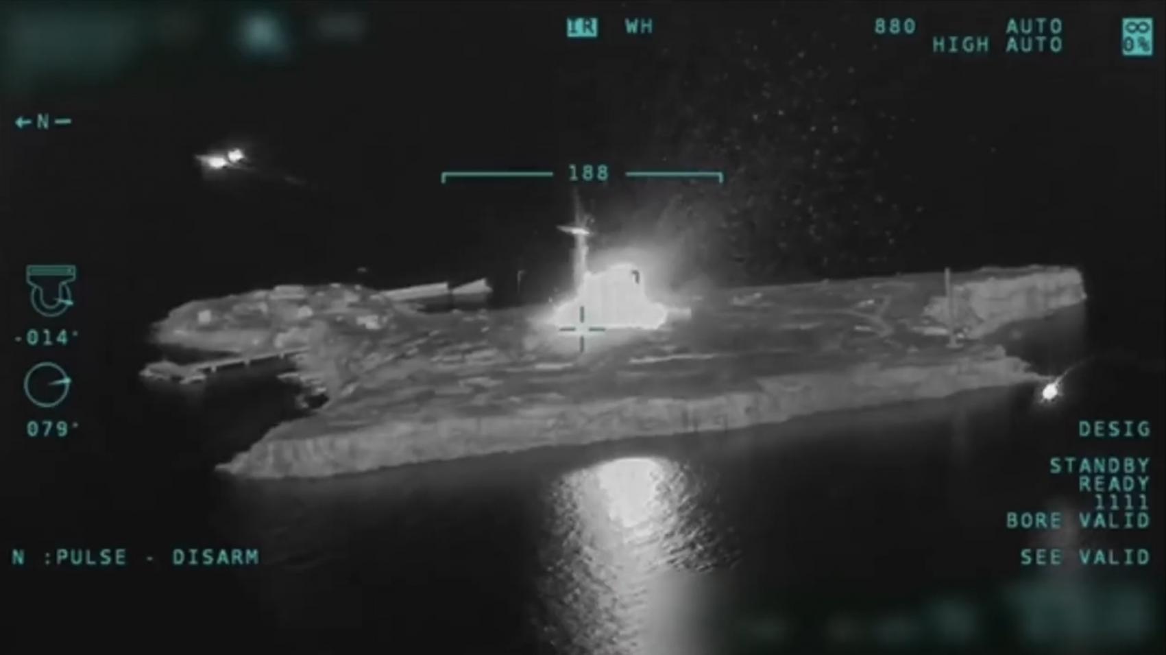

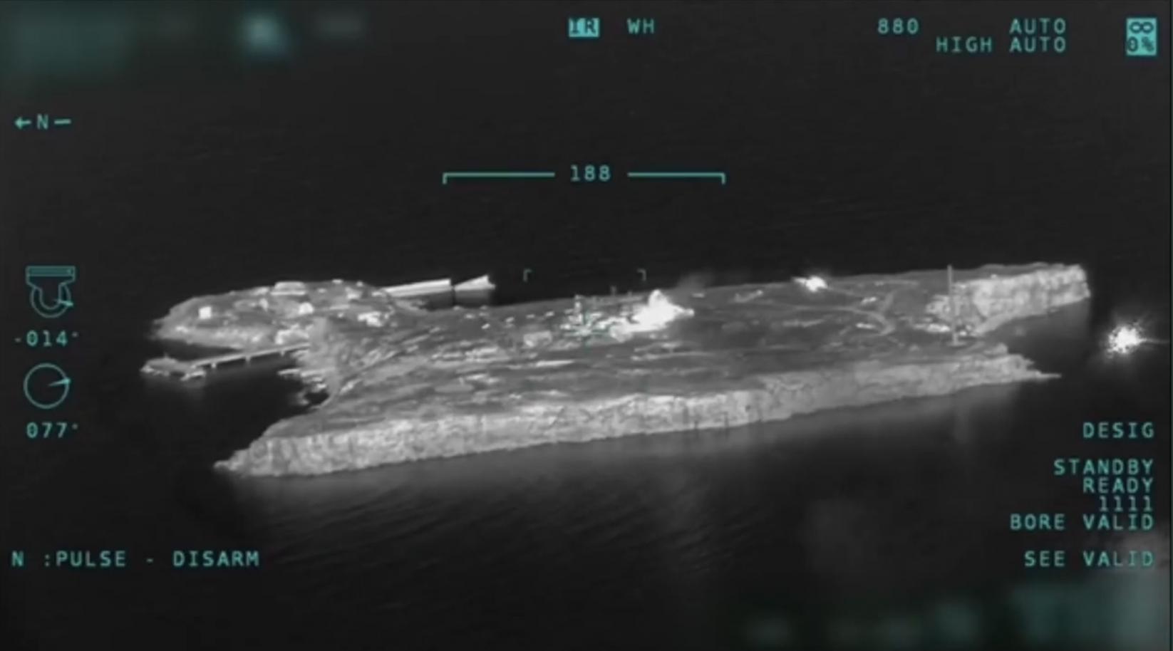

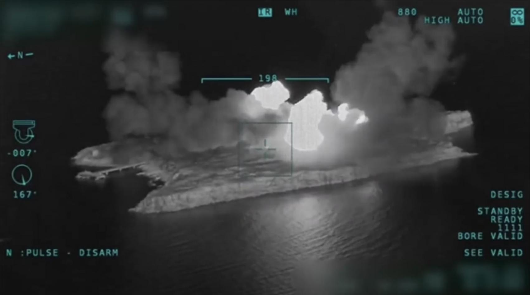

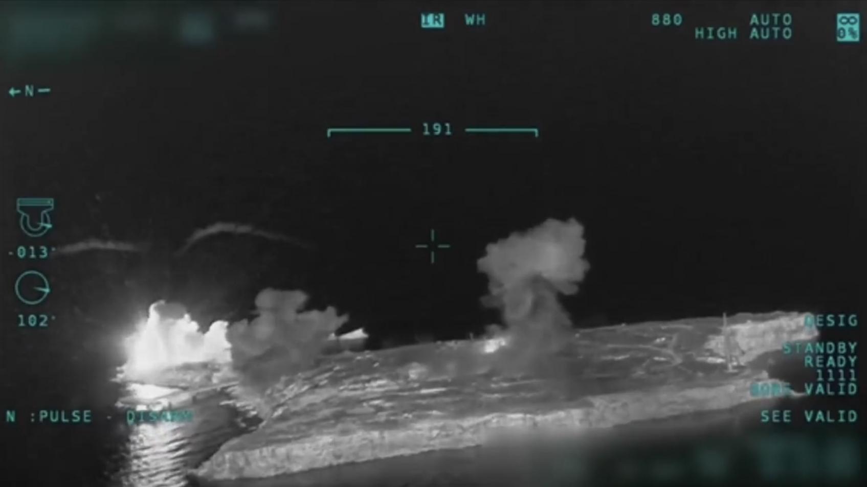

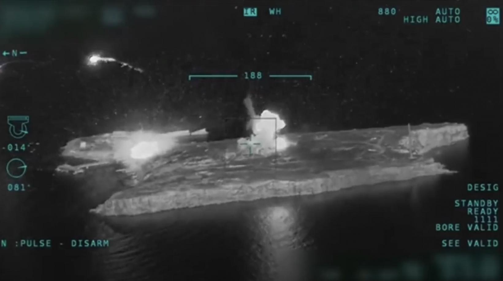

      Meant to post these earlier but I’ve been busy.

        What am i looking at?

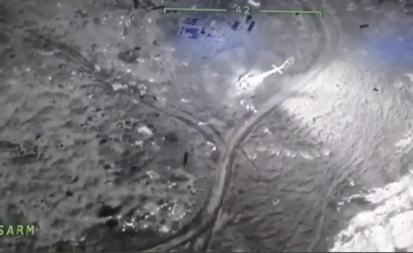

          This is footage from a TB2 drone of Snake Island from the other night of two Ukraine jets striking Russian positions. This was after Ukraine sunk the small Russian landing craft with the Tor defense system onboard. After this attack Ukraine sunk two more Raptor class fast boats near the Island. Wagner group landed a Mi-8 on the island last night and that was destroyed also. Pics below.
