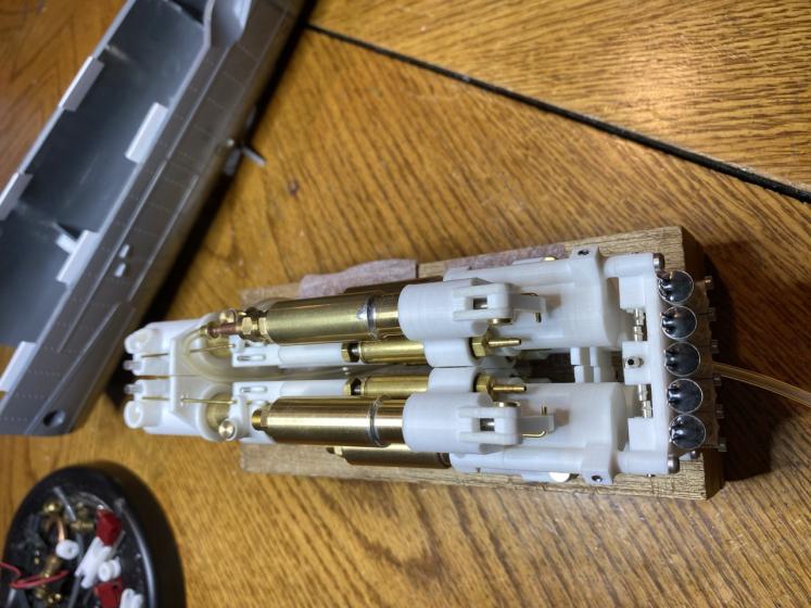

      Manfred,
      Yes the type VII hull space fills up fast as you point out and that I am currently finding. It is my favorite boat design of the war for a lot of reasons. Thank you for your helpful advice and I will apply what you have suggested when it comes time to trim this build. As for the CG of the central ballast tank, I completely agree with you. I’d like it to be more centered. It will be interesting to see how this boat responds the way I have it designed currently. There is still some room to make adjustments.

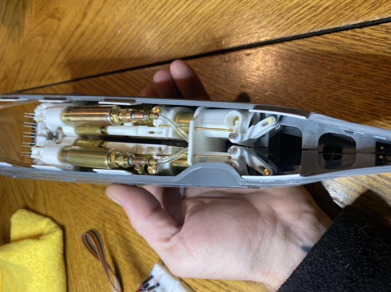

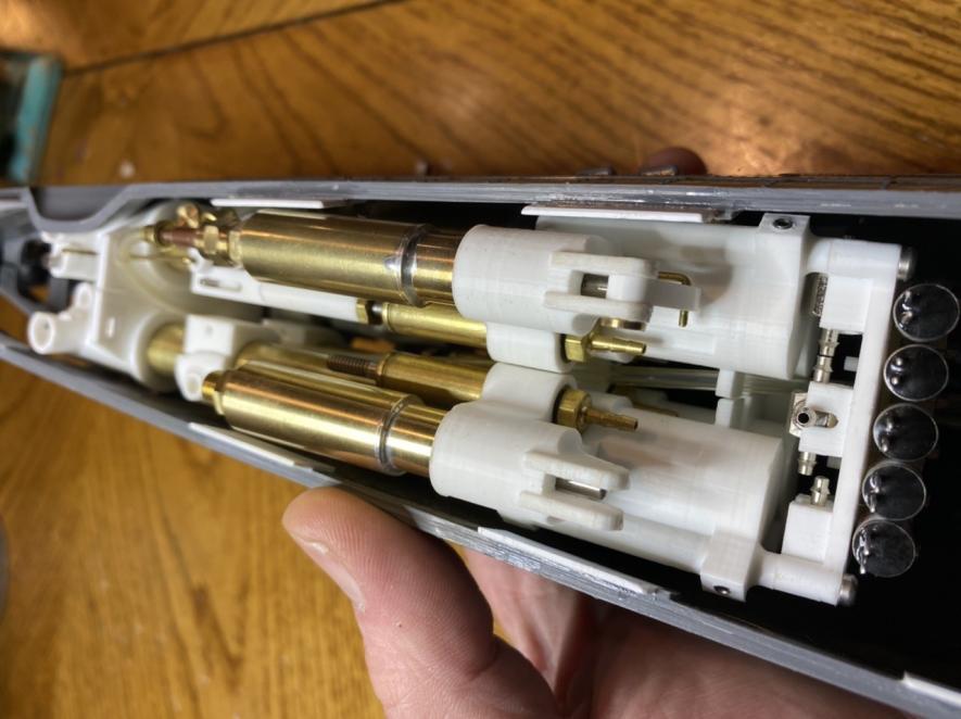

      Got a few more parts for the port side tubes machined and put together today.

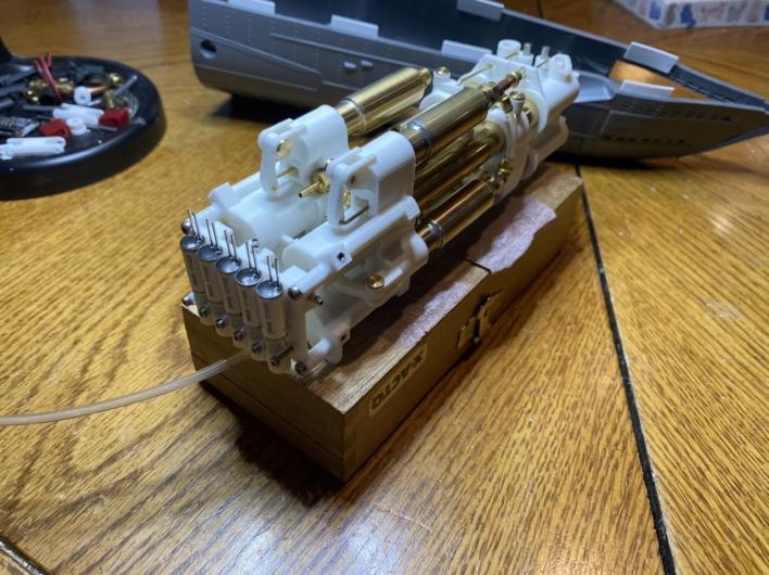

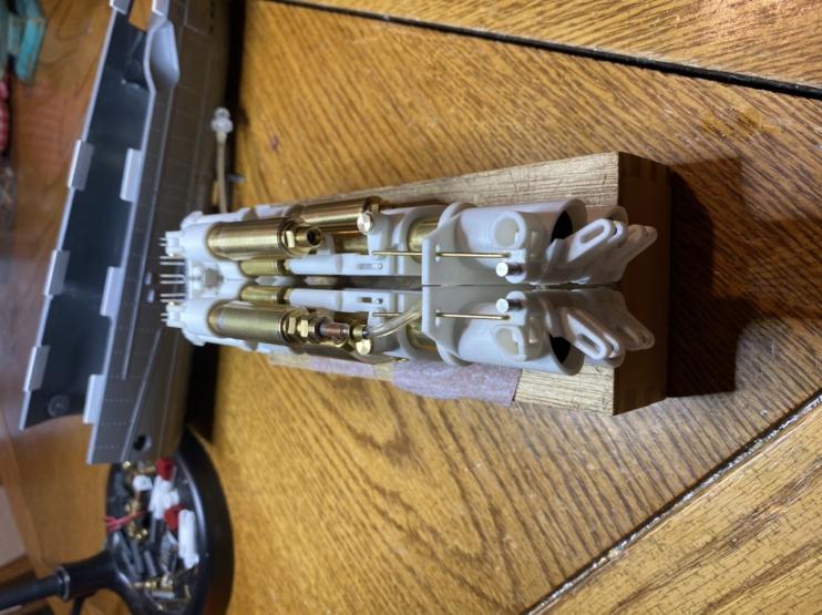

        #153
        Hey Rube Goldberg, here hold my beer…

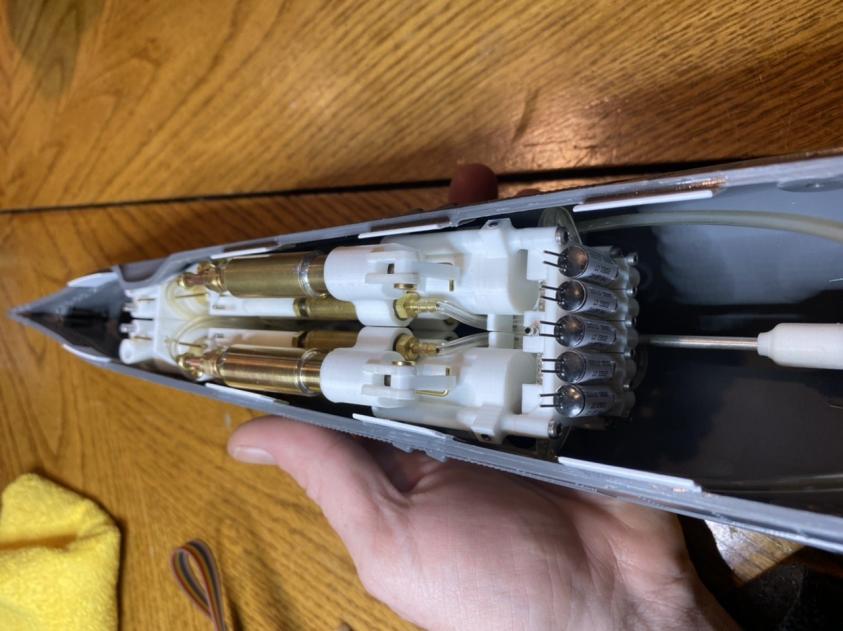

        Starboard side launch tube assembly just about done. Still some minor work to be done and a few more small parts to machine.
        First time since I designed this thing about a year ago that I’ve seen both port and starboard launch assemblies together in person and not just a CAD model on a computer screen. Kinda cool.
        Nick

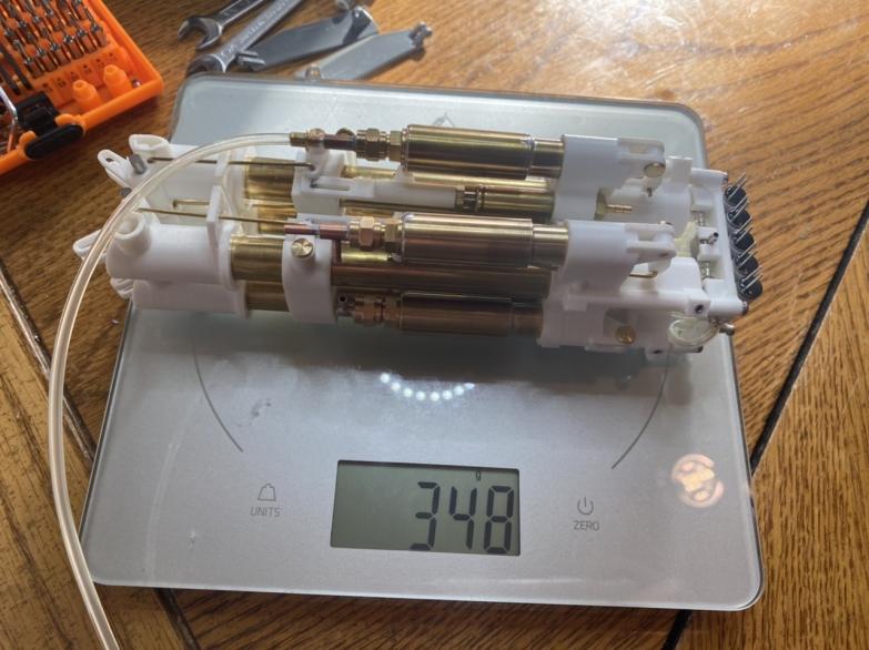

                      That is what i call a snapshot, nice!!!, how much does the complete contraption weigh?
                        Thanks! It is pretty fun to play around with pushing the temporary launch buttons.
                        Borrowed the Mrs. kitchen scale to weigh the complete contraption.
                        348 grams or 12.28 ounces.

                          Nick,
                          Now you know how much bouyency more you need if you don't use foam, as for firing, in the past i used a single servo with five switches, by turning a knob i could choose which tube i wanted to fire, there was a channel controlled relais between the wires, so i could set the switch, and fire by activating the relais.
                          This way i got away with the use of only two channels, now i'm using a multiswitch, one channel is split into 6 relais, much simpler to use.
                          One remark about weight, the stuff on top of your boat must not be bigger as 2% as the total weight underwater, this to counteract the pendulum effect when you raise the boat and when the wind hits your conningtower on the surface.

                            Manfred,
                            Thank you for your help. It is good to know what this launch mechanism actually weighs now. Like you are doing, I am also now using one channel to pick and launch each of the 5 tubes.
                            As far as weight goes, I will need to check the ratio between the below waterline total weight at surfaced level verses the above waterline total weight of everything at surface level. Thanks for sharing that ideal percentage. I’ve done everything I could to stay true to the original design layout of these boats when it comes to the launch tube equipment and where that equipment was placed. Most of it is below waterline. I had to add 7 oz of weight to the forward section already to bring the WTC down. She’s getting heavy but most equipment weight is already placed down low and the cylinder has a lot of buoyancy dry. Close to floating this contraption, so it will be interesting to see where the cards fall.
                            Nick

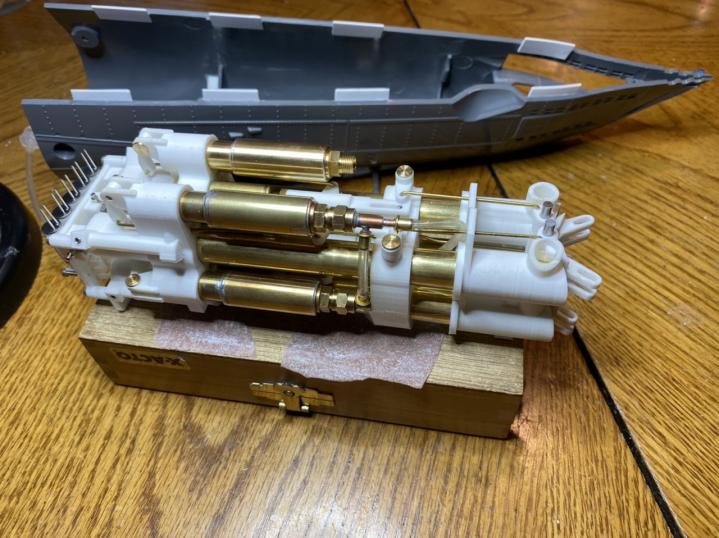

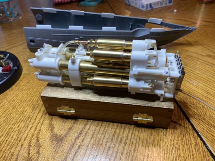

                              #164
                              More completed forward launch tubes

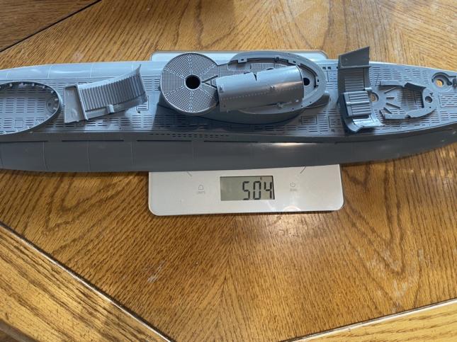

                                #165
                                Since I have separated the Arkmodel type VIIC hull at the waterline from bow to stern, it is very easy to weigh everything above waterline.
                                For those curious what everything above waterline roughly weighs, here ya go.
                                504 grams. I have not included handrails, deck gun or other small bits but those can be weighed separately and added to the total.
