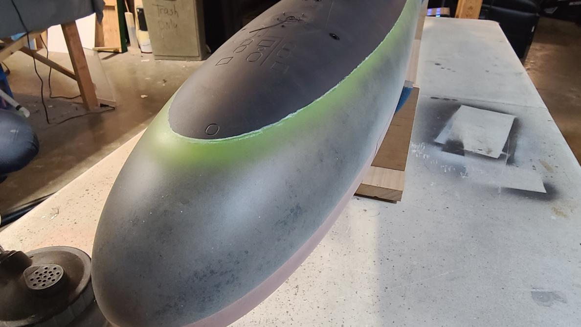

    Dang David! I hadn't even gotten to those things yet but you picked right up on them.
    Zincs...

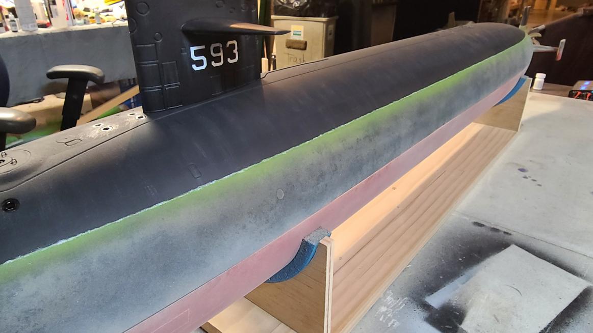

    Subdued sail.

    I ordered some Rub n Buff. I still have to dry brush the edges and high points.
    OK... stop! You're making me look bad! Wow! This beast is shaping up, Steve. What a beaut! And when you're done give this thing a very, very flat clear-coat to protect all your excellent work.

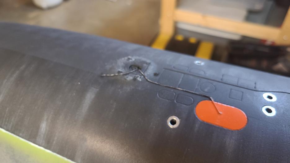

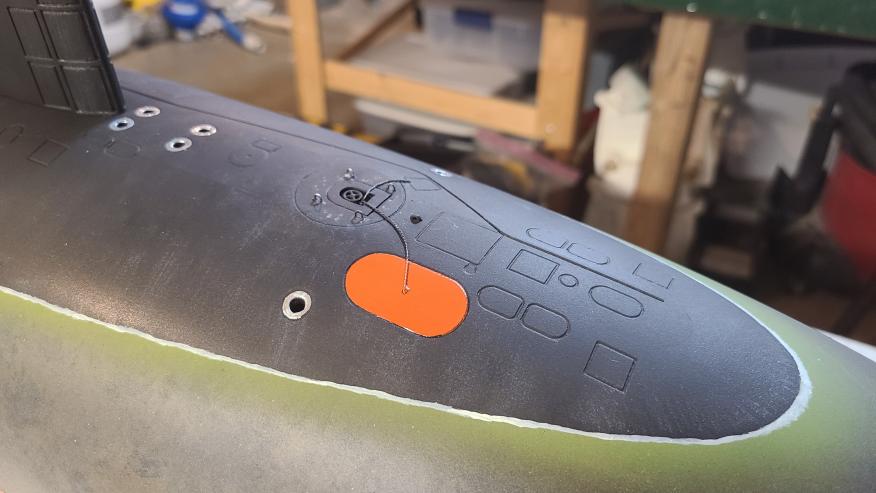

          If there is that much of a scum line and marine growth on the hull, then the boat is in regular service and the orange rescue buoys have long been painted over from orange to black. That’s just something I always notice, but I’m anal. ;)

              I am certainly not in a position to know but David mentioned that having them be orange helps with underwater tracking so I made them orange. Also, since it had not yet completed deep submergence trials would that have mattered at all? I know that the pennant numbers on the sail are often removed but THRESHER still had them when it went down. I am not set on them being orange or black, I just want to know what they likely would have been at time of loss. If the concensus is black it is easily corrected.

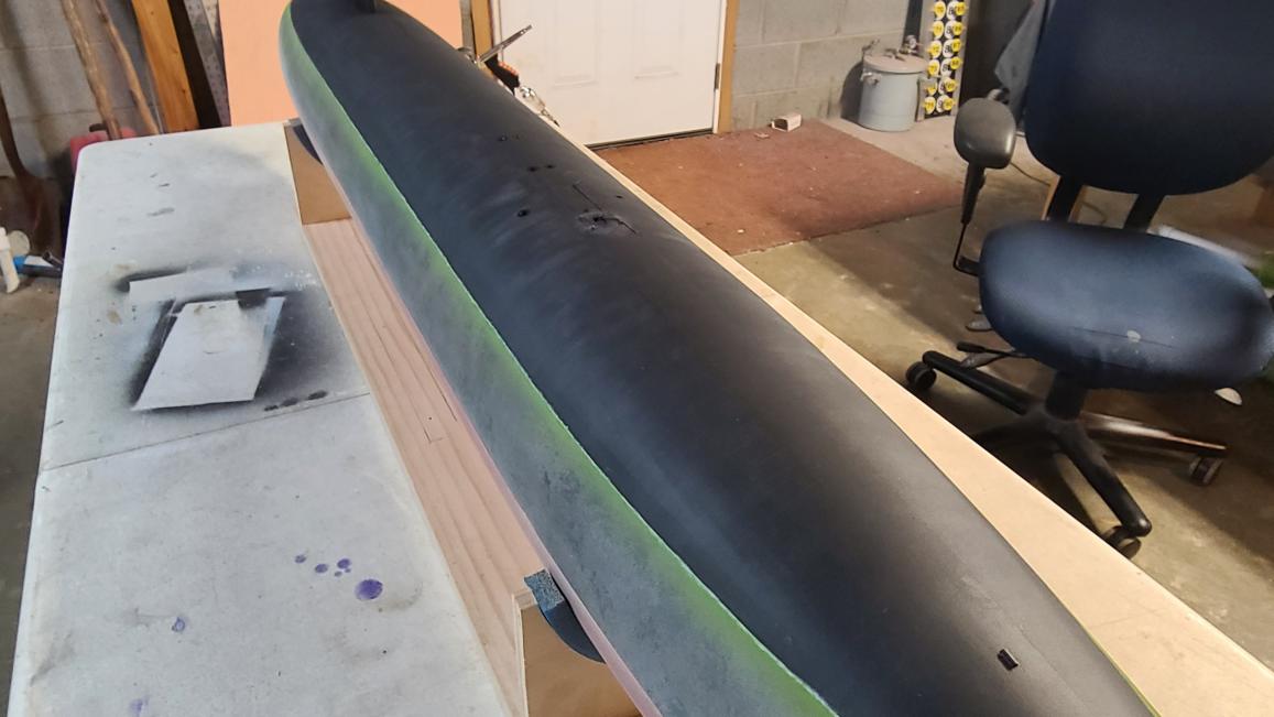

                  Bits and bobbles...

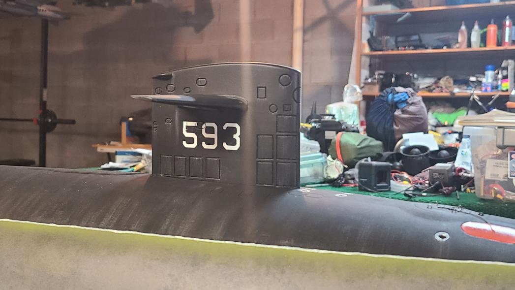

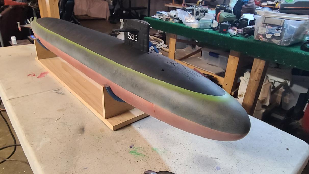

                    Pennant number. Turned out well. David was right about using freshly cut edges of masking tape to prevent bleeding. Next up will be the dry transfers. I have never aligned individual numbers or letters before so it will be a new experience.

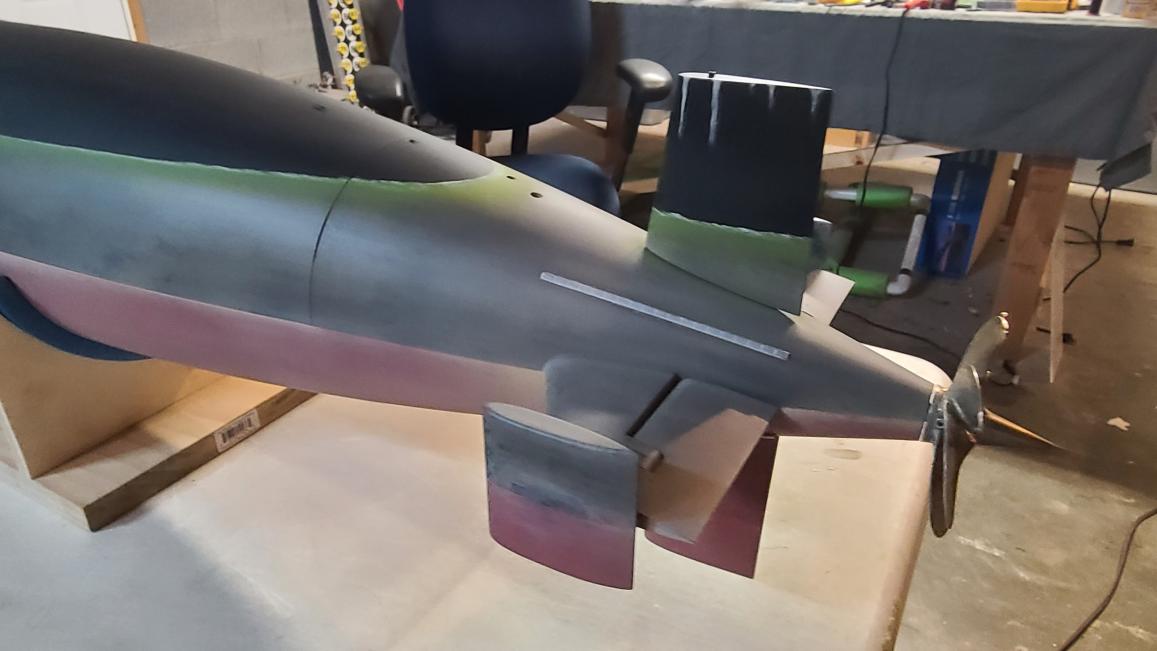

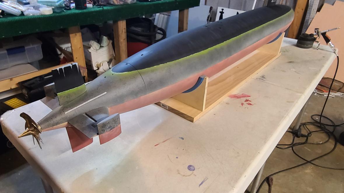

                      Looking closer I believe I set the waterline too high...now I am faced with a what to do question. Leave it or change it?

                        Enough of the huble-pie stuff. You gotta admit: weathering is not as hard as you thought it would be. Right?
                        As to the waterline: Leave it! I didn't even notice it (let me guess, you found out when you started to plot location of draft numbers, right?)

                          Weathering is not that bad and it really makes a huge difference in the presentation of a boat. Yup. The draft number locations got me. I should've paid closer attention to the drawing I was working off of when I set the waterline. Live and learn. I won't be able to sleep tonight if I don't fix it though. Shouldn't be hard to do.

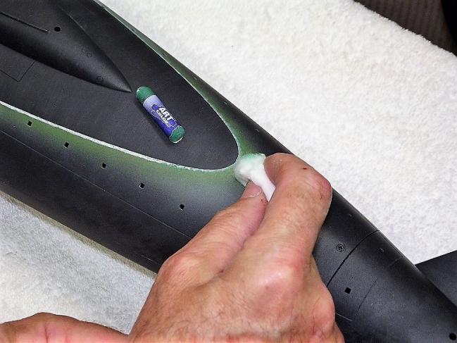

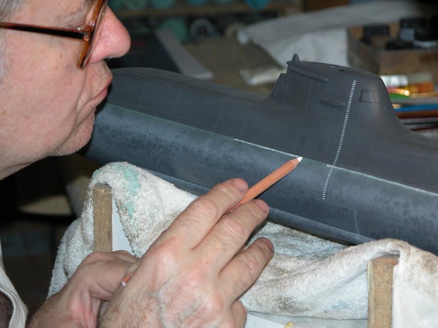

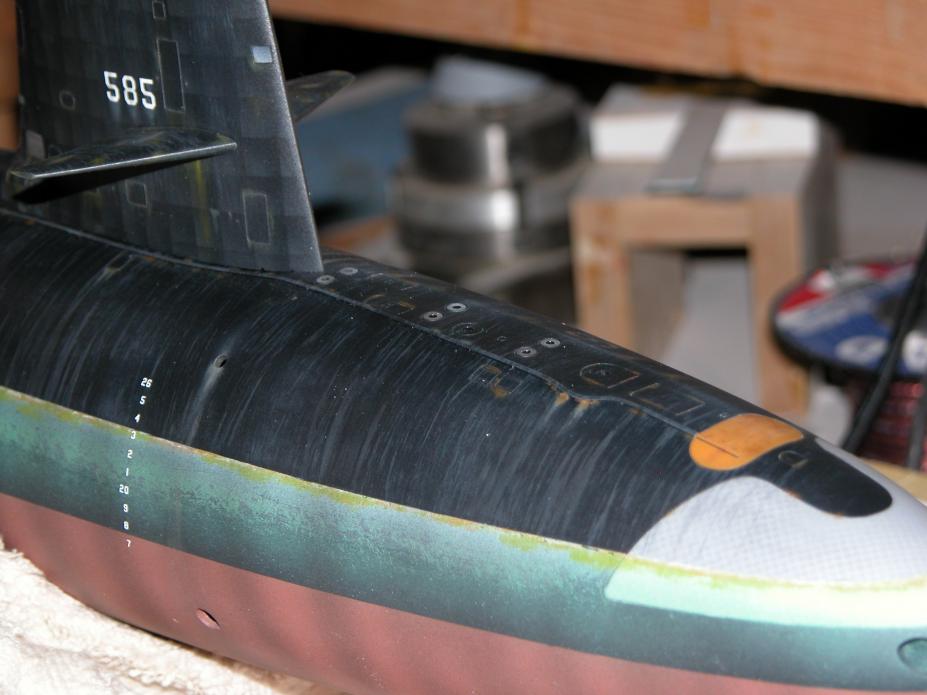

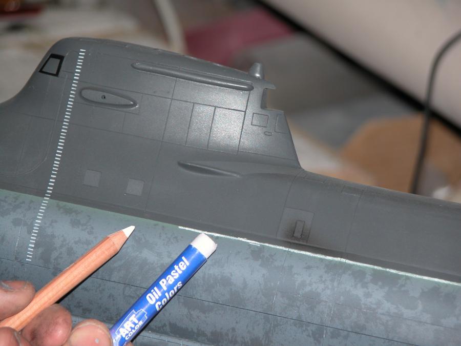

                            LOL. OK. I'm the last guy who should shout at someone for being anal when it comes to their work. Go get 'em, Steve! That boat is going to cut one nasting looking wake when you get it into the water!
                            And tone down the 'white' at the waterline. As you've laid it on now it looks like a slopy job of boot-toping. Just dabs of it, rubbed and blotched with a tight cotton ball or Artist texture stick. Best medium there is pastel crayon, almost lipstick in consistancy. I too have done the occasional awful job of it -- my 1/96 Type-212 being the worst offender.

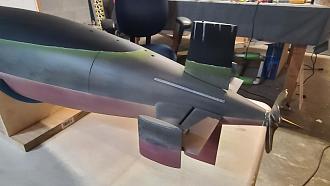

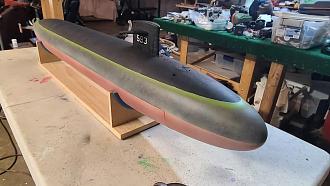

                              Ok. Waterline moved down about 1/2" and the 'white' toned down. I also painted the rescue buoys black. Now I think I am on to dry transfers. At least my waterline is more accurate.
