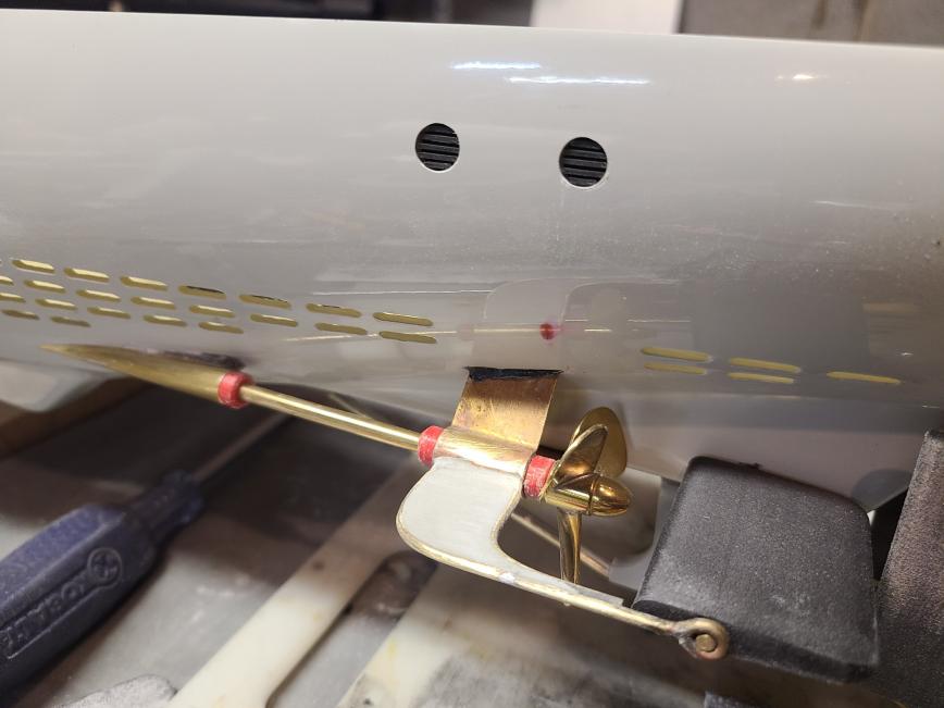

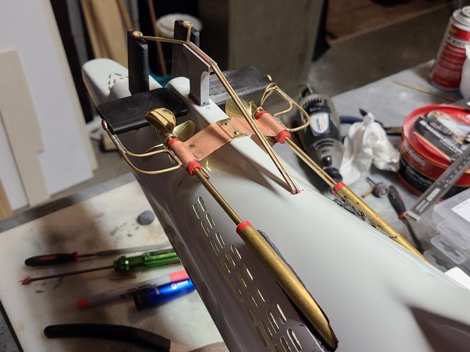

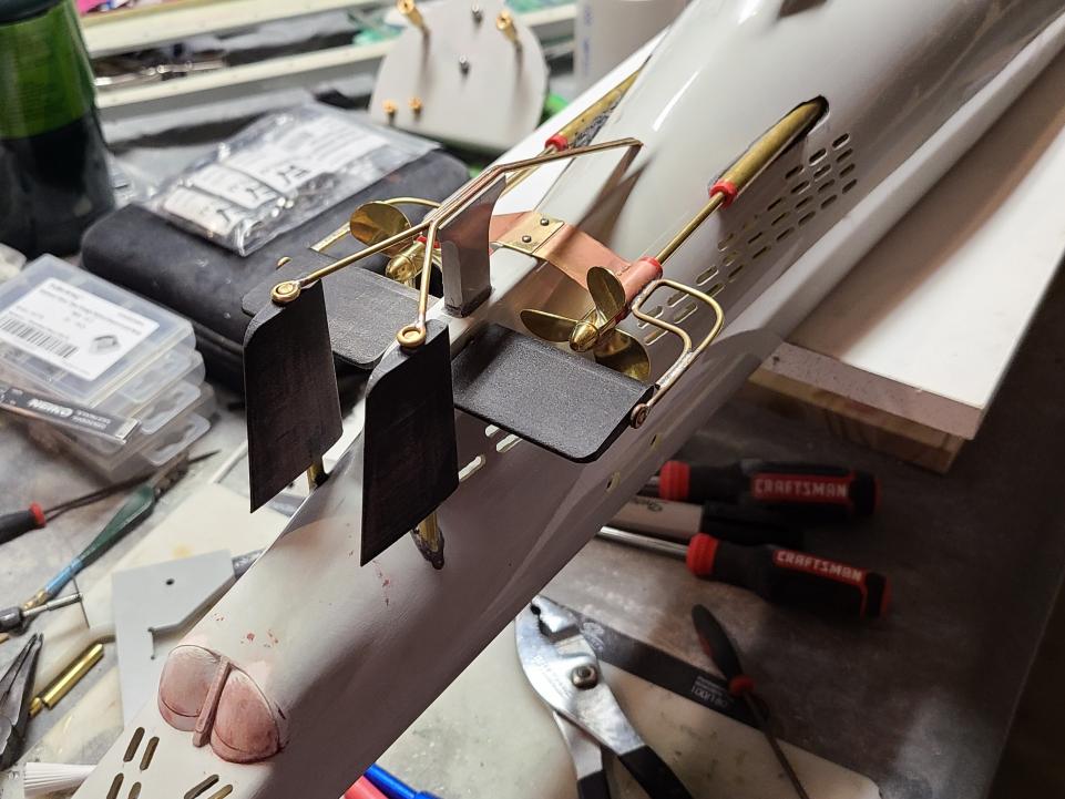

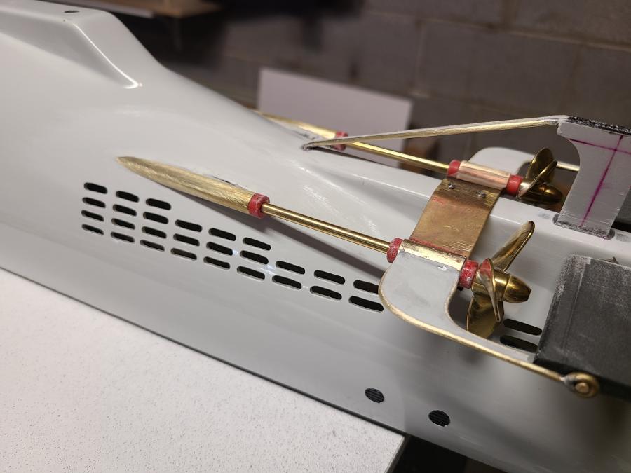

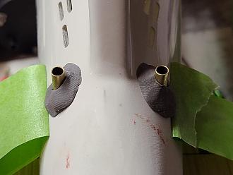

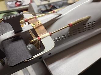

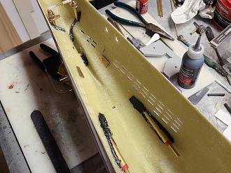

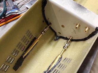

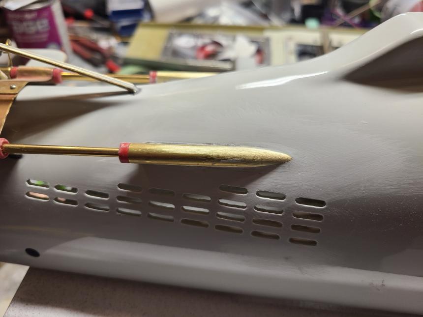

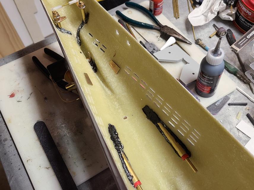

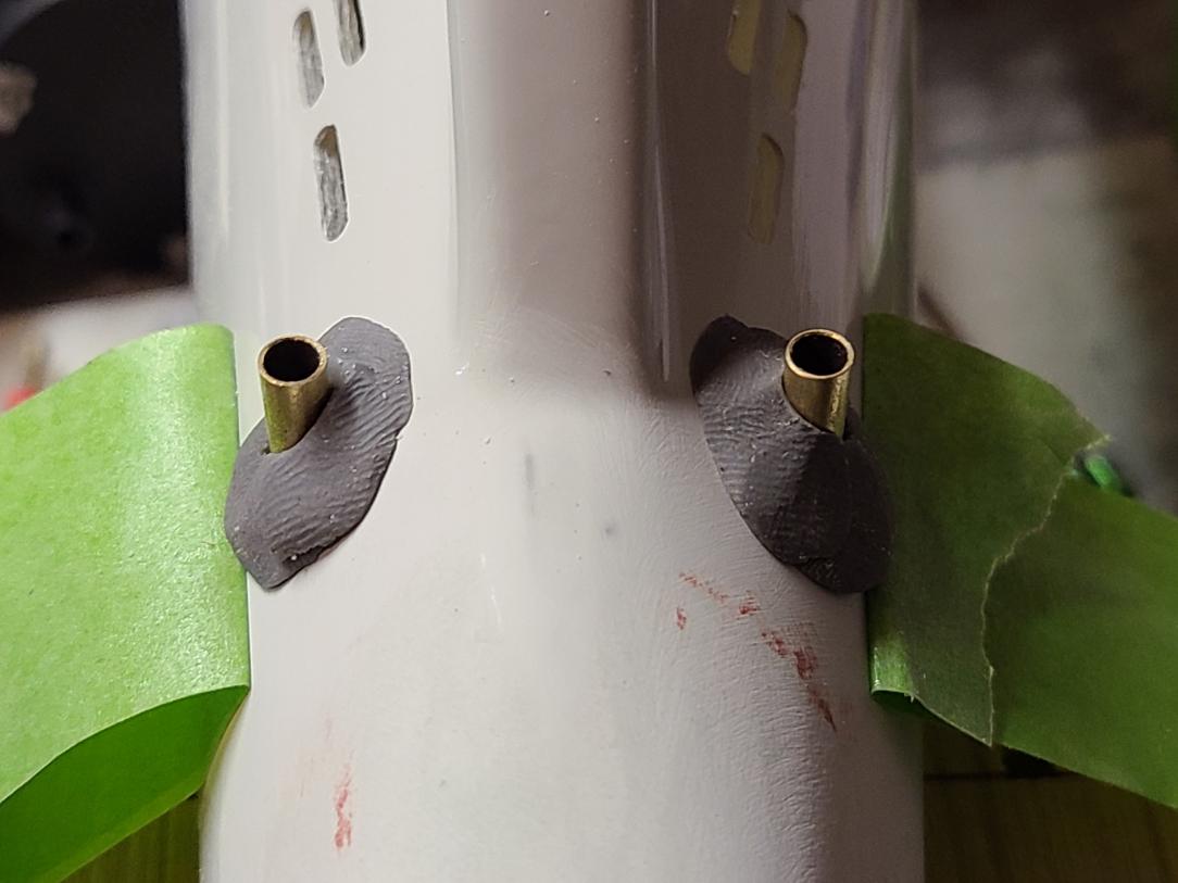

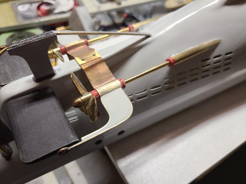

    I got the rudders installed, stern planes, bow planes, drive shafts and support rods. I still need to add fillets and blend it all in. I also have the main center Plexiglass hatch made and working on the backing frames for the smaller hatch openings. It's progressing rapidly at this point. I used modeling clay to seal around the tubes to glue them in with Starbond black CA. Worked great!

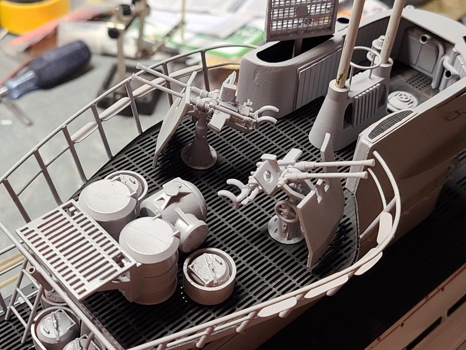

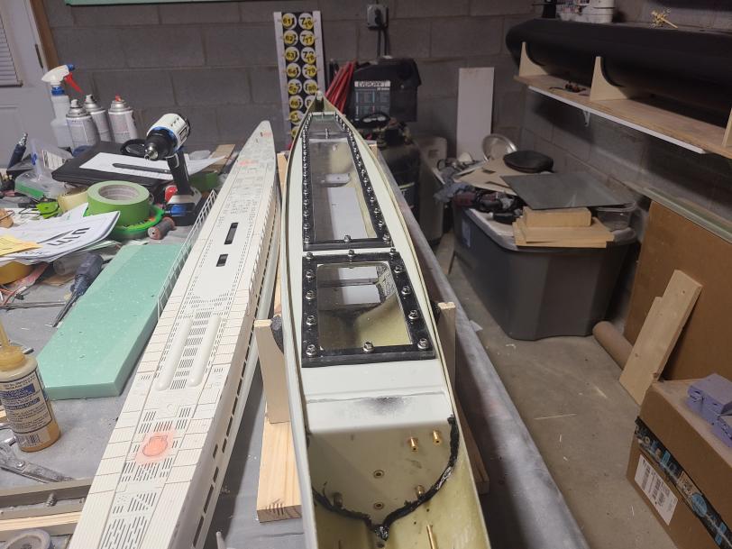

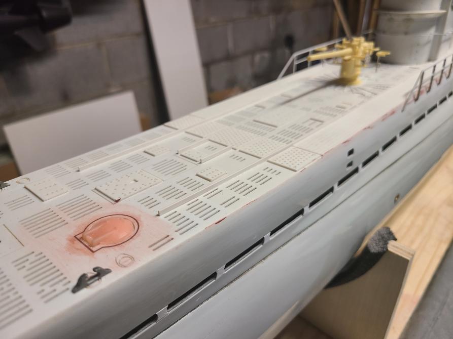

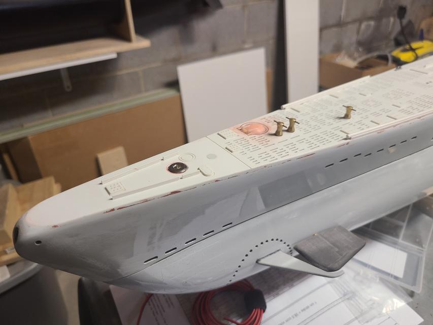

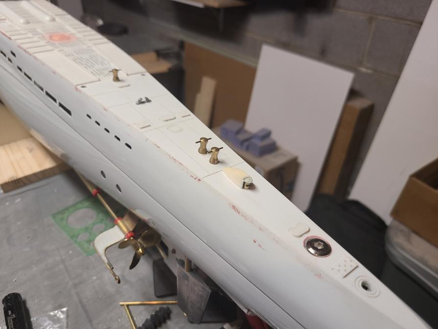

      The lower hull work is done. Did some fill work with Evercoat Rage filler and added some 3D printed vent grills. It is getting close to being ready for paint. I need to make some gaskets, secure the middle deck and work on laying out the electronics next.

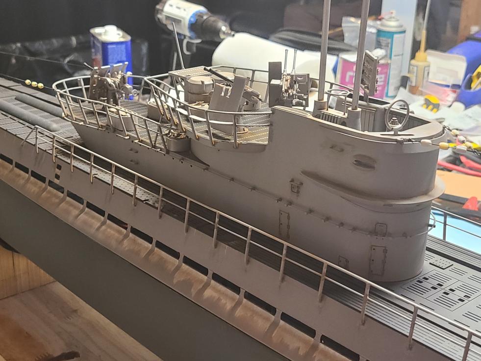

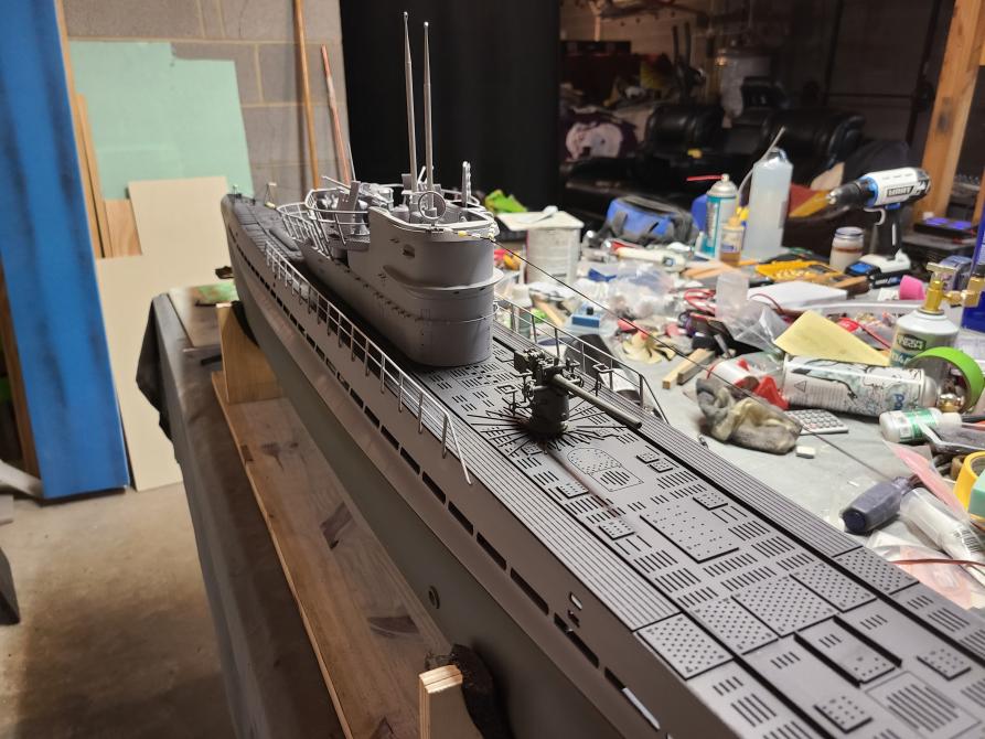

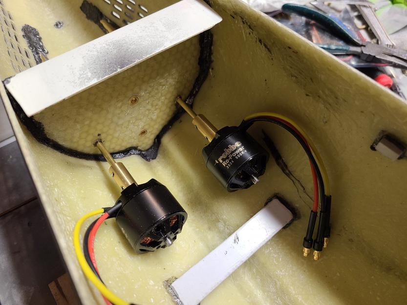

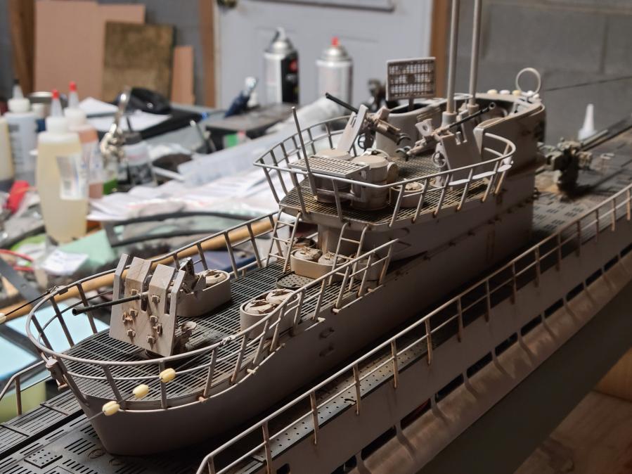

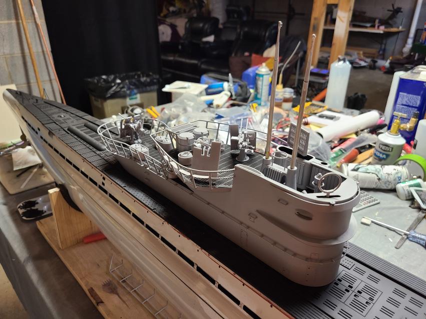

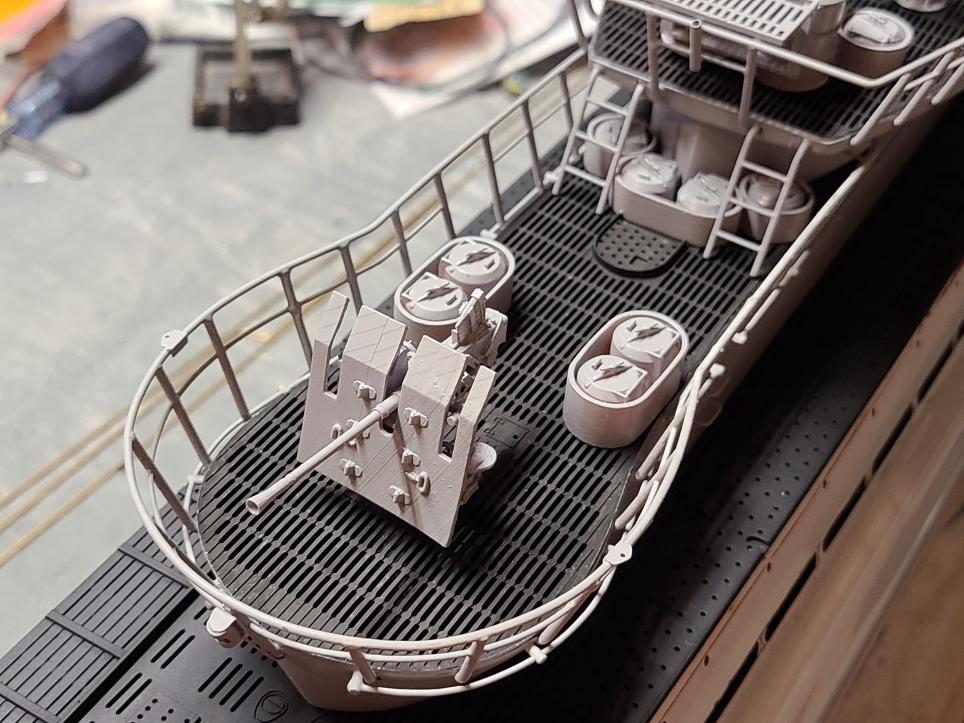

          I got the gaskets made for the middle deck hatches and the bolts to secure the upper deck to the lower deck are installed. The middle deck is still not secured yet but the seam between upper and lower decks is actually not bad. I also feathered in the styrene decking to the upper hull with some Evercoat Rage filler and added the final detail bits to the deck including an anchor light. Try as I might and even with good alignment I was just not happy with how the brushed motors secured and connected to the drive shafts. As a result, there was too much drag in the system to be reliable so after talking it over with David we decided to go with a set of the Engel 500kV brushless motors connected directly instead of the stock geared setup. This thing is very close to being ready for paint and it is looking really good.

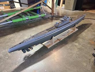

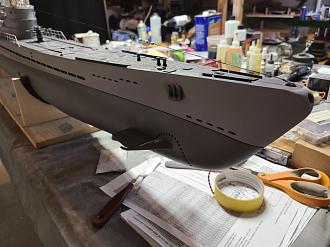

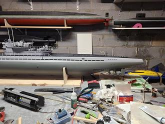

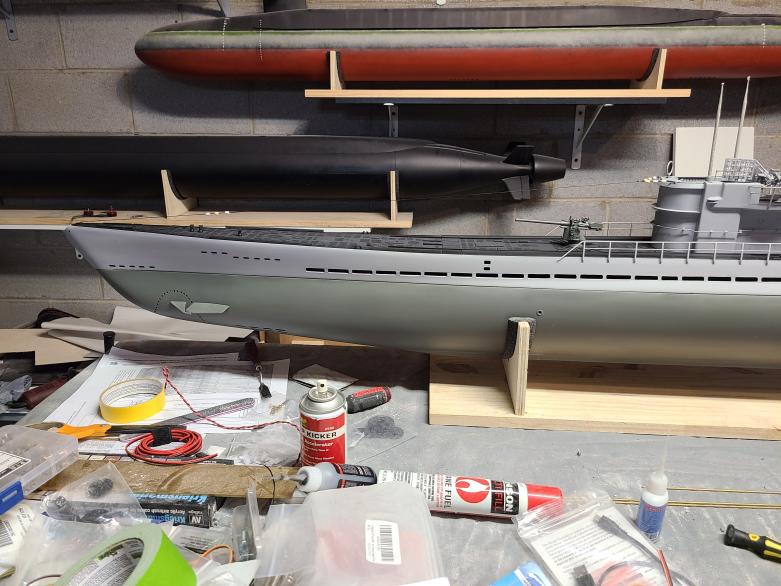

              The base painting is done and she looks really good so far. Not much left to do. I am planning to have it ready by SubFest. The next task will be to design and print a mount for the brushless motors.

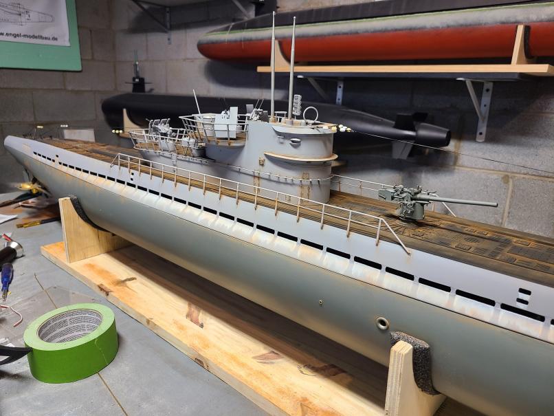

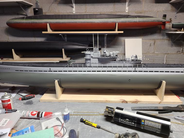

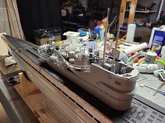

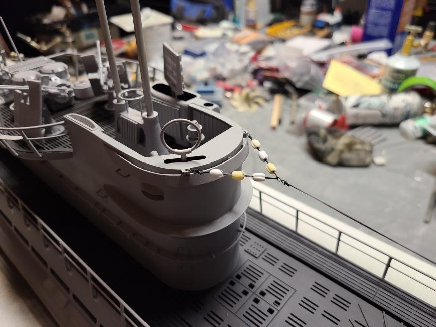

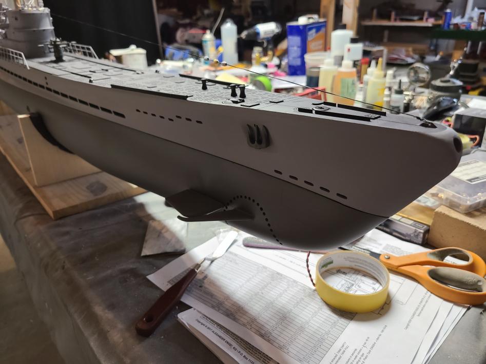

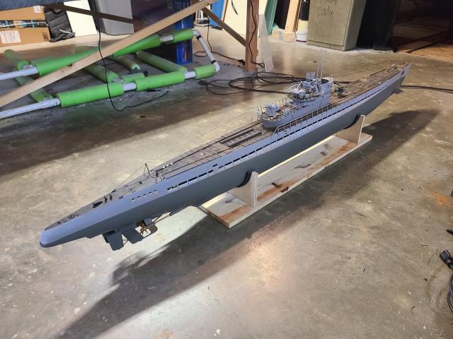

                This project is nearing completion. All of the electronics are functional with the radio and the middle deck is installed. I am weathering it now and then it is time for pressure testing and trimming. Overall it has taken me about 3 months to put it together and has been a huge opportunity to grow my knowledge and skills.

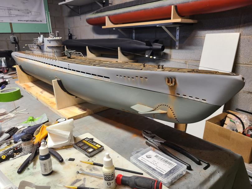

                    Thanks Rob. Weathering is done. A light coat of clear matte tamed the rust making it look better. Next up is pressure testing.

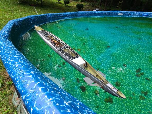

                      Pressure testing for leaks...

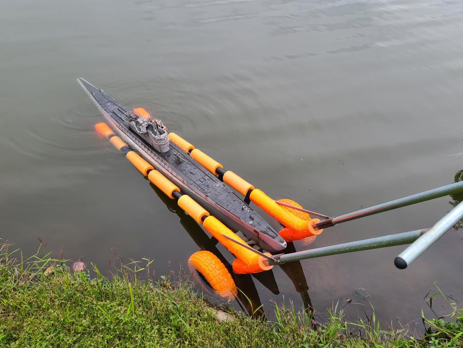

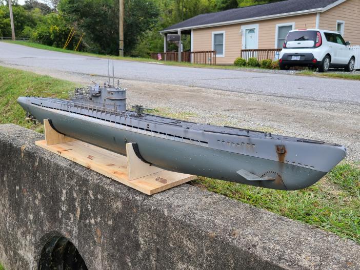

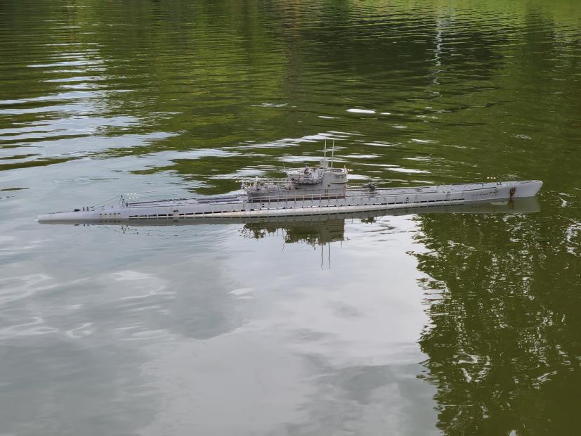

                      It's first run at the lake.

                        Beautiful, Steve! Well done, sir. And a wonderful looking venue to play in as well. See you in a few days, pal.

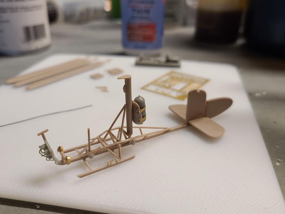

                              Thanks guys! David managed to find a 1/48th Focke-Achgelis Fa 330 gyrocopter model for static display. I have never seen the level of detail in a model like this. It is testing the limits of my abilities.
                              Click image for larger version  Name:	20210919_204334.jpg Views:	0 Size:	53.0 KB ID:	153667
                              It will make a nice display piece when done.

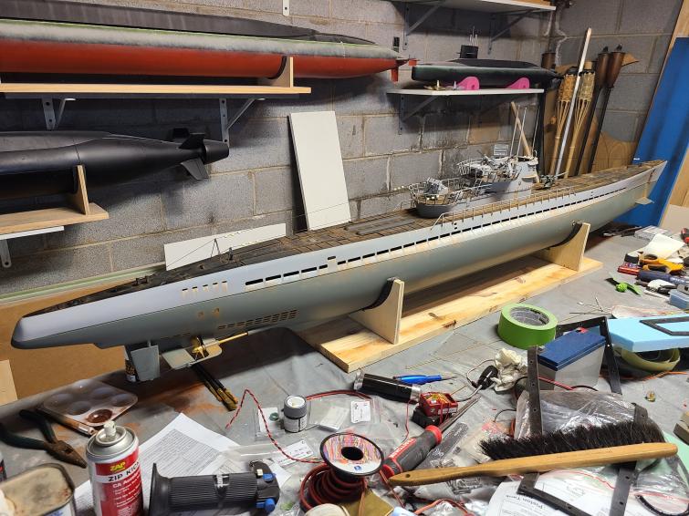

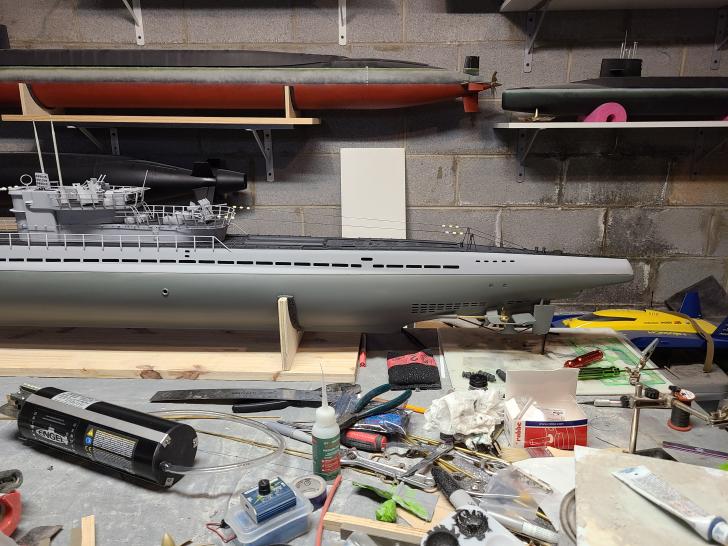

                              The sub is completely done. I had to do a few minor adjustments to the placement of the weight in the hull to get the trim just right but it is ready to go.
