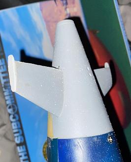

    The tabs on the dive plane ends always worried me that they would break. Well one did during test fitting. I lucked out and found it. Superglued and used spot putty. Anyone else have this problem?
    • 3746
    Not sure I understand, what tabs? I do not recall any tabs.
      The outside of the dive plane support wing? Yeah, they’re fragile in that scale, and located in a spot prone to bumping...
        • 2638
        Reinforce the area with thin brass sheet or g10, bonded on with JB weld.
          • 13973

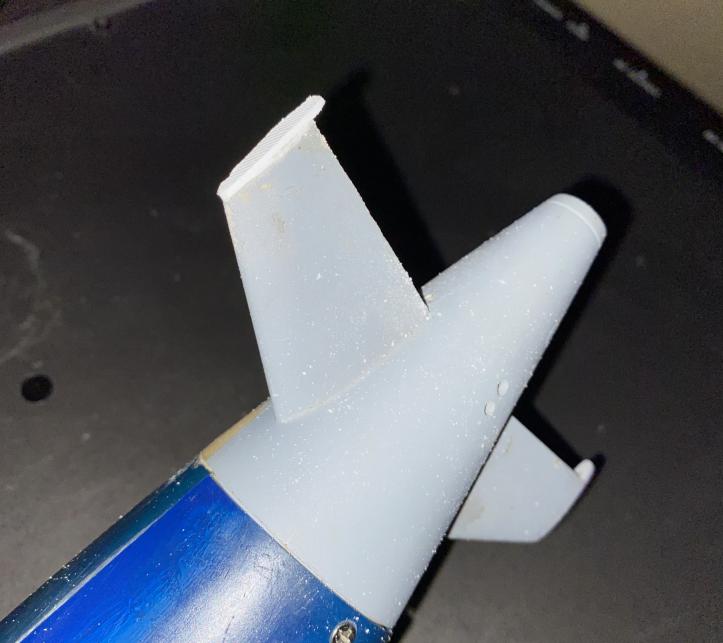

              Little more shaping and I’m done. Click image for larger version

                There you go!
                  • 3746
                  Excellent Casey! Good solution.

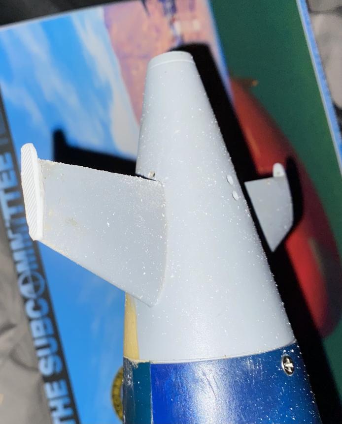

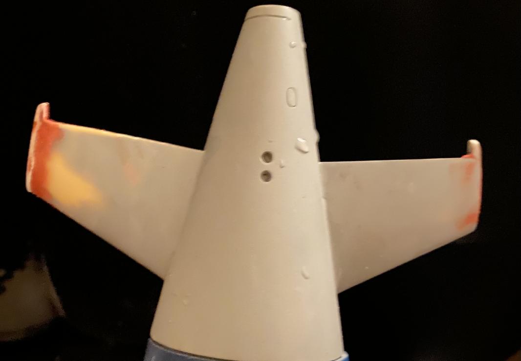

ID:	153914 Thanks, guys. I sanded off the end of the dive plane so what I added would be even with the other side. I then glued a piece of .040 sheet of Evergreen plastic backed by a small strip of .015. Sanded to shape and coated with some spot putty. All done.

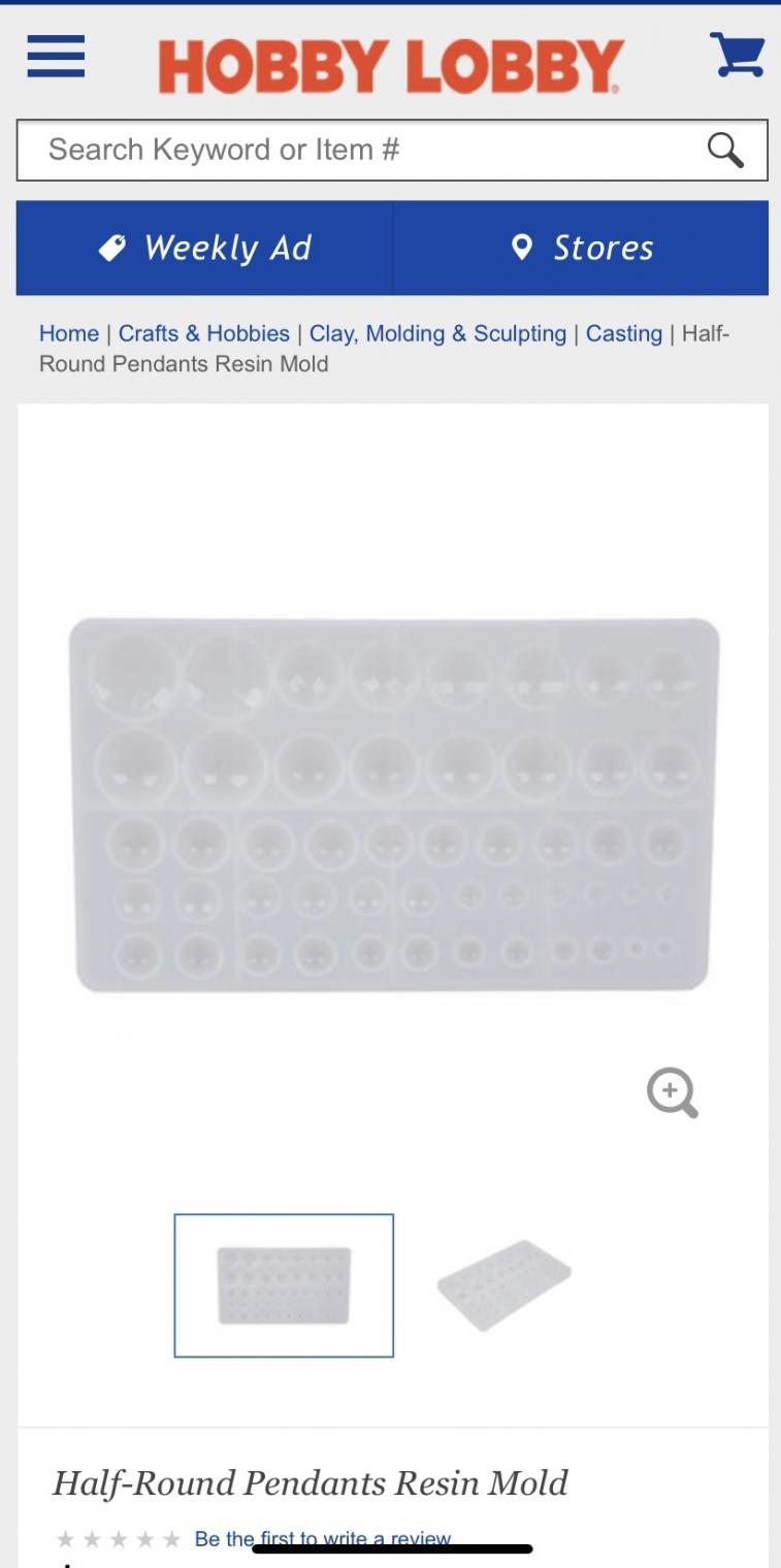

                          May I know what this particular silicone mold is called.
                            The wife and I were shopping and I saw this. It was the answer to my missing anchor.
                            Click image for larger version  Name:	67EC58A8-B468-44BD-97C8-2301648D2319.jpeg Views:	0 Size:	68.0 KB ID:	154359
