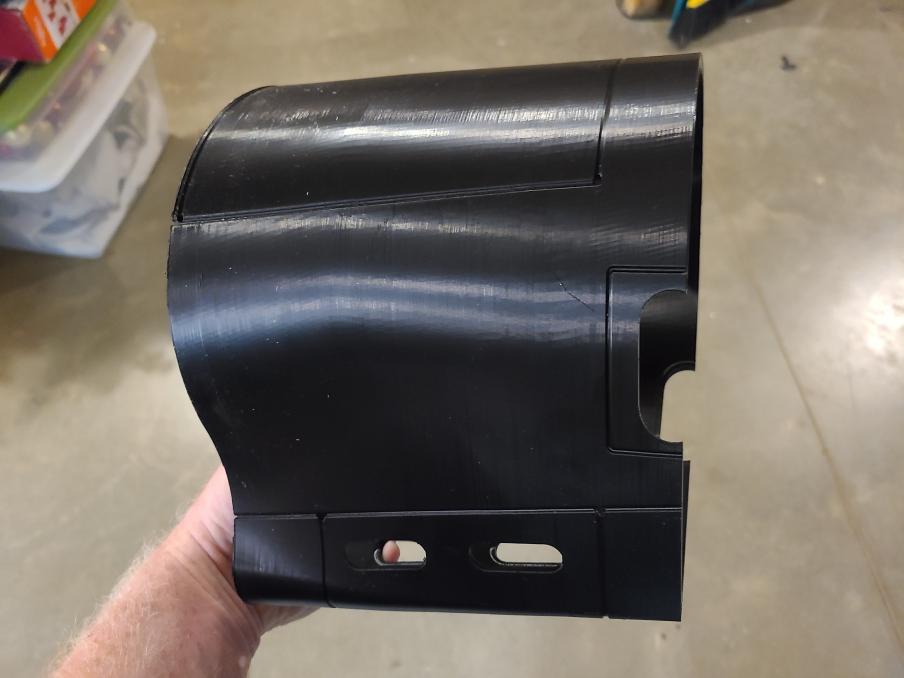

                I am currently printing a 1/6th Seehund in ASA on an Ender 5+. I love ASA but I know it has its issues that keeps some from using it. My 1/72 Columbia is also printed in ASA.
                Click image for larger version  Name:	20210423_113706.jpg Views:	0 Size:	45.3 KB ID:	149256
