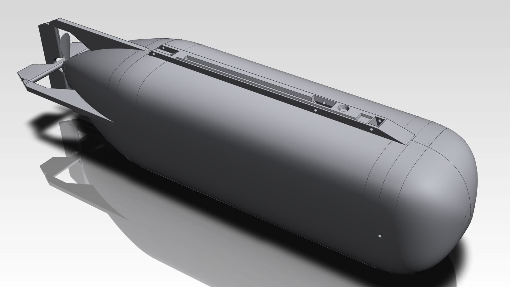

    Many years ago, I attempted an SDV mk8 in 1:12th scale. It’s still in the rafters with numerous issues. I started this model last week and already have the tail section in the printer. Still not sure if this will be dynamic or static. We don’t need a large ballast tank so I’m even thinking an rcabs would be enough to get it to positive. CAD images are super rough now but I’ll get some renderings out soon.

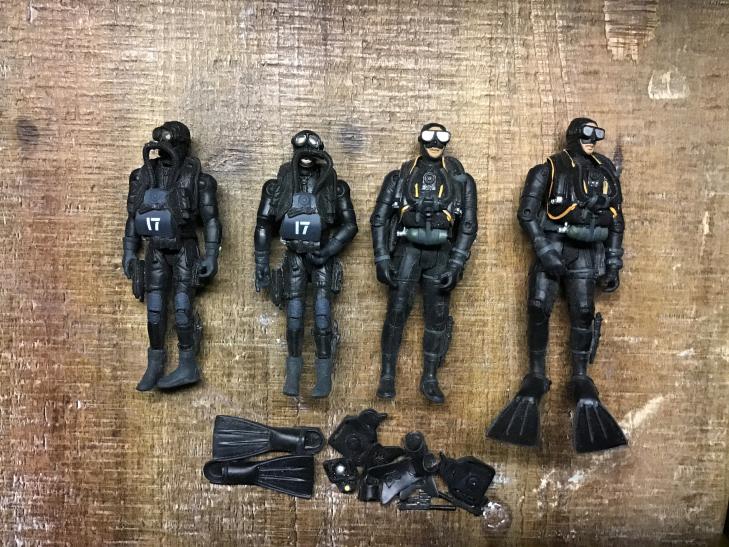

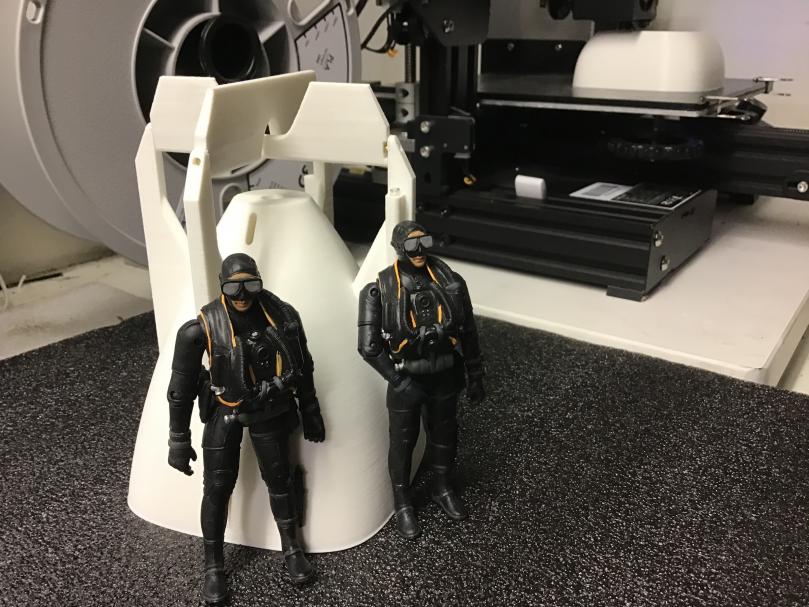

    I have started many scratch builds off of a figure. This one is no exception as these divers will look great with the seams filled and some correct rebreathers added. Will need help from the master for that....
    Tail section print visible below.

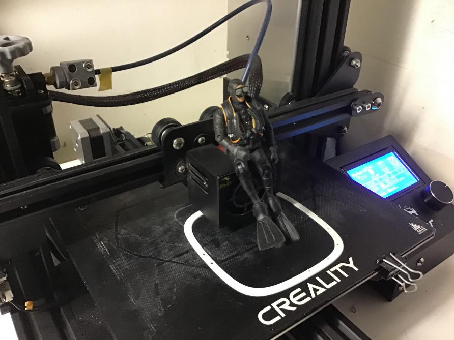

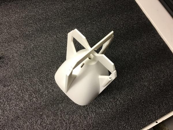

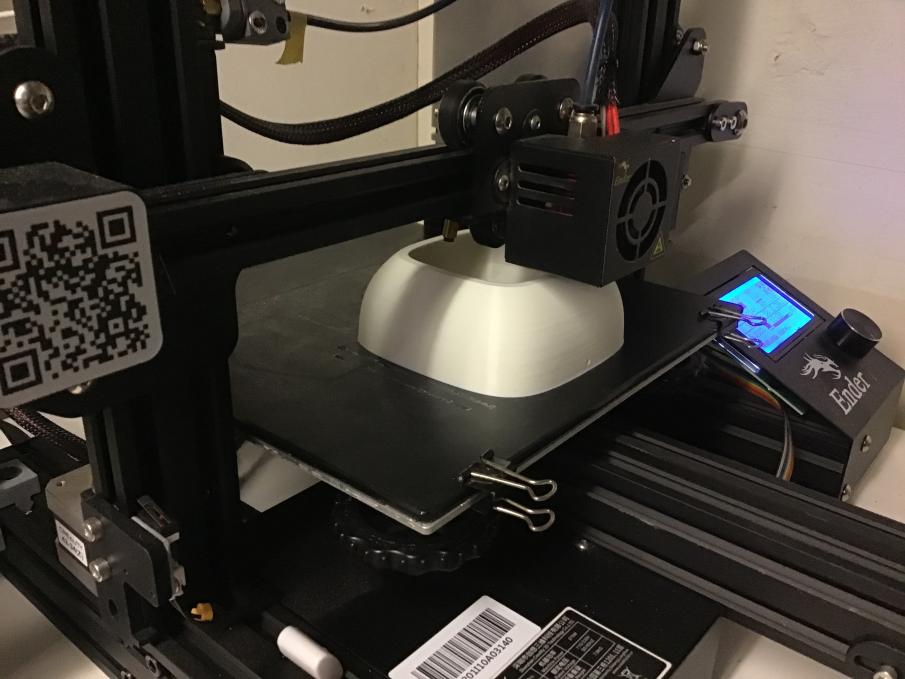

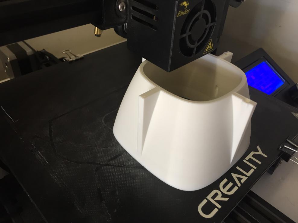

        Say what you want about $200 printers but I’m quite happy to wake up to this. Pushrod channels already molded in.

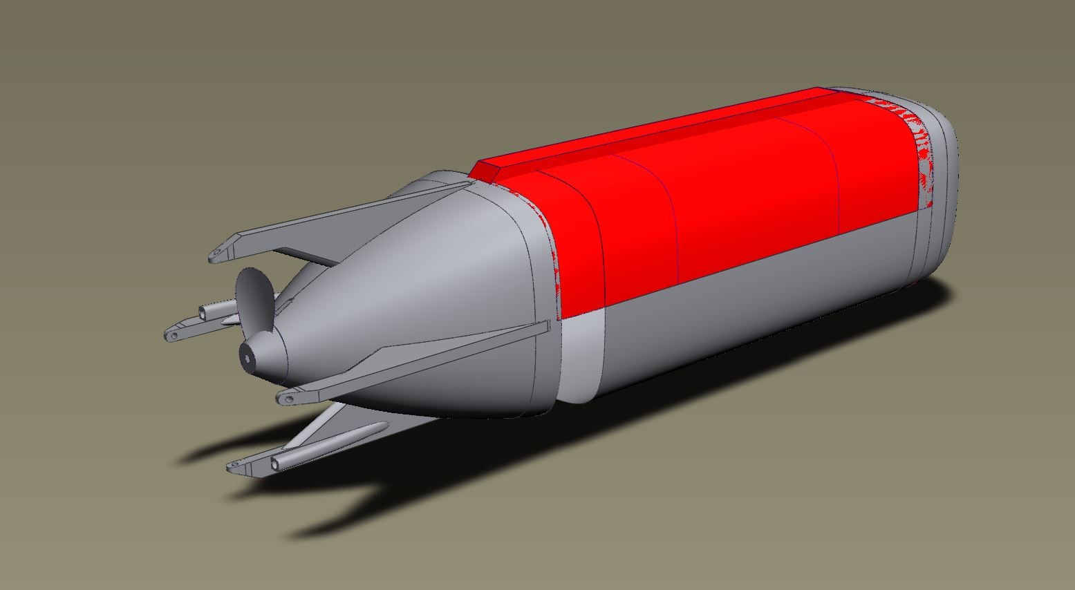

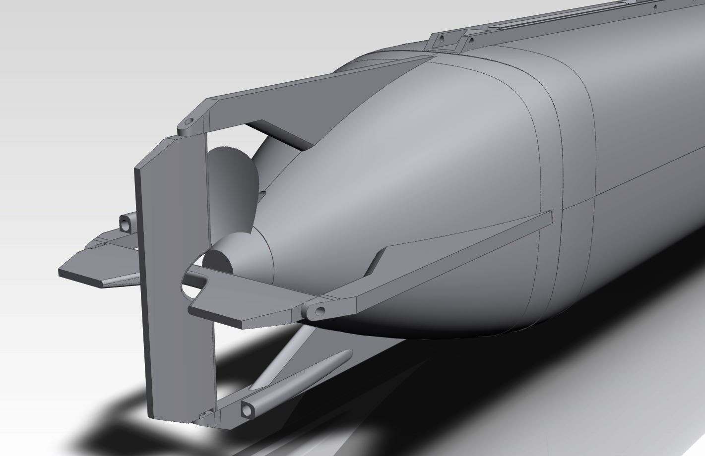

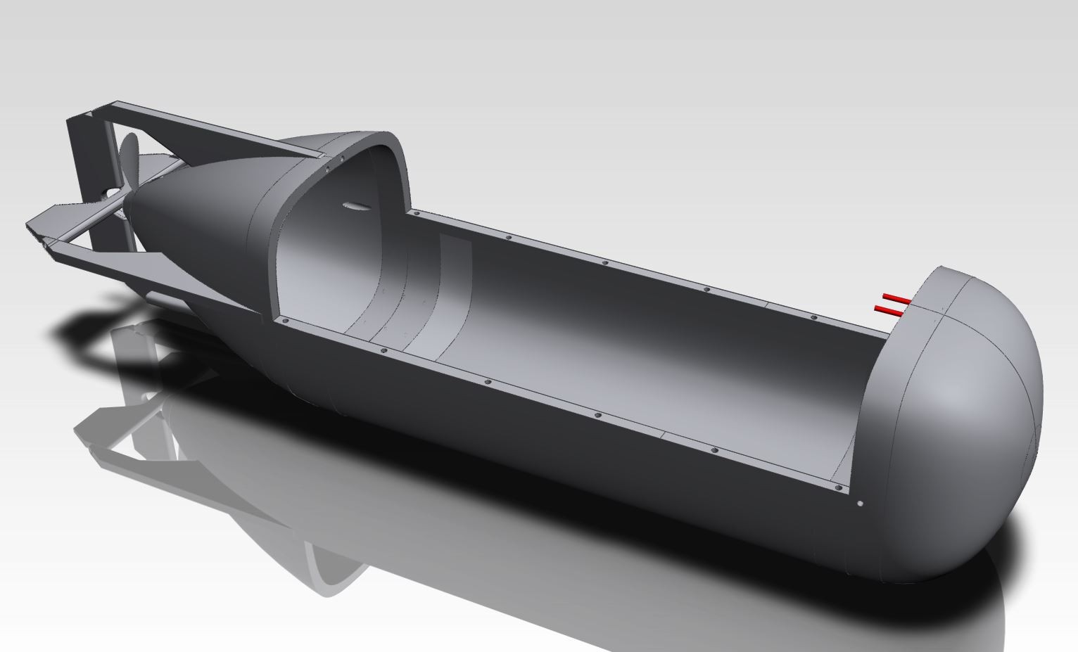

          Almost finished with the digital work. I added some appendages and the upper periscope details. Some things are adjusted for scale and print limitations.

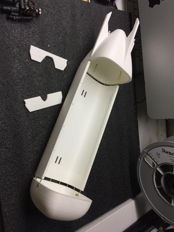

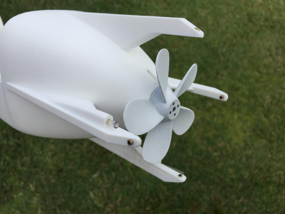

            Rear section and appendages are ready for sanding and fitment. The pushrod tubes are in and linkage setup should be pretty simple. This should be a very maneuverable boat with the control surfaces behind the prop. Need a cheap APC if anyone has one or a link. Bow section is almost complete.

                Thanks for sharing your build progress. All I can say is WOW! The figures look store bought. Look like McFarlane Seal figures. Just incredible to my eyes.

                  I think the figures are 1:18 21st century. Unfortunately, I now realize I built this in 1:16 to get a bit more size for internals. I was planning on a closed hatch boat so no issue for me.

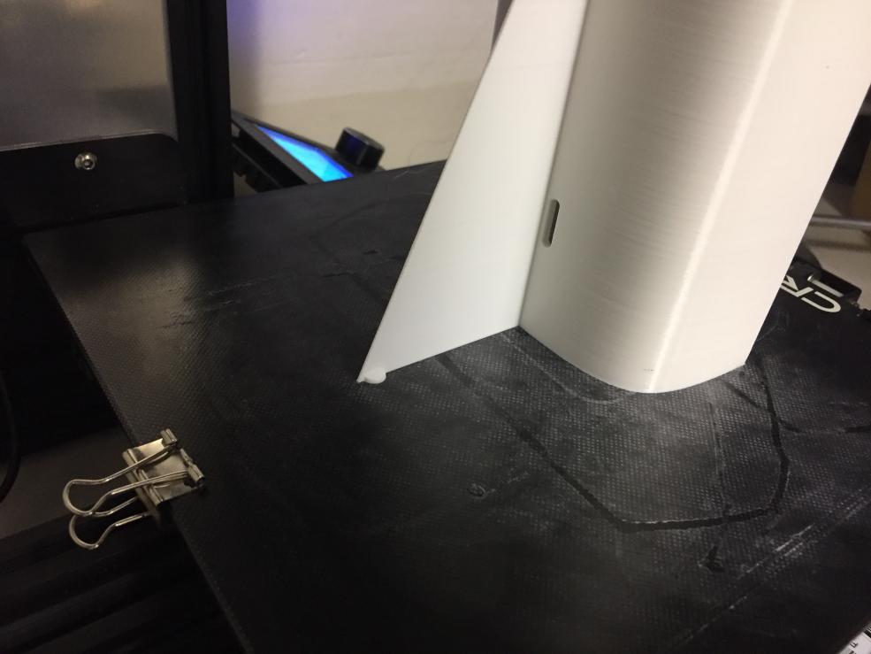

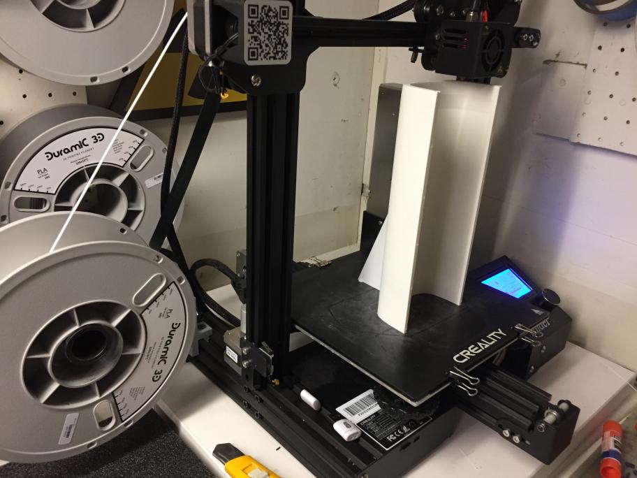

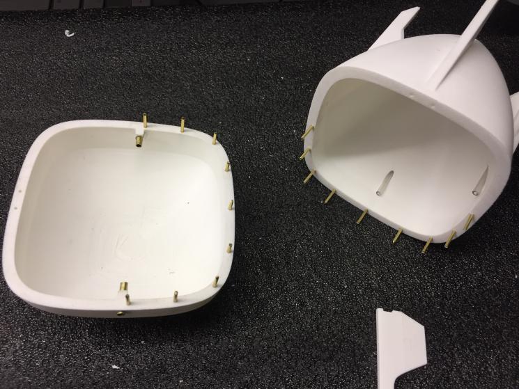

                    The large section came out great. Going to show a couple of my tricks here. For the tall center parts, I add a spine to reduce wobble at the extreme end of the print. I also put a small dab of CA on the bottom corners after about 1mm has printed. Had to tap this part off with a hammer. I also use the glue stick on a glass bed. Next shots show the 1/16” pins to join the hulls. After the epoxy cures, I glass a small strip inside and out to stop seam issues. Hull thickness on this hull is 3mm with the join surfaces about 4mm and it is very sturdy. Less than $25 in material for all sections.

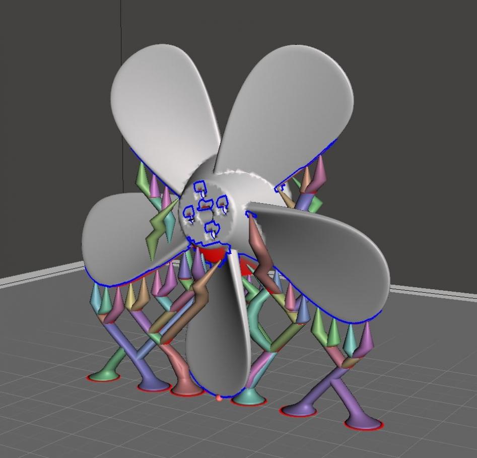

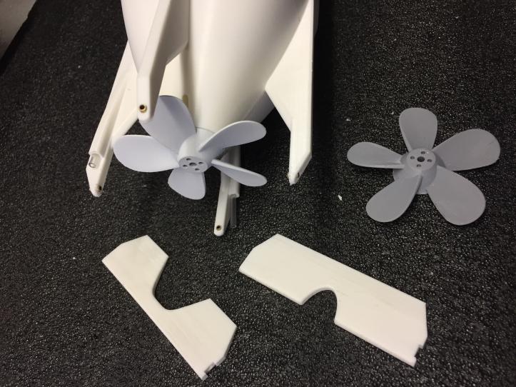

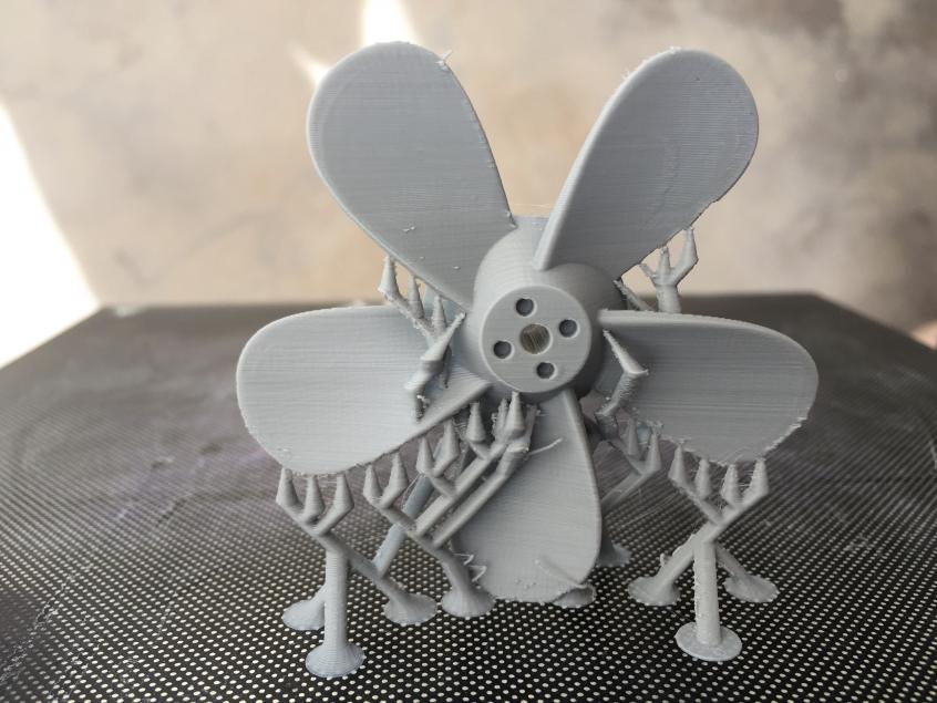

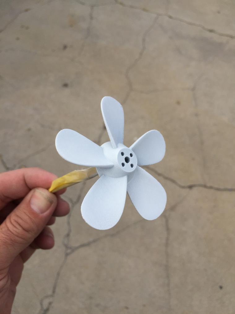

                      Propeller progress today. One of the toughest parts to print needed some help. I used “mesh mixer” software to generate these structures and print vertically. Less than 10 minutes of sanding so far and we are getting close. Blades are plenty strong and have a slightly flattened pitch. Should allow me to use a smaller motor to swing it.

                        Your figures WOW can`t stop looking at them. The detail is incredible. You did them from scratch or did you work with a file and modify it?
                          Are those Elite Force 1/18 Navy divers?

                            DH, Nice work. The prop looks amazing. I really like how you printed in the holes for the rudder and dive planes. How long did the CAD modeling work take? Scott T

                              In scale, It is about 16.5". The figures are 2 brands. Elite Force and 21st Century I believe. Not cheap these days but I grabbed every one I could find when we used to have toy stores. Can be found on Ebay still.
                              As for the CAD work, Probably 6-10 hours so far. A very simple model compared to the Lotus with its automotive surfacing. Prop was about 2 hours considering 2 or 3 tries at it. Print took 4 and finishing about 1.
