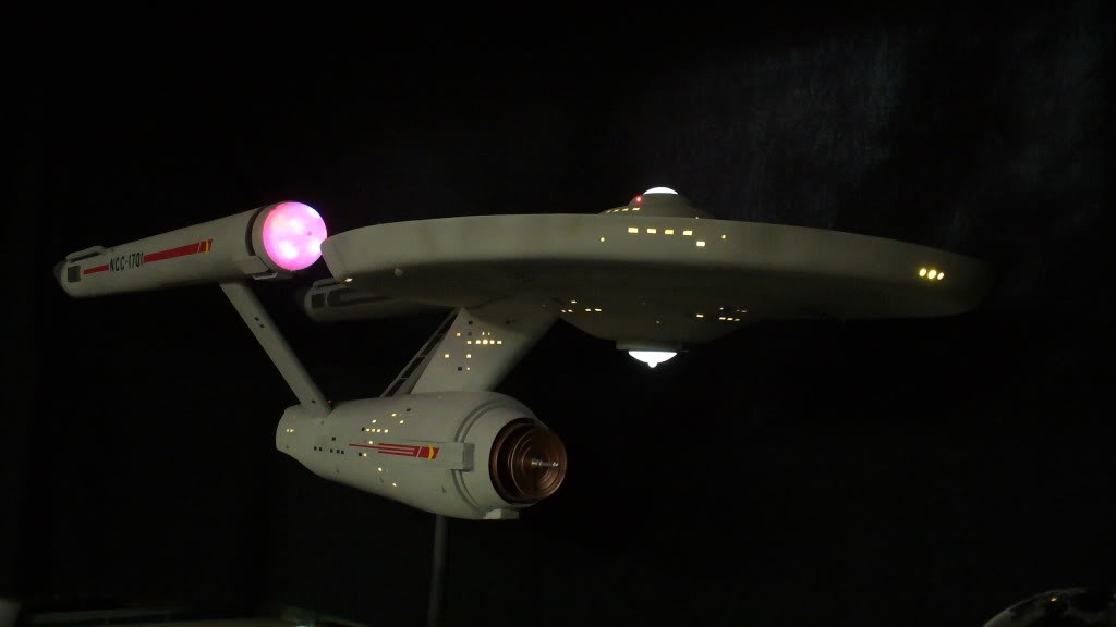

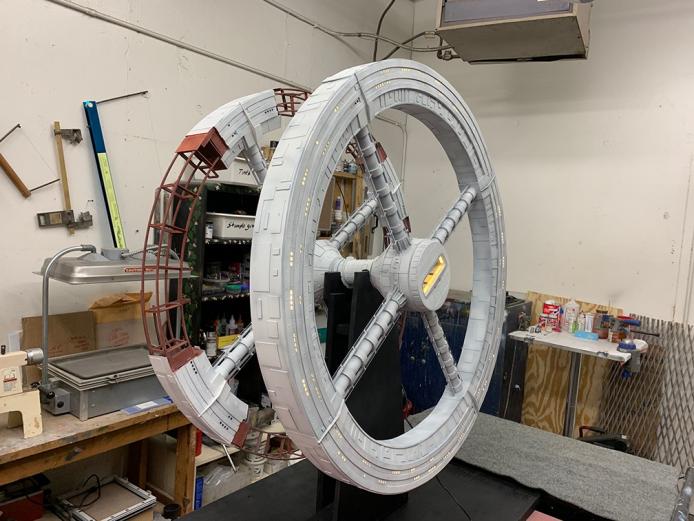

      Agreed on all counts. A printer is on the way here. I try not think about it much until it gets here. Thankfully I have worked for years with computers on all levels of 3D imaging mostly modeling in lighwave for film and TV which should help. Still I love working with my hands too and this model was entirely hand crafted, 66 inches long and built from my molds in epoxy glass. But on the next model I will print all the smaller stuff. It was a a pain to make the small parts for this model.
      Not to mention the second large mold here which was all hand built from styene and resin parts made from silicone waste molds. I own this model but it was made for an exhibit in San Francisco and was there for 6 months before they returned it. I had 6-7 weeks to build it from scratch. I nearly didn't make it. I can only imagine how much the printer would have helped here as I cut out millions of small parts to put on panels. Not to mention the windows cut into styrene.
      And Darrin there's that vacuum form machine in the BKG. It's a really good one and pulls flush to the bed every time. I want to try making a negative mold with panel lines and details and pull into that. The printer can print molds too I would imagine.

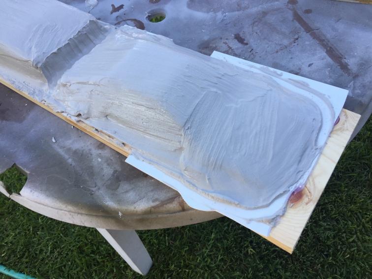

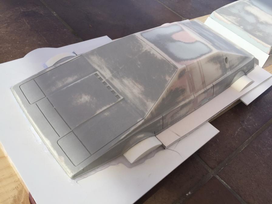

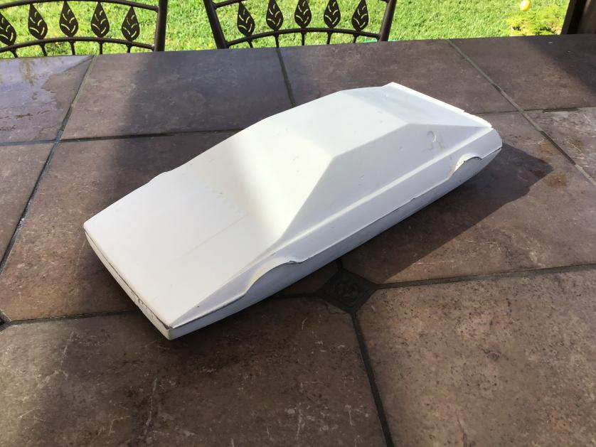

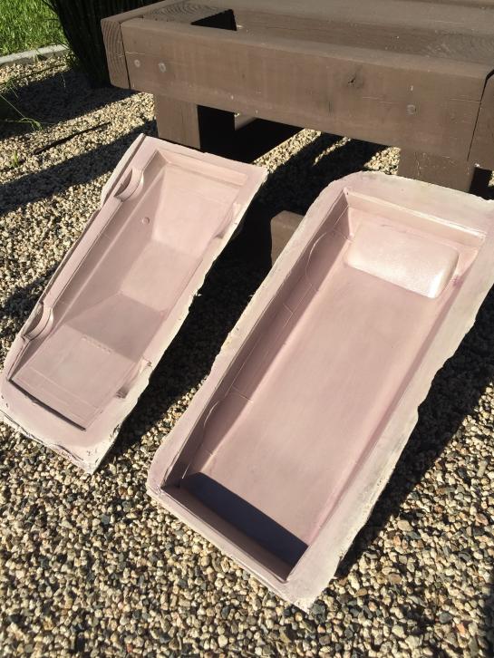

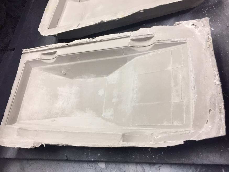

          Built the masters up last night and did a quick Ultracal30 plaster mold. Should be able to get at least 4 parts from these. Plan is to lay 1 up for a runner and eventually, 1 heavy layup with details for a display boat or ?????
          Happy with the results and will start sanding it out after a full day of curing. Need to knock down the door cuts and details.....Uggggh, Time to buy the fiberglass materials....

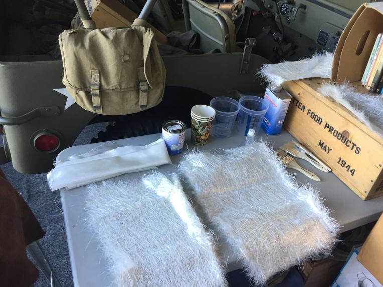

            Mold is cured and has several coats of PVA. Plan to lay up in the morning.

                    Not selling anything for the Lotus. Too much license stuff to be concerned with and after laying up that hull, I am done with glass for a while.

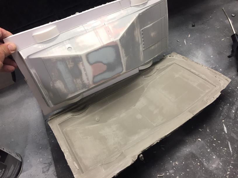

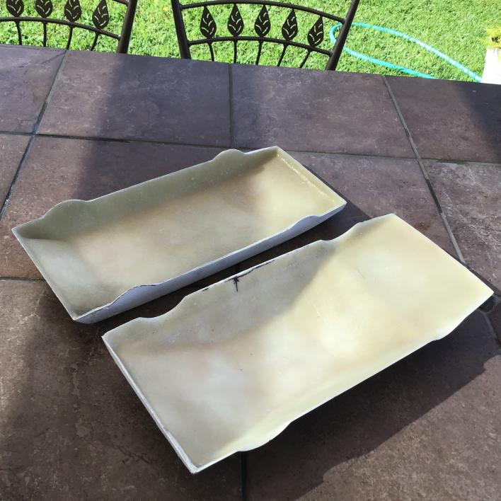

                        Parts are pulled from the mold and rough trimmed. Lots of voids to deal with I have been through worse. Nice, heavy layup should reduce a bit of the spring out common with flat laminates.

                            • 2642
                            Did you mould that with polyester resin? Thought you tended to prefer epoxy.
                            • ffr2608
                              • Oct 2009
                              • 347
                              Polyester so I could take advantage of the gel coat surface. Lots of details on a car body and much easier to scribe lines in it after.
