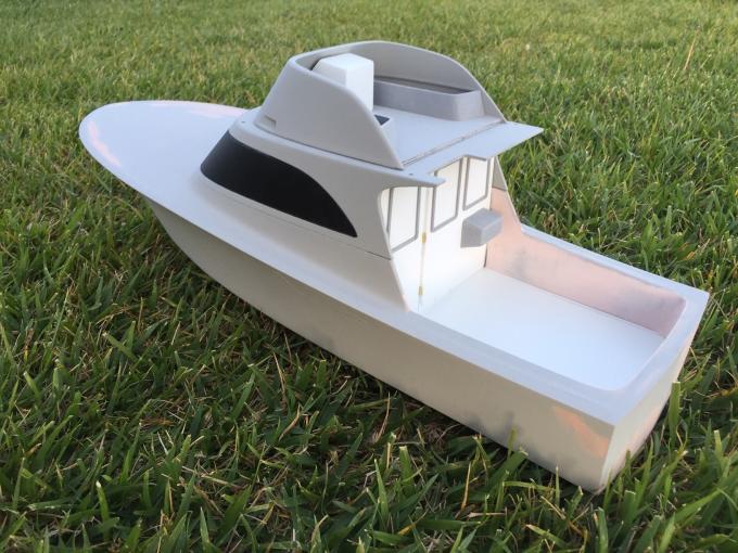

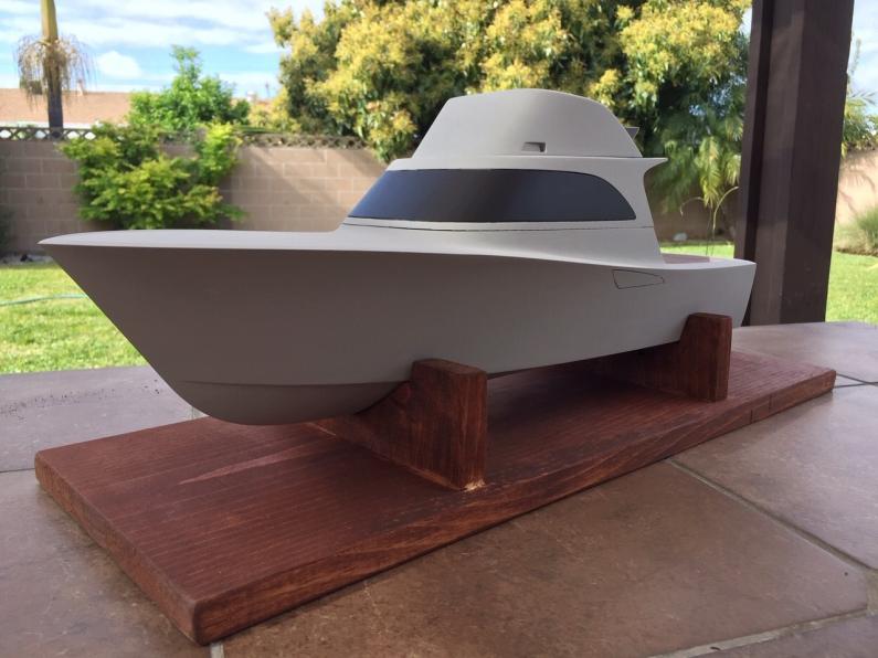

      The new material had some stringing in the center of the lower hull. Told me there could be some structural issues down the line. With the flat nature of the shape, I decided to play it safe. I have had great luck with boat shaped hulls though...This was my most recent build...
