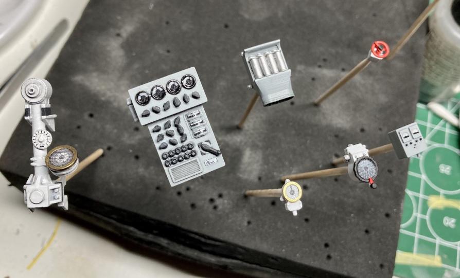

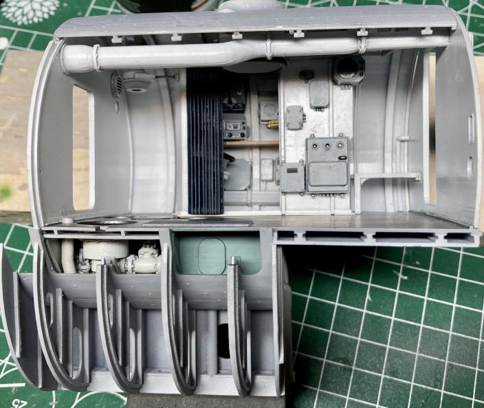

      I'm mainly occupied doing sll parts right now. Here's an example including machine telegraph, rpm meter, the steering column of the rudder including a compass daughter, the secondary switchboard, an oxygen meter, lime cartridges, and a vent valve....
      Click image for larger version  Name:	XXIII-129.jpg Views:	0 Size:	56.6 KB ID:	157018
      On the ceiling of the control room, I've attached the feed through for the direction finder antennae and the corresponding drive. When the antennae was extended (hydraulics), a clutch cage connected to the feed through and the radio operator cold turn it using the manual drive in the radio cabin.
      Click image for larger version  Name:	XXIII-130.jpg Views:	0 Size:	54.7 KB ID:	157019

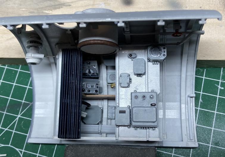

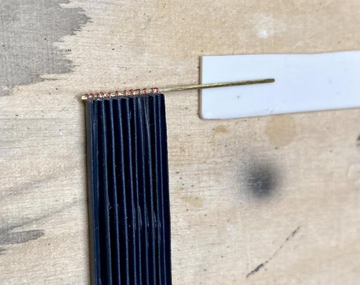

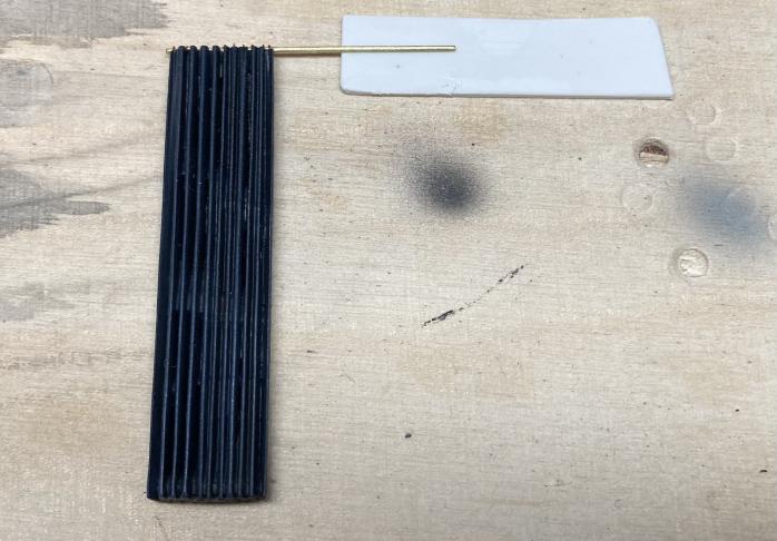

        Continued with the curtain for the radio cabin. Found it as 3d file in the net, adjusted it to my demnds and printed it. The cirtain rail is made of 0,6 mm diameter brass and the curtain hooks out of 0,2 mm diameter copper wire. Attached it to the cabin that also got ist skirting baord made of styrene L-profiles....

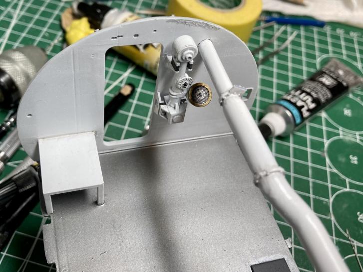

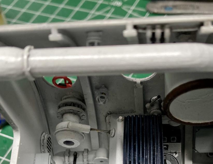

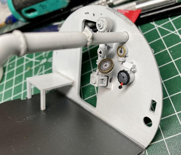

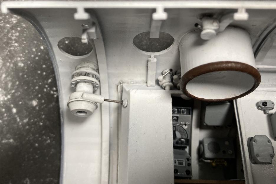

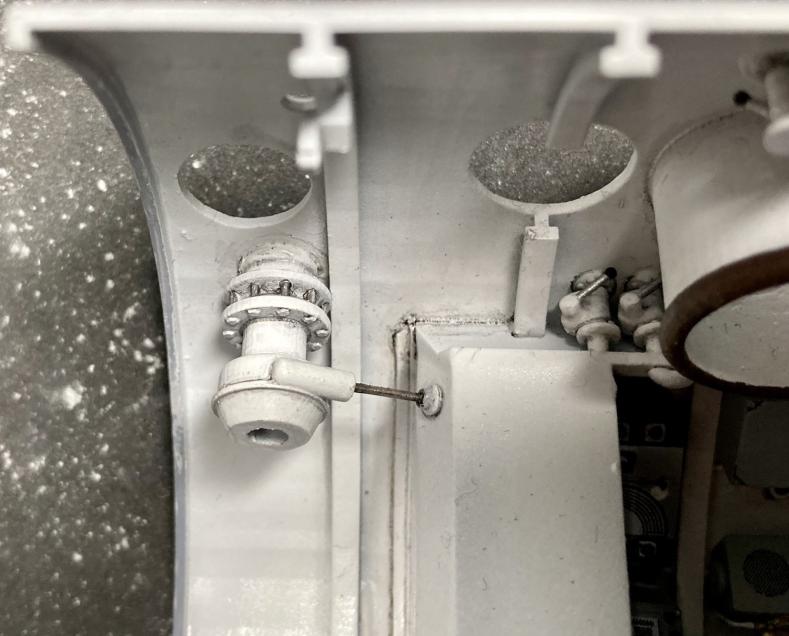

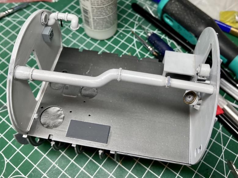

                      Adding bits and pieces to the control room. Ventialtion ducts, the steering column for the rudder, rpm meter, machine telegraph.....

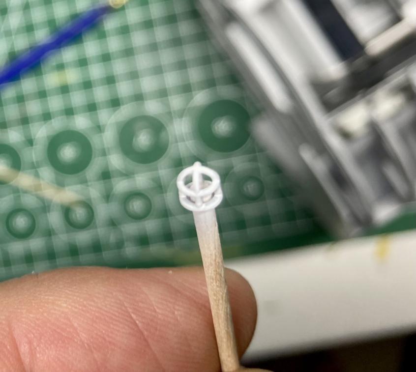

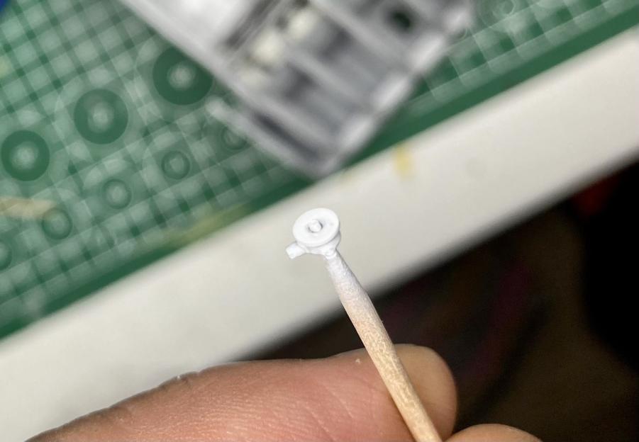

                        Started working on the lights of the control room. In 1:35 scale one an actually model the lamps close to the original, i.e. with base and cage for the bulb. I made 3D models of the base and the cage and printed a bunch of them. The wires of a warm-white micro LED is routed through the central hole in the base, and then the cage is glued onto the base. We have a lamp. Three of them went onto the pressure hull wall and I have to admit, that I'm rather pleaed wth the result....
