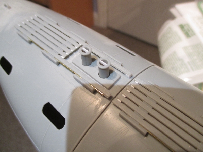

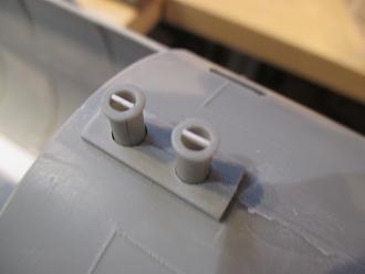

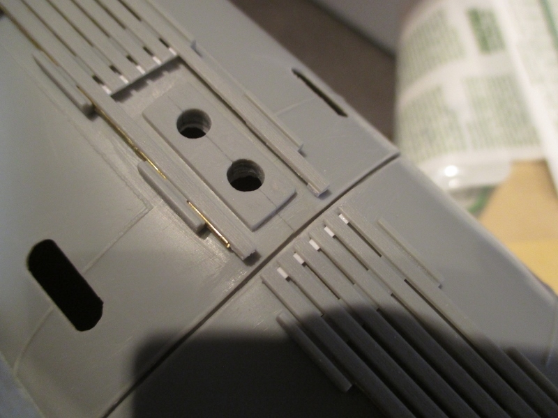

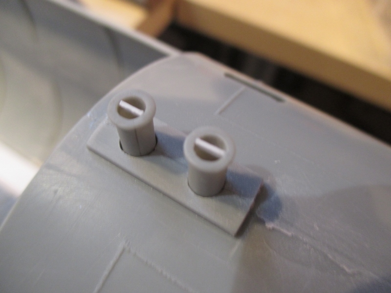

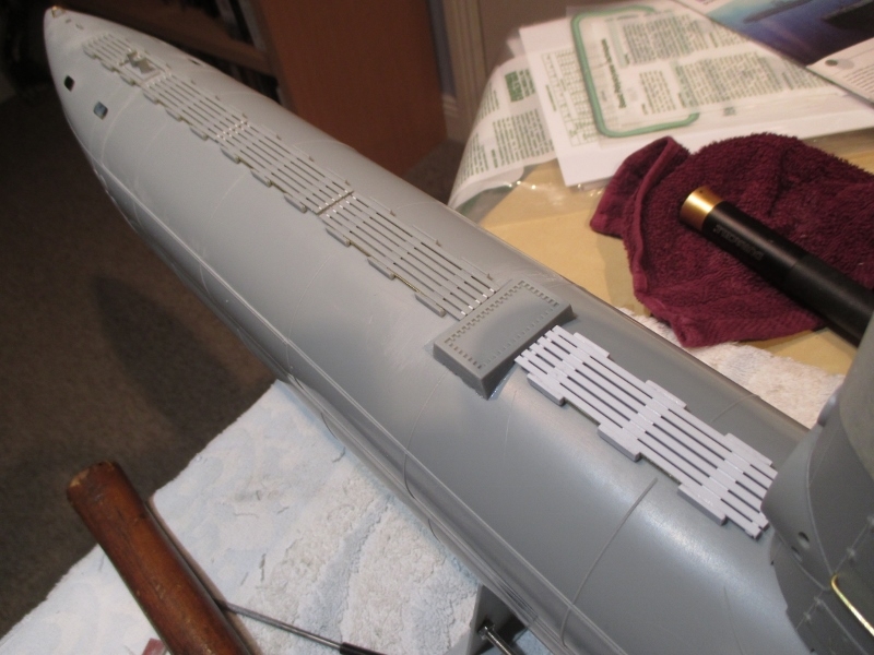

                            I drilled out the holes for the bollards all the way through to let air out as they are now hollow.
                            Click image for larger version  Name:	IMG_1966 (800x600).jpg Views:	2 Size:	246.7 KB ID:	131792Click image for larger version  Name:	IMG_1960 (800x600).jpg Views:	1 Size:	218.9 KB ID:	131793

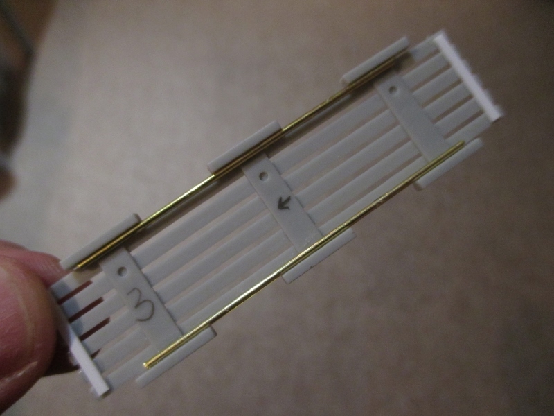

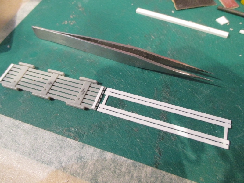

                            I followed Manfred's advice and beefed up the deck planking with 1mm brass and also end stringers from 1.5mm x 0.5mm
                            Click image for larger version  Name:	IMG_1970 (800x600).jpg Views:	1 Size:	241.6 KB ID:	131794

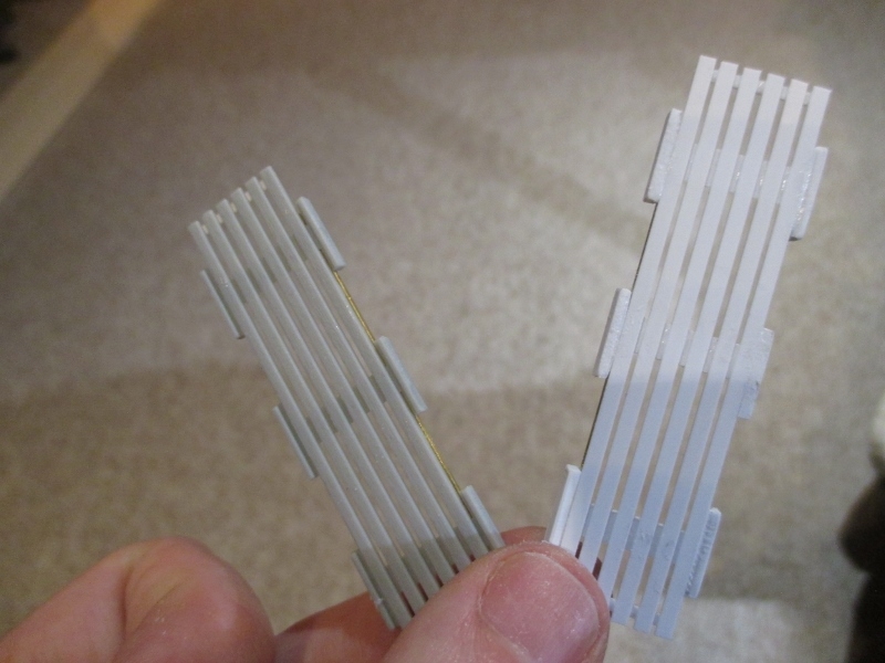

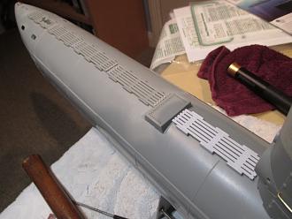

                            I added the extra piece to lengthen the run of planks, here it is finished and under construction from strip styrene.
                            Click image for larger version  Name:	IMG_1962 (800x600).jpg Views:	1 Size:	252.8 KB ID:	131795Click image for larger version  Name:	IMG_1961 (800x600).jpg Views:	1 Size:	352.2 KB ID:	131796

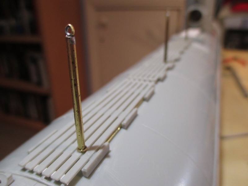

                            I made sure the hull break was at the end of the initial run of planks and cut down a kit supplied item and then added the extra one near the tower so any tiny differences are not noticeable.
                            Click image for larger version  Name:	IMG_1966 (800x600).jpg Views:	2 Size:	246.7 KB ID:	131797Click image for larger version  Name:	IMG_1968 (800x600).jpg Views:	1 Size:	270.8 KB ID:	131798
                            The vulnerable cut down planking has reinforced ends on the single planks, they are sure to get whacked so extra strength is vital

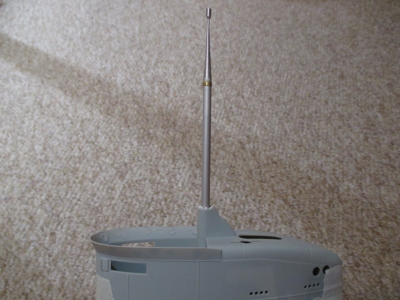

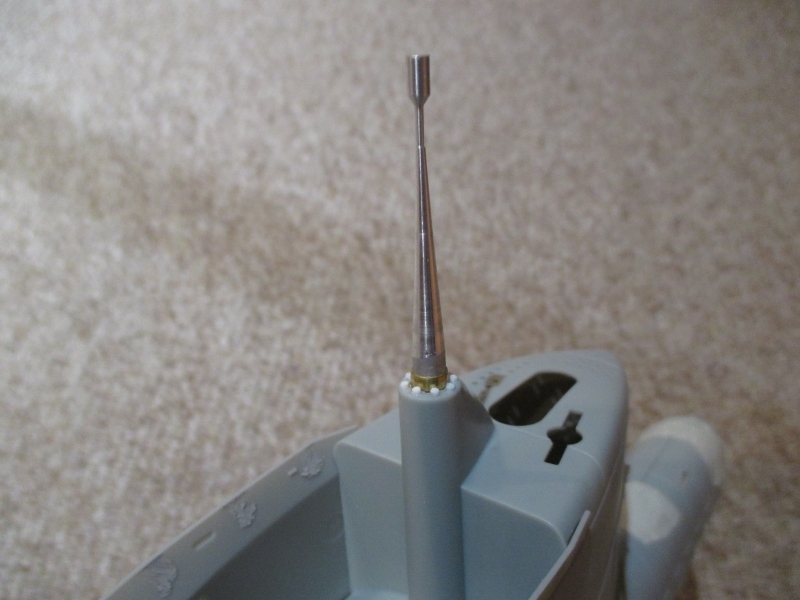

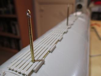

                              Nice turned scope from Wikinger.................
Name:	IMG_1971 (800x600).jpg

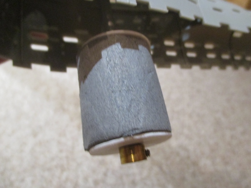

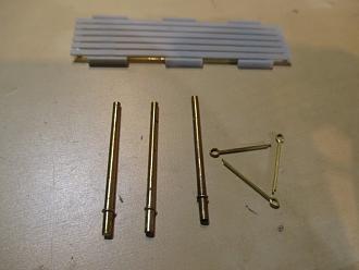

                              .........and the lift mechanism, closed cell foam and two shaft collars...............
Name:	IMG_1972 (800x600).jpg
                              ...........and in the raised position.
Name:	IMG_1973 (800x600).jpg

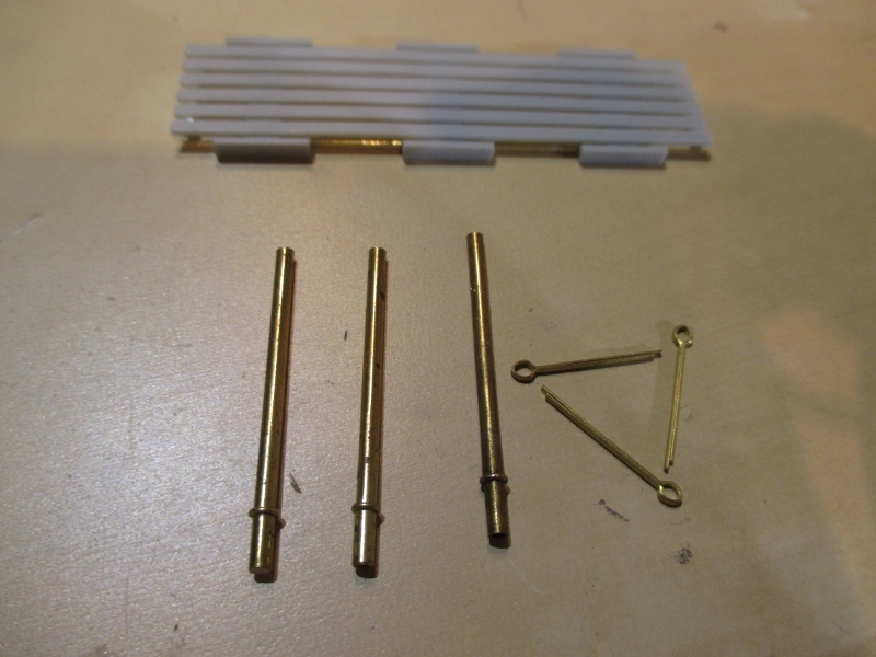

                              I found these 1.5mm tubes in my spares box, collars will be a nice feature.
Name:	IMG_1974 (800x600).jpg
                              The pins are soldered on top, won't install till the painting phase.
Name:	IMG_1975 (800x600).jpg
