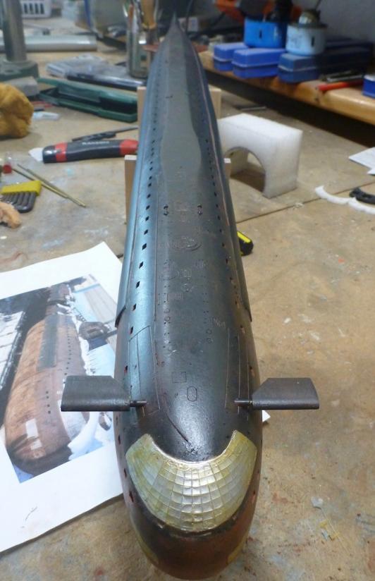

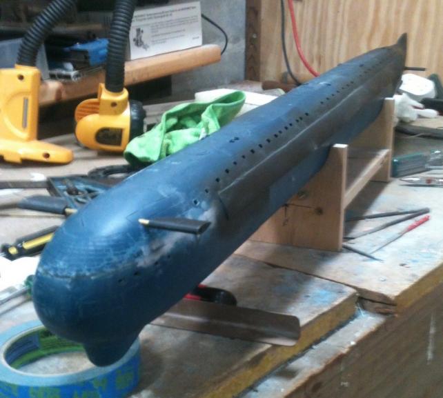

        The hull is together now and conformalarray is almost finished. Its getting blacker and more menacing every day.

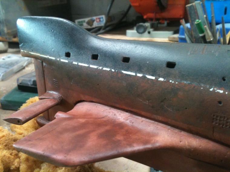

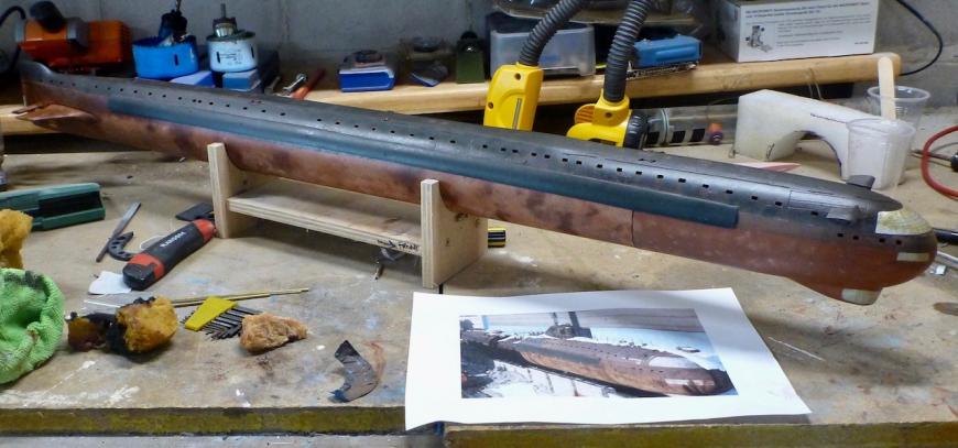

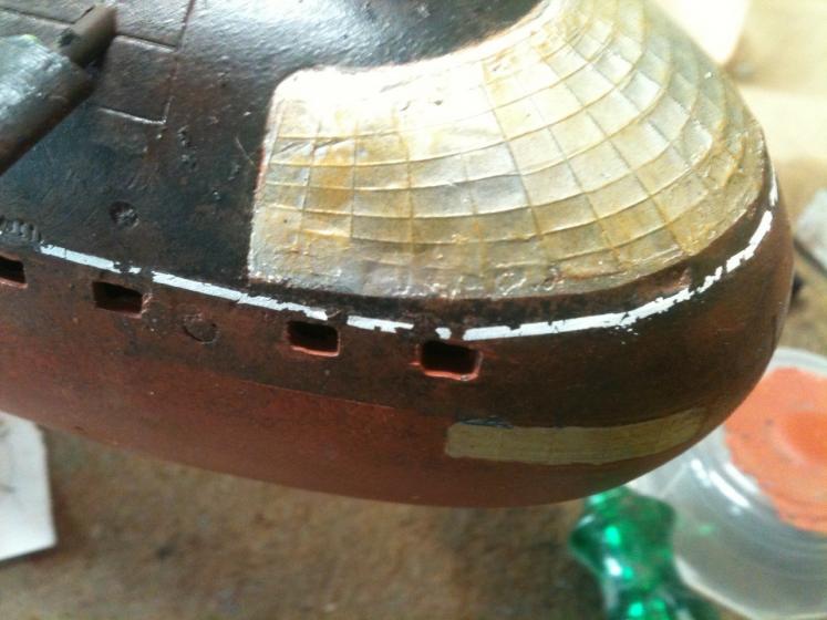

              I've been playing around with this hull while I wait for the sail to arrive. The junkyard look:
                • 3757
                #367
                I do like that look! Share your processes and tips, please. You are capturing the feel really well.
                  #368
                  Bob Martin did a post some time ago on weather the Nautilus. This one started as a coat of red brown paint as a base coat, followed by masking off the water line and the top and bottom halves of the hull. Then a coat of granite black applied with a sponge on the top half and several coats of rust brown, white and pink sponged onto the bottom. The radomes are just hand painted silver with a bit of rust pigment rubbed on top.

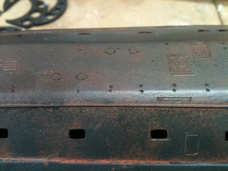

                    This is a closer view of the upper surface of the November.
