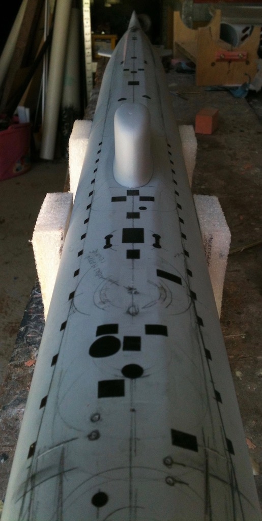

            You are the Master. Can't wait to see those props. Meanwhile the marking out continues. About half the masking out is done. The rest will be scribed once the plug is painted.

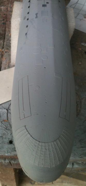

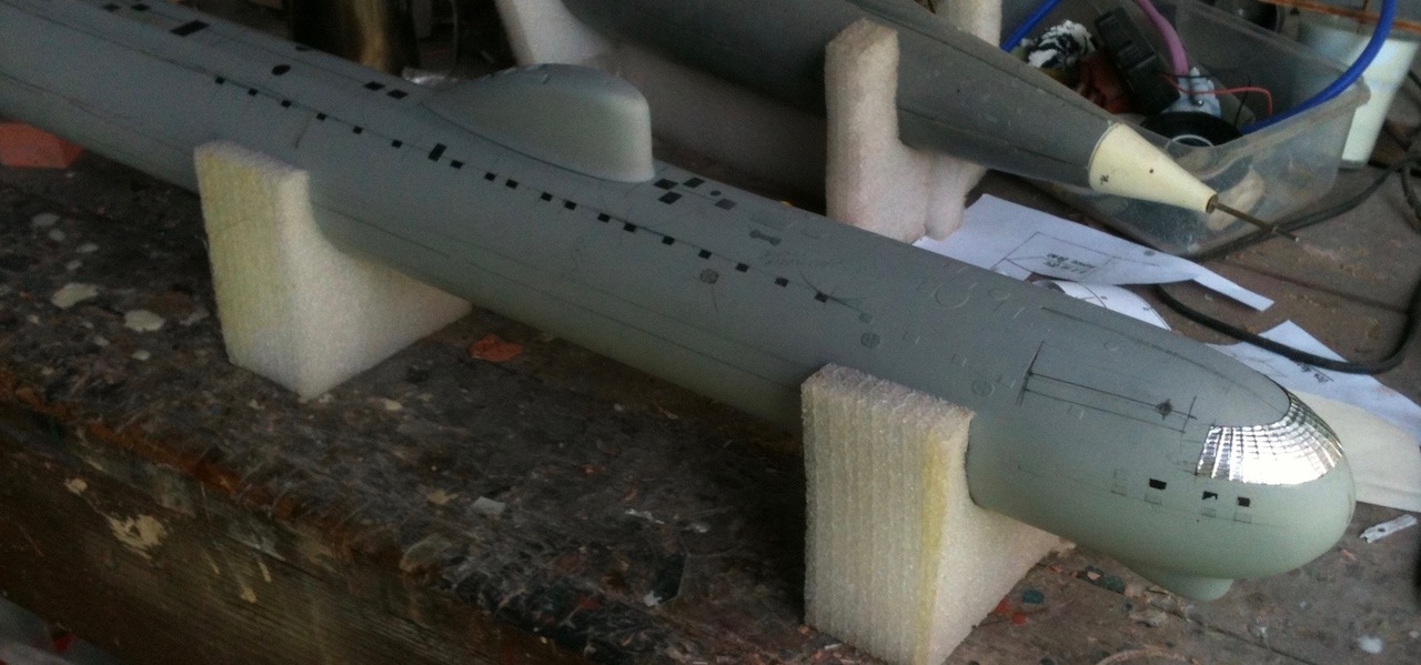

                    I have been giving the front sonar dome some thought lately. This is the current idea which uses thin tape overlaid with bare metal. Its OK, but the tape is a bit too wide. I'm going to experiment with waxed cotton thread as for formwork and see how that looks. Any other ideas are welcome.

                      thin adhesive strips followed by a blast of abrasive grit within the tape matrix. Remove the tape strips and wa, la: dished in GRP sonar window.
                        #176

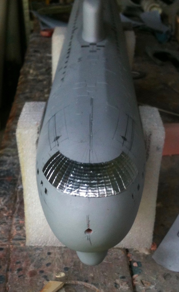

                        That's a good idea. After painting the tape and bare metal looks clunky. I've been experimenting with etched brass. Looks a lot better.

                            I agree with your conclusion, which is a shame because the tape looked so cool pre-primer. Great idea.
                            On the final hull, will the sonar windows be recessed or slightly raised?
                            *EDIT* - I'm with Tom on this - the foil look, especially the kind of "wrinkled" texture that those horizontal lines add a ton to the overall texture of the boat. Almost sort of like the skin on a B-52 when you look closely:
                            I don't know what it is about those silver colored sonar windows, but I've always really dug that look on the vintage Soviet boats. Perhaps you could build up a few layers of primer, then lay out a grid of horizontal & vertical lines made of brass or foil, and then do as David suggested and blast the remaining area with an abrasive?
                            Either way, keep doing exactly what you're doing. I just get more and more excited every time I open this thread.

                              Those are nice ideas for the sonar. I see the clunky that you are talking about, but having that molded in adds to the look of this sub. At our local craft store, there is a foil (gold, copper, aluminum) maybe that would reduce the bulkiness?
                                #180
                                That's the foil that I used. Was hoping that it would be a little bit stiffer and mute the tape lines but its very thin and conforms almost exactly to the outline of the tape. I've found a better solution, I think. Workimng on that today.
