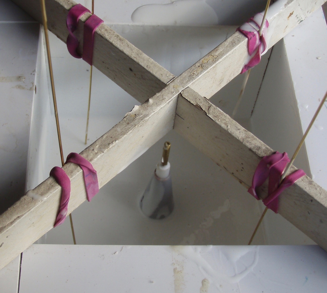

        Is it safe to come out now? This is the upper half of the mould for the complete tail end. The brass rods are connected to the trailing edges of the thing to channel air bubbles away from the edges. I'm going to add a 10" tube at the top to provide a bit of pressure when the resin goes into the mould.

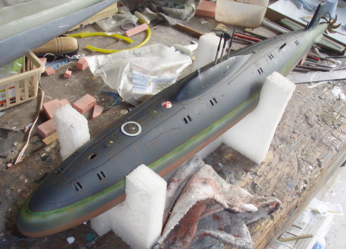

        This is the finished boat. Add SD and some weight/foam for balance and off she goes.

          Glad to see you take on the very challenging tooling chore of producing a stern cone with all four stabilizers integrated into the eventual casting. Good stuff!
          Strands of carbon fiber placed into the tips of the stabilizer tool cavities will greatly reduce the likelihood of breakage to the eventual cast resin tail-cone appendages.

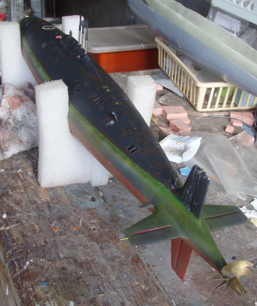

            If I was t pick on one area of your finished sub (which is gorgeous), it would be the space between the aft planes and the stern stabilizer. You have weathered the sub, but in-between this space is the original paint.
              #171
              David. I have the carbon fiber ready to go; Tom. "Hello nit, this is picker, over". You're right - I haven't looked at it from that angle so I'll ge on it and fix it!!!

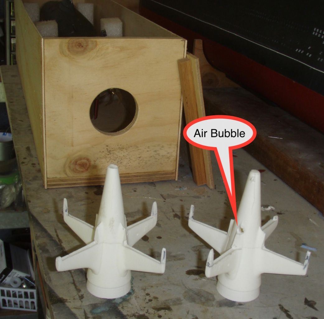

                The mould is working. I still have some problems with random air bubbles being trapped in it but its not all that bad.

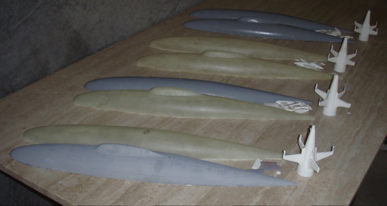

                    That's it. Production halted, items ready to ship! Hurrah!!!Click image for larger version
                      • 13998
                      #175
                      Beautiful. Welcome to the big-time, pal.
                        #176
                        Its not that big. Five off and that's it. One for me and one for each the people that inspired me. Seems like a good trade to me.

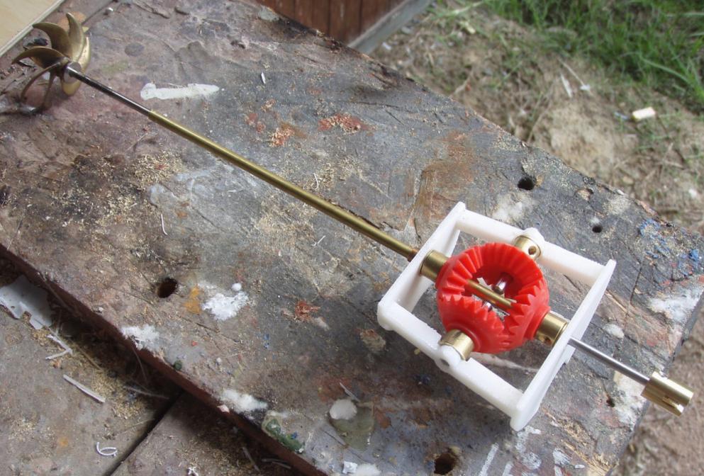

                            Basic contra rotating gearbox. Standby for water ski activity.
