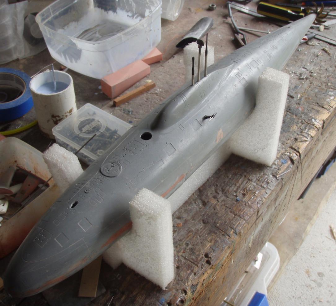

      I've been having a play with the practice hull while I wait for a new lot of silicone to arrive. Its going together quite well so far.

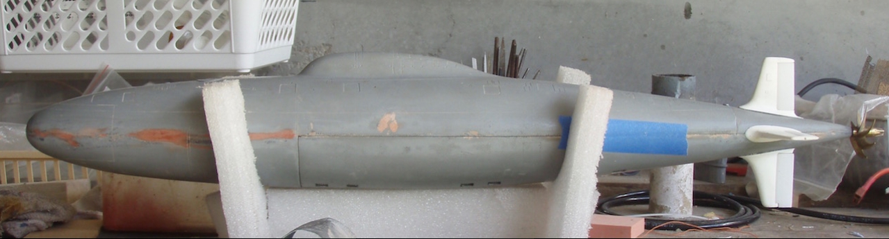

                  #128
                  Test fitting some of the bits that I made earlier whilst the upper mould dries.

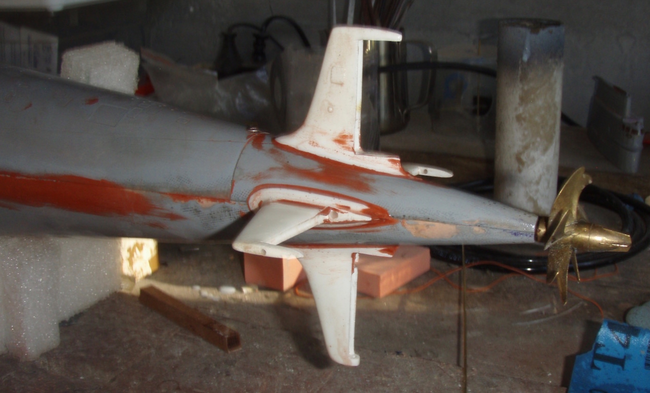

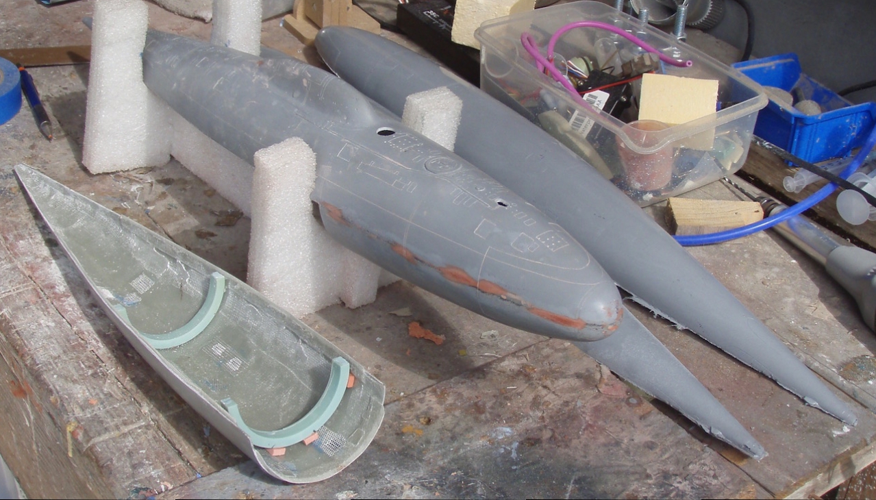

                    #129

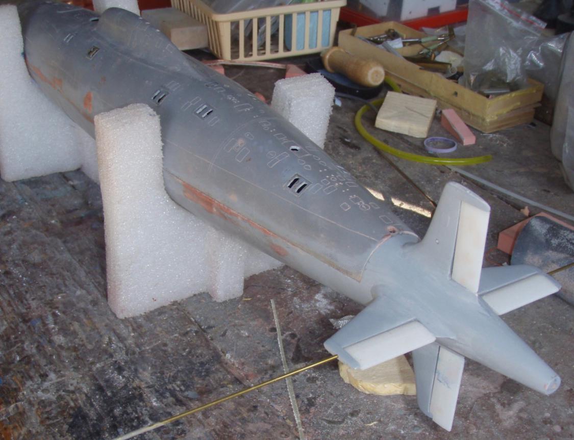

                    Fitting the tail feathers today. Not perfect but OK. One of these days I'm going to buy a pressure pot and a vacume pump and and elephant and a merry-go-round and a new Ferrari etc etc.
                    The control surfaces look pretty small but I'm assuming that this boat will be very slick in the water and won't need much in the way of deflection to get it turning and diving.
                    And the messy bit.....

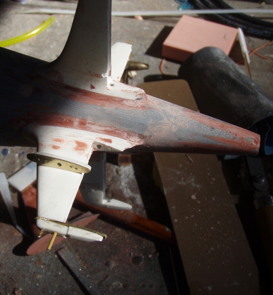

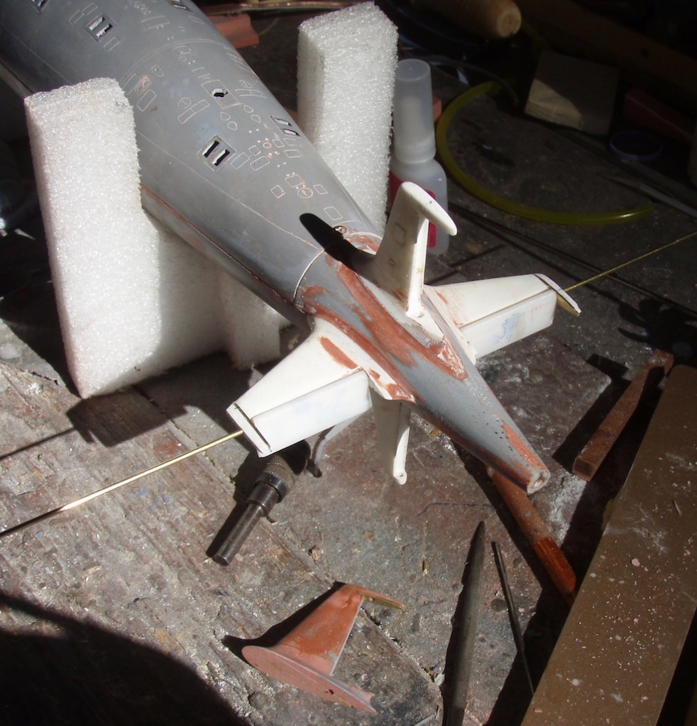

                      #130

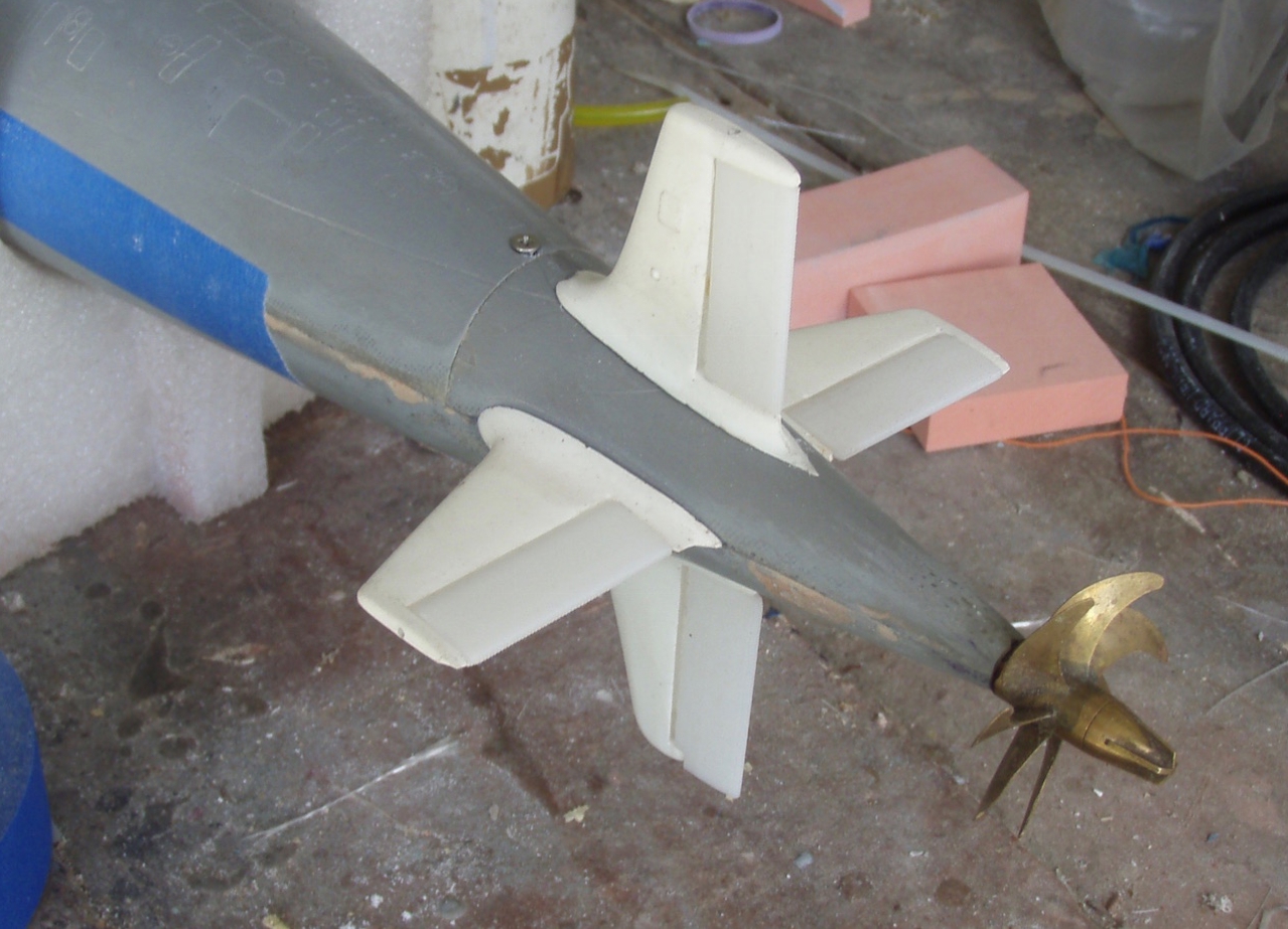

                      I keep busting off those fiddley little pointy bits on the stern planes. This is the fix -
                      A bit of filing and filling and it looks OK and is much stronger than before.
                      She is slowly coming together.

                        #131
                        Next time you cast up the horizontal and vertical stabilizers, prepare the tool by placing strands of carbon fiber at the tips to give the resulting cast part strength in that area.
                          #132
                          Yep, I thought about that and about placing a brass rib in the mould but it kinda got lost amongst everything else.

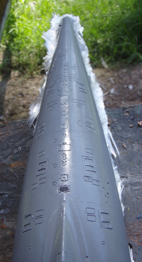

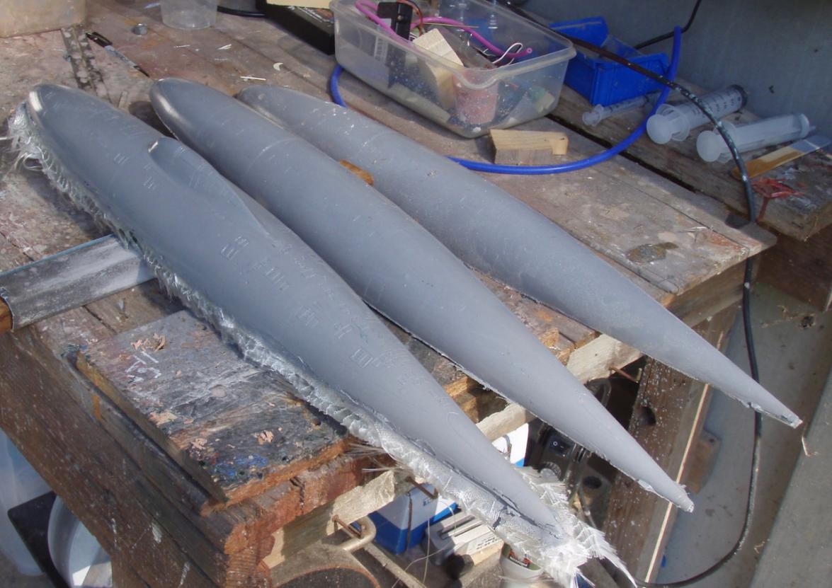

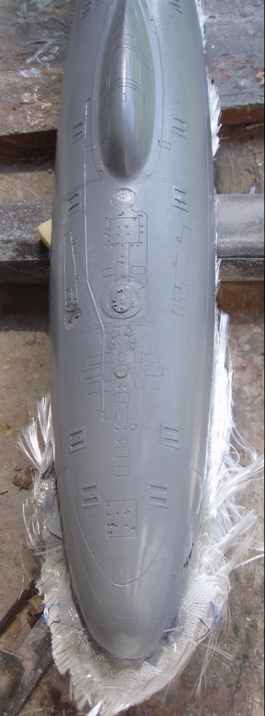

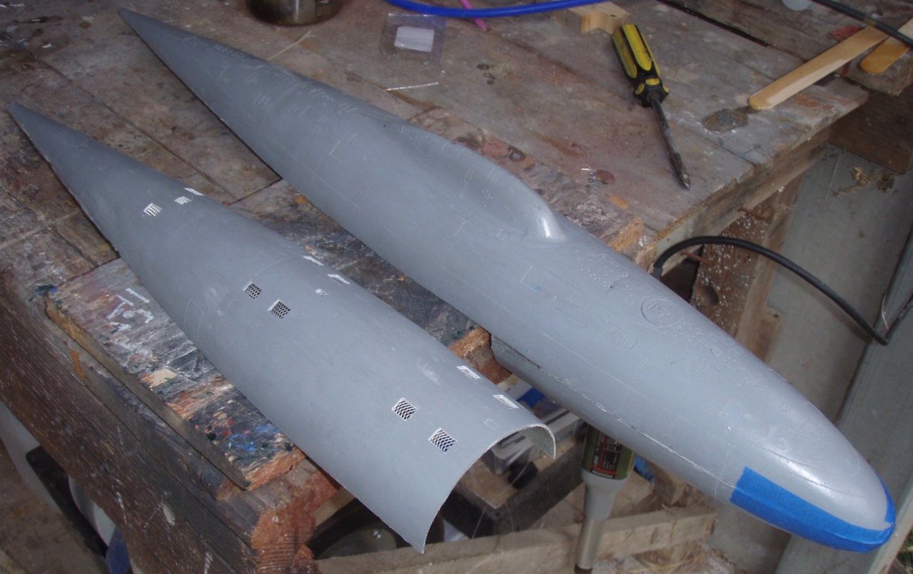

                              I've started on the upper moulding process. This is the first shot out of the mould. It has a few faults where the gell coat has pulled away from the substrate.

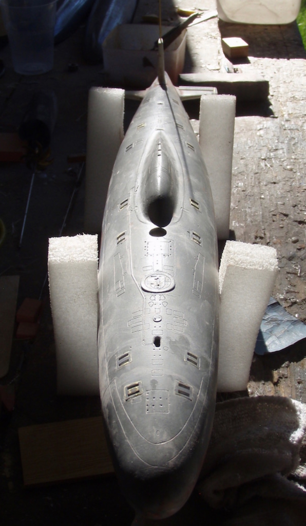

                              And, meanwhile the Beluga build goes on (in the background).
