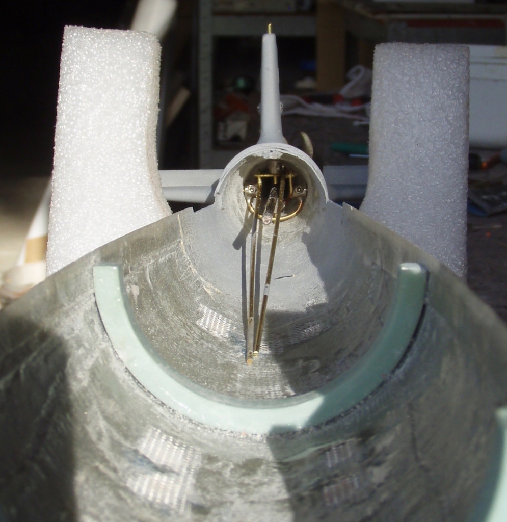

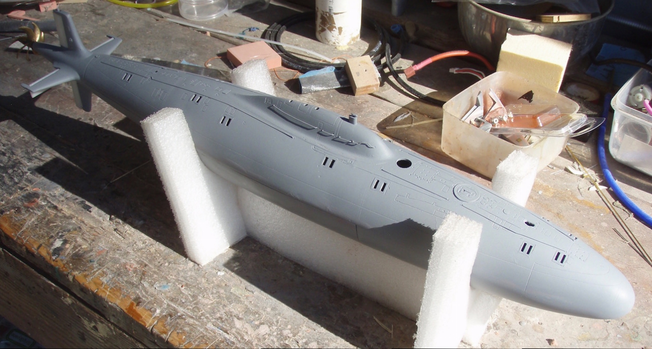

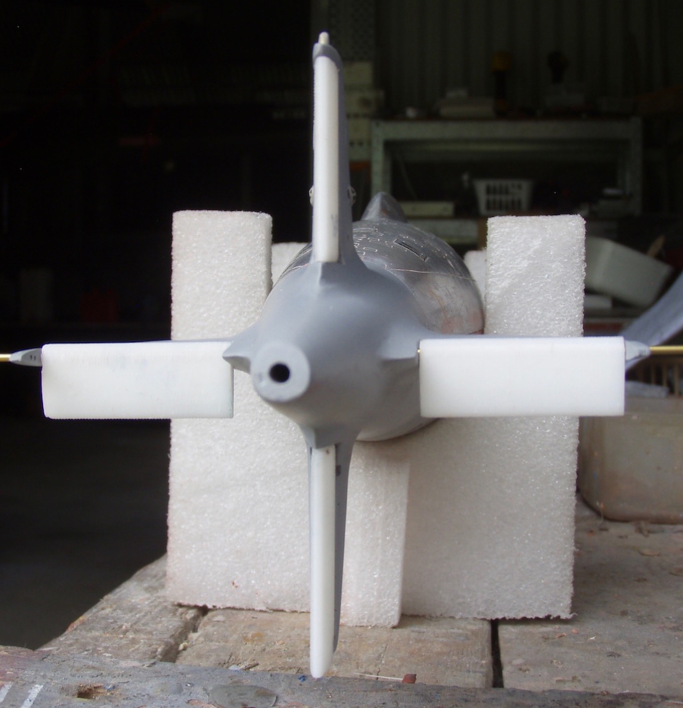

        I'm getting close to finishing the tail section. If I had the skill and a vacume pot, I'd cast this whole tail section in one piece and eliminate all the messing around. But I don't, so I won't!

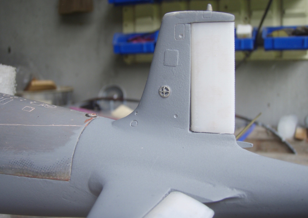

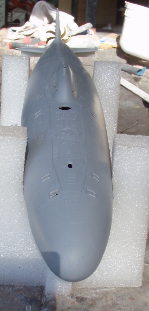

          Spent a few hours today adding safety lines and hand rails. I started with 1mm stainless stell rod but it looked too thick. This is .5mm brass - much better.

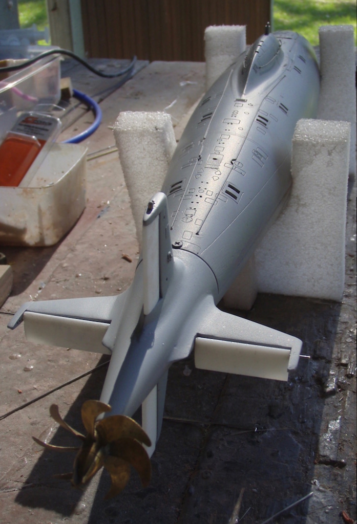

              Sure does. I'm thinking of fitting a contra rotating prop system. Its not scale but can you imagine who fast that thing will go with TWO props?
                • 3768
                #142
                I think without the contra-rotating props it will be an adrenaline rush! After making this accurate, your going to add an unrealistic detail? Why make things more difficult?
                I know it is your party and you can do what you want to.
                  • 13998
                  #143
                  I read, or saw a picture where this boat investigated the counter-rotating propellers.
                  As this is the Ruski ALBACORE, and pretty much followed the same testing in phases protocol, I find it difficult to believe that at some point in this experimental boats career, it did not have the 'mix-master' at the ass-end.
                  But, right now, don't get fancy. Go with the single wheel and get this dude into the drink.
                    #144

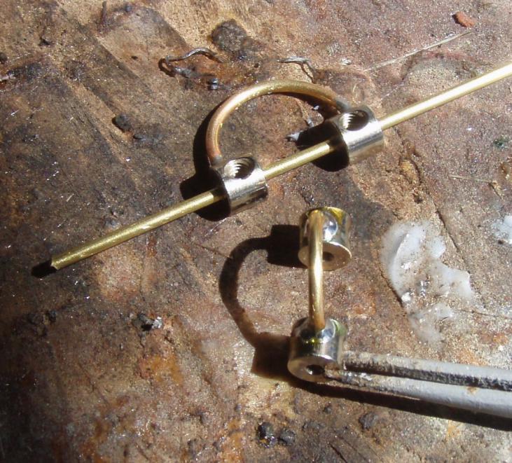

                    I ordered four 1.6mm ID wheel collars a few days ago. This is them. Making the yokes for the stern planes and upper and lower rudders.
                    Rear end madness!

                      #145
                      I was going to say something about how tight it is back there .... but decorum dictates otherwise.
                      Good looking work back there, pal. Will this thing take a 2.5 cylinder, and if so how long can it be to be practical -- want to produce as much ballast tank as is possible as these boats had a stupidly high freeboard in surface trim.
                        #146
                        Hi Mate. Hope you are feeling better. I'm not sure about the SD yet. The shape of the hull is almost crying out for a hybrid 2"/2.5" set up. I'm thinking of a fat little 2.5" ballast tank in the middle with two sections of 2" at either end for the battery and electronics. On second thought, I'm going to send you set of hulls and you can work it out!
                              Free translation of a russian publication:
                              quote " it was possible to determine the ways of reducing hydrodynamic interference to the work of the SAC at high speeds, as well as to test new methods for calculating propellers (at different times, propellers of different designs were installed on the submarine) " unquote
                              and if we look at the below scetch it's not so unrealistic me think.
                              What I don't know is if they were tandem or contra-rotating props.
                              When built she was provided with a single 7 blade prop with actuator (It was not a highly skewed propellor).
                              So maybe she had different props during here lifetime but when she was scraped her original (or lookalike) prop was in place, see picture below.
                              Grtz,
                              Bart Click image for larger version  Name:	beluga.jpg Views:	1 Size:	66.0 KB ID:	125674
Name:	beluga prop01.jpg
