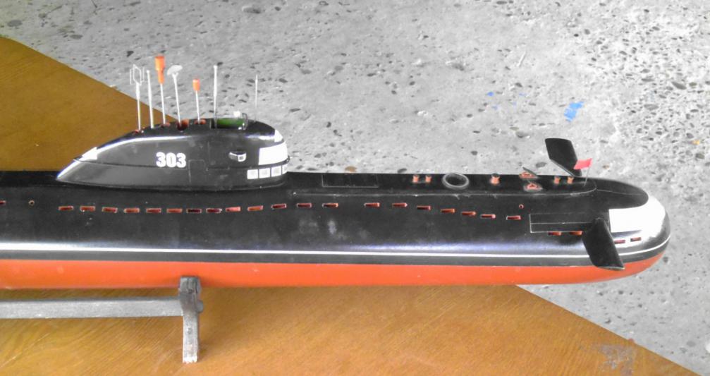

            • Tirfing
              • Jan 2017
              • 66
Name:	627-November III-160710.jpg
              And Another one....
