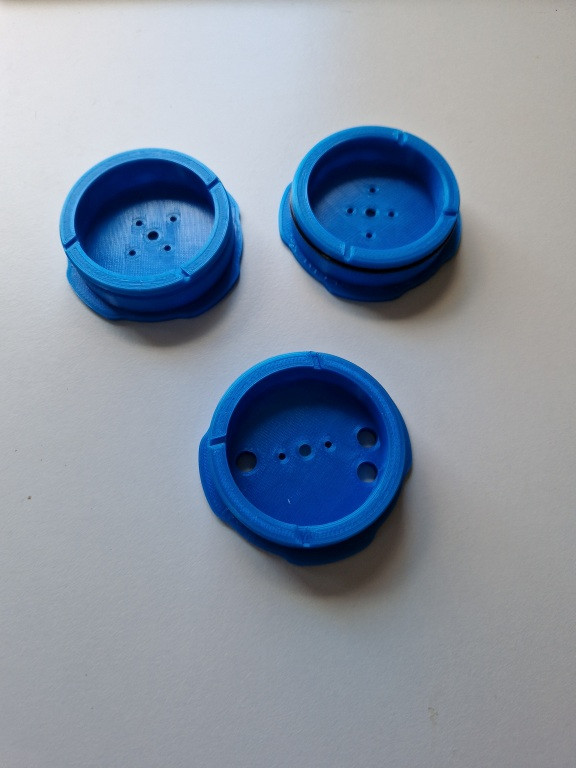

    The end caps of the ballast tank are ready... Perhaps my reasoning behind making a custom water pump did not make sense. Routing the tubing inside is tricky, as the minimum bending radius of the tubing is relatively large. The last picture shows that both the discharge and suction of the pump and the lines integrated in the intermediate cap are in line. This was my aim; this way, no bending of the tubes is required. It will only require a small straight piece of tubing.
    Click image for larger version  Name:	Victor_III_59.jpg Views:	0 Size:	51.8 KB ID:	180049
    Click image for larger version  Name:	Victor_III_60.jpg Views:	0 Size:	62.2 KB ID:	180053
    Click image for larger version  Name:	Victor_III_61.jpg Views:	0 Size:	45.5 KB ID:	180051
    Click image for larger version  Name:	Victor_III_63.jpg Views:	0 Size:	45.3 KB ID:	180050
    Click image for larger version  Name:	Victor_III_62.jpg Views:	0 Size:	54.1 KB ID:	180052

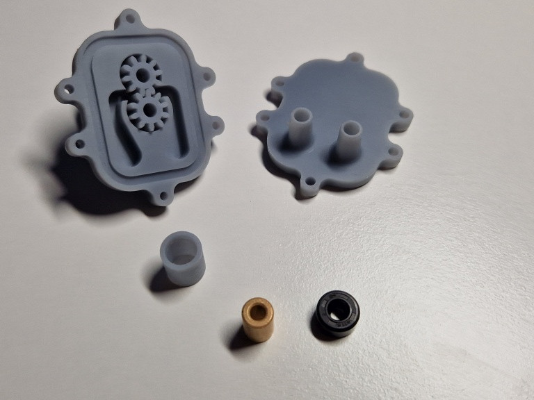

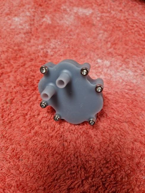

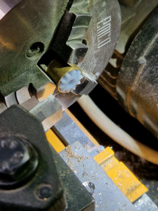

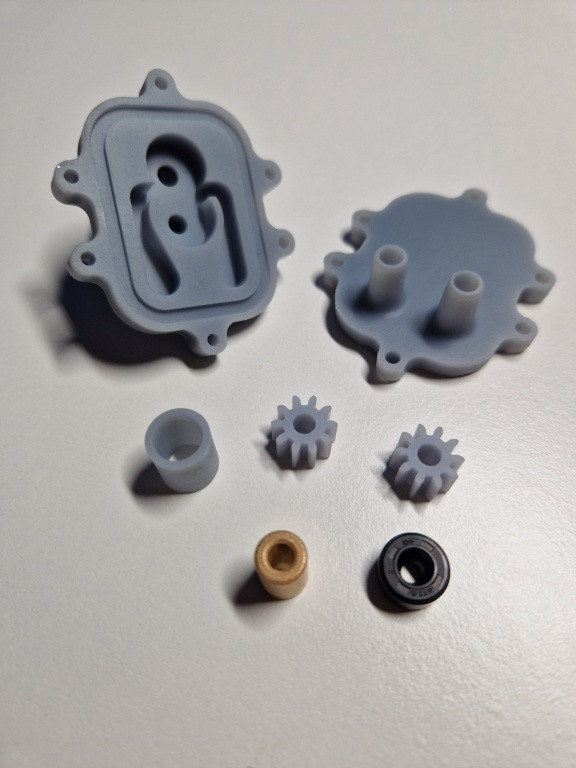

  • bwi 971
    replied

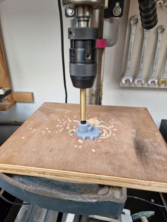

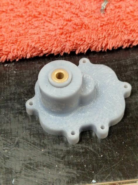

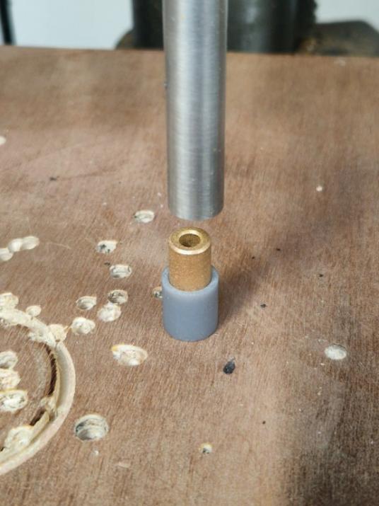

    Assembling the pump. Tolerances were still good after fully curing.
    Lip seal and bushing were pressed in place using the drill press.

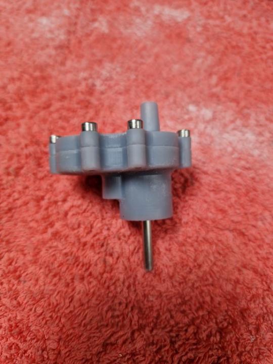

    The bushing and gears had an overlength to allow machining to the correct length. For the gears, I used a brass tube with the correct ID to hold the gear so I could secure it in the chuck of the lathe.
    Both pump housing and cover are secured together using stainless steel M3 bolts.
    Waiting for the arrival of the O-rings for a test run.
    Grtz,
    Bart

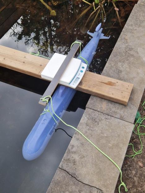

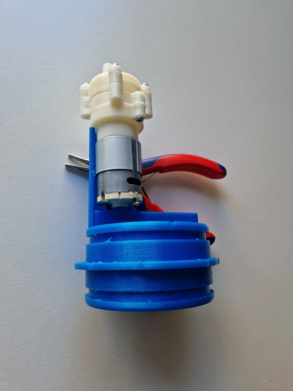

    I've been occupied with the design of the WTC.
    To determine the minimum lifting capacity of the WTC, I measured the weight of the hull above the waterline when surfaced. As with my AKULA, I used Archimedes' principle, calculating the difference in weight between when the vessel is surfaced and when it's submerged. I determined that a minimum of 310 grams is required.
    Measuring setup.

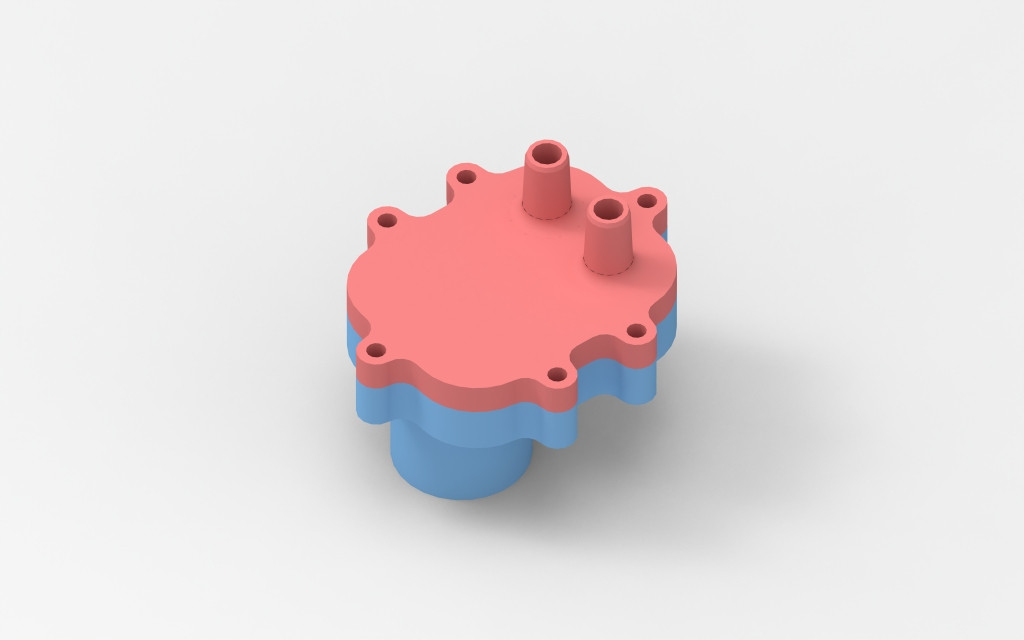

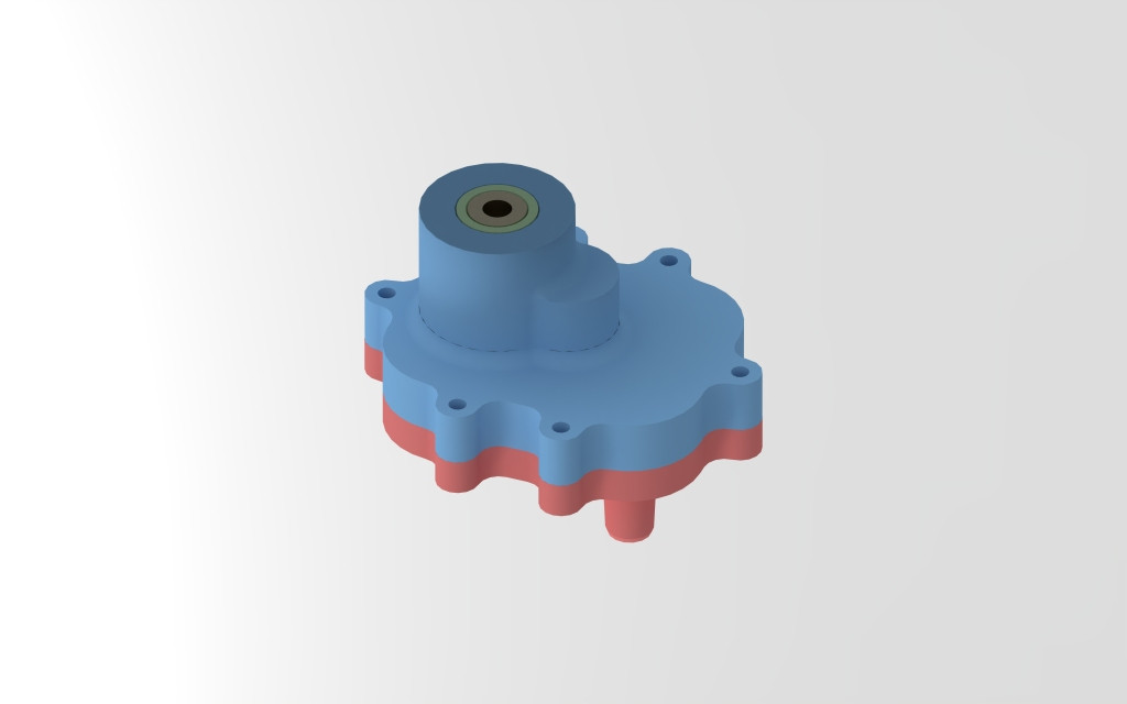

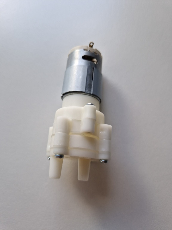

    After several prototyping runs, I realized I had a massive oversight regarding the pumps.
    I ordered a water pump and, upon testing it, discovered it was a one-way pump, not reversible. I decided to use two pumps instead and adjusted the design accordingly. The pumps would rest in cradles, and "sea" suction and overboard functions were integrated into the intermediate cap, which acted as the bulkhead for the ballast tank. I was quite proud of the design until I realized that the pumps were "open," meaning they allowed water to flow freely without running. This oversight felt rather foolish and embarrassing, to be honest.
    I abandoned the idea of using two pumps and sought a reversible gear pump. In the past, cars on this side of the pond used windshield washer pumps from the brand VDO, which were gear pumps. I know that a gear pump also backflows when there's a pressure difference, but I pondered providing a loop above the water surface level to mitigate this.
    I couldn't find a suitable mini gear pump, and the VDO pumps are hard to come by. Furthermore, I wanted a brushless motor to drive the pump. So, I decided to design one myself. I'm not sure how well it will work, but it was a fun challenge. I'll use 4mm shafts, as I use them wherever possible. I buy 3m lengths of this material, and I have seals and bushings in my standard stock for the 4mm shafts.
    For the seal between the cover and the housing, I used an O-ring. O-rings can be used in rectangular or non-circular groove patterns, but it's important to consider the minimal bending radius, which should be at least 6 times the circumference of the O-ring. I calculated the required ID of the O-ring by converting the circumference of the rectangle to a diameter. The inlet and outlet are part of the cover and will face towards the intermediate cap of the ballast tank (which I will redesign).
    The prototype needs to settle for a few days to allow shrinkage to occur. The clearances and gear backlash seem okay at first glance, but further settling is necessary. Any design flaws or weak spots will be revealed after conducting a test run.

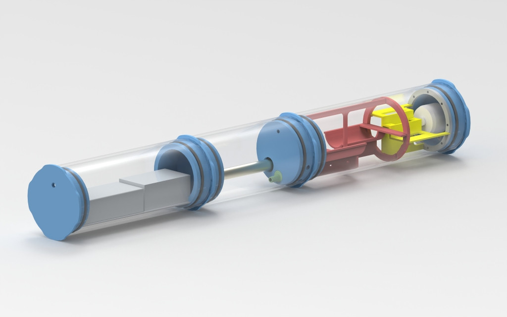

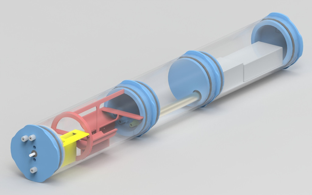

    Below is a rendering of the WTC designed for two pumps.
    Servo rack (Yellow)
    Pump Saddles (red), now obsolete
    Ballast tk, inside I provided a fairly large conduit for the cables (silver)​

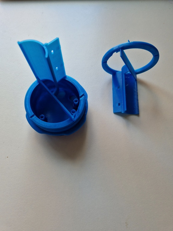

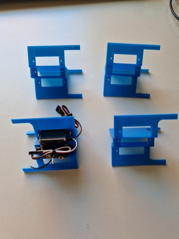

    Several prototypes have been made and adapted to overcome issues.
    Servo rack
    Encap
    Pup racks (now obsolete)
    ​ Click image for larger version
