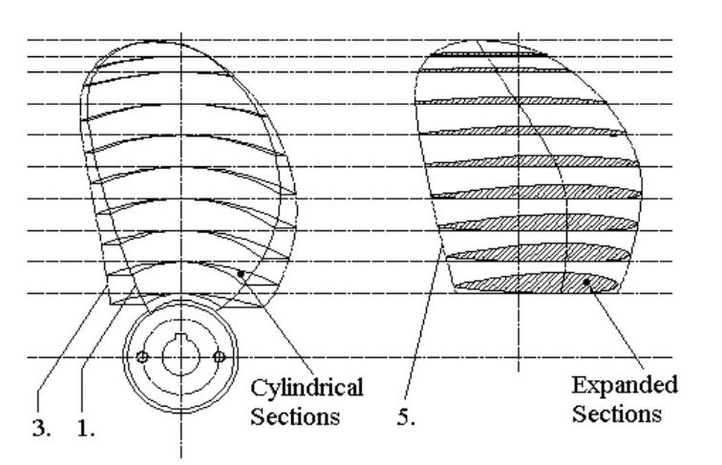

    Drawing scribing stencils equals looking at pictures for hours, figuring out the positions of all the hatches, the distance between them, to be honest for me it's quite boring stuff, but it has to be done.
    I needed to do something in between that is fun, such as designing and making of the propeller.
    Although I must admit that this is also involving the profession of staring at pictures.
    This will be my second propeller I made the first one was for my AKULA, there I used brass sheetmetal for the blades, now I wanted to add some body into it by designing the blades with actual airfoil shaped cross-sections.
    I went all in (HWSNBN makes me do all this ****) I refer to HWSNBN excellent explanation of propeller making in a SCR from some time ago (damn I'm polite).
    I do not want to post a picture of the prop assembly without explaining what it takes to design a propeller. If you want the skip all this just scroll down, but in my opinion, this is part of the fun.
    The V3 I’m trying to make here is equipped with a tandem propeller. Each propeller has 4 blades, so the complete propeller assembly has 8 blades.
    Based on the pictures I made following assumptions in my design.
    • It is a non-skewed propeller as the projected outline is symmetrical in most pictures (Projected Outline is the outline of the silhouette created on a screen just forward of the propeller, by a light directly behind the propeller, shining directly forward).
    • The total propeller is quite short although it there are two propellers involved here, the propeller will have very little rake (A propeller with rake has blades that slant fore or aft of a line perpendicular to the propeller axis of rotation).
    • The pitch of both propellers is the same (The pitch is the linear distance that a propeller would move in one revolution with no slippage).
    Based on the info provided in the article of HWSNBN following dimensions were determined:
    • Pitch 53mm (17 feet for a real one)
    • Diameter 49mm (6m for a real one)
    • The projected area ratio is about 70% (Projected Area is expressed as a percentage of total disc area: PAR ≡ Projected Area/Disc Area, the Projected Area is the area enclosed by the projected outline of the blades and the disk area is the area of the circle scribed by the blade tips)
    • It will be a constant pitch propeller (With Constant Pitch Propeller the propeller blades have the same value of pitch from root to tip).
    • The cross-sections of the blade changes with the radius, the root is thicker than the blade tip (see expanded sections in picture below).
