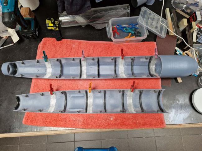

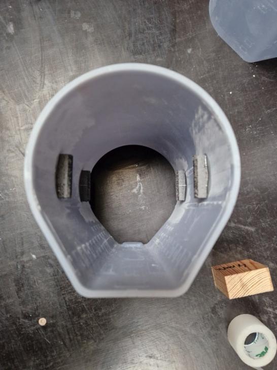

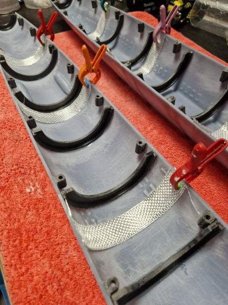

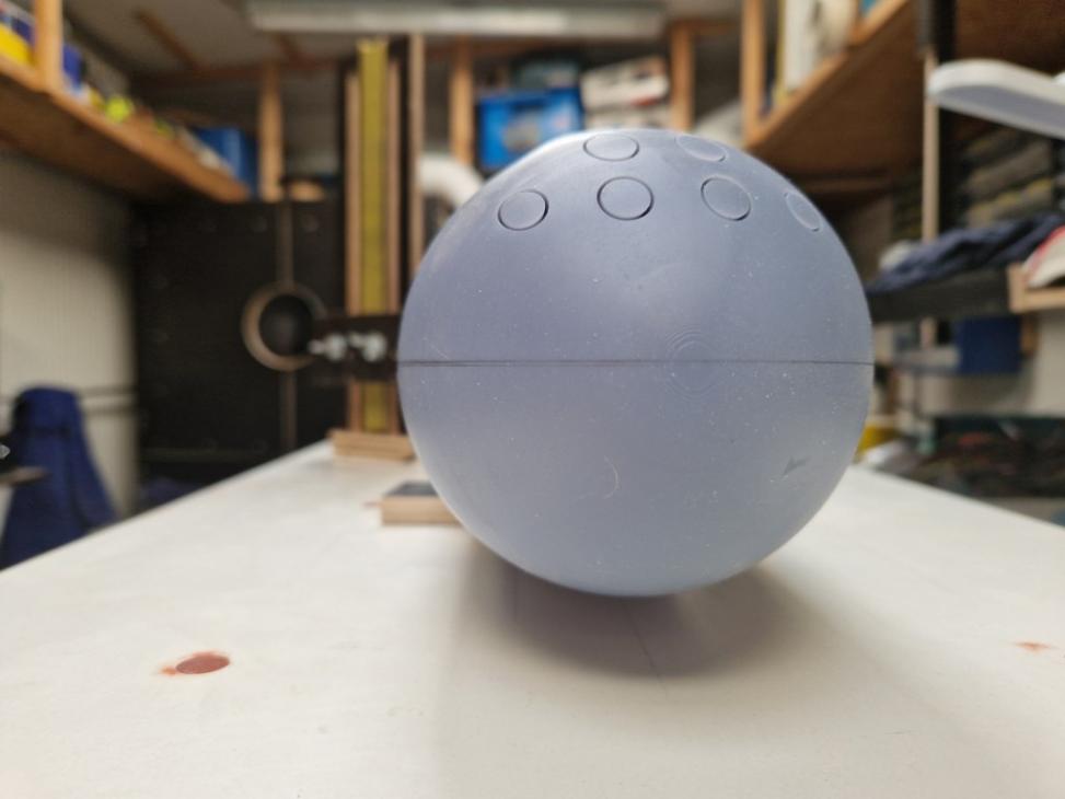

    Bow and stern glued in place with CA. As I don't want to rely solely on the CA, I added a strip of fiberglass mat on the section seams and fixed it with epoxy.

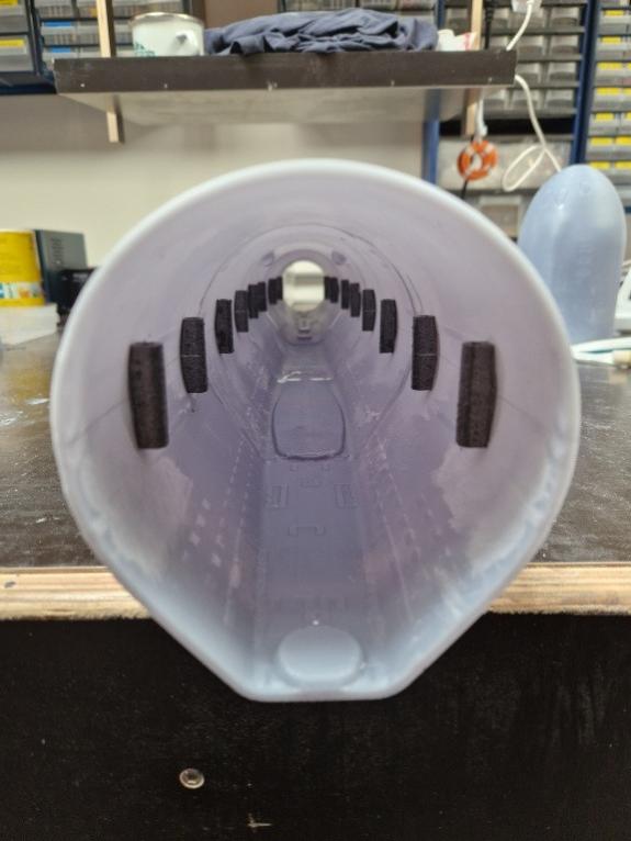

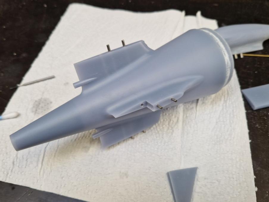

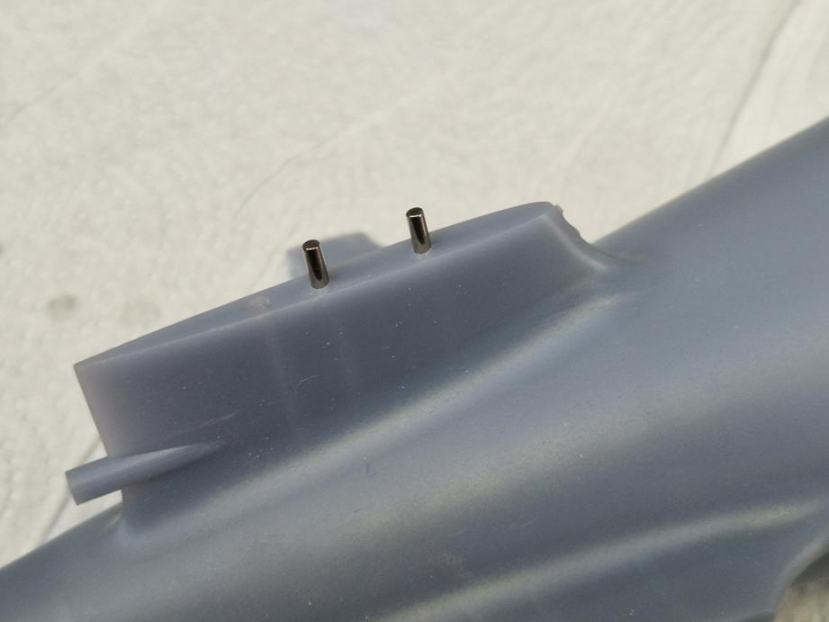

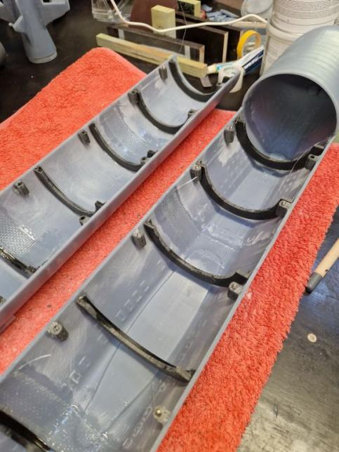

    Made all the 4mm stainless steel (SS) indexing pins (tapered), reinforced the hull with frames that also serve as supports for the WTC. Very happy with the result, very tight fit of the upper and lower hull without any additional tweaking.

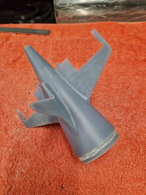

    I used also indexing pins for the stern appendages.

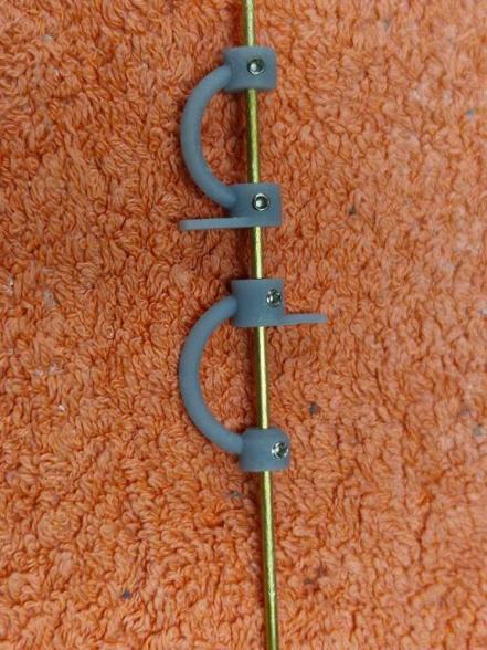

    Designed also the yokes, the rudders will have an 60° rotation each side and the dive plans 50°.

    Originally posted by Marylandradiosailor
    What material was used for the numbered blocks? (the ones that will hold the pins) Thx.
    PETG, glued in with epoxy, 4mm holes were included in the print and afterwards reamed for a snug fit.

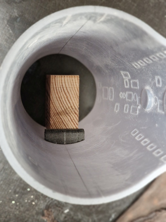

  • bwi 971
    replied

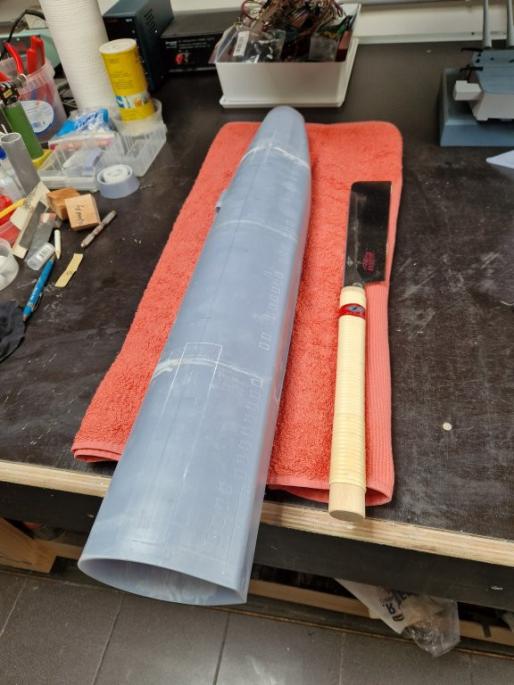

    It's been a while due to various reasons and other scale projects.
    All parts were printed with better supports this time.

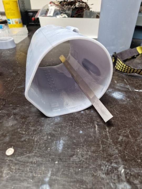

    My intention was to use a transversal cut to gain access to the internal WTC. However, that did not work out, so I had to split the hull longitudinally. I wanted to provide index pins before the split because it was difficult with my Akula to match the seam of the upper and lower hull parts.
    I have 6 hull sections, 4 of which will be split.

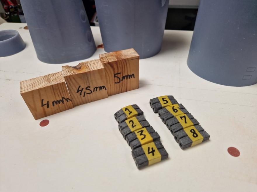

    For each hull part, I prepared 4 index pins. The radius of the index pins differs depending on the position they will be glued into the sections. Distance blocks were also prepared with various heights and will be used to support the indexing pins when glued in place.

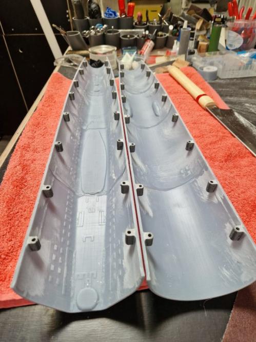

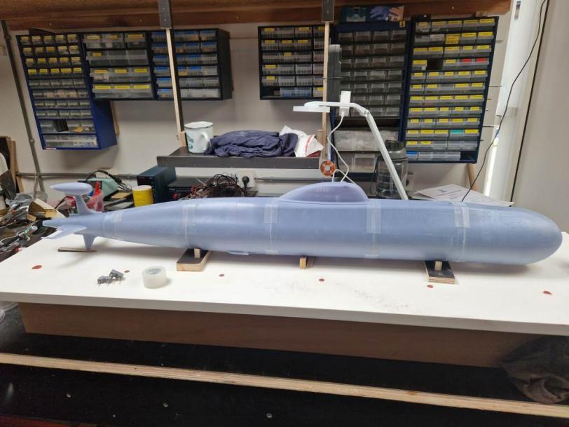

    I temporarily assembled the six hull parts together with tape, ensuring the assembly was plumb both transversally and longitudinally, and traced the separation line all around. This line was transferred to the inside so I could align the index pins to it.

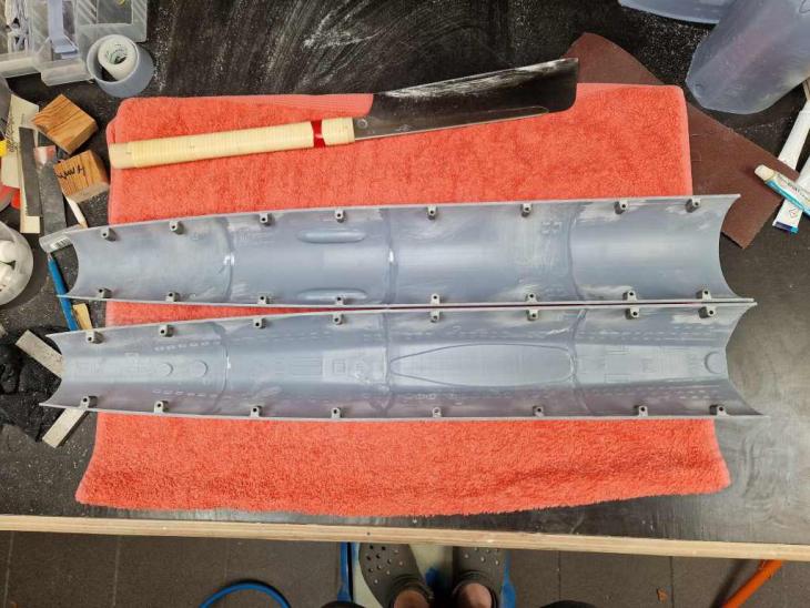

    Next, I glued the index pins to the hull sections using the distance blocks.
    The next step was gluing all the hull sections together and making the longitudinal cut. I used a thin Japanese saw, with a kerf of only 0.5mm.
    ​ Click image for larger version
    Grtz,
    Bart
