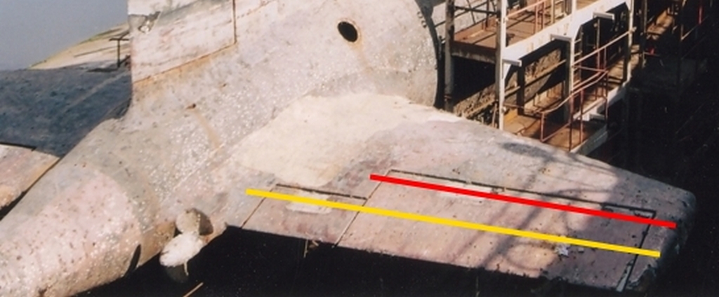

                            I'm working (drawing) on the rear planes.
                            We have the main and the stabilizer.
                            I’m drawing them as one (the stabilizer will be part of the main);
                            We have two options:
                            • Yellow line on picture; Pivot the whole around the stabilizer (semi balanced, will result in flow restrictions over the main)
                            • Red line on picture, Pivot the whole around the main plane (balanced, when angled the trim plane will look like an extension to the main, at 0° angle it will appear like a real trim plane)
                            Think the last will be most effective (that means the radius of the leading edge will be opposite between the stabilizer and main).

                              How about option-3? We don't make the stabilizer (here I would call it an auxillery stern plane) practical, we just scribe its outline into the horizontal stabilizers and be done with it. I don't think I've ever seen a photo of the auxillery stern planes deflected. So, let's keep the ass-end simple: just the main stern planes. And yes, I agree with the 'red line' as the center of rotation there.
