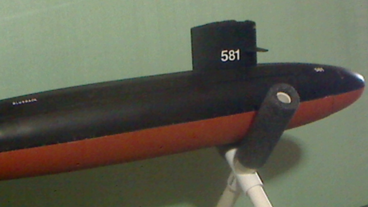

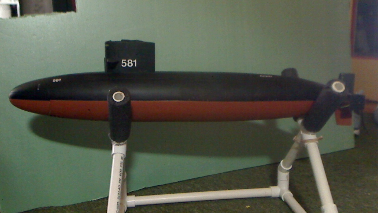

        uploaded pictures 7:10 pm Tuesday evening

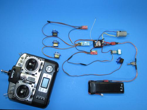

            You do have an angle-keeper in that boat, right? If so, is it trimmed with just the top of the sail sticking out of the water in submerged trim?
            Always observe the switch-on protocol: Transmitter on first, then the SD. And wait a good ten-seconds before wiggling the transmitter sticks!
            Your original LPB-MPC are likely OK. Sometimes, if you wiggle the transmitter sticks before the SD has time for all the devices to 'initialize', the ballast sub-system will be locked out. Did the ballast servo still work when you had the initial LPB not working issue? The SD's go out of here certified for proper operation of the propulsion and ballast sub-systems. If you can give me details at City Lake, that would be most useful.
