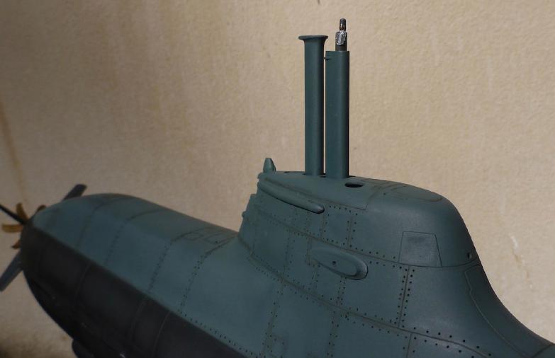

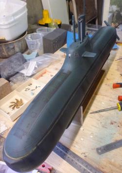

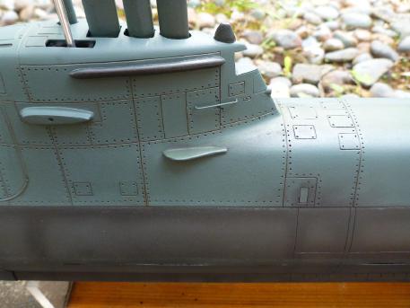

    The paint arrived yesterday afternoon, so now Romeo Romei (S 529) is progressing. Can't find a source for those tiny 1/96 scale depth markings however.
ID:	113750Click image for larger version
    Have to clean up the windows a bit, but the lights are fully functional.

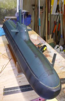

      Playing the periscope.

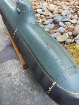

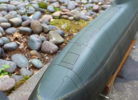

        Front and rear anti skid patches added.
ID:	113774Click image for larger version

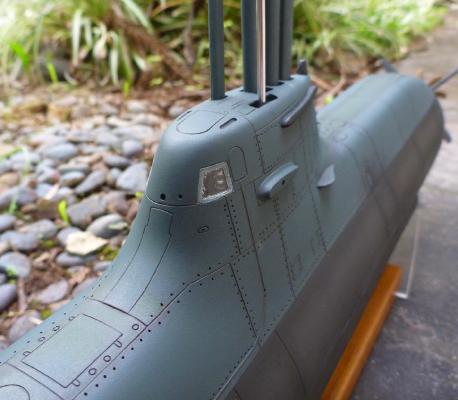

ID:	113804Click image for larger version

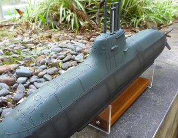

ID:	113806Almost ready to go swimming.
            #35
            First trial in the pool. ADF is a bit sensitive and I broke yet another drive coupler.
              • 3739
              #36
              There is a lot of torque when you go from forward to immediate reverse. Other than that it looked real nice in the water! well done, Captain.
                #37
                Thanks Mate. There is a whole lot of torque. I broke another coupling in that little effort.

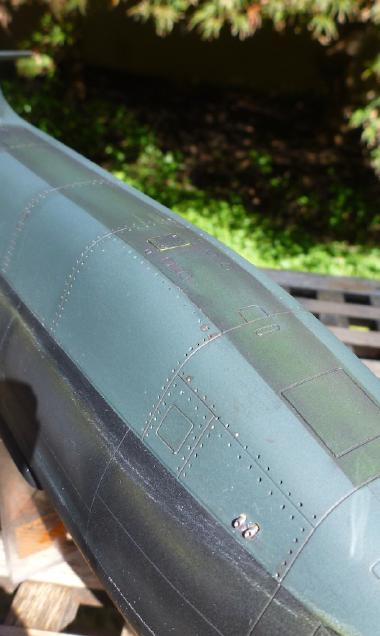

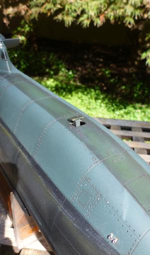

                  I've had a persistent problem with trapper air (probably understandable at my age). When the boat dives there is a pocket of air that does not vent and prevents the boat settling. Fortunately there is a neat little hatch scribed in the rear deck at abouit the right place. Therefore:
ID:	113928Click image for larger version
                  There is a small operating rod attached to the hinge that opens the flap when the sail planes hit full down. Gravity and forward speed cplse it again (I hope).

                    #39
                    Now .... THAT is slick. You gadgeteer, you!
                      #40
                      Thank you Your Eminence. Just gave it a run and it actually works!
                        • 3739
                        #41
                        I will steal that idea! Thank you.
                          #42
                          My pleasure Sinior. One prefabricated aircraft undercarrage hinge and a bit of brass rod and you are away.
                            #43
                            Just make a free moving trapdoor. Pressure from trapped air bubble forces flap up.
                            Btw, Love the rivet holes.
                              #44
                              I tried the free moving trap door but the dammn thing flapped around like a tap dancer's instep so I went for a more controlled approach. Wasn't sure about the rivet holes at first but once I'd begun there was no turning back. Overall I'm pretty happy with it.
                                #45
                                Wonder if you could make that vent of yours airtight and putting a pair front and aft making the whole casing a ballast tank.
