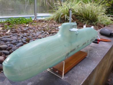

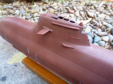

    Pushing on with the filling and filing. Drilled the two fairwater plane holes and (amazingly) they lined up just fine.
    Fairwater planes installed and working.Click image for larger version

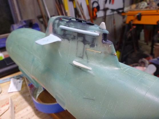

    The various bits have been added to the sail.Click image for larger version

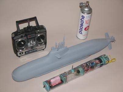

        [ATTACH=CONFIG]n113424[/ATTACH]
        Fairwater planes installed and working.[ATTACH=CONFIG]n113425[/ATTACH]
        The various bits have been added to the sail.[ATTACH=CONFIG]n113426[/ATTACH]
        And its now tucked up for night. [ATTACH=CONFIG]n113427[/ATTACH]

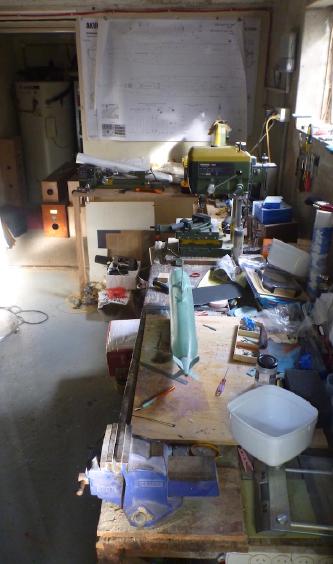

        I love it when you guys show off your shop. Is that an X-Y vice under that drill-press? Slick. And I so appreciate a guy who builds and uses transportation/storage boxes for his completed r/c submarines! Working sail-planes!?.... They call me anal!?
          Yep. X-Y vice on calibrated table; decent drill press, mill and small lathe on the table behind. If I actually knew how to use this stuff I could make watches! And you should appreciate those storage boxes - you made the one at the top left in the stack (1/96 Skipjack). I just copied the design. I have to go back to the bathroom now and watch the water in the tiolet swirling around in the CORRECT direction.
            Tiolet is the Australian word for toilet by the way.

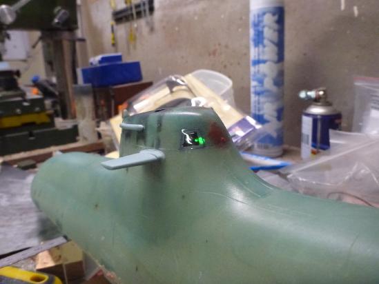

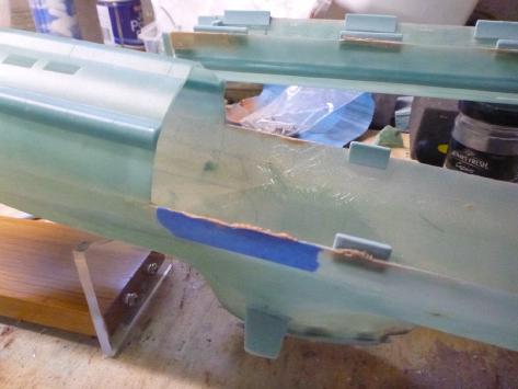

                Filling in the digs. Click image for larger version

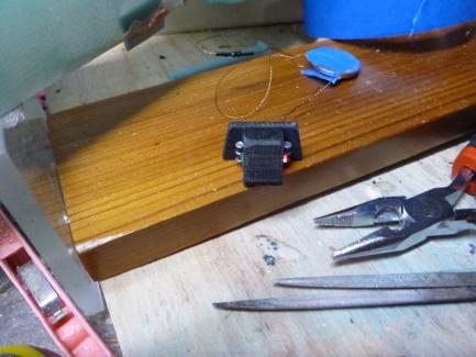

                  Making windows; and lights.
ID:	113500Click image for larger version
ID:	113501Click image for larger version

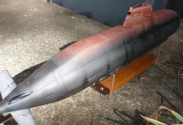

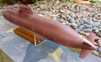

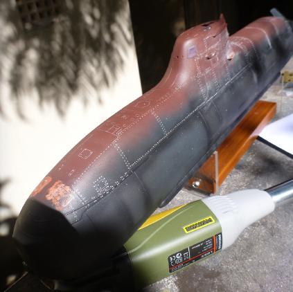

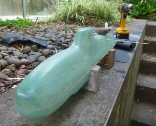

                              Finished the fill, sand, fill, sand, swear, fill, just get over it cycle. Also fitted the SD and the linkages and made a start of the lower hull. There is so much detail on this thing that I can't (in good conscience) grunge it up too much. All of the photographs that I have show the Italian boats looking very clean in any case so I've just hit it with Grey/Black and highlighted the pannel lines with streight black. I'm still waiting for the top side paint to arrive from elsewhere. Also order a 5 mm silver star for the front - in fact I ordered 100 of them because that's the minimum number. Anyone needing 5 mm silver stars please PM me - I have some spare.Click image for larger version
ID:	113591Click image for larger version
ID:	113592Click image for larger version
ID:	113593Click image for larger version

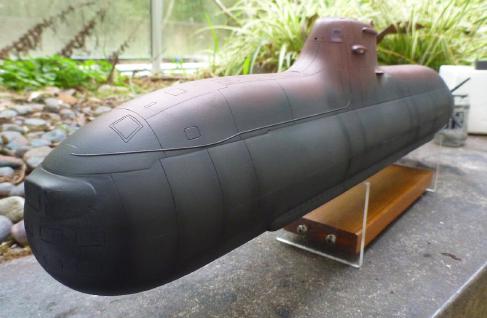

                                It seems that those pesky Germans sold the Italians an export version of the 212 which is missing the two forward passive do-dad (technical submarine term) antennas on the nose. The Italian boats just have two square covers where the German boats have something more interesting going on. It also appears that they hold their submarine's casings together with screws. They are quite distinctive and stand out in every photograph that I have to a lesser or greater degree. Nothing for it but to drill a couple of thousand .5 mm holes. Fortunately I'm waiting on some paint so its no big deal.
ID:	113622Click image for larger version
