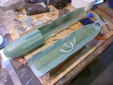

    Here we go again. The D & E 212 is one of the best kits I've assembled. So it seemed entirely reasonable to make another one! This one will be the Italian, Todaro version. Hence my question about the colour (please note the CORRECT spelling of colour - trogladites). I've washed the resin parts in thinner and the hull halves are soaking in the bath. Meanwhile, I am persuing that elusive colour!Click image for larger version

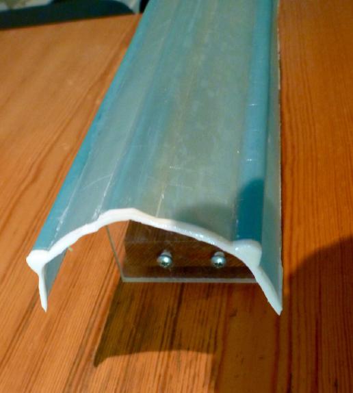

    Making up the kerf, making up the kerf (sung to the tune of "bringing in the sheaves", with apologies to Knowles Shaw).

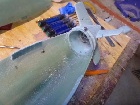

      "Z" cut is complete, kerf made up and tail cone has been rivetted onto the lower hull. Its not going anywhere! Onward!Click image for larger version

        What did you use to make up the kerf?

              I made *p the kerf with casting resin *sing the same technique (as described very eff*sively by HWSNBN in the plans) with masking tape b*t instead of *sing filler, I ran some casting resin along the edge and let it go off before sanding it back. It seems to have worked quite well. That might be beca*se there is a cast resin SD bracket b*tting *p behind it and a radial flange *nderneath it.
              I made some 1mm reviets a while ago so I used six of them to firm *p the tail cone. The photograph shows the ends which I planned to snip and tap down a bit. Once they were in place I p*t a drop of thin s*per gl*e on each and they are now rock solid.
