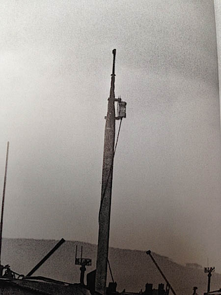

    Earlier I asked about a white light for navigation on the Type XXIII. I saw a model of a Type XXIII with it on the periscope and wanted proof the Type XXIII used it. A gentleman by the name ofMichael shared this photo, but said it was for a Type VIIc (U-281)
Name:	Bronco Type 23_308.jpg
    That is cool, but then he also shared this one (U-2360):
Name:	Bronco Type 23_309.jpg
    Bingo!
    I also read that the oval depicted on the Bronco model's sail (aft and bottom) was a housing for a light. I will try to find that source again.
